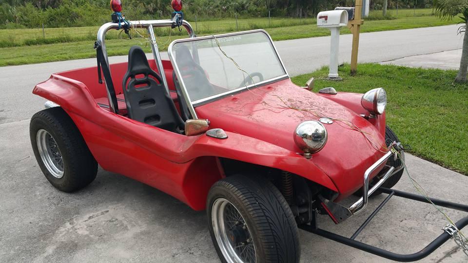

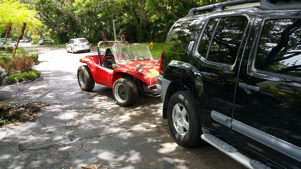

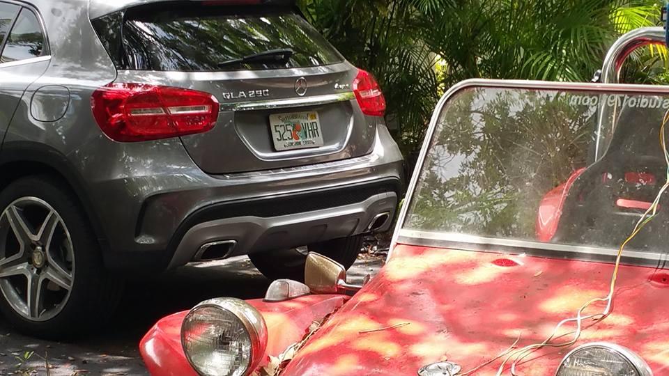

I just bought my first Dune Buggy 3 weeks ago.
I drive Uber part time on Sundays only to make some extra money for my project bus and when i was dropping off an Uber Rider passenger I just happened to have glanced over the parking lot area of condominium complex and seen what looked to be a buggy under some tree partially covered in a brown tarp.
I wasn't going to do anything because i was working on getting another Uber Rider then since nothing was coming into the Uber App i decided to knock on some doors and was led to a woman who had owned it for about 8 years and she told me that it had been sitting there under the tree for about 4 1/2 years.
I told her that i had worked on one with a friend when I was 17 and always wanted to own one. She said if i hadnt come along it would probably sit another couple of years. In my mind i thought initially i could just buy it and if it runs flip it so i can fund my 1967 Split Window bus project restoration.
Before
After

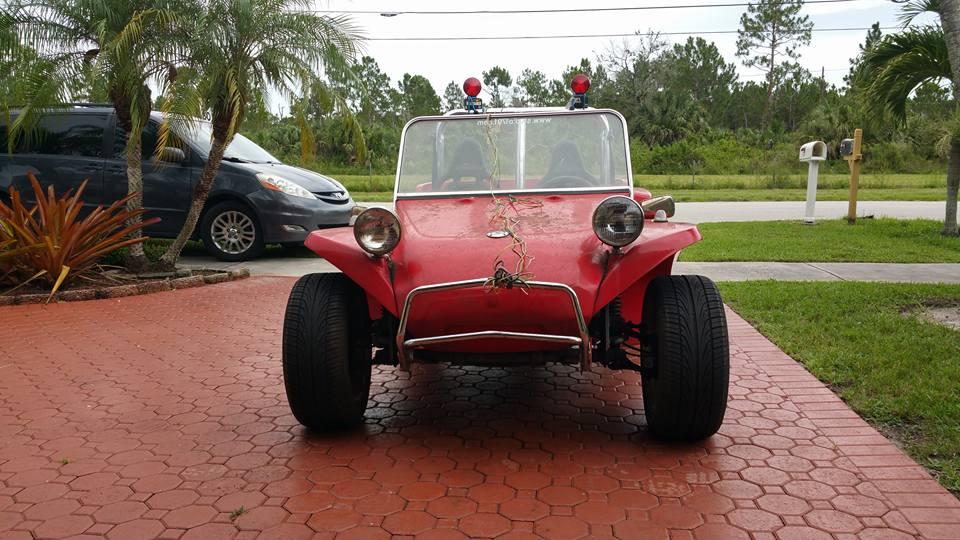

I am a glutten for punishment because the Dune Buggy looked great just sitting there but when i got it home it was going to prove an expensive flip because the motor had sucked in so much rain water that it was everywhere... wait to you see the pics.. but here is the preliminary photo of what i saw but in the pages to follow you can follow my journey to the point of no return Laughing

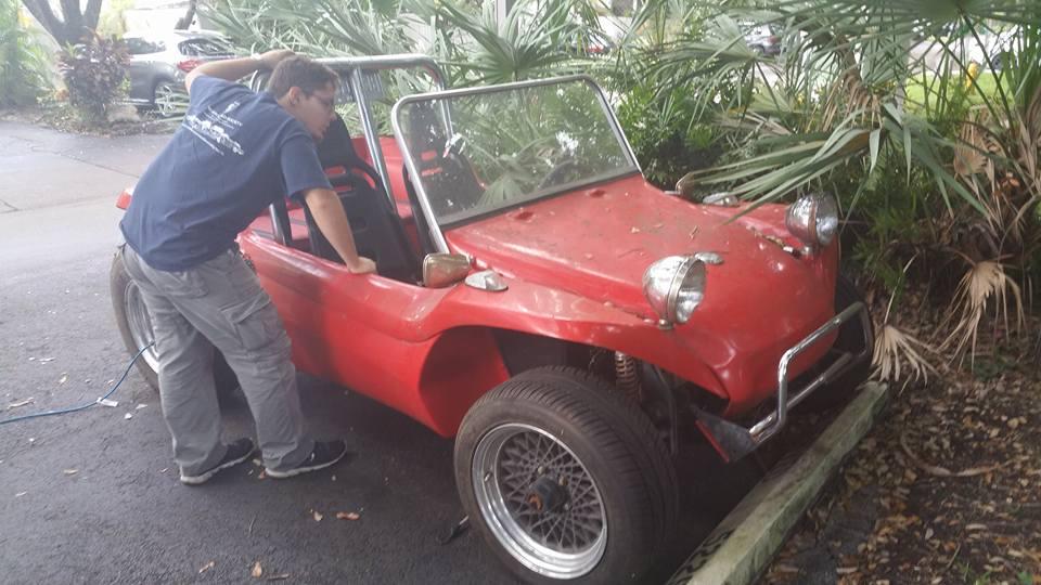

This is Frank "Volks Medic" a mobile vw mechanic...
This is what it looked like underneath the tarp
It took about 4 weeks to finally negotiate it from almost 3k to $1,800
Ready to be towed home
My '64 Pan Meyers Manx Dune Buggy "Lady in Red"

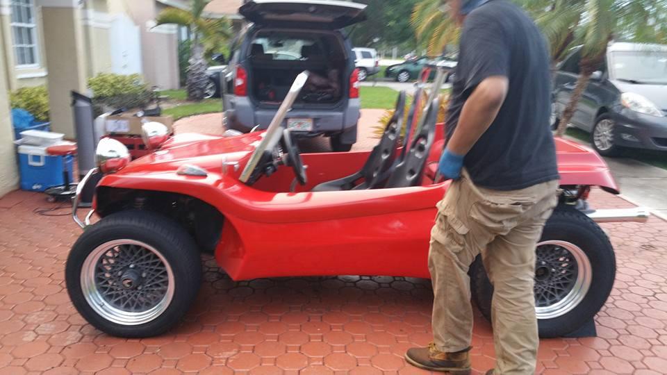

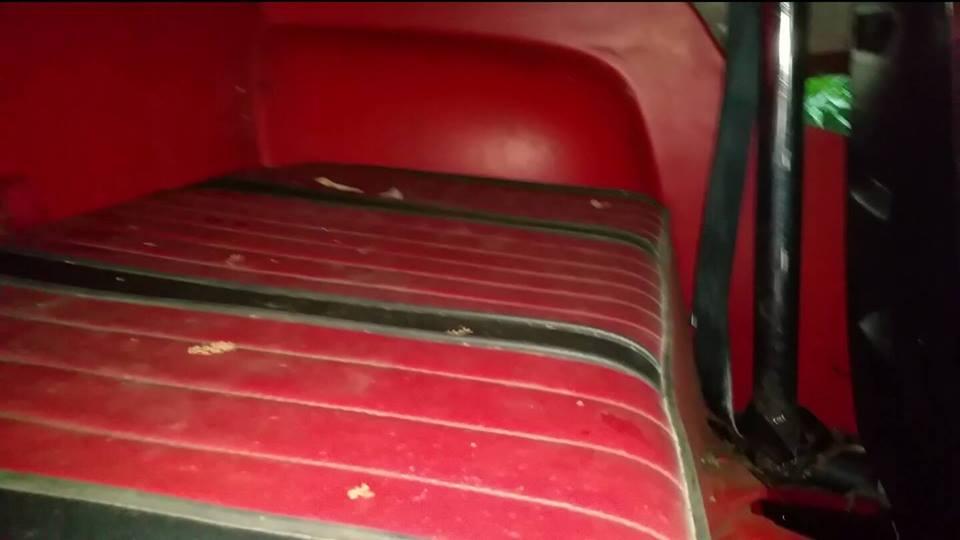

The Dune Buggy is filthy

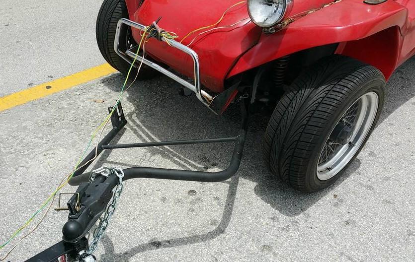

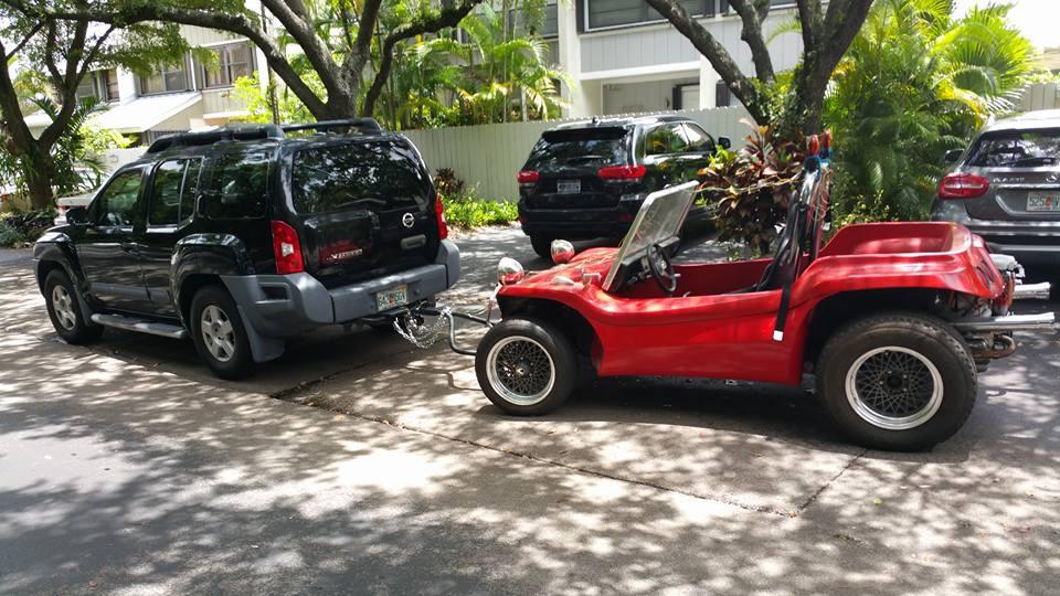

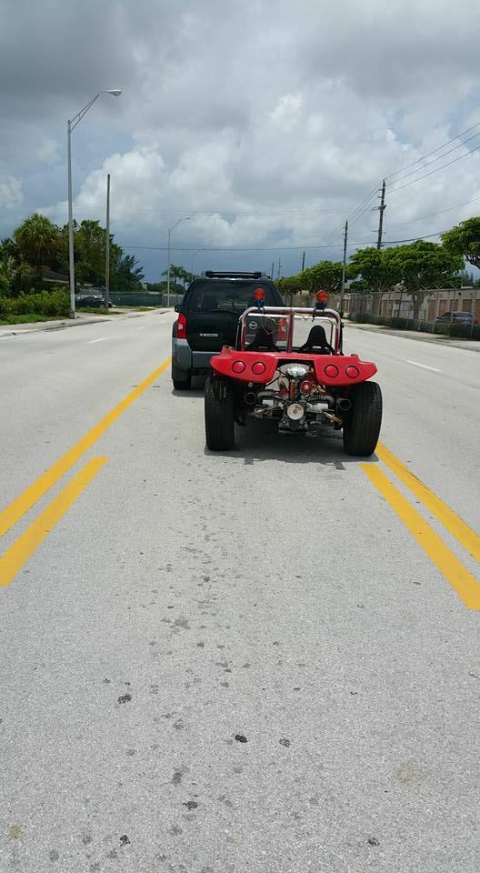

Damn cotter pin and bolt came off less than 3 blocks from where i bought it.
I am out on the road without a paddle.. I cannot leave the car here and the buggy so i had to call a friend to come sit with the cars so i can go look for the bolt and cotter pin... it was a very hot and muggy day in Miami and i was wearing a black tee shirt... HOT Sweltering HEAT !!!
I finally got her home but it took a long time because the right front wheel was locking up and smoking
All cleaned up .. debris , leaves, dirt, ant nest and vermin removed via Dry Vac... what a mess this buggy was in.. now to tackle the wheel locked

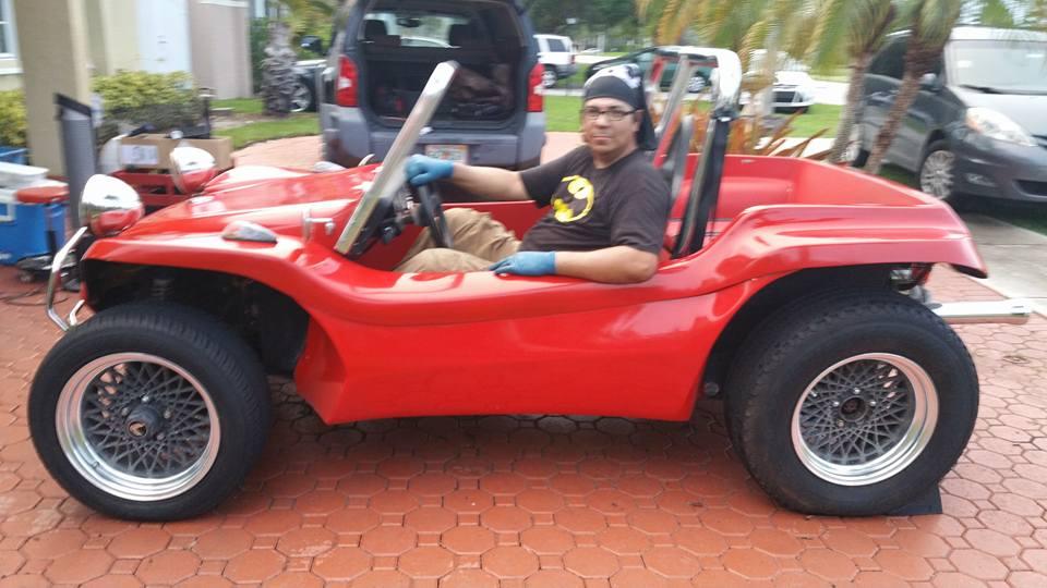

I am a big guy at 6'2" and 250 lbs.. lets see how it is getting into this
It wasn't easy but i have to get sliders under these seats.. i cannot drive it this cramped up

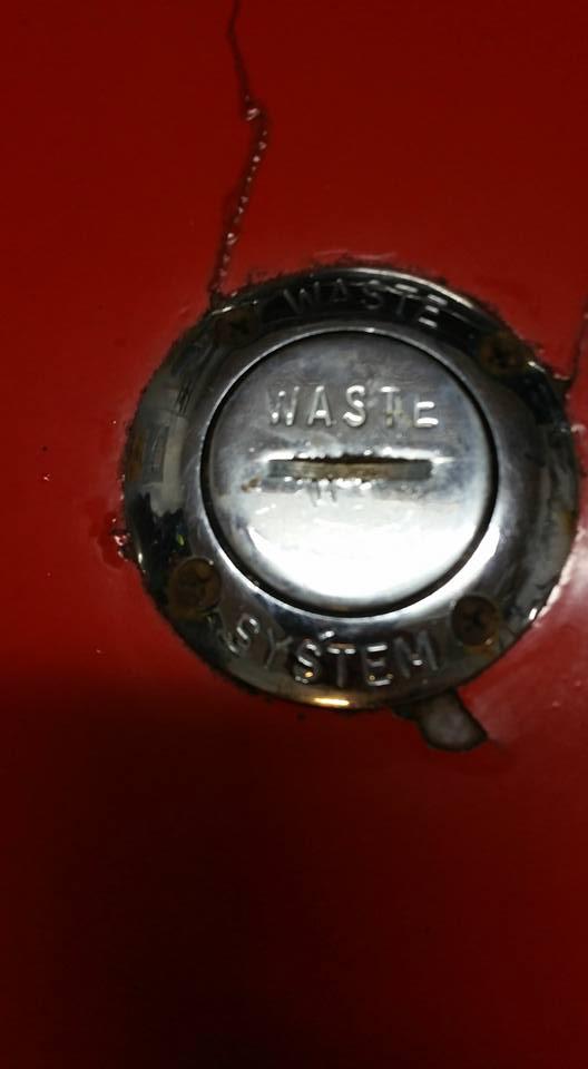

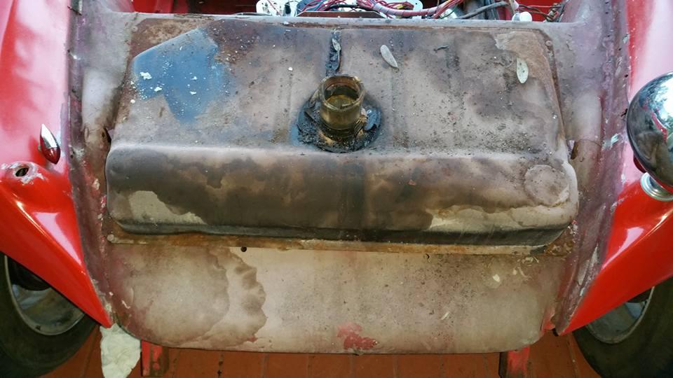

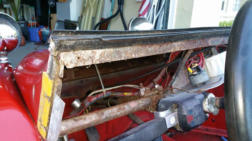

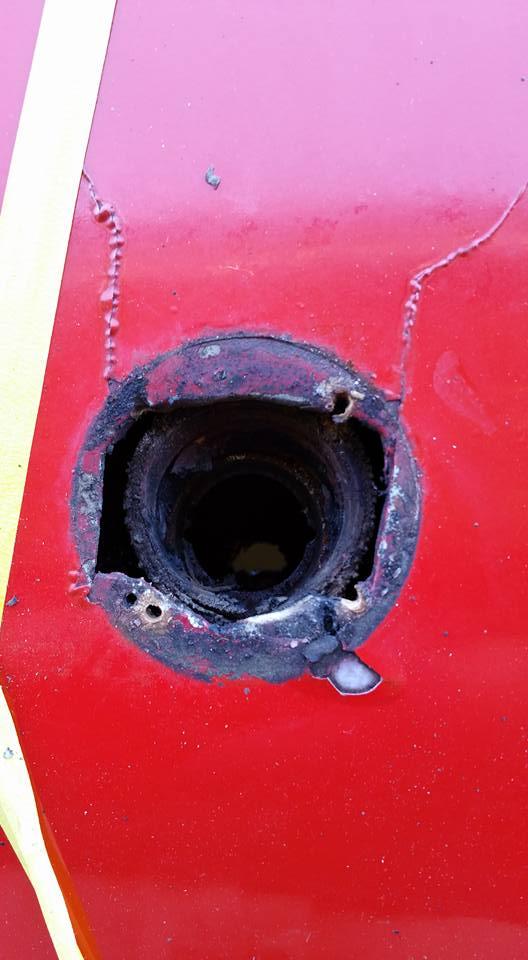

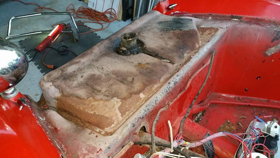

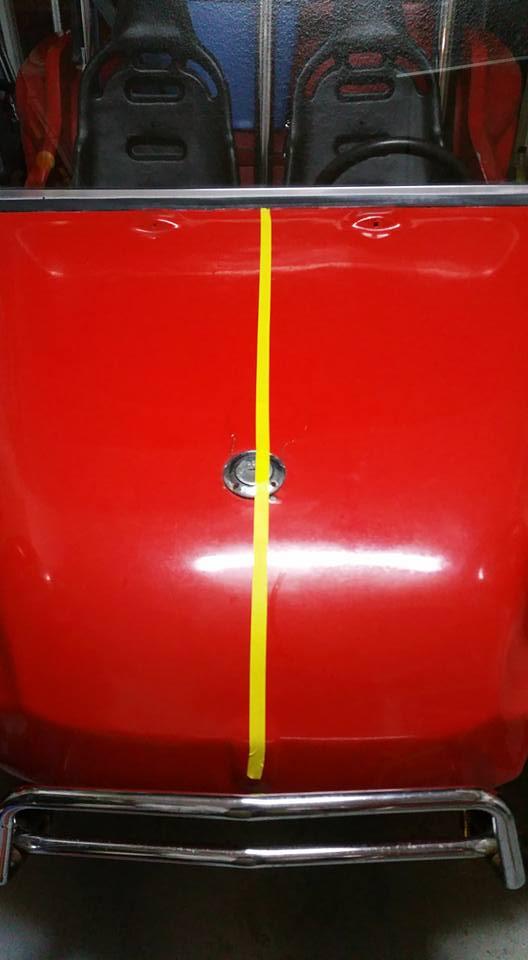

Time to remove the gas tank.. the guy who built this dune buggy used a plumbing contraption hardware as you can see by the pic.. it didnt seal well and in some future posts you will see the nightmare of water i removed from the gas tank..
Its off center.. .. what a mess
Its a good thing that i have experience working with fiberglass so i will make this better.. if you have seen my vw bug then you know what i am capable of

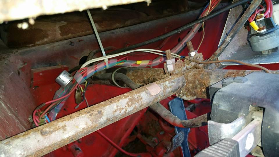

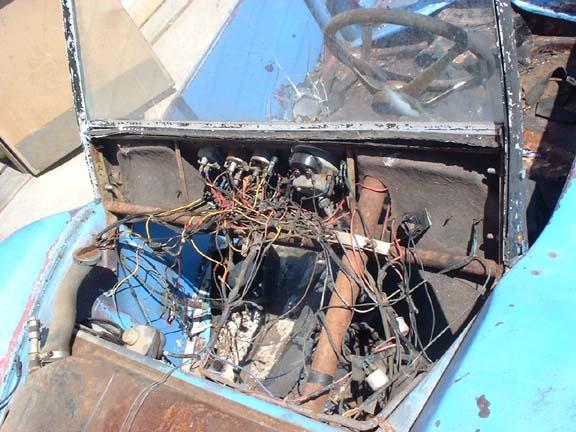

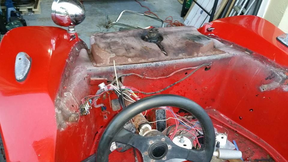

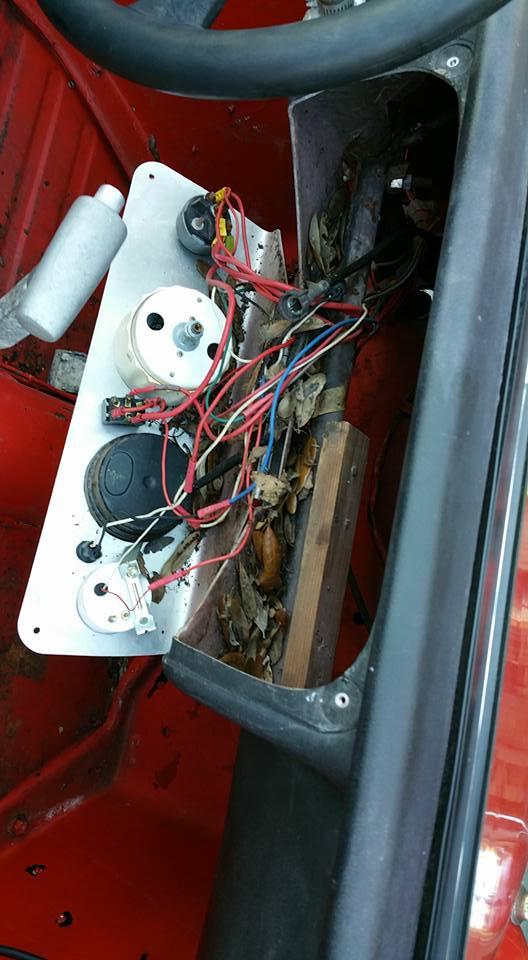

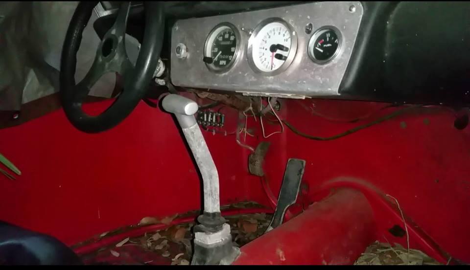

All these gauges wired up but not working..
No sending units to the wires

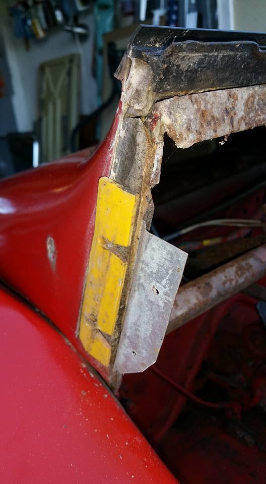

Removing the windshield
What a mess

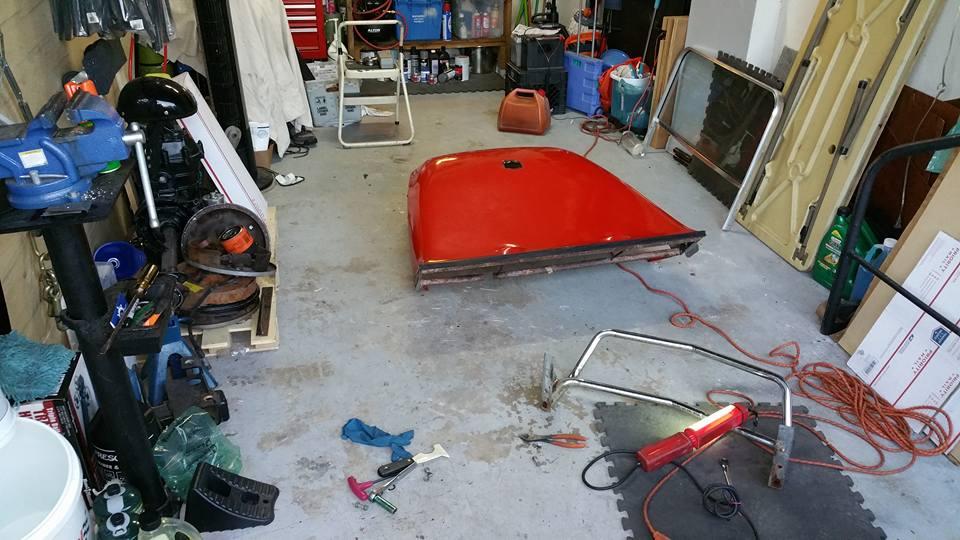

The windshield is off and so is the hood
Now to remove the gas tank
Before this it is time to siphon out the water from the tank and gas if there is any

Nice! I think you got a good deal.
Do know if it an actual Manx or a clone? Mine looks just like it but it's a clone.
Good luck buddy!!

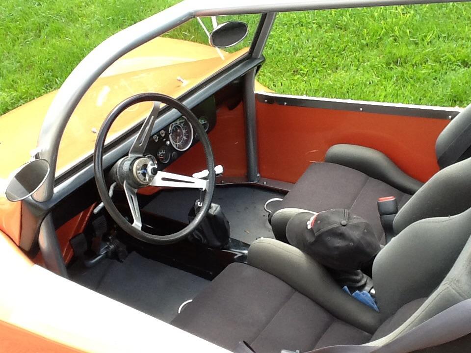

Post a pic of yours.. and if you have a pic of the steering wheel column because i want to see what i can do with mine that is rusted out.

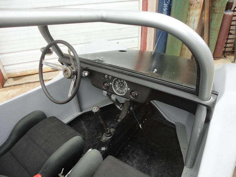

Unfortunately, I don't have many pix of the steering column. I used the whole column from a '73 Ghia. Worked great. I just filled the dash and manicured it in to fit snug. Here are a couple pix but probably not a lot of help.
I still need to find a real horn button. Smile
Best of luck!! I'll be watching your posts!

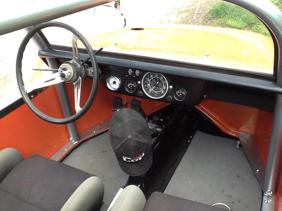

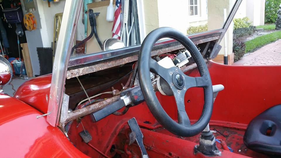

That looks like it might be a genuine Meyers Manx. The steel dash frame looks like an original one.
The dash is definitely one of the new replacements which Bruce Meyers makes now. It needs to be bonded with fiberglass to the back edge of the hood as per Bruce's instructions(figure 1).
As Bruce explains in paragraph 1., the frame actually needs to be modified for it to fit. The top crossbar and the two vertical bars need to be removed. I also filled the holes previously drilled in the two vertical side bars and redrilled them. The sheetmetal tabs he put on there definitely won't do. The bolts which mount the windshield frame should be right on the seam between the dash and the hood.
Your steering column installation was designed by the builder. Bruce originally had the column mounted on top of the cross bar

This thread by Vince shows how to properly bond the dash to the hood
http://www.thesamba.com/vw/forum/viewtopic.php?t=588675
Actually you should check out all Vince's threads first if you're going to do any fiberglass work

Judging by the pictures you need a new wiring harness badly. If you want something simple(not a bunch of extra gauges, etc.), which uses VW switches, is easy to install and high quality, you can't do better than this one which is made in Florida
http://www.ebay.com/itm/VW-Dune-buggy-Wiring-harne...2040232386

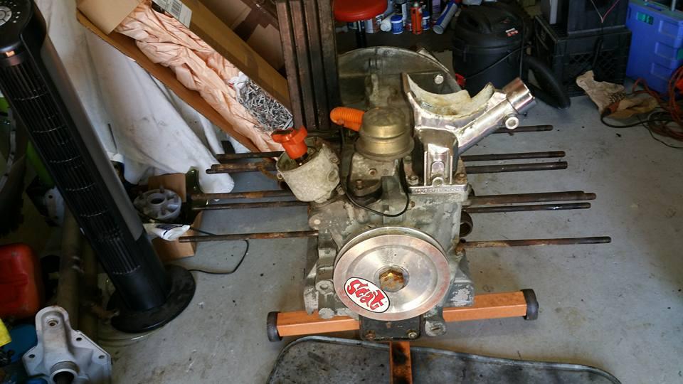

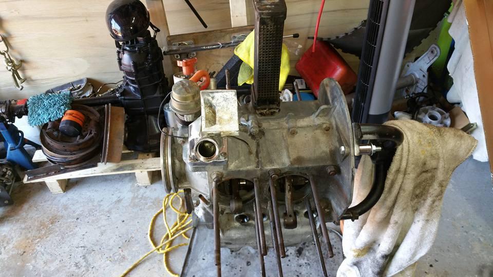

PostPosted: Sat Jul 16, 2016 10:49 pm    Post subject: Re: My first Manx type Dune Buggy... a Deal of a Lifetime.. Reply with quote

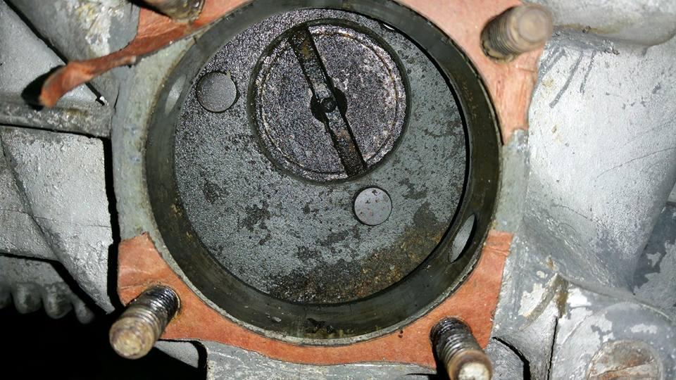

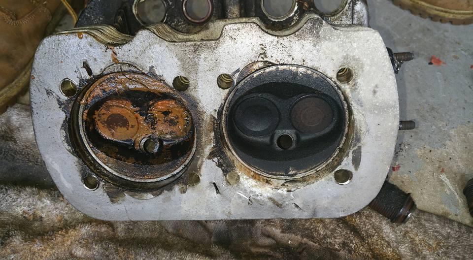

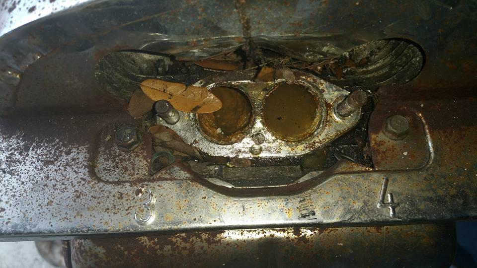

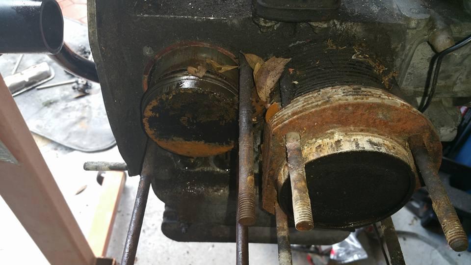

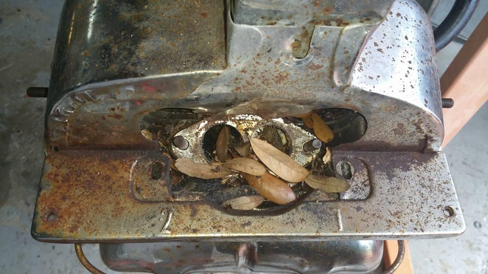

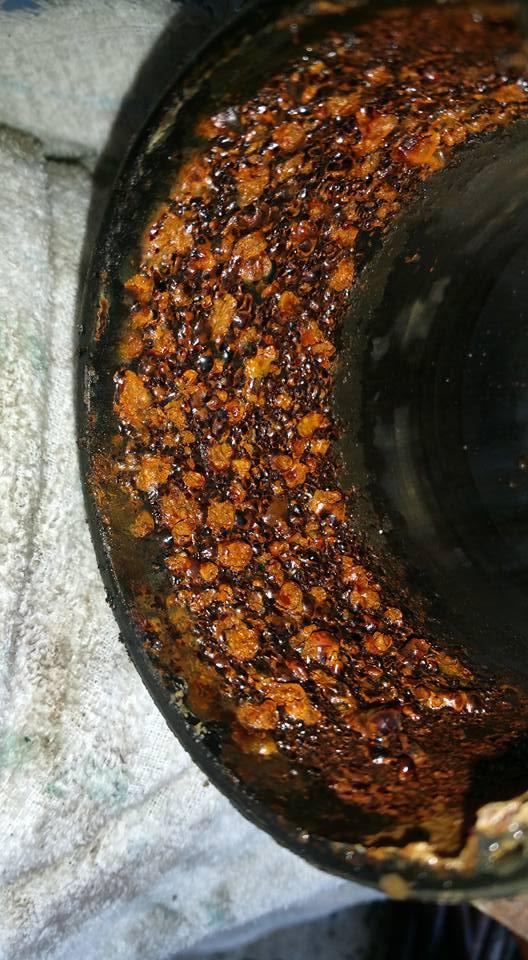

Time to tear down the motor .. get ready for some graphic images.. not for the faint of heart.
Water in the intake ports of head.
Some of the cylinders were so badly rusted that they only came out with the heads after some hitting with rugged rubber mallet.

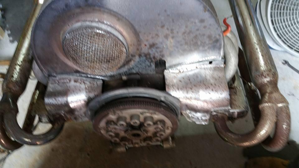

Continue tearing apart the motor
Removed the oil pump
No wonder the motor wouldn't turn over.. water got in everywhere
