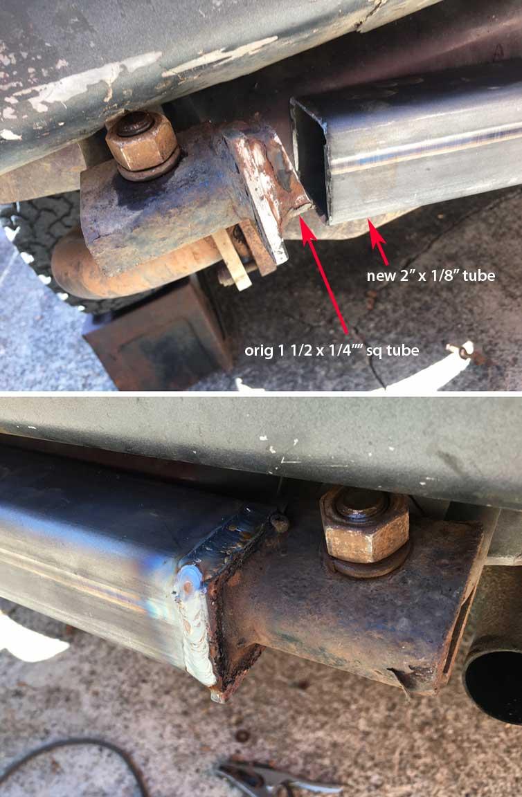

Built this hitch to be able to carry a motorcycle. I've been using a similar setup for many years. It was adapted from a '72 loaf, then to my '85 Westy, then to the current Syncro. I decided to change it over to a standard 2" receiver attachment and clean things up a little.
I cut off/re-used the original mounts to the towstrap loops but the rest is new. The supports are welded at top, and the torque of the receiver goes forward (bolted) to the Syncro underbars. It's ideal for a Syncro. On a 2wd the moustache bar can take some of the load, but it's not ideal. To add bracing to the moustache bar on a 2wd is feasible.
Here's pics, hope it helps others if planning to build a hitch.

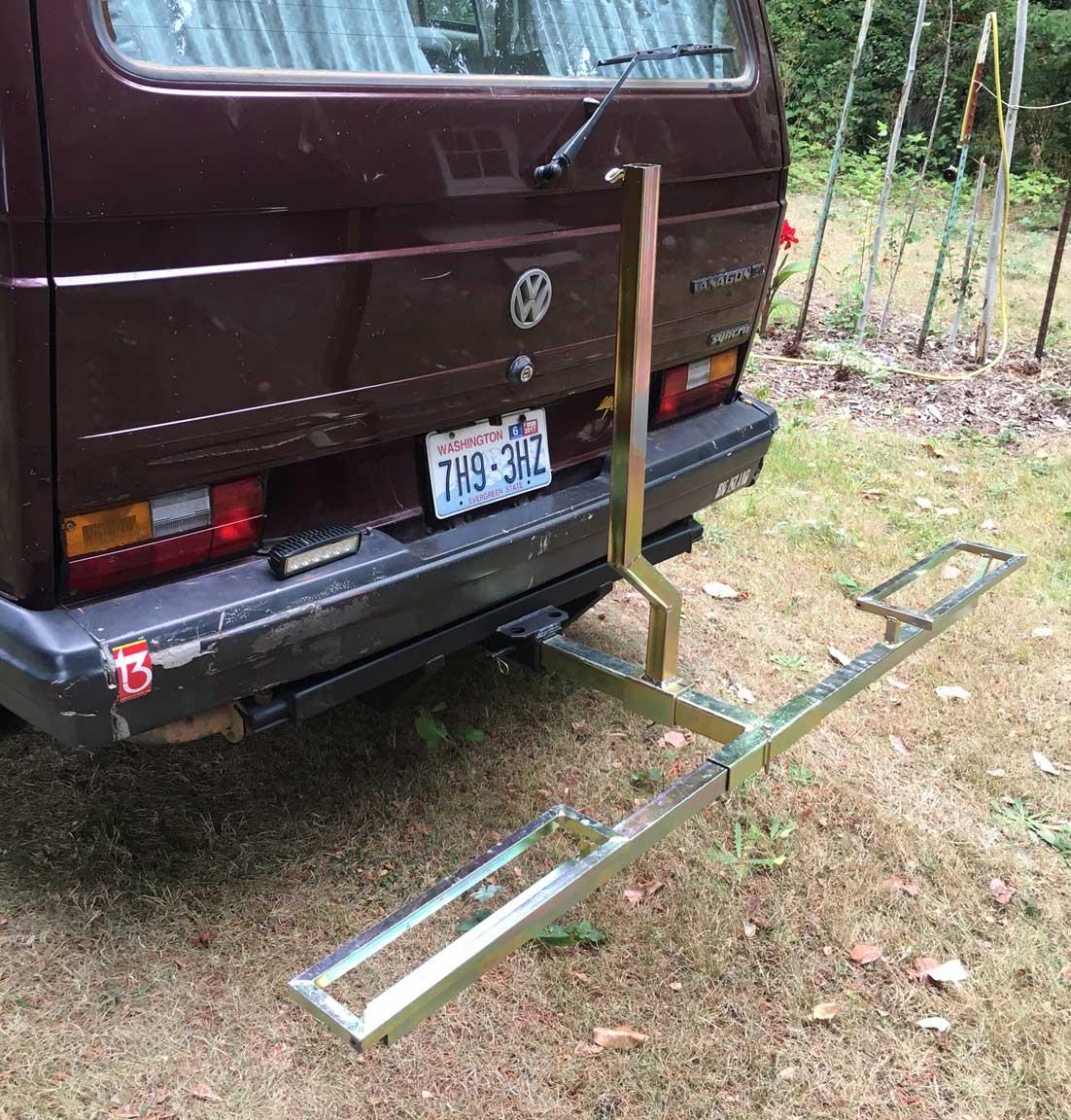

Jim I'll move all the mounting monkeybusiness over to the motorcycle carrier, and find another way to steady the rocking. Was tired of looking at the "rack receptacles" on the van. I had several needs piling up:
    - wanted the van to look clean
    - want to use a "receiver-hitch cargo shelf" to get some stuff OUT of the van when travelling
    - we have a bicycle carrier that uses a 2" receiver
    - other projects
Such as this trials bike carrier design I've been goofing around with lately. A "trials motorcycle" weighs only 160 lbs, 80lbs per wheel. This lightweight carrier collapses into a fabric bag. I had a 'zinc plating project' a few months ago and getting this plated was sorta "free" so I included it. Problem is I can't make any more modifications dangit.
Currently I wrap a towel around that vertical bar and the bike ties to that, it's very secure. But that part needs further developement because it looks like a towel wrapped around a bar.
Three of the parts fit in this nylon bag. Need a slightly larger bag.

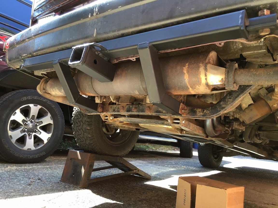

The last example of the hitch receiver is without a doubt beefier than the others.
It's welded to a steel channel bumper.
No waving at traffic behind you.
The first example on the syncro is well thought out, and executed really nice, two "buts"
It's too close to the muffler, it's gotta hit as the engine rocks on the mounts, ya need some more gapation there, that 1.5" or 1.25" ( just eye balling it ) tubing is pretty thin walled to be doing any serious towing hooked to the drawbar.
I see it's bolted to the bottom of the bumper for less chance of rolling on the bottom mounts, perhaps heavier wall tubing would take a beating better.
I have a South African trailer hitch on my westfalia, I think a frame mounted setup doesn't allow much flex, regardless what you stuff into and on the receiver.
Even though a small notch has to be cut into the bottom of the bumper to accept the hitch assembly.
T.K.

Dave you are thinking of this? (BenPlace)
I will have to do something to prevent the rocking. Not sure yet what to do but will figure something out. Maybe a chain at an angle from that vertical support. I want the whole thing to be compact, packable. I also have a webbing loop tied around the hinge, it comes out of the rear hatch upper gap.
Terry you've forgotten there is no torque between a VW engine and the rear end. It's bolted solid, zero motion (a transaxle). The whole thing shakes maybe 1/4" max, maybe 1/8". And no "serious towing" is allowed, this is for a little trailer, or sports eqpt (....wicked sprts eqpt).

While a couple of these hitches look to be well thought out, and mounted nice, I thing a guy should do all he can do to get to the frame rails, and tag any hitch to them--
Other that the Syncro--most all of them are using the tow loops as the primary platform,the main mounting point for the class 2 hitch receiver.
The receiver is stout--the mounting hanging point isn't so stout.
The primary load bearing point is the tow loops, along with engine carrier.
That's all I'm saying about that right now.

PostPosted: Sun Aug 28, 2016 11:51 am    Post subject: Re: Built a 2" receiver trailer hitch Reply with quote
Terry Kay wrote:
Nice picture. Of what?
Folks are discussing ways to lessen the twisting of the carrier in the 2" receiver which has some slop for ease of insertion.
This is a pic the clamp arrangement on the HarborFreight motorcycle carrier. You insert into the receiver, then that clamp grips the outside square of the receiver and reduces the rocking significantly.

PostPosted: Sun Aug 28, 2016 12:12 pm    Post subject: Re: Built a 2" receiver trailer hitch Reply with quote
Here's my 1.25" hitch that I made from a tow ball type bar. I plan on emulating your forward stabilizing arms that will tie in with the engine crossbar, but just set a few inches more forward on the van for my TDI install. These stabilizers will also serve as bridge pieces for a steel skid plate to protect the fragile aluminum Passat pan.

PostPosted: Sun Aug 28, 2016 1:17 pm    Post subject: Re: Built a 2" receiver trailer hitch Reply with quote
Casey that's nice. I don't like the way my hitch hides a painted body panel when there's empty space above behind the bumper. hmmmmmm. That method could almost be a bolt-on unit, just drilling some holes in the bumper bracket, and clamp to the moustache bar. But moustache bars are all over the place, with various engines, so in general it's still a custom unit for each van.

PostPosted: Sun Aug 28, 2016 5:08 pm    Post subject: Re: Built a 2" receiver trailer hitch Reply with quote
Those older tow ball type bars were indeed designed to bolt between the bumper mounts, and I think it'd be pretty easy to modify your hitch to tuck up there in a similar manner. It has threaded inserts at the end of the bar, and is through-bolted on the flange. I welded that one up about a decade ago. It's been great, but it did allow a lot of sway when loaded up with four bikes. I've always wanted to add some bracing to help eliminate that issue. I intend to make the braces a bolt-on thing, so I can remove them should I need to service a muffler or access the timing belt from below.
