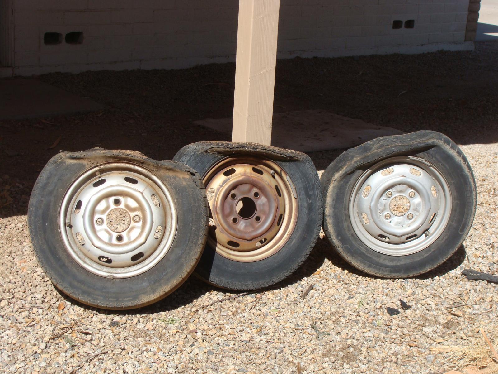

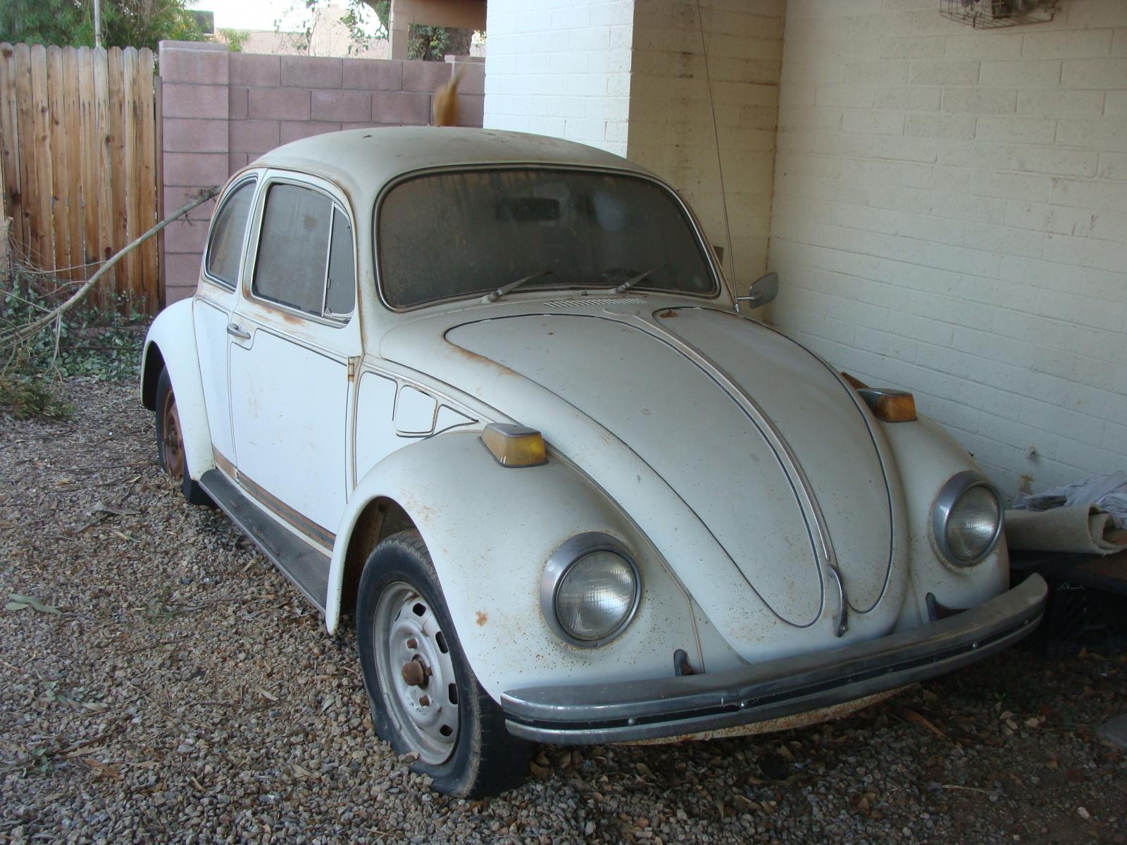

This will document the resurrection of my 1970 VW which I bought in November 1972 with about 40K miles from original owner, the newest vehicle I've ever had.
This got its 1835cc DP engine in Oct. 1976 because I wanted more power and update to dual port heads. This 1970 was my daily driver until 1993 when with 260K and with 2 kids I felt it was time to retire it to save about $500 insurance costs per year (drove it into my backyard for its retirement party; everyone brought their VW stories).
Now that I'm now retired, it's time to get this running again. The tires were only flat on the bottom.
Its 1835cc engine had been swapped into my 1971 Convertible a decade ago. Anyway, grabbed the spare from my 1971 and mounted that, pumped some air into some others, attached my tow bar, and moved it for the first time in 23 years. Only the left rear wheel was stuck, freed that up with impact wrench and 36mm socket.
This engine is in it right now, the original 1971 engine from my Convertible: the engine we drove for 4 more years after the oil stud vanished in 2003 and Mrs. Cusser kept driving without any oil. This should make an interesting autopsy, hope engine case is OK to re-use, as matching number for the 1971 and never has been apart yet.
So got this into my driveway today; work will progress over several months as I'm older now, and it's still in 90s temperature-wise. I'll need all-new brake hydraulics and flex lines, new battery, will rebuild the engine (likely to stock 1600cc), will rebuild fuel pump (which was from the 1835 engine but leaked when swapped in a decade ago), generator and carburetor condition were OK 23 years ago, big question mark today. I'll need a pressure plate with center ring, as I removed the center ring to swap the 1835 engine into the 1971 a decade ago. I'll need new tires, new gland nut, and likely a host of other parts.
Next step is either to pull the engine or to pull the drums to see if I need new brake shoes in addition to the wheel cylinders and master cylinders; likely will just do new, as not expensive and will need to remove the shoes anyway to add new wheel cylinders.
