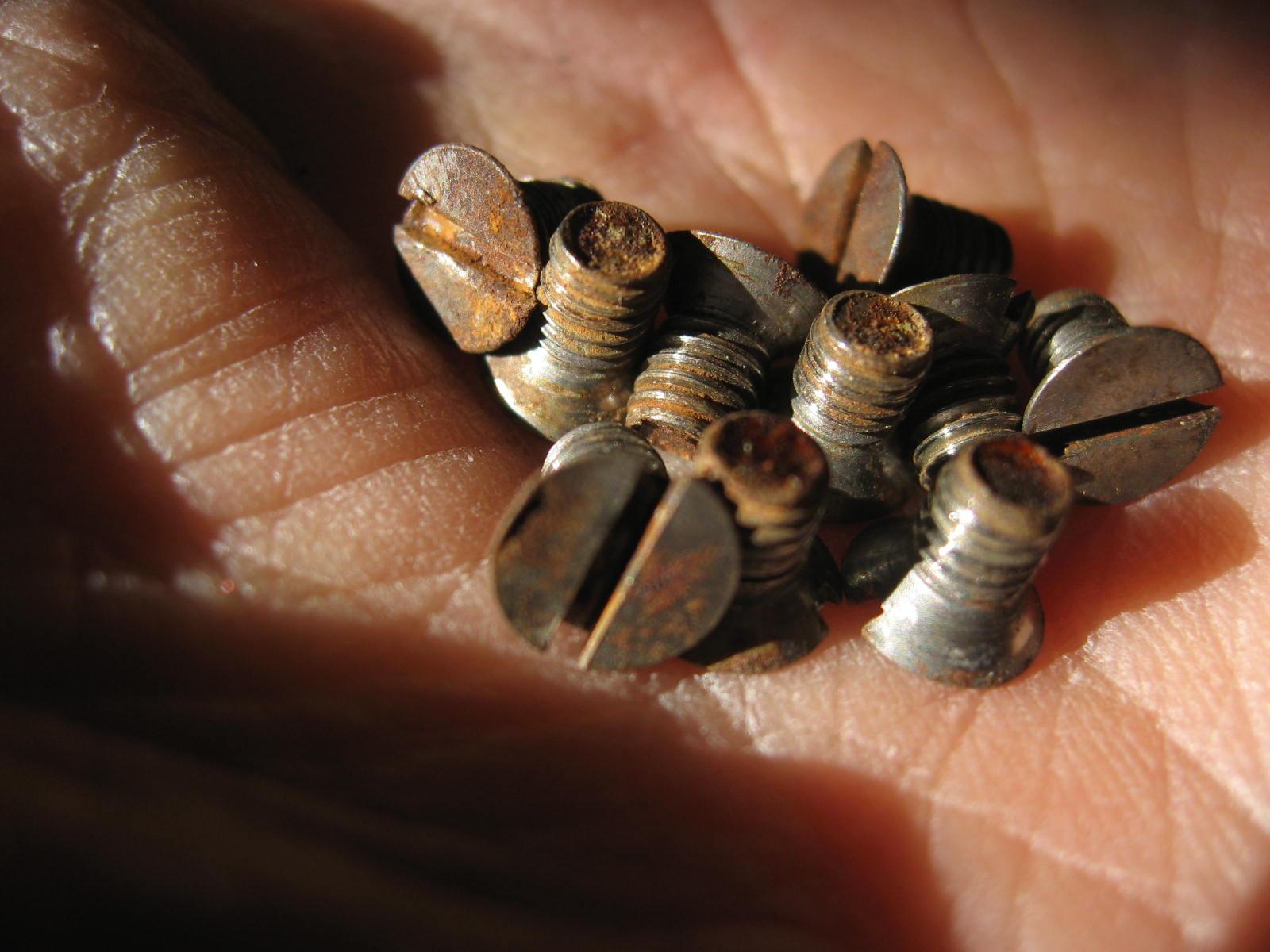

BRANDEN HOY wrote:
1. Are the 5 pop out to hinge screws to be painted frame color or are they zinc?
This doesn't prove anything about other years' but these are original '65 and '67 examples. These are bare steel. Part #28 here doesn't say. http://oacdp.org/5867part/455.png

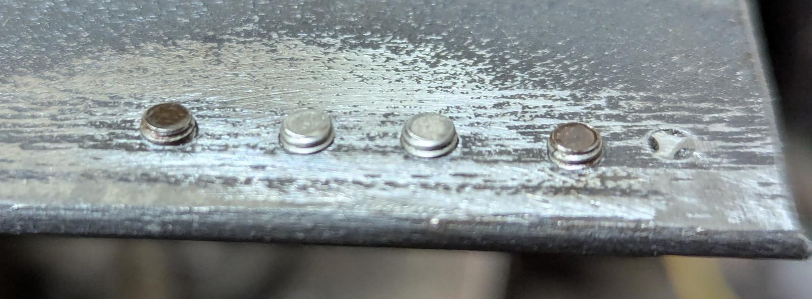

Those screws are 1mm too long, but probably as close as you will get. I ground mine down to the right length.
Drilled a hole and taped it with M3.5 treads into a flat bar with the right thickness. Screwed the screws into it and the ground down what was sticking out.

PostPosted: Yesterday 9:06 am    Post subject: Re: Pop Out screw questions Reply with quote
The weird-looking one is a cheap Chinese tap that snapped off in the hole.
