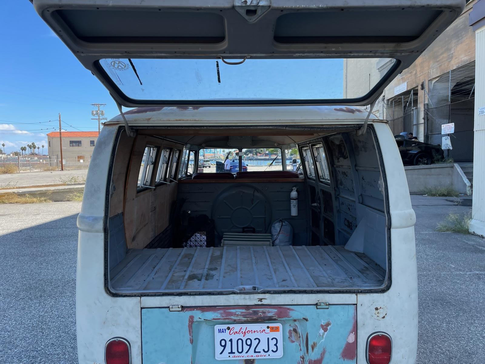

The rear interior was bare, save a few deteriorated wood panels on the driver's side and headliner. Originally a panel van, I believe it was converted into a Sundial camper early in its life, judging by the windows and awning mounting strip on the roof, but someone more familiar with the details might be able to disprove that hunch. I do find it odd that there are no upper vents near the roof in the rear.
As camping and day trips are our goal with the bus, I've already started the work of building up the interior. Next I'll get this thread up to speed with my current progress.

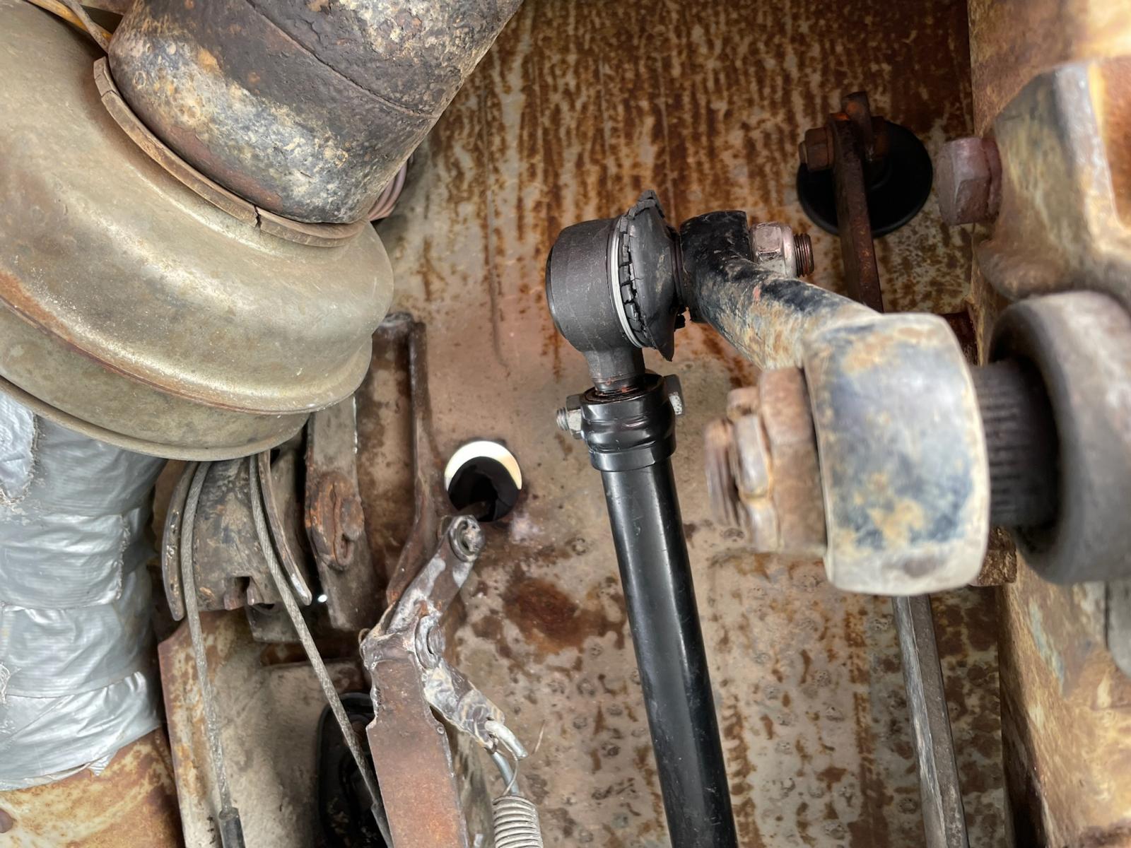

Throughout all of 2023 and most of 2024 the bus was basically on the back burner while other projects took priority. The time I did spend with the bus was focused on sorting out some lingering mechanical issues and making it really road-worthy.
There was about 90 degrees of input play in the steering. Fortunately the steering box itself was in good shape, and everything else was to blame. It's now got a completely rebuilt beam (thanks to A&D Buggies in Torrance, CA) under the front end and all tie rods, drag link, and shock absorbers replaced.
Has anyone in a salty coastal environment found really durable brake master cylinder and tie rod boots? I've already had to replace them due to cracking twice in 2 years/2,000 miles. The most recent ones were warrantied out by WW, but obviously I'd prefer to avoid taking the whole thing apart to replace the rubber stuff every other year…

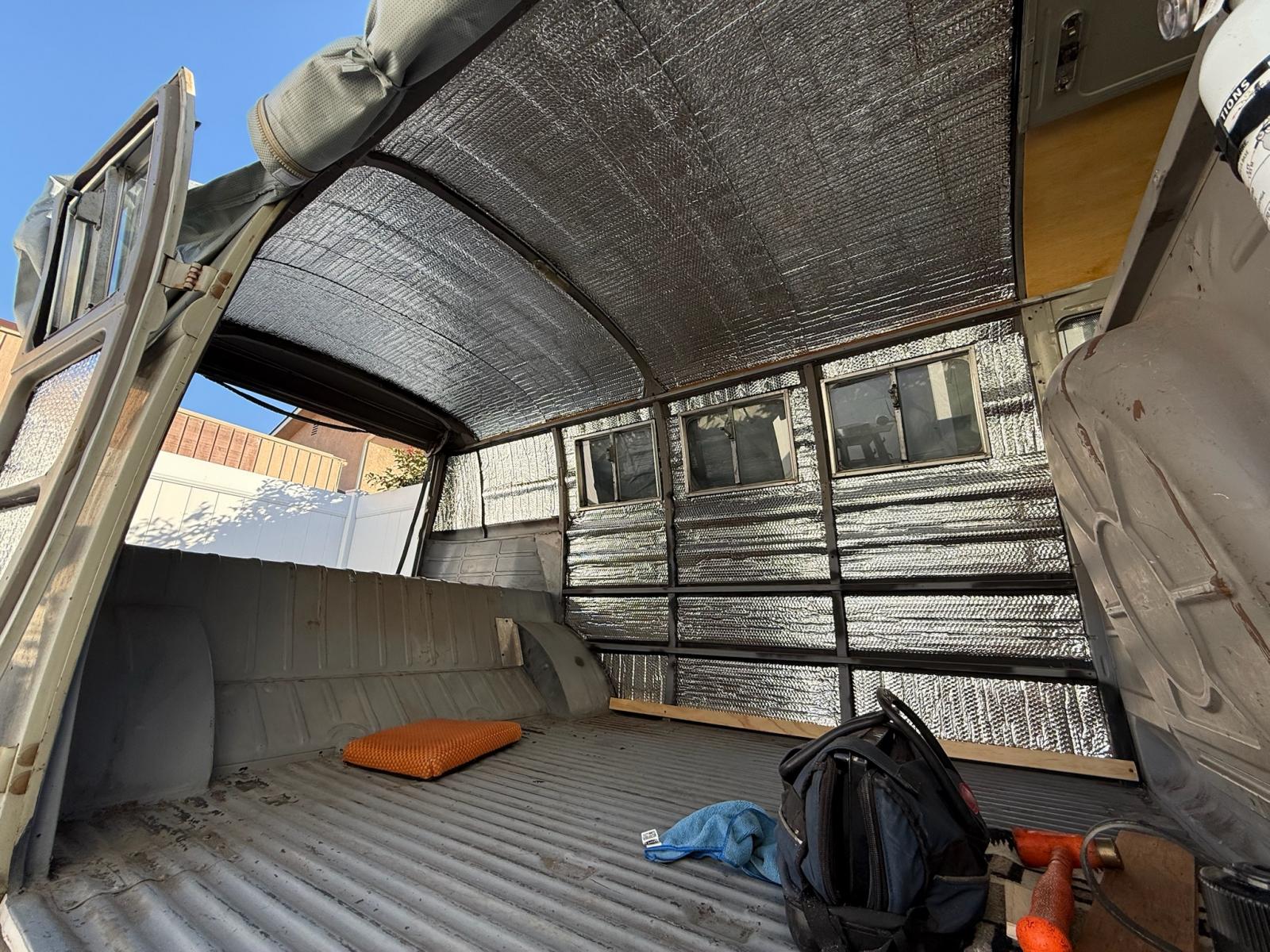

Since September 2024, I've finally been able to spend full weekends on the bus here and there. I don't know about y'all but I have a tough time making progress an hour or two at a time.

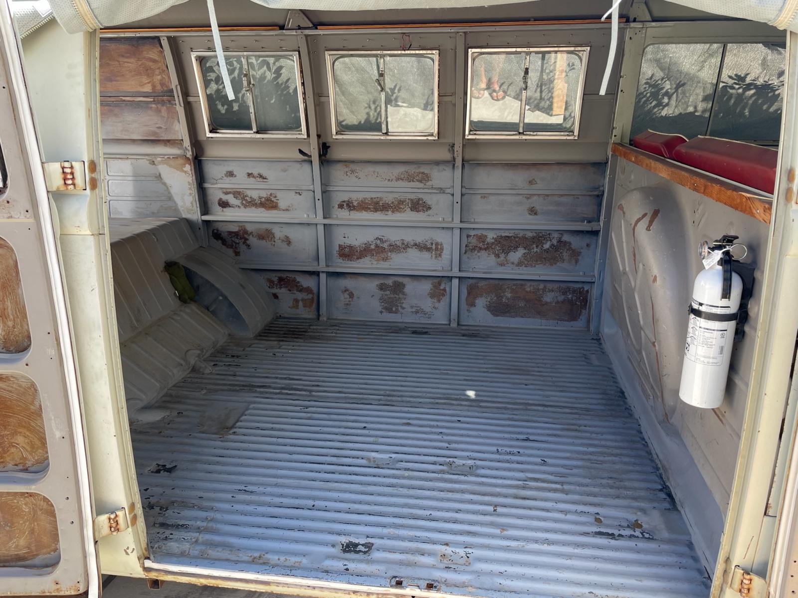

I stripped out what was left of the old interior. Essentially just the wood headliner, large driver's side wall, back corners, and head banger. Luckily there wasn't anything too alarming hiding behind. Only bits of foam insulation left hanging from the roof that had trapped some moisture and started to cause surface rust, though most of the brown splotches you can see all over the inside is just old glue.
For the time being, I'm really focused on getting this project to a state where I can start enjoying it, which means having a place to sit and sleep. The dog and I are happy to sleep on the cargo floor, but it'll take a few more creature comforts to convince my partner!
Pic from the 2024 Silverado Campout:

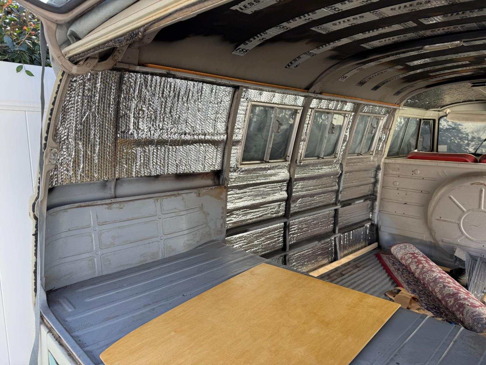

At some point I may strip everything down to bare metal and repaint the entire interior, but for now I sanded back just the areas of surface rust and coated with Rustoleum Rust Reformer. It's not pretty, but should at least stop the situation from getting worse in the meantime.
I'm under no illusion that this thing is ever going to be quiet but figured a bit of sound deadening and thermal insulation on the large panels couldn't hurt. I read tons of posts here and on other restoration forums and took the sound advice to steer clear of anything that could trap moisture. I covered 15-20% of the large sheet metal panels in tar/foil sheets, which made a huge improvement in the general "tin can" experience riding down the road. The bubble wrap thermal insulation is covering as much of the walls and roof as possible.

Regarding the rubber boot they are counting on you having a splash pan.

Ah yes! The rubber components with all the rubber taken out!
I changed all my shift rod boots - the originals lasted 50 years, the replacements 5 months.... Rolling Eyes
You know, I hadn't really thought much of the missing splash pan. But it's certainly not helping that they're dangling out in the open like that. Another thing added to the to-do list!

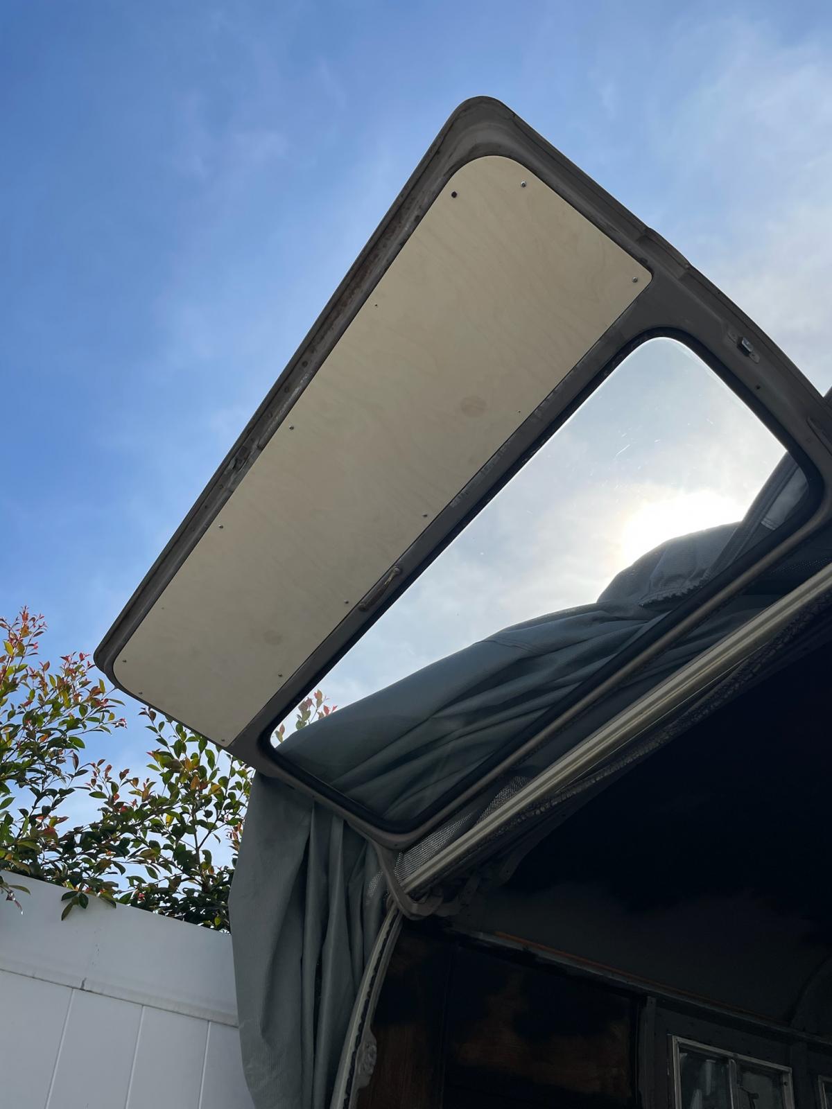

PostPosted: Wed Feb 26, 2025 6:22 pm    Post subject: Re: 1965 Mild Custom Camper From Scratch Reply with quote

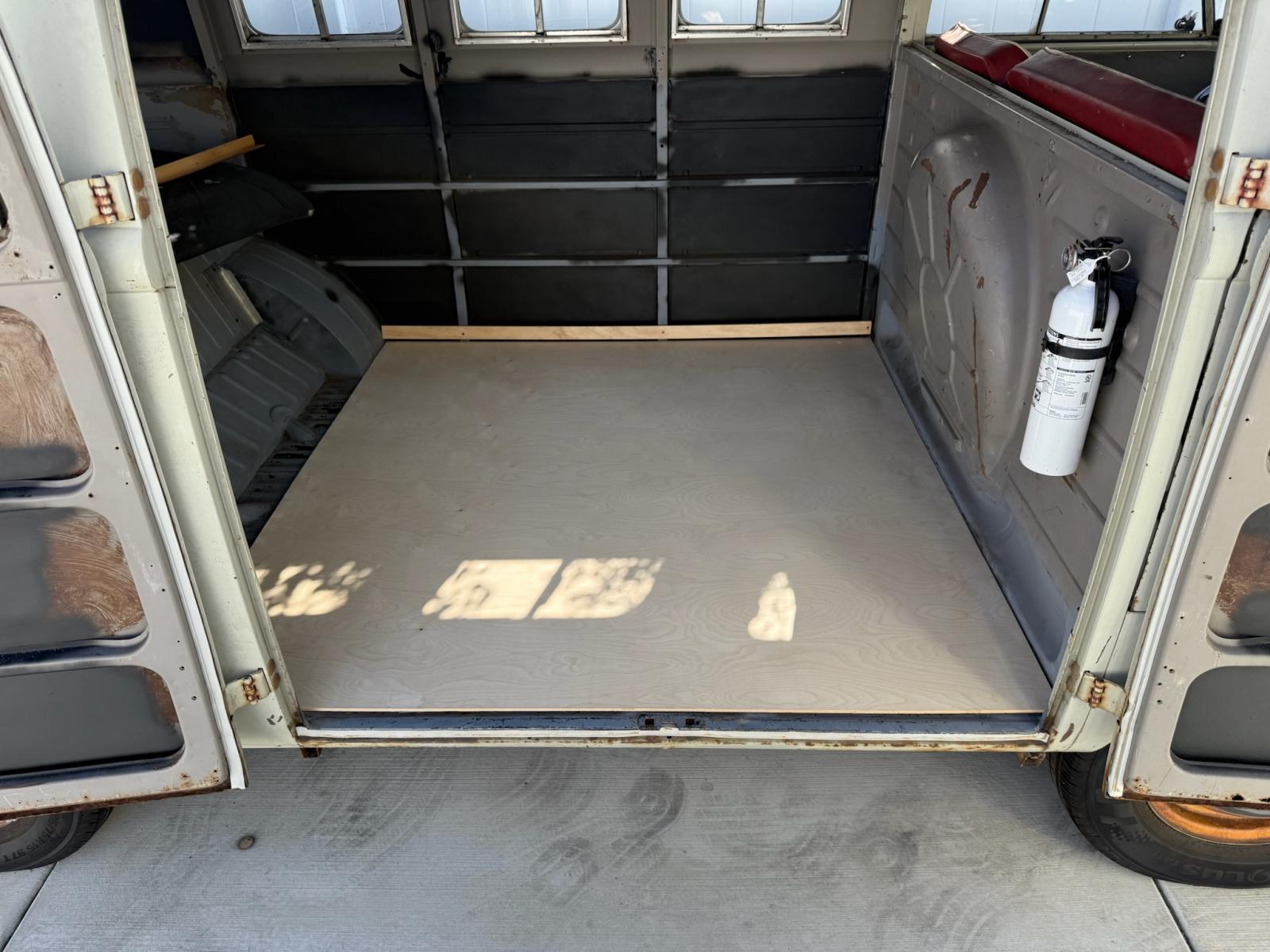

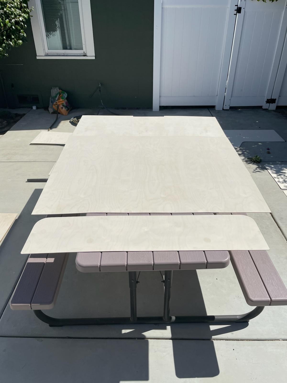

Considering the cost of good quality birch plywood and the templates I'd have to create for the missing panels, it was a no-brainer to buy the walls, doors, and headliner panels CNC cut from OC Westy in Orange, CA. As they were made to order, I was able to get exactly the parts I wanted, unfinished and without the windows cut. That way I could be certain that they were in the right places and choose the color and type of finish I wanted.
Aside from cutting the windows, I had to make very few modifications to the panels. Ed really has his templates dialed in.
To source the 1/4" floor and 1/8" plywood to cut the panel joining strips, my neighbor tipped me off to a fantastic local lumber yard that carries 5'x5' Birch plywood - Hudson & West in Torrance, CA. They carry a wide range of plywood, hardwoods, tools, hardware, and best of all - KNOWLEDGE.
As others have noted, by using a 5'x5' sheet for the floor I only had to trim 1" off one side, and the gap at the rear will be covered by the bench seat.

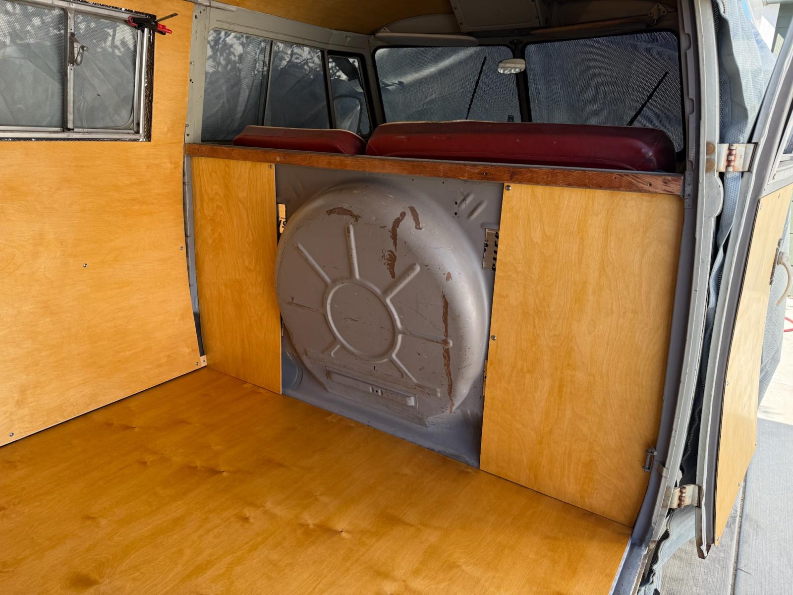

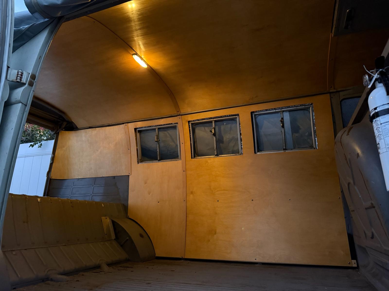

I really like the warm glow of the woodwork in sgellis's 64 camper and decided to use amber shellac as well. Everyone seems to say that shellac is "foolproof" to apply. But I disagree... Either I'm a rare breed of fool, or my expectations were too high, because I really struggled to get a result I was happy with on such large birch panels. After 10+ samples of varying cuts of denatured alcohol, coats, brushes, and techniques, I finally landed on a process. Three light coats of Zinsser Amber Shellac, cut 1:1 with denatured alcohol, applied with a cloth, and sanded with 400 grit between each coat gives everything a really nice honey color and satin sheen without completely obliterating the grain. I coated the backside of all the panels with polyurethane for a bit of additional moisture resistance.
Having fitted all the panels, I disassembled it all again to spend a few days shellacking.
And reinstalling.
So far I'm very happy with the color, fit and finish of the paneling. The panel surrounding the rear window on the driver's side looks a different color in photos, but it's really just because the grain is running the opposite direction. They look much more consistent in person. I'll probably wait to make the strips around the top of the wall/below the headliner until I've planned out my new headbanger shelf and rear cabinet dimensions.
Which brings this thread up to date with my current progress. I'll be updating as I work from this point onward.
There are places like this that have the ATE parts. Their boot is pretty long lasting.
