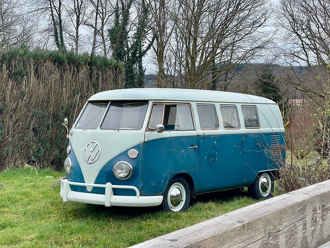

just before xmas we receive a 65 walk through ... our first split-screen bus.
this a 11 windows passenger bus ... the mplate indicate that it was deliver to L.A , and i know it was in idaho for several years.. after the bus shipped to uk , had some work to go back on the road , and a samba member take it to the isle of wight. 10 years after , i buy it and the bus is now in France ( next to Switzerland and Germany border )
fun fact : when you look at technical section of the samba for color scheme , this is our bus on photo for example ( the 3th photo link )
idaho license plate slogan is " the world famous potatoes " , my region is know as the " high potatoes " Smile

Very cool.
What part of Idaho did it live? Idaho is a large state, the size of Germany, but mostly forests and deserts. It is a good place for Buses. The climate is very dry.

That is a great picture! Very Happy
These buses love to work and drive. Enjoy.
i don't know where it was ... not a lot or rust also ... so yes maybe in dry part of idaho
i just drive it for few miles , winter is here and it need a little work Smile

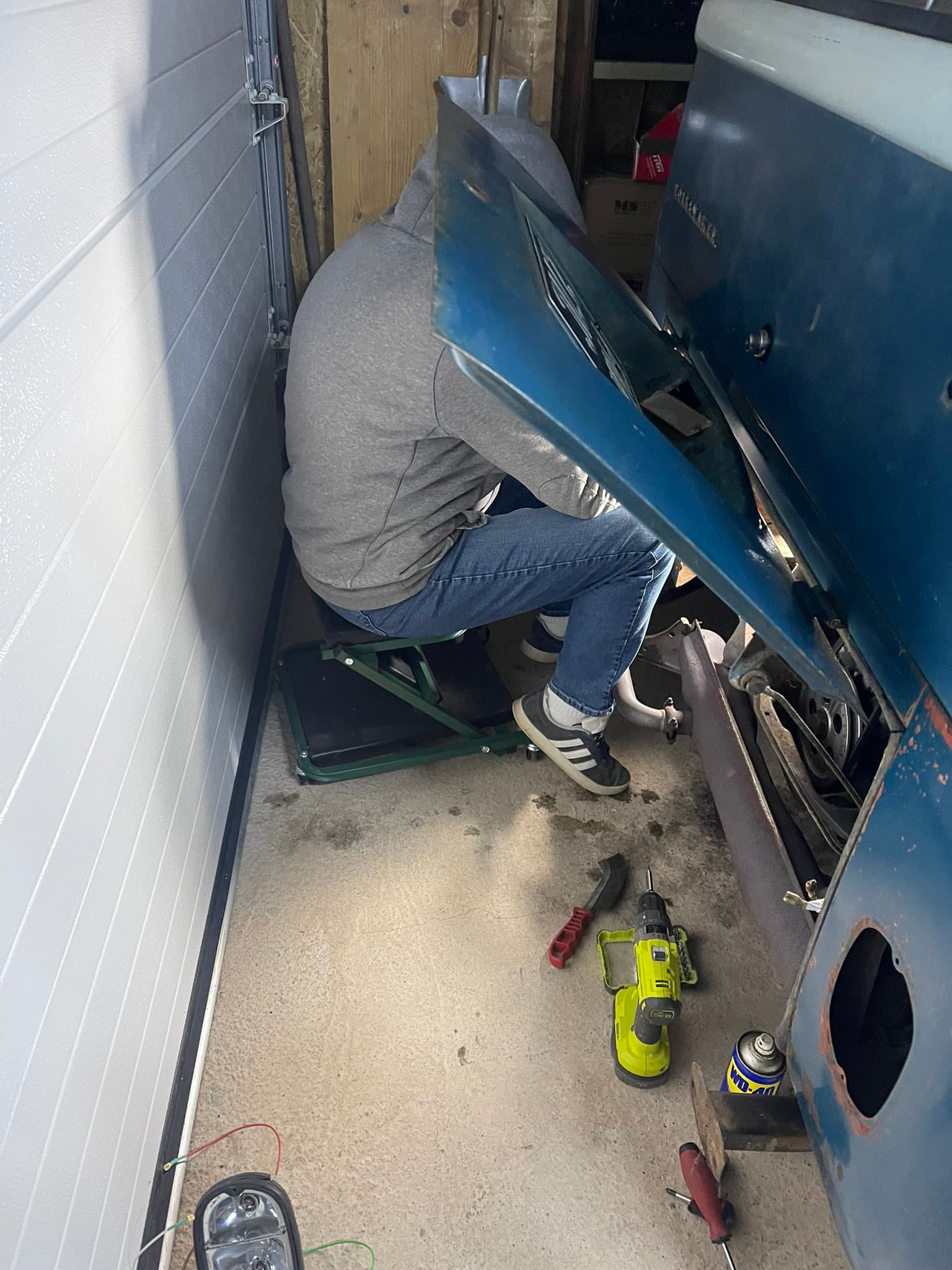

PostPosted: Tue Feb 18, 2025 11:01 am    Post subject: Re: my 65 bus walkthrough , from idaho to france Reply with quote

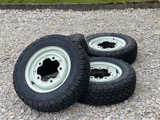

little work on the bus ... because it's very cold , on ski season Very Happy
i was searching for 14' steel rims but , hard to find know , or to expensive.
i test some big tire on the bus ( 175/80/14 and 185/75/14) , stutted tire for some ... 40 years old ...
i found an old set in my garden Rolling Eyes , and get a refresh
just need some new hubcap clips , and new tires..
my 71 bus was slammed , but now " i'm too old for this shit " ( lethal weapon ) , and i'm inspired by shasta snow trip and other offroader
thinking about nankang ft9 , available in 185/80/14
need to remove dropped spindel ... maybe next winter Smile

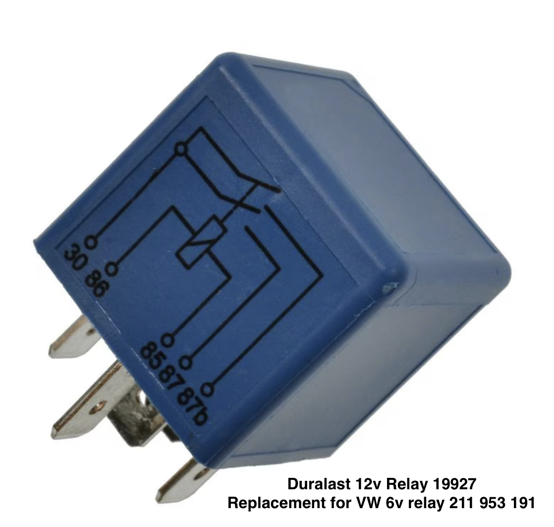

the bus was in us version for the blinker light , converted to european version in uk , but with some trouble ( no whipper , stop light ... ) and some hasardous wiring... so we rebuild the fuse box with some fix when needed ...
my wife help me sometimes Very Happy
more easy to find the good wire than the original vw wiring diagram
to be continued Wink

Do you plan to re-wire for USA specification, or keep it UK/Euro style?
If putting the hazrd circuit back in, be sure to use the right wiring diagram
https://www.thesamba.com/vw/archives/info/wiring/bus_63_USA_with_emergency.jpg

also indicator relay is 6v version ( bus the bus is 12v ) , lot of fun with wiring Smile

The hazard switch itself is readily available new
and used as well. It looks like you have the big red hazard light in the dash (to left of speedo).
Use either a 211-953-215C turn signal relay from an early baywindow, or get the modern electronic unit and you can run LED lights as well
https://www.pantera-electronics.com/bosch%20hella%20flasher%20relays%20with%20kbl.htm
For the big hazards relay (211-953-207; very hard to find!) you can use anything like this
or to keep the OG look and use a similar VW unit
In any case, use the wiring diagram I mentioned previously and you will have no issues.

i've ordered a 12v flasher relay after chating with 70bus..

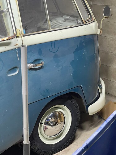

new paint for the front bumper, with us specs front bumper ... 2nd and not in good shape , so i have to buy some new parts ( was on a brasilian bus before )
and the result

new tyre 175/80/14

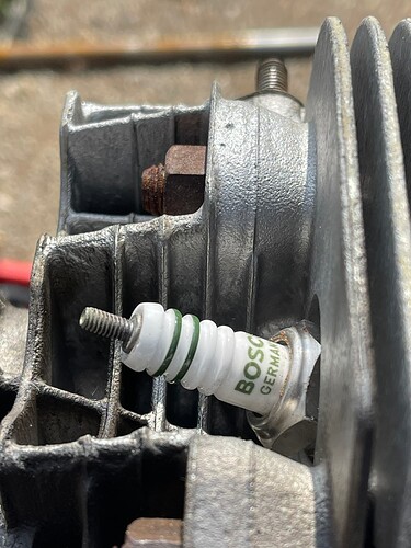

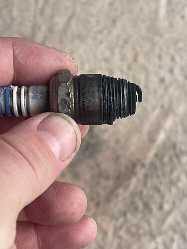

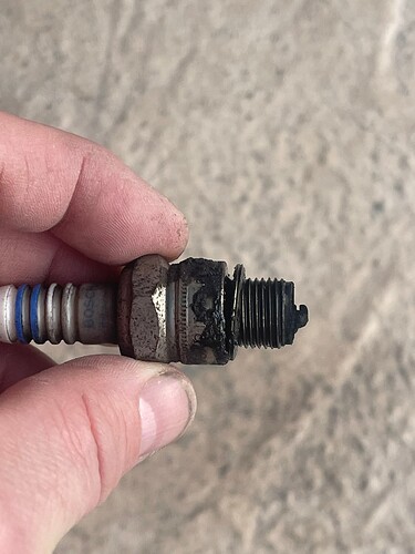

after , i've tried to measure the compression of the motor ... one sparkplug comme without tool Rolling Eyes , and another have some screw thread with , due to an old repair.
my daughters help me Laughing
it's out Smile

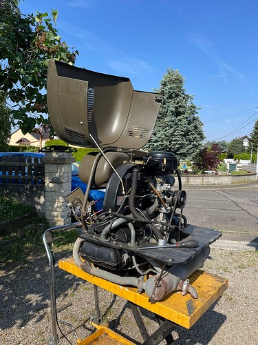

PostPosted: Fri Apr 11, 2025 1:28 pm    Post subject: Re: my 65 bus walkthrough , from idaho to france Reply with quote

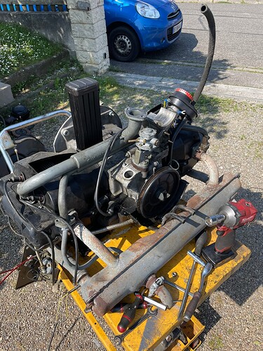

a friend just pick up for me a industrial vw motor , direct from a switzerland atomic shelter Smile
only 94 hour of run , with full maintenance book
the older motor will be inspected this winter ..

PostPosted: Fri Apr 11, 2025 6:16 pm    Post subject: Re: my 65 bus walkthrough , from idaho to france Reply with quote
That is a fantastic engine. I've never seen one except in brochures and books.
Yours even has a like new Bus pressure plate.

PostPosted: Sat Apr 12, 2025 11:44 am    Post subject: Re: my 65 bus walkthrough , from idaho to france Reply with quote
not so rare here , a lot of them is in use for generator or waterpump ...juste need some modification to fit on the bus , but not expensive for a new motor Smile

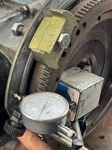

PostPosted: Wed May 14, 2025 1:55 am    Post subject: Re: my 65 bus walkthrough , from idaho to france Reply with quote

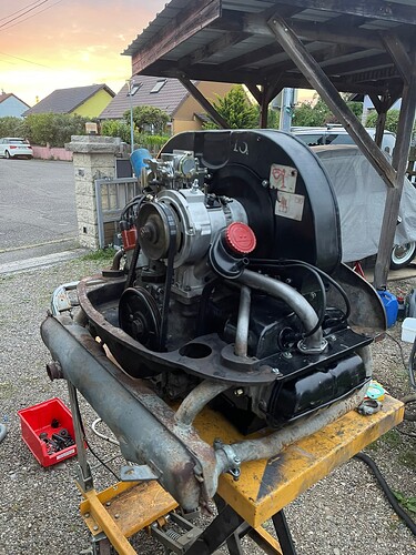

little work this long week end Smile a friend who built motor help me , and also he had all the tools needed.
a pleasure to work with a brand new motor , no modification or another issue, also all is clean Smile
we take the clutch and the flywheel of my old motor to put on the new.
after 30 min ..
bosh spark plug " period correct " made in germany Wink

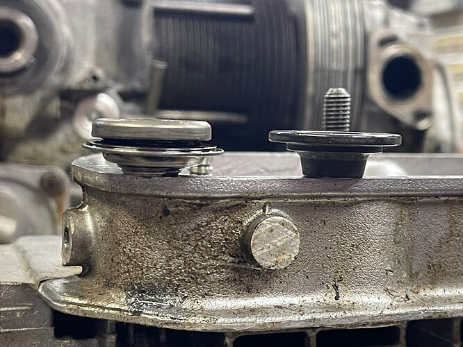

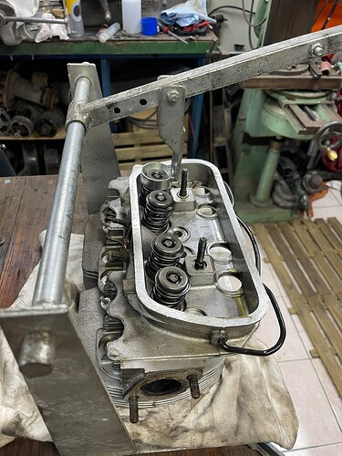

my friend tell me to the change valve spring and valve cups... , but lot of people use it " stock " with no modification ..
control of flywheel adjustement
ready to go !
we have to change the intake manifold , who had a strange size ( 32 carb on industrial motor ).
just need to remove the gasket on the 123ignition because we can't move it ...
after some tune , all is ok ...

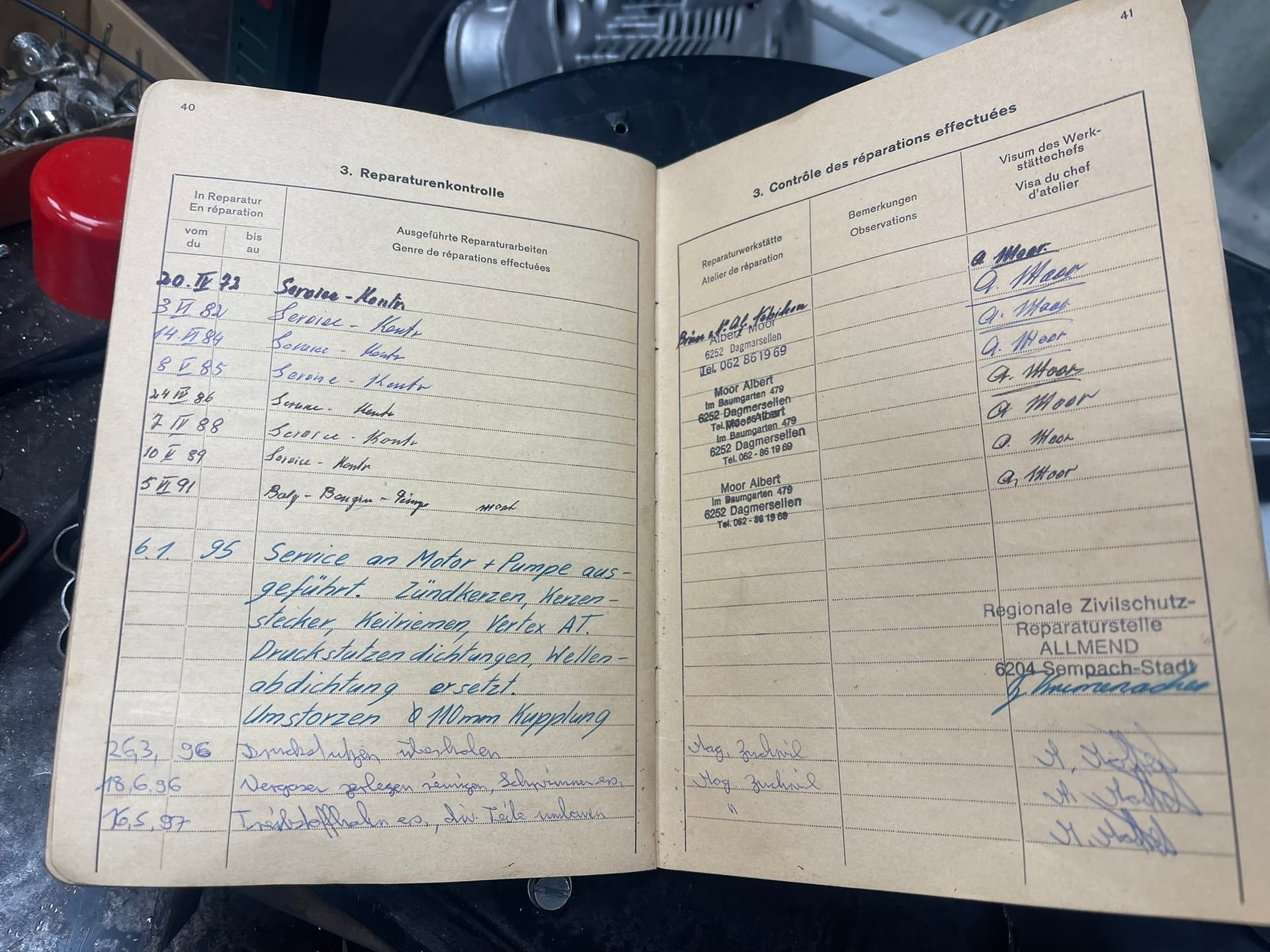

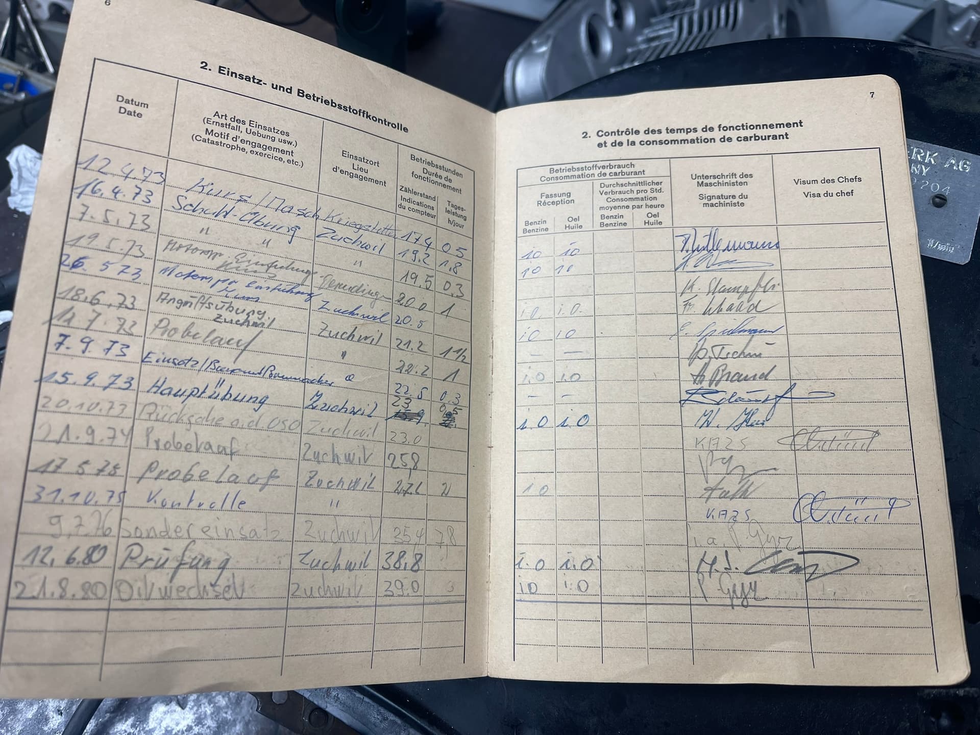

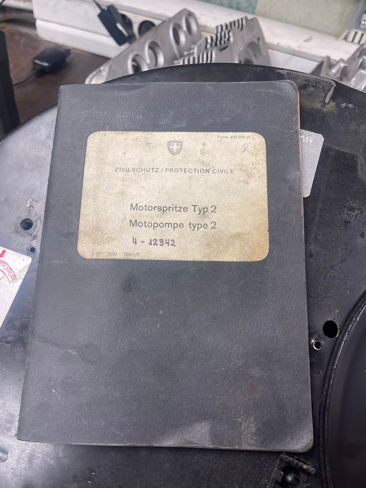

bonus :
mainteance log of the swiss civil protection
( not for my motor )
