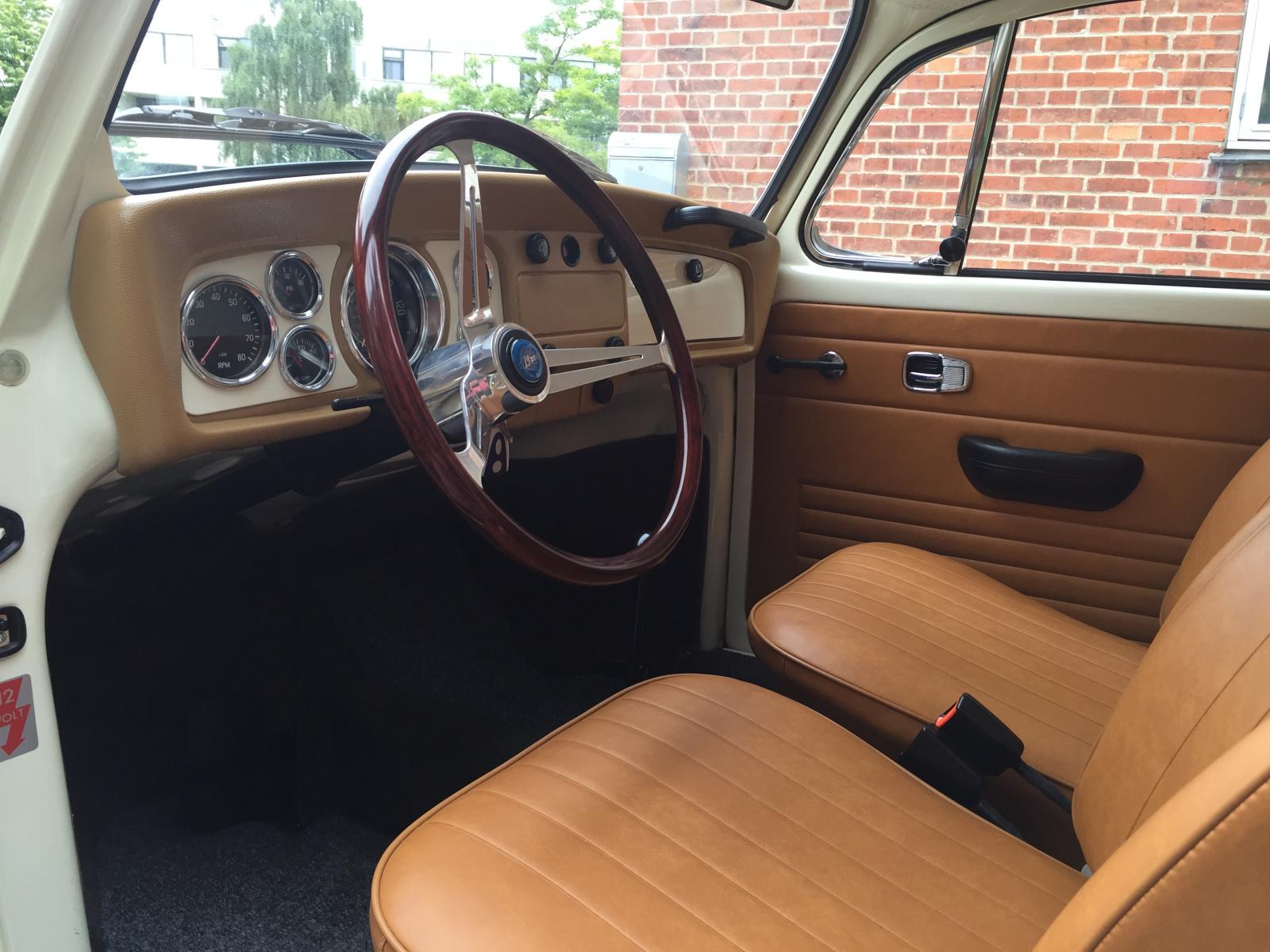

Haven't painted the knobs, but the dash and other parts. Used vinyl dye, and it holds up pretty good. Even painted my running board rubber, no problem.
I think I've said it before but, it needs repeating...
MAN, does that interior look good!!

flat4olsen
Joined: February 20, 2014
Posts: 344
Location: Denmark, Europe
flat4olsen is offline
PostPosted: Wed Sep 20, 2017 8:45 am    Post subject: Re: Painting/Spraying the black rubber dash switches?? Reply with quote
Thanks Dan Smile

PostPosted: Wed Sep 20, 2017 9:44 pm    Post subject: Re: Painting/Spraying the black rubber dash switches?? Reply with quote
That looks nice. How easily does it rub off?

PostPosted: Thu Sep 21, 2017 1:22 am    Post subject: Re: Painting/Spraying the black rubber dash switches?? Reply with quote
Not easily. It's amazingly tough. Cleaning and degreasing is essential. My running board rubbers are holding up just fine even though it's on the outside.

PostPosted: Thu Sep 21, 2017 4:01 am    Post subject: Re: Painting/Spraying the black rubber dash switches?? Reply with quote
Danpa wrote:
Dan
I'll repeat that too. Gorgeous and tasteful.

flat4olsen
Posts: 344
PostPosted: Thu Sep 21, 2017 9:18 pm    Post subject: Re: Painting/Spraying the black rubber dash switches?? Reply with quote
Yes, you get full coverage. My dash pad was Black before painting (only colour VW made them in), and so was my centre console.
6-7 very thin coats of dye gives you a complete colour change.

PostPosted: Wed Sep 27, 2017 3:30 am    Post subject: Re: Painting/Spraying the black rubber dash switches?? Reply with quote
Flat4, echoing others here, it looks awesome. Can you be specific about the name brand of the "vinyl dye" you used?

PostPosted: Wed Sep 27, 2017 4:24 am    Post subject: Re: Painting/Spraying the black rubber dash switches?? Reply with quote
Thanks! I'm danish and SEM is not available around here. I use a German brand,- MHW. The system is three parts, a cleaner (which seem to lightly dissolve the outer layer of the vinyl), the color itself and a clear "finish spray", that toughens the surface.
Cleaning and prepping and thin coats is the key.

PostPosted: Wed Sep 27, 2017 5:46 am    Post subject: Re: Painting/Spraying the black rubber dash switches?? Reply with quote
That looks freaking fantastic.
