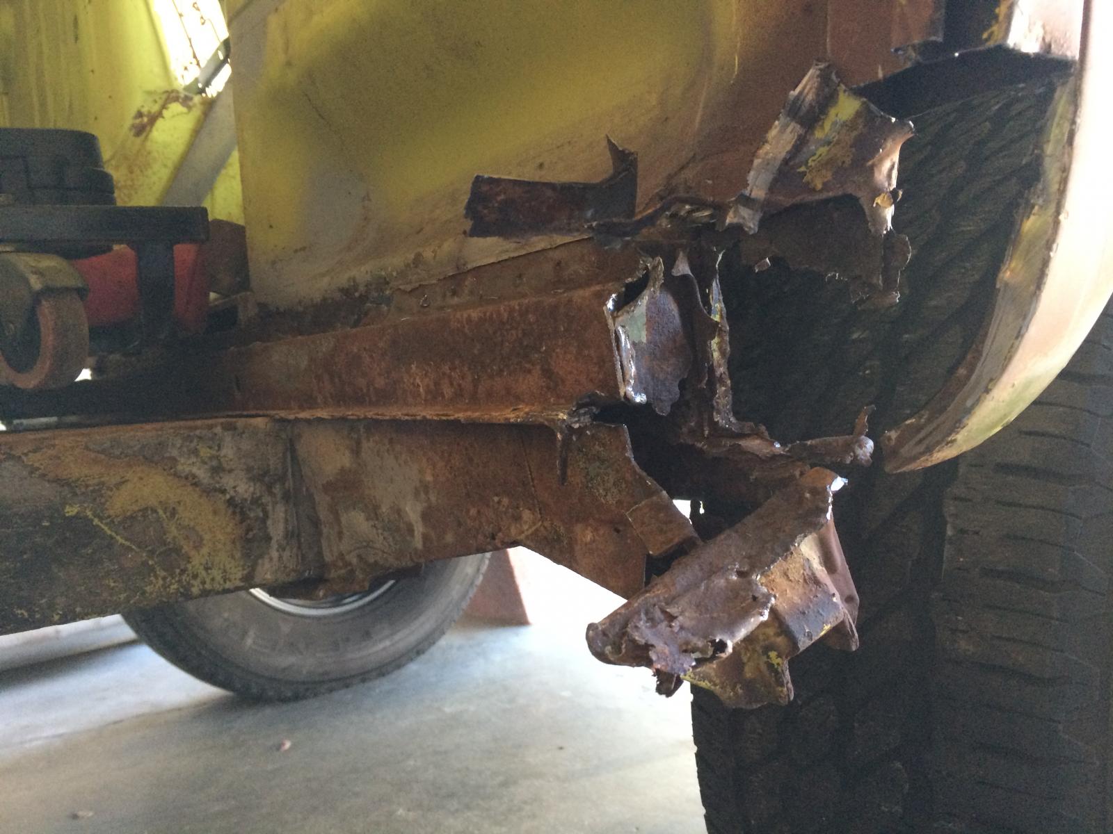

Day one on the 1975 Westy that I acquired from another forum member on here. He purchased all of the replacement panels, tons of suspension parts, an extra set of wheels, freshly rebuild series 4 engine, rebuilt trans and managed to save all of the original interior, among many other original parts. I picked it up last week, had it delivered via AAA a couple days ago and got to work today.
Test fitted the new floor pan, it fits nice, and traced my cuts for the foot wells in the dog legs. Cut out a section of the rear cargo floor and fitted it up as well. Not bad for about two hours of work and the first day.
This will be my build thread, and with that being said, I really appreciate everyone's advice, and constructive criticism. If you're here to troll, however I will kindly ask you not to post anything. I saved this bus from the scrap yard, and it needs some work. No matter what it can't get any worse. I've gotten some serious inspiration from other forum members builds. Thanks everyone !
Now for the photos...

Back at it. Decided against the middle rocker panel. I mounted the new lower sliding door track and put my door on to see how it fit... like a glove. The nose is almost done. Lots of welding, grinding and a tiny bit of bondo to smooth it out but it's looking good. Gonna throw on some primer and call it a day. Big box of bus parts on the way, hoping to have the engine in and running by May 1st. Only issue I've come across is figuring what clutch I need. Porsche 914 engine with a "bus flywheel" from the PO. The flywheel has 130 teeth and the diameter measures roughly 220mm across. I've included photos, if anyone can help I'd really appreciate it. Posted photos of my other progress as well.

Been awhile since my last update, I've been pretty hard at work on the bus. All of my welding is almost done... I have to finish the rear wheel arches, sliding door guide and then my cargo floors. The end is nearer.
I purchased a new main wiring harness, figured it would save me a massive headache since the PO didn't leave me much to work with. Spent a couple of days figuring out the DIN wiring diagrams and they finally make sense to me. Had a real "ah ha" moment today. Once I'm done welding and get the basics wired up I'm gonna throw some fuel in and see if it'll go.
Still need to get the rear hubs off, I'm now certain that it's an impossible job without a 1000 lb impact or having the engine and CV axles hooked up along with a massive breaker bar.
Finally, a few photos. I'll take more once I roll it out and get it cleaned up a bit.
