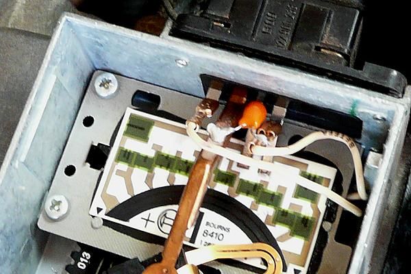

I'm in N Cali now, limping towards I-5 in Oregon and heading N to home in Bellingham. After 8 weeks of flawless running all over Baja, my 1989 Westy has developed the dreaded vanagon syndrome. I'm very sure that's what it is, runs great for 2-3 hours at a steady 3500 rpm, then out of the blue bucks and jerks. Turn off and back on and you get a 5 to 30 minute reprieve, then back to a bucking bronco (worse cause it's a syncro so the driveshaft slop amplifies the action).
So to be blunt I'm not looking for a discussion on the syndrome or alternate causes, I've cleaned the throttle body, change the fuel filter, cleaned the air filter, etc. I want to find someone on my route who has one of those AFM capacitors a soldering gun and experience in doing this fix. I'd even spring for the VW harness, but since I'm going Zetec this spring, I'd prefer the $2 capacitor. Thanks for any solid info you might have, otherwise I guess it's a slow slog back to the cold darkness of western Washington.

I had that on a van once and it does occur as you describe (way too many people think every problem is vanagon syndrome). But if yours is really vanagon syndrome, you can make it go away by varying the throttle position. It is a static charge or something that builds up when the AFM needle is not moving that wrecks the signal to the ECU. So if you can make it stop by giving it throttle, then taking off the throttle, it is probably VS. If not, it is something else. What I did on long flat drives was to acclerate up to 70, then drop back to 65 and then back up to 70. When I finally got the VW harness it went away. It occurs under such infrequent circumstances that you don't need to fix it if you are puling your engine soon. You can find a harness on ebay or classifieds though.
I would guess it is some other fuel air delivery problem. I would try to clean the intake, take a look at the spark plugs, if it is time to change the fuel filter I would do that. Maybe someone will have better suggestions, but that is what I would try.

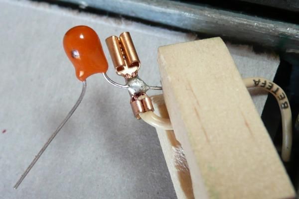

IIRC, it's a 22uF (that's microfarads, I saw someone here tried a 22mF and it made his engine sluggish) tantalum capacitor, of 16 or 25 volts.
Haven't installed one myself but I had non-syndrome hesitation that had me looking.
Good luck. The search engine won't work too well (the phrase is too readily employed here) but the answer is somewhere in the FAQ.

before open up the AFM and put in the capacitor try this
- check all vacuum lines
- check the TPS (throttle position switch) - it must give a clicking noise when opening the throttle

Running a ground wire from the body of the AFM to the engine block will help some. You can also just fold up the leads of the 22uf capacitor and jam them into the correct terminals in the back of the plug under the boot. Not as good a fix as soldering but it works in a pinch.
The 22uf capacitor is the largest size you can use without causing sluggish response. You could probably go a bit smaller and it would still work.
