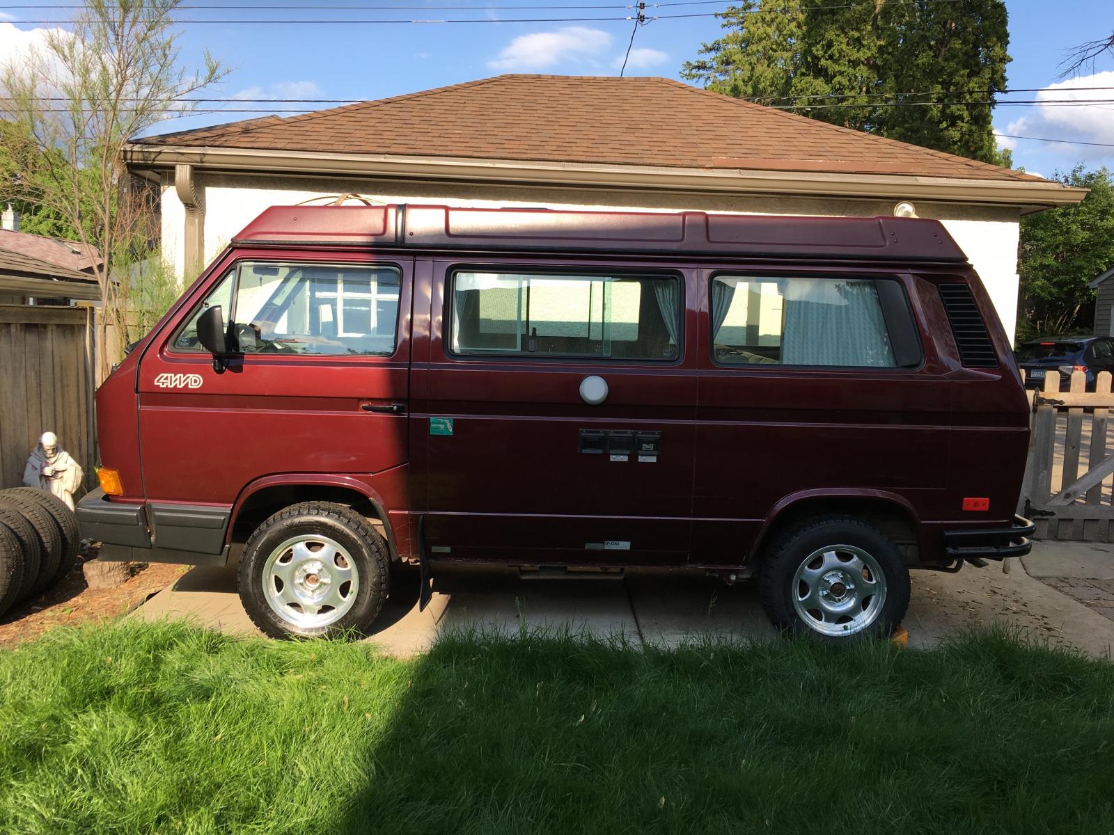

Calling all wheel pros.I am ready to purchase tires for my syncro and I am a bit overwhelmed. Here's the specs I know on my van and wheels. Help me pick.
1.8t conversion
Taller 4th gear .82
Audi a6 wheels : 16" x 7". 42mm offset
Schwenk syncro lift springs
G60 disc brakes front/eurovan disc brakes rear
Stock length wheel studs front
45mm studs rear
I want something that is great for the highway mainly but suitable for occasional off pavement bursts. Doesnt have to be too tready but look appropriate on a syncro if that makers sense. Like the tires you would see on a cayenne or Audi Q7. Let me know your thoughts opinions. Chris t3 you out there? Thanks guys
Heres a pic of my wheels.

Amateur's opinion...no questions, hands down, 215/70r16 BFG KO 2 tires. You won't be disappointed.

I wrestled with the exact same requirements - went with Nokian Rotiiva's 215/65/16 very happy with my choice. No noticeable downside vs the miche;ins I had on the highway and handle very well off road. Not as burly as the k02s I considered but given my realistic time spent in the dirt is at 10% I didnt want the noise, cost or to lug the extra weight

I second the Nokian Rotiiva's 215/65/16's.
I previously had the Michelin Agilis 205/65/15's on my 90 syncro westy and recently upgraded to the 16's on CLK rims. I noticed a slight increase in noise over the Michelins, but otherwise a very firm and stable feel on the road. Very solid, maybe more so than the Michelins, despite the slightly higher ride height.
A great tire, and highly recommended so far for road use. I have not tried off-road yet, though. I bought mine from tiresbyweb dot com and have had good results from them for this and other purchases. Warning: I have a Nokian bias, as I've used their snow tires for many years on my other vehicles with excellent results.
Here's a photo of the install. Thanks to Chris at T3 for his help in making this happen. Dem lug nutz fit like a surgeon's glove.

I too have a set of the Rotiiva AT+, 225/65 16 and I too haven't gone off road yet with them.
On the pavement they give a solid feel to the Syncro. I also like the open tread design they used as I think it will work well in the rain to prevent hydroplanning.
In all honesty you need to do your research and read reviews submitted on all the tires out there because in-between the lines you'll pick up on things people are experiencing about the tires.
For example I had Hankook Dynapro MT put on by the PO and they are really dam good looking tires! They were too large and rubbing so I started looking to replace them. I wanted the same tires based on how I like the tread and good ride.
However, I found two instances where the sidewalls were cut by rocks, one time within 6 months of new and the same thing happened again to the same driver. It also happened to another owner in another state so that killed my desire for them!
So do your reading, but I like the Rotiiva's!

casey79westfalia wrote:
1.8t conversion
Taller 4th gear .82
your 4th is 3.5% tall, so it lower your rpm by 3.5%
now add the tire
if you use a 215x70x16, w a 28" diameter, which is 10% tall, your gearing ends up 13.5% tall overall..
a stock van with stock tires goes 71mph @ 4000rpm, so with 28” tires your 71mph would be at 3460, or 540rpm lower than stock.
in your other stock gears, your gearing will be 10% tall. It will reduce your RPM by 10%, for any given speed, compared to a stock tire.
The 215x65x16 Rottiva is a 27" tire, so 6% taller than a stock 25.5" tire. Imo this is a better match to your gearing, especially because you made 4th taller
with your 3.5% tall 4th and the 6% tall Rottiva, your 71mph speed would be at 9.5% less than stock 4000rpm, or a drop of 380rpm, so 71mph, at 3620rpm.
I would pick the Rottiva, for your 99% pavement use, particularly since it does not snow in Baltimore, otherwise I would consider a Nokia WRG3 because it has more sipes, which also helps in heavy rain btw.
Im heavily pro WR series Nokian, for snow, as I have found them unstoppable. The heavy siping also works surprisingly well on sand, and dirt, none of which you need Smile
just one other thing.. Nothing looks as bad ass as BFG.. true dat! but looks aint every 'ting

PostPosted: Sat May 27, 2017 5:42 pm    Post subject: Re: Wheel Pros help me select syncro tires Reply with quote
Thanks Jon slider. Looks like the rotiva is the one. Now to find the cheapest dealer.
