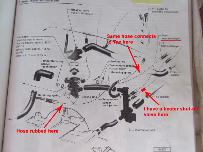

I can't believe I didn't notice this, but my hose rubbed on the axle and scarred it pretty good......
This is the hose shown in the Bentley....
another shot of the hose....
It's not leaking but doesn't look like I want to ignore it for long. It's a hose that comes from the front heat exchanger (Heater, I guess). I have a heater shut-off valve installed on the other hose that goes to the heat exchanger that I got from Terry Kay. It is 5/8" heater hose.
My question; is there a way to fix this hose without draining the whole system, replacing it and re-filling the system.
Thanks in advance for any comments!

OH Hey! It just occurred to me that I should be able to just pinch the hose on either sides and install a splice/coupler.??

PostPosted: Mon Oct 10, 2016 8:12 pm    Post subject: Re: Coolant hose rubbed on cv axle boot Reply with quote
Depending on where the shut off valve is installed, maybe only pinch one hose?
If hose is in good shape, why not?
I had the same thing happen with a fairly new heater hose.
I was lazy and shunted in a piece of 1/2" copper
pipe. (double clamped). Would suggest you buy a proper plastic part.
Your FLAPS should have a "Help" type part or similar.
Neil.
