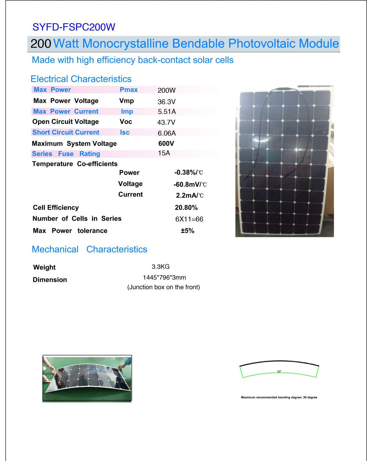

I'm considering flexible panels for the roof... it won't make much difference to the range but will keep the 12V system battery topped up and provide useful auxiliary power Cool
Here's a typical example from EVTV
