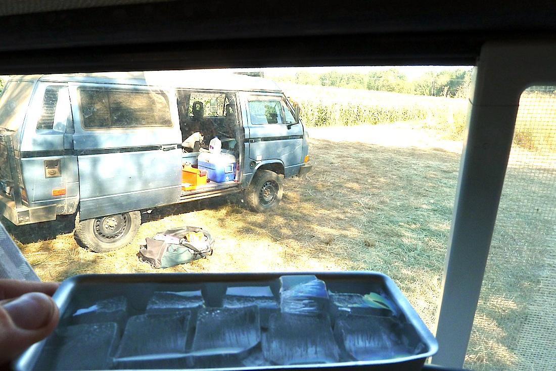

I've left my Dometic fridge running for more than a week non-stop many times in multiple vans.
Last time was four days at MogFest. It even made ice in the infamous Sheridan heat, which I was able to put in my water bottle every morning. Cool

Not only do I leave my fridge on propane all the time, I also drive while it is lit.
Tip, to make ice more quickly while driving, first light the pilot, then switch to alternator. The pilot stays lit unless you turn the gas off, and the driving adds heat to the compressor, making the fridge colder while driving than it would be on gas alone.
the above dual simultaneous mode does not work with the auto igniter models
