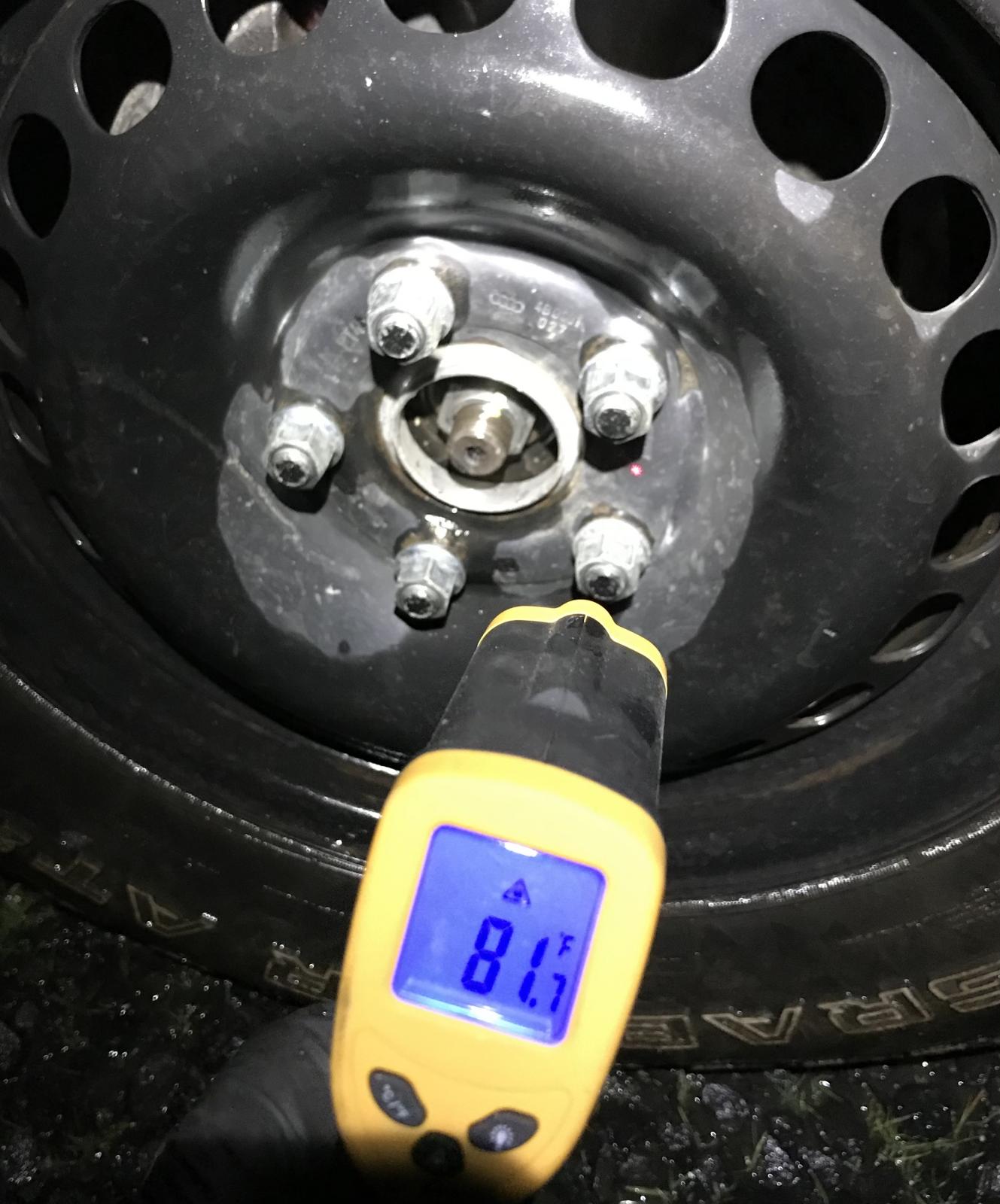

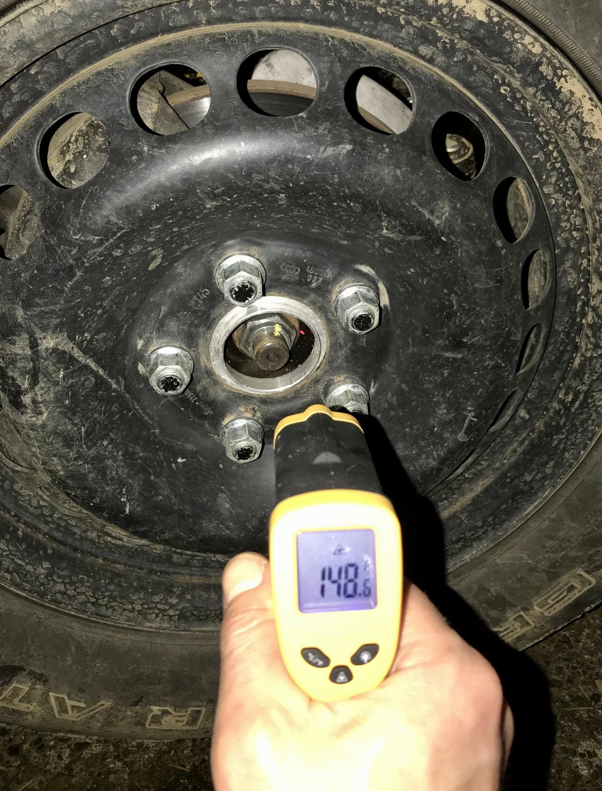

Hello, I just wrapped up our front end late last night. Replaced all bushings, ball joints, bearings, installed lifted springs and new shocks.
Today we joined a rover group to do some off-roading. Drove about 120 miles, including lots of forest gravel roads and pretty gnarly off-roading (that lift is amazing). I noticed during the day, while checking the torque on the lug nuts that they were pretty hot. I didn’t think anything of it at the time.
Once we got back home, I hosed off the van (about 30min after getting home) and noticed that the front wheels were steaming and the water was drying from the center of the wheel. By the time I grabbed my IR thermometer, the center part of the wheel registered between 75° and 90° depending on where you measured. Outside temperature was around 45°. The brakes themselves were around 60°/70° (both front sides).
I drove the van again about 12 miles on the highway to dry it off. During that drive, I did a about 5 heavy brake test, toward the middle of the drive. The last part of the drive didn’t need much braking. I measured the temperature again and they were much higher:
- front wheel hub: 149°
- axle spindle: 139°
- wheel surface between lug nuts: 132°
- stud: 134°
- CV joint (close to the steering knuckle): 123°
- steering knuckle (next to CV): 105°
- brake rotor and caliper (both): 78°
- rear wheel spindle: 66°
Does this sound normal to anyone? I don’t seem to remember the nuts getting that hot in the past. People seem to blame the brakes or bearings. The brakes seemed pretty cool in these tests so I am worried about the bearings I just installed...

Posts: 23809
Location: NYC/Upstate/ROW
Abscate is offline
PostPosted: Sun Jan 17, 2021 4:47 am    Post subject: Re: Hot lug nuts and hub after Syncro front end rebuild Reply with quote
95% it’s brakes rather than bearing. When were the fluid and hoses last changed on the caliper?
149F isn’t crazy hot for a disc brake but if water was sizzling rather than just steaming, it’s too hot.
AceTaylor
Joined: July 15, 2009
Posts: 156
Location: PERKASIE, PA
AceTaylor is offline
PostPosted: Sun Jan 17, 2021 6:00 am    Post subject: Re: Hot lug nuts and hub after Syncro front end rebuild Reply with quote
Before you check temperatures again. Do the road test without the 5 hard stops.
MarkWard
Joined: February 09, 2005
Posts: 18725
MarkWard is offline
PostPosted: Sun Jan 17, 2021 6:13 am    Post subject: Re: Hot lug nuts and hub after Syncro front end rebuild Reply with quote
A brake disc can easily hit 1000 F. I’ve never fiddled with the grease in new bearings. I install them as they come out of the box. Drive it using only the hand brake.
valvecovergasket
Joined: October 10, 2018
Posts: 1499
Location: pnw
valvecovergasket is offline
PostPosted: Sun Jan 17, 2021 8:52 am    Post subject: Re: Hot lug nuts and hub after Syncro front end rebuild Reply with quote
Seems like odd coincidence, and he didn't mess with the brakes he messed with the bearings and axle
All the brakes I've ever had lock up stank like burning pads which is a pretty unmistakable smell. Meanwhile all the bearings I've misadjusted did exactly what he's describing... (Usually rear bearings on mk1s and mk2s in my younger days Very Happy )
Based on what we know about how they were torqued my money's on overtightened axle nut.
Sodo
Joined: July 06, 2007
Posts: 10628
Location: Western WA
Sodo is offline
PostPosted: Sun Jan 17, 2021 10:04 am    Post subject: Re: Hot lug nuts and hub after Syncro front end rebuild Reply with quote
...forest gravel roads and pretty gnarly off-roading (that lift is amazing). I noticed during the day, while checking the torque on the lug nuts that they were pretty hot. I didn’t think anything of it at the time.
What is the distance from axle to fender lip?
20 inches is the max allowable.
At some number beyond 20" the CVs bind and get hot.
....KTMs, GasGas, SPOT mtb
Abscate Premium Member
Joined: October 05, 2014
Posts: 23809
Abscate is offline
PostPosted: Sun Jan 17, 2021 10:21 am    Post subject: Re: Hot lug nuts and hub after Syncro front end rebuild Reply with quote
Error analysis on your torque approach
Your foot is about 10 cm wide, and your 1.3 feet is about 40 cm long
Ergo have an uncertainty in torque of about 25% due to that method just from the length aspect
More importantly , stepping on a bar doesn’t put it in pure torque , there will be a downward reduction in force which will introduce torque loss.
Get a torque wrench for this application.
Steve M.
Joined: July 30, 2013
Posts: 6926
Steve M. is offline
PostPosted: Sun Jan 17, 2021 10:35 am    Post subject: Re: Hot lug nuts and hub after Syncro front end rebuild Reply with quote
Sodo wrote:
All of the grease is sealed inside the bearing.
Steve do you mean rotating the wheel (slowly) at the very early stages (less than 10 ft-lbs)? That makes some sense for ultimate ninja bearing assembly, but I can't imagine know how it could be related to the heat.
I'd forgotten that it is a sealed bearing. Embarassed
It's not related to heat. It is related to torqueing a wheel bearing.
