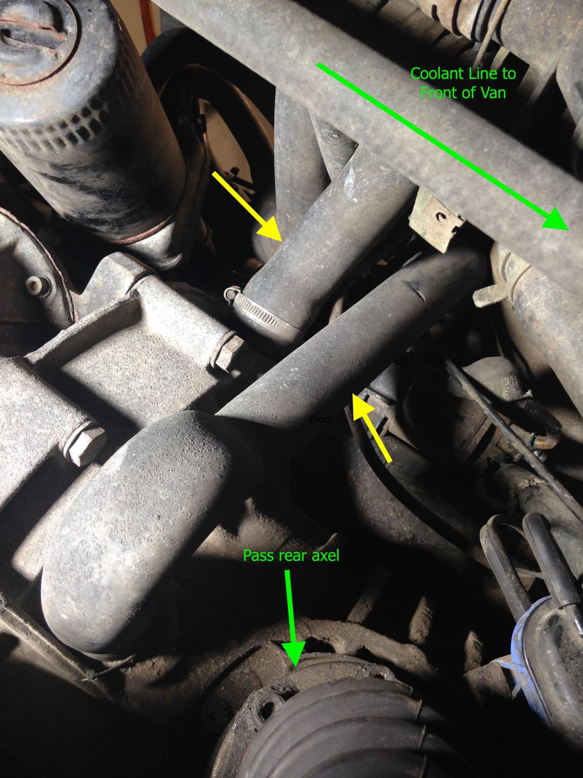

Hi All,
As I'm learning (oh so much) about my imported doka I keep running into some things way over my pay grade... i.e. wtf does this wire do and why is it cut off?
I've got almost zero experience with diesels (am up to about 5% now) and having a transplanted engine in a European T3 makes it more challenging for sure.
First there are two, what I assume are breather tubes fro the transmission? (Syncro), coming out of the transmission just aft of the rear axels that run up to the top on the engine bay and gooseneck to...well, nothing.
From the top (yellow arrows on right point to the ends of the transmission tubes - hard to see one under the oil cooler pump. Yellow arrow on left dead ends also under air filter)
Better view of the upper one I repositioned for clarity
Though that seems like a pipeline or debris into my precious synchro transmission perhaps this is normal? Or did they connect to the original 1.6l JX somehow and were left off? Any insights most appreciated.
Mark (the gremlin herder Rolling Eyes )

Yes, those are breather pipes. VW built the Syncros to work, and one of the things they had in mind were stream crossings.
Not sure why they thought the diesel bell-housing needed such large breather pipes, (the gas versions have just a small plastic breather hose), but bell-housing, transaxle and front diff all have breathers because they are sealed against water intrusion.
The two hoses from the transaxle and front diff usually terminate over the fuel tank.
It's always a good idea to check the small pipes for dirt clogging the opening.
You may want to double check that smaller hose you are pointing at that leads to the air-filter. Follow it back where it comes from. If I remember correctly that should be a vacuum hose for the LDA and connects to the intake manifold.

Thanks MsTaboo! Knowing that is a relief. After reading many of the trans threads and how mere dust motes can wreak havoc with our gears I was alarmed at a passage(s) that would slow several fat gerbils to pass easily. I will do my best to keep them above water. I did find a small plastic line - 1/4” ID that comes off the forward end of the transmission just before the driveshaft (the transaxle?) that runs to the general vicinity of the fuel injection pump - resting on top of the engine and isn’t connected to anything. Perhaps it was routed more forward over the fuel tank in the past but flopped out when the new engine was installed. I’ll look for the front diff ones now and check they are clear too.
I’m not sure what that device is - something throttle related (I’ll look up LDA) - but the other end isn’t connected to anything. Perhaps it was on the 1.6l - no obvious small male ports that I can find. I’d like to know where/what it should connect to.
Perhaps to this hiding behind the drivers taillight assembly? (Current intake air hose is removed for photo)
Original intake fan? Not sure, but it’s tied into the electric still - 10 years after the swap.... (don’t mention the rust by the way....I’m still adjusting to the fact it’s, well, everywhere Crying or Very sad )

PostPosted: Mon Dec 18, 2017 3:27 am    Post subject: Re: 1.9l AAZ in T3 Hose Dead Ends?? Reply with quote
So, I too had the tatty insulation around the original rubber hose, and NO heat shield. Well, after a loooong hill last summer, and suddenly losing power about 3/4 the way up, I figured out that the rubber hose burnt through Shocked.
So, I bought the heat shield (aftermarket), and the new air hose (silicone, rated for re-entry) and fixed the problem. As you can see here:
The wire for the extra air blower can be seen. This is where you need to look for yours. I have come to the conclusion that mine doesn't function because I have a cooler thermostat installed. (85° as opposed to 87°). I think the switch opens at 90°. I've replaced it twice, and it never works, however if I ground it against the head, it fires right up.... go figure.

Thanks for that - I had no idea it can get that hot - tho now that I think about it makes perfect sense.
Saving your pictures - It’s great to have pictures with labels. I’m in the process of doing that for our WBX in the Westy to help me learn and talk the wife through any issues. The AAZ is still mostly Greek to me. This helps a lot!
I’m going to see if I can get my “Luftbläser” working too Cool
