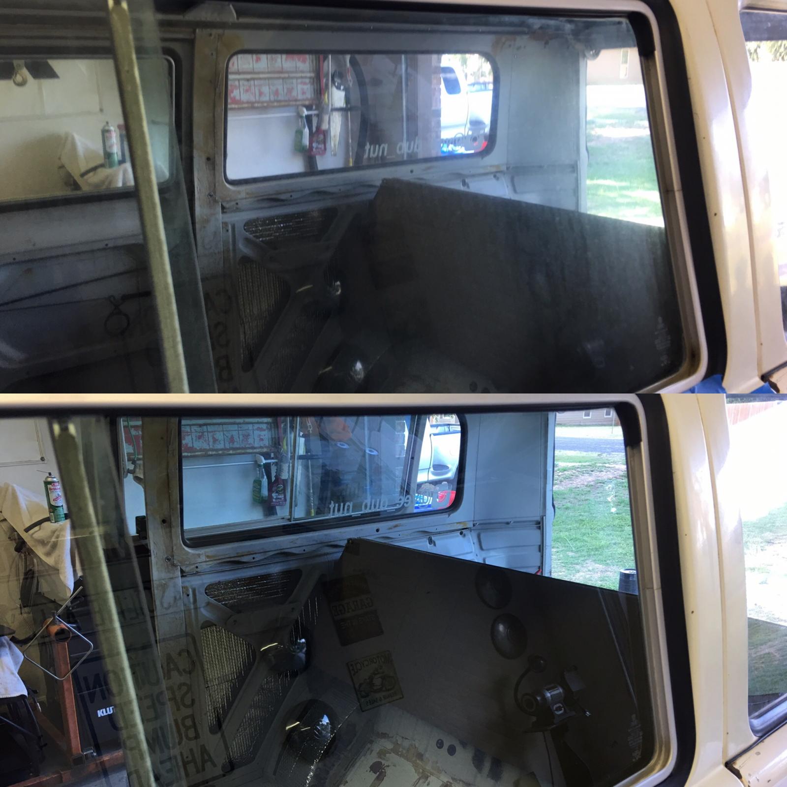

Starting with the windows, I was happy to find really clean openings after removing the jalousies. After a quick cleaning and a couple of spot touch-ups, th the sliders were ready to go in.
Just a tip, if you ever work with glass that is particularly stubborn to clean, I found that warm water, bar keepers friend, and a NON-SCRATCH scotchbrite can do wonders with some elbow grease. Just check out this before and after.

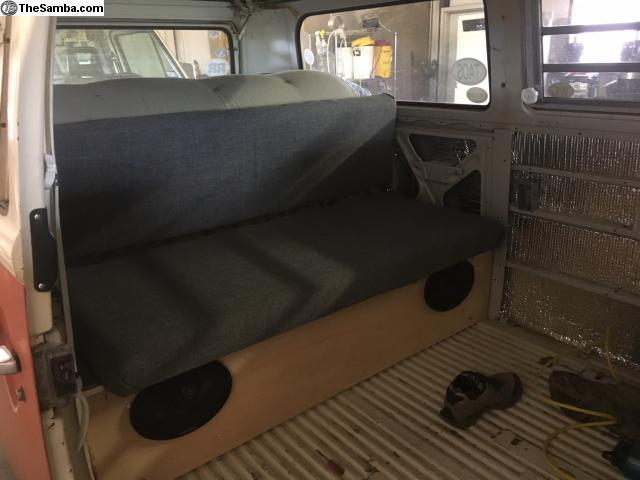

After getting the bus dried in, I shifted focus to the interior and stared with installing a new rubber cargo mat from WW. Its a decent mat, but is a little overly thick compared to OG, and it needs to have all of the holes cut open. A little tedious, but I got it trimmed up for the seats and belt mounts. What worked the best was a rough cut with a box cutter, and then fine tuning with a sanding drum on a dremel to smooth out the edges and round the corners (never mind that burnt rubber smell )

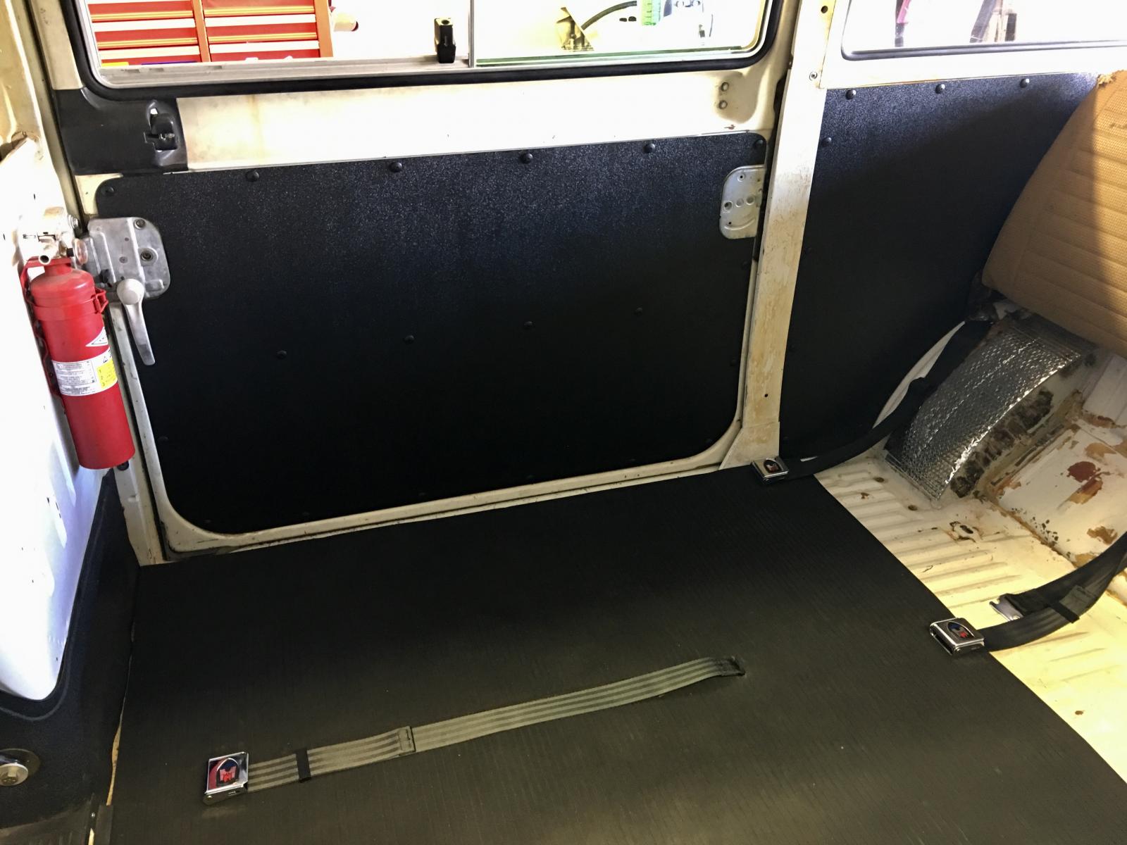

About this time my Werksberg ABS interior panels showed up. I've had my eye on these for a while, as they look really nice and sharp, and I knew they would be very durable for a Bus full of kids. Nothing could happen to them that a quick wipe with a wet rag couldn't fix. If any of you guys are considering these panels, I HIGHLY recommend them. I went all out, and got panels for all of the interior.
Installation was pretty easy. The plastic molys that they install with were about as good as any plastic trim panel clip (read, just OK), and a few of the holes in the panels needed to be massaged a bit, but it all went together quick.

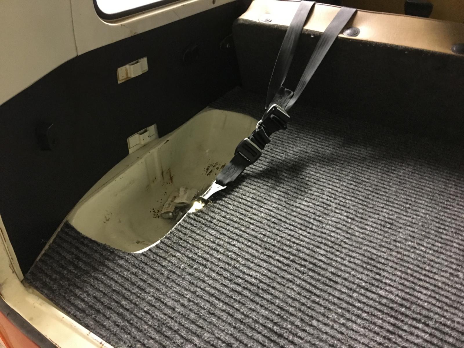

With the panels back in, I got all the rear benches installed as well as the kids y-harnesses and some latch mounts for car seats. I didn't do anything in the front except for the ABS door panels, as the PO had already recovered the seats and installed new kick panels, seat stand mats, and front floor mat.
I do plan to eventually recover the rear benches in black so that they match everything, but for now they are functional, and I can divert project money else where. _________________ Fightin' Texas Aggie Class of 2006

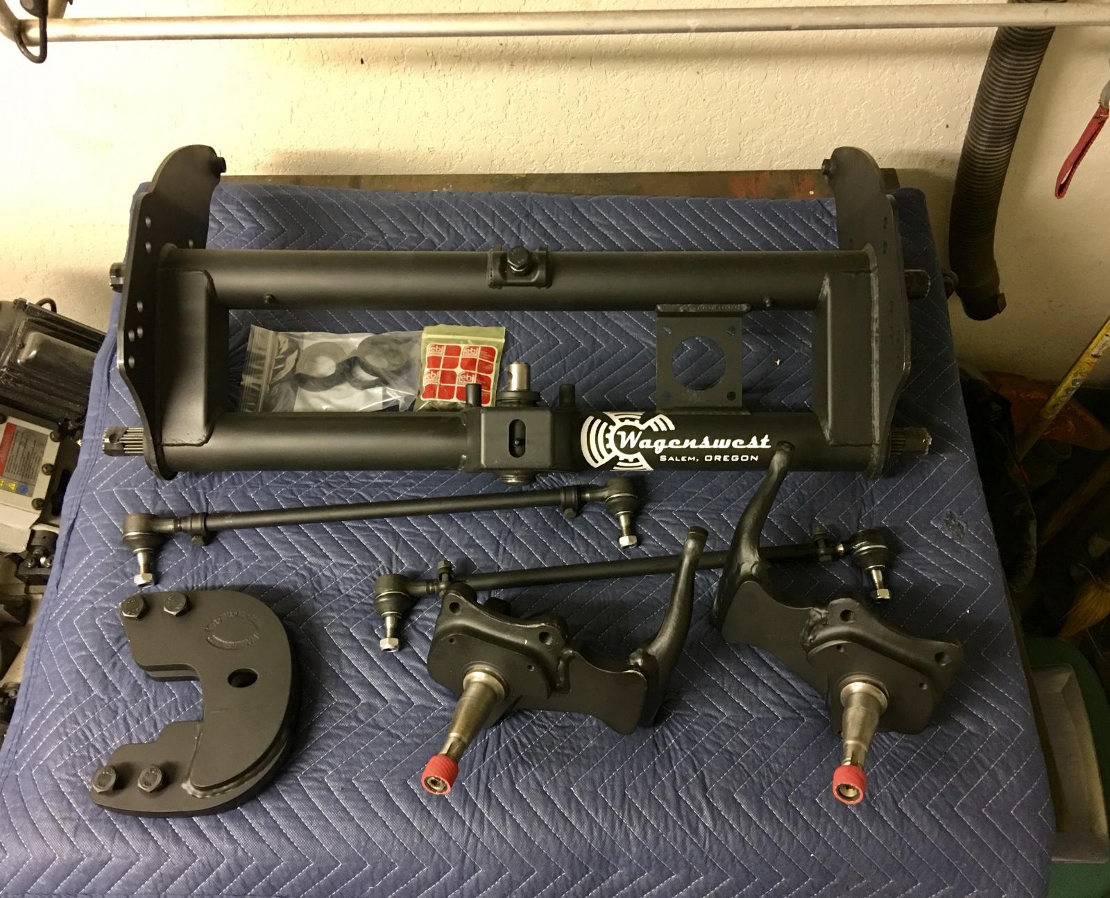

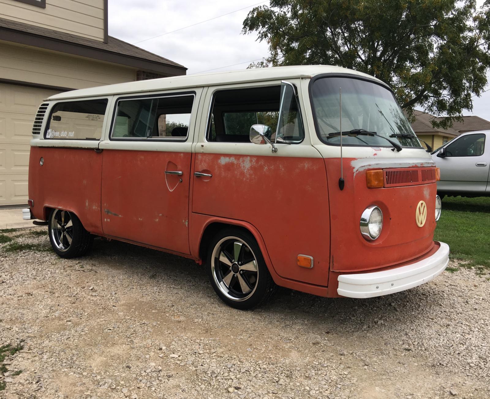

After getting the interior sorted, I shifted my focus on the stance of the Bus. I wanted to lower it and change the wheels, but not go so low as to make the Bus unpractical as a family hauler. I settled on a full suspension setup from Nate at Wagenswest. I went with a 4" beam, 2.5" spindles, and 3.25" horseshoe plates for the rear. The wait for Wagenswest parts is pretty long, but I was pleased with the quality of the parts once they arrived.

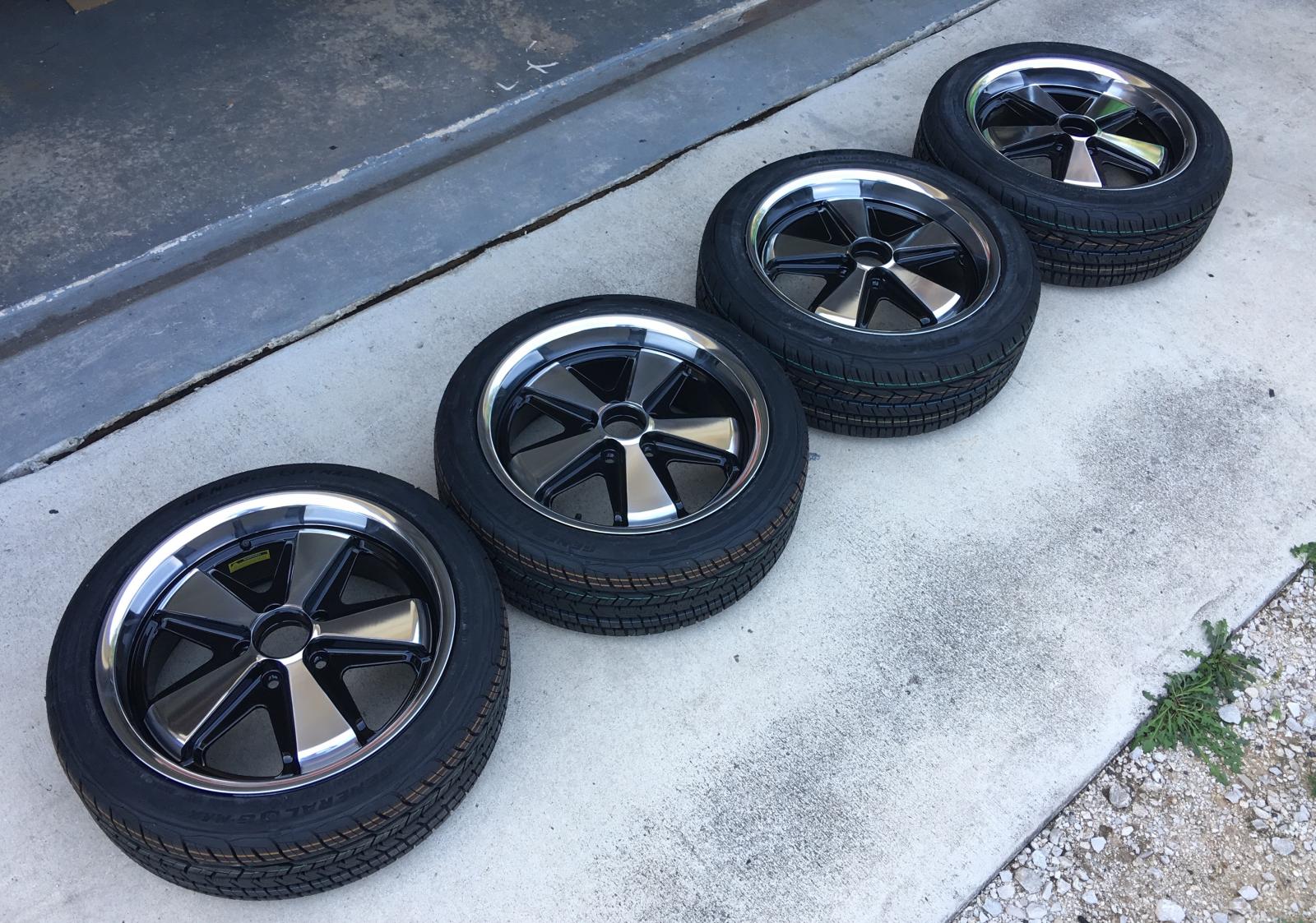

During the wait for the suspension I ordered wheels and tires and got them ready. For the front I went with 205/45's, and the rear 205/50's, all mounted on 17x7" re-pop fuchs.

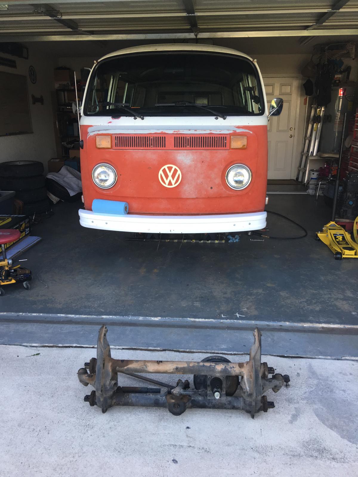

Once I got all the suspension parts in hand, the Bus went under the knife. I started out on the install with the front. It is a pretty straight forward process of removing the oil beam and installing the new narrowed Wagenswest beam and narrowed tie rod ends. While I was there it also got new wheel bearings and seals, and rebuilt torsion arms with new ball joints from Wolfgang Intl. It was a fair amount of work to RnR the beam with all the control components having to be removed up front, but the quality in the Wagenswest parts showed with the ease of install. His parts are truly top notch.
Up on jack stands ready for the disassembly.
Old beam out
New beam prepped and ready to go in. The new beam came with a new center pin installed. All I had to do is move my swing lever over, and install the brake booster from the old beam.
After getting the front reassembled, I couldn't resist trying on a wheel for size. Seeing this motivating, and provided a fresh breath of energy needed to keep plugging away at the rest of the install. It was all coming together exactly as I'd hoped it would, making the slogging in and out from under the Bus worth the work.

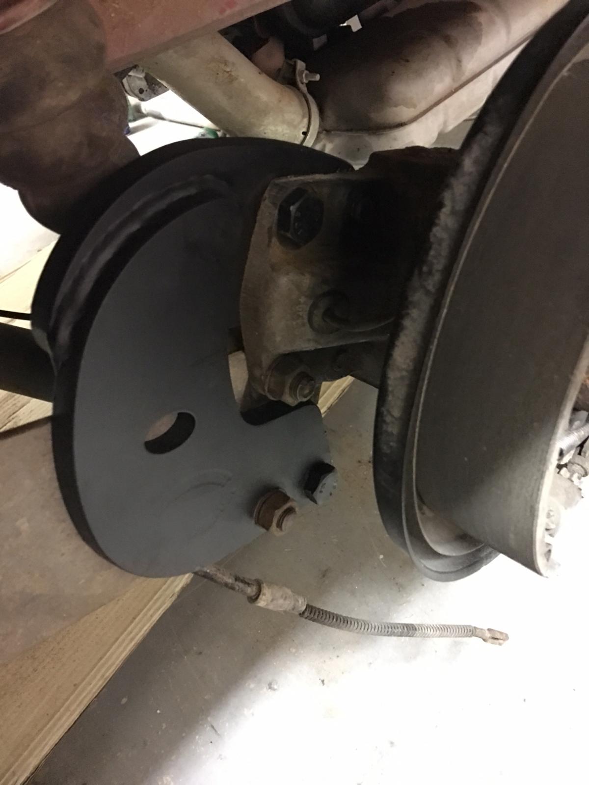

Next up was the rear. The horseshoe plates went on pretty quickly. They are pretty much a bolt on affair, and progress was only slowed by a full service and boot replacement of the CV joints, and an RnR of the rear wheels bearings for a grease repack and new seals. Here is a shot of the plates installed prior to the ebrake cables going back on. You do have to cut a small hole through the spring plate for the ebrake cables, but that is a pretty quick job.
Once finished with the front and back, I bolted up the wheels and got it down an all fours. After some fine tuning on the front adjusters to level things out, I landed here:
Since I've already had a chance to live with it at this height for a while, I can confidently say that I'm completely happy with how it came out. I'm at the practical limit height wise for me, without doing any body mods (which I wanted to avoid for now). With some 15's and shorter tires I could go lower, but I love the look of the 17's, and right now my tires are essentially stock diameter which doesn't change my gearing. The ride quality is truly as good as it was stock, and I have no real issues with tire rubbing. To be completely transparent, I do occasionally get a small rub up front on really BIG bumps if the Bus if fully loaded, but by and large no rubbing.
After a trip through the alignment shop to get everything dialed in, it was ready to drive out to its first show, the 2017 VW Harvest in Austin.

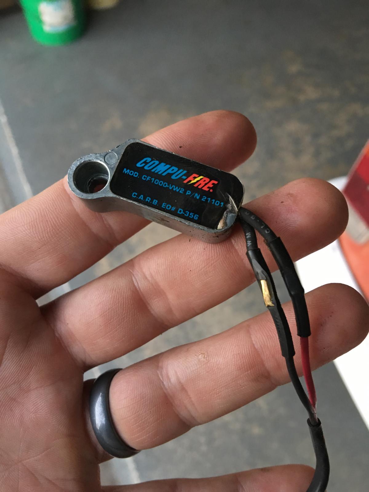

Up until this point I had been driving the Bus without a single hiccup. Unfortunately on the way home from the Harvest that changed. While on the way back from the show, I started to randomly get some cutting in and out from the engine while cruising on the highway. It was always a quick breakup, and would go right back to normal after a miss or two. I pulled off the freeway and into a parking lot to check it out, but couldn't find anything wrong. After getting back on the access road and running up another light or two, it finally died and stalled out all together. After getting it safely pushed out of the intersection, me and a friend who I was caravanning with started to investigate. I first suspected a fuel issue, but a quick pull of the fuel line proved that the filter was clear and the pump was getting fuel. The fuel pump felt a little hot, but otherwise seemed to be working. After a bit of fiddling trying to identify the problem, it magically fired right back up with no apparent fault identified. The rest of the trip home was fortunately uneventful. Back at home I dug into it further determined to find the actual cause of the issue. I hate trying to ID intermittent problems. They can be tough to find. Fortunately after tearing into the distributor, I found the smoking gun.
Apparently the wires to the ignition module were a little slack under the cap, and one of the wires had its insulation rubbed off by the trigger wheel on the distributor shaft and was shorting out, thus killing the ignition. A quick repair using heat shrink and improved wire routing, and I was back in business. Hasn't missed a lick since.

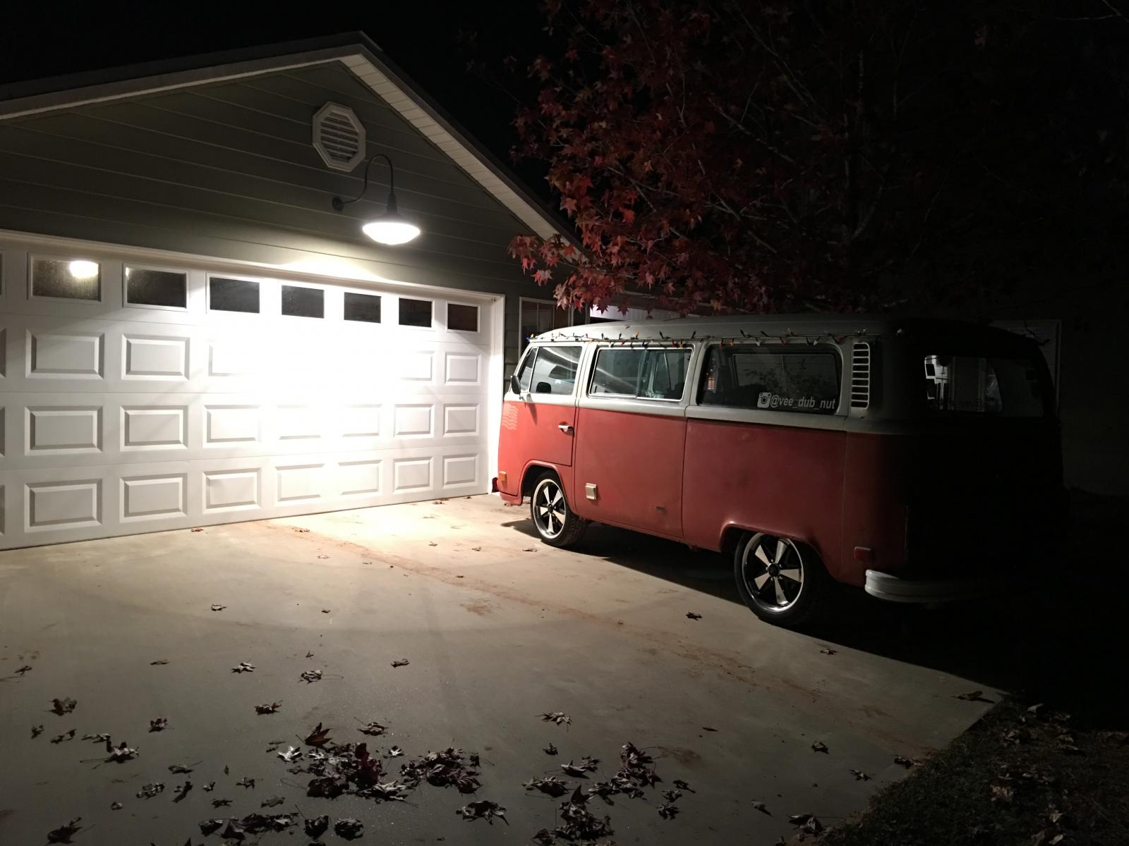

Not long after that Christmas rolled around, so I picked up a set of lights and set about decorating for our family Christmas light cruise. Let me tell you, if you don't get enough attention driving a Bus as is, put some Christmas lights on it. We got a kick out of all the smiles, waves, thumbs up, and pics taken of us as we cruised around. It was a riot. Next year I need to add some speakers outside and play Christmas music
With everything working smoothly, I somehow managed to talk my 7 month pregnant wife into taking the Bus "home" to visit family for our Christmas vac trip. We rolled out of San Antonio for the 2.5hr drive back home late Thur afternoon before Christmas. We stayed off I-10 and cruised the small highways through small towns like Gonzales, Shiner, and Halletsville. This made for a wonderful drive, as all of these little towns do up Christmas big with lights, so there was lots to see. We pulled off for a quick pick in Halletsville by the court house.
After a nice easy drive we made it all the way to Grandma and Grandpas, and settled in for the Holidays. While we were there I got to take all the nieces and nephews for a ride into town in the Bus. They had an absolute blast. It sure was fun watching them experience the Bus.

Question about the kids y-harnesses and latch mounts for car seat: how and where did you install them?
Could I trouble you for photos of those mounts?
Thanks.
James _________________ 69 Westy |
Back to top |
Vee Dub Nut Samba Member
Joined: April 25, 2004 Posts: 1190 Location: Dallas, GA
Posted: Wed Jan 31, 2018 8:04 pm Post subject: Re: Vee Dub Nut's 74 Bay Transporter (& Subaru EJ25 Swap) |
appetite wrote: |
Cool bus!
Thanks.
James |
Thanks...
So the harness and latch points are two different things, but use the same mounting hardware.
For my "latch" mounts, I installed two of them on the middle bench to mount one of the car seats. The latch mount bolts in on the same holes as the seat belts do. In fact I have both the seatbelt and latch mount bolted in together. Just required a slightly longer bolt, and a spacer between the two bolted segments. Note, I also had to buy some longer latch straps since the clips now have to reach all the way to the floor.
For the kids Y-harnesses, they use the same latch style mount for the harness to clip in to, but I had to drill holes and mount them to the rear deck over the engine. I mounted them right in next to a structural rib of the rear deck, so they are good and strong.
Here is the left side without the rear mat in place
And here is the left and right sides with the mat back in.
The only real downside is that they interfere a bit with cargo in the back. Not a huge deal, but something to consider. I think the added safety is worth it though.
I used these harness in my old Westy to, but the mounting scheme had to be different due to the cushions/cabinets. I really like these harnesses, as they offer a lot of added protection and work well with existing lap belts. The harnesses can be purchased here:
https://www.apartswarehouse.com/product/show/1688/universal-harness-passenger-vehicle
Note, they also offer a larger y-harness for bigger kids too. They spec them by the Childs weight.
https://www.apartswarehouse.com/product/show/726/universal-harness-for-standard-vehicles
