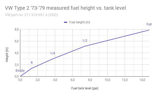

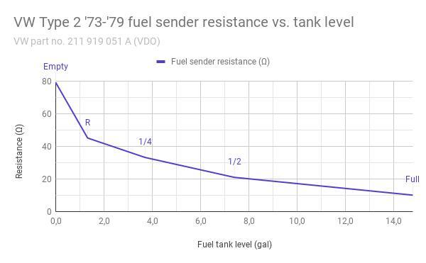

A while ago I calibrated my fuel sender with the fuel gauge, and while at it, I did some measurements and took some notes. Recently, a question about the Late Bay sender prompted me to take some additional readings and to put those notes into this post.
Note: as far as I know, neither VDO nor VW published the sender specs –other than perhaps specifying its min and max resistance. I'm sharing the values I measured as orientative measurements in the hope that they can help others to either calibrate or diagnose a bad sender. I do not claim them to be the nominal values from the manufacturer. Depending on the sender itself, the matching gauge and how well the gauge's voltage regulator steps down and regulates the battery voltage, the gauge reading might vary from bus to bus.
Here's a visual summary:
Here's the data:
Code:
Fuel tank level (l)  Fuel tank level (gal)  Fuel sender arm angle (°)  Fuel height (mm)  Fuel height (in)  Fuel sender resistance (Ω)  Fuel level status
56                   14,8                   60                         200               7,9               10,1                        Full
28                    7,4                   40                         130               5,1               21,0                        1/2
14                    3,7                   25                          75               3,0               33,2                        1/4
 5                    1,3                   12                          35               1,4               45,1                        R
 0                    0,0                    0                           0               0,0               79,1                        Empty
Here are the diagrams:

For those of us who use SI units, here's also the metric version of the diagrams Smile

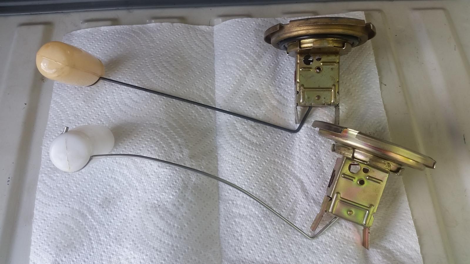

Please note the wrench in the fan:
Many replacement senders are using linear potentiometers versus the original senders which used exponential ones:
The original potentiometers have the slow drop in resistance between full and 1/2, then the speeded-up reduction down to empty. This of course mirrors the gauge which has a short distance between full and 1/2, and that streeetch to reserve.
I have an annoying replacement sender in my 1977 now. Even after adjusting the gauge head, I have a stunning drop in the displayed gauge reading from full to 1/2 in only three actual gallons consumed, then it levels out to an actual 1 gallon remaining at the indicated reserve mark.
Please note, do not bend the float arm too much in your effort to get the gauge to read full. Better to try a slight adjustment on the full-stop tab, then go directly to the gauge for a tiny tiny little nudge of the range screw.

If any one has a busted OEM late Bay sender as Colin shows I would love to play with it and come up with a decent rebuilding how to.
Would you like a photograph of a disassembled burnt up one?
I threw it away. I hope I don't regret that.
Please note, the wire is coiled tightly. I do not understand the loosely wound units where the sweeper can snag each strand!
Colin

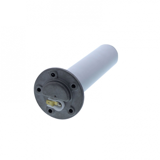

Haw, I have been shown how a Gia and bus sending units from the 60s- mid 70's bu never was curious about the resistance...hahahaaaa
Straight wire type.... 8-80 ohms. Never dissected it to see how the piece of wire can present that kind of resistance.
https://www.jbugs.com/product/271919051B.html
