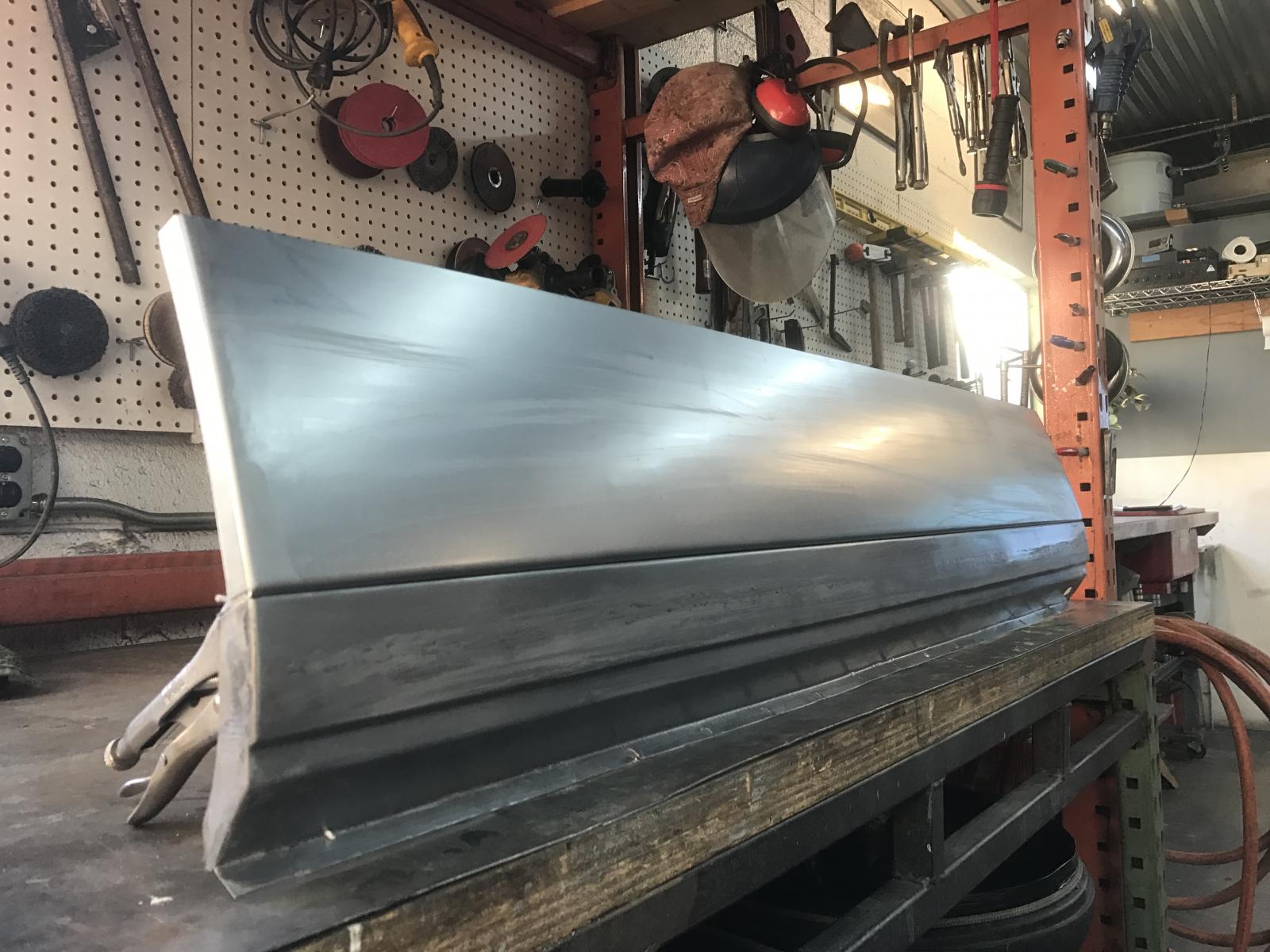

I have some metal from a couple different dist's, and I have found that the best looking stuff I have has come from https://www.brickwerks.co.uk/ in UK. Hands down, top notch stuff. Worth paying for the metal, and the shipping. Widest selection too, from memory.

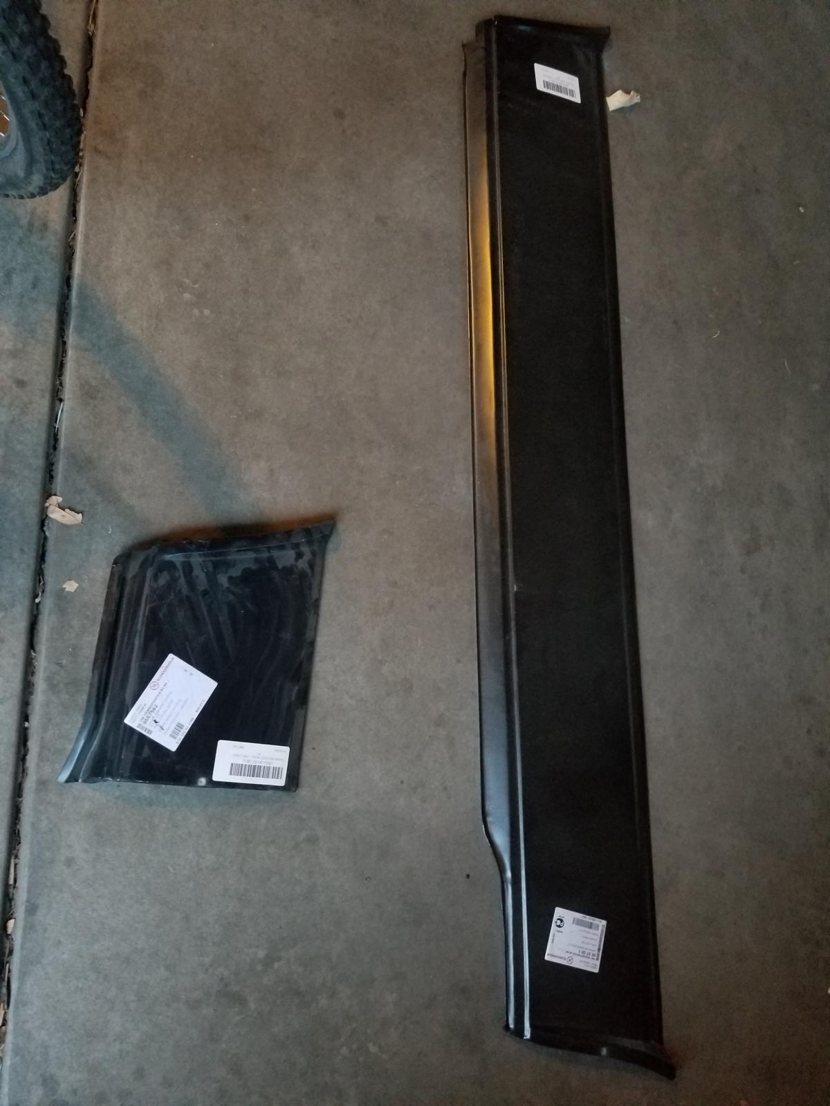

I got driver's side lower body panel from Bus Depot (kitchen rust repair) which worked out great for me. It has a fake seam where the rusted seam was but it blends in very well.
I also got this right rear wheel arch panel (made Klokkerholm) but ended up not using it. Seems pretty decent.

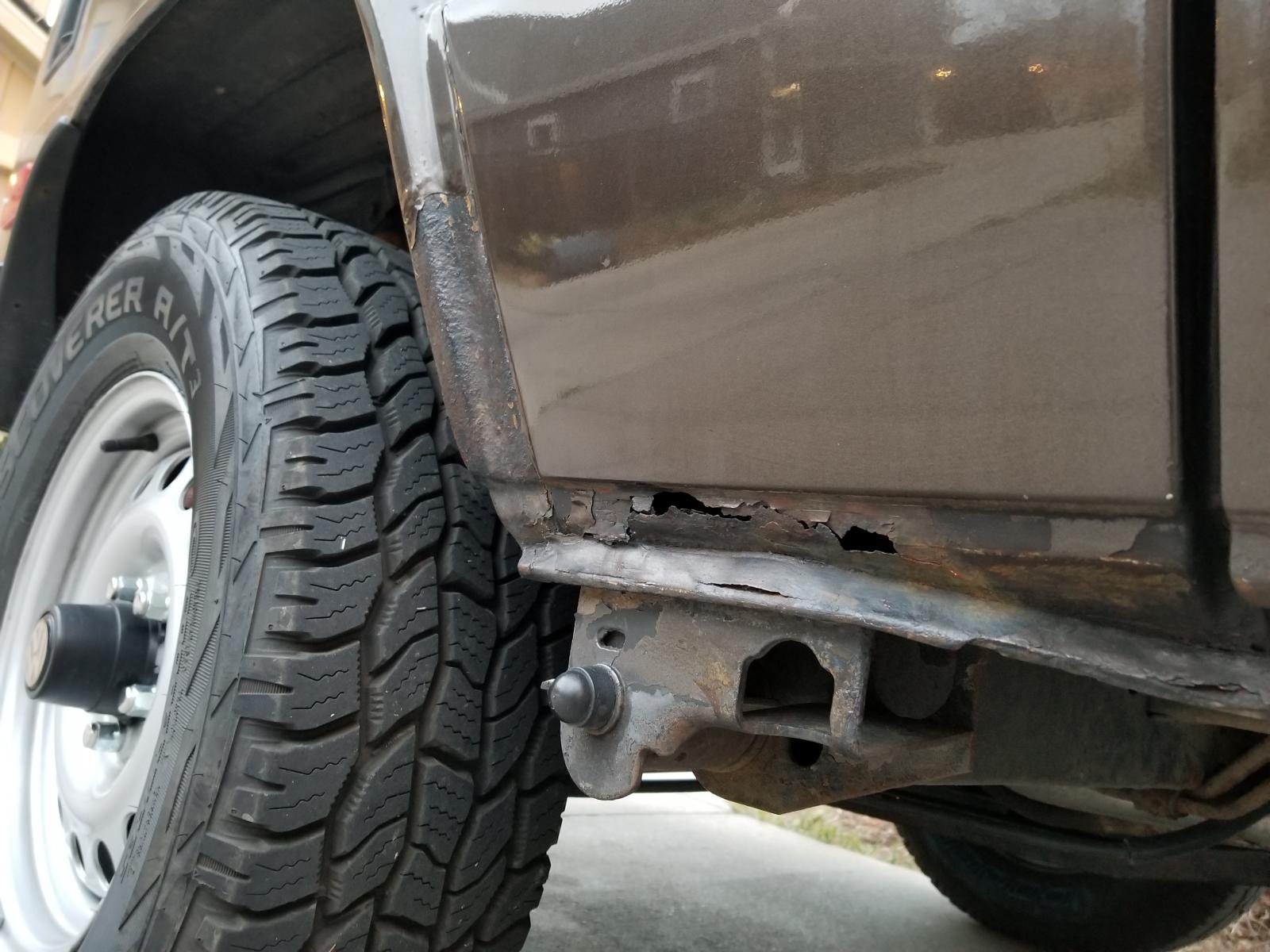

The Klokkerdoodle rear fenders are one of the few pieces they make that fits like a factory part. It is a little bit on the thin side at 20G. Factory outer panels for Vanagons tend to be in the 18G realm or close to 1mm.
Their section which goes just aft of the rear fenders is a pretty decent pressing as well.
I don't care for their long-side rockers due to the fact that it eliminates the seam. I prefer my panels to fit like the factory intended. Another downside is that you won't be able to metal finish the upper weld because the lower rocker is attached and it doesn't leave any space to put a dolly behind the panel. I prefer making the upper on the long-side for these reasons, plus it's 18G:
I'm not sure if there is a decent pressing of the lower rocker. In the pic above I replaced the upper half of the lower rocker.
Seam rusted areas which don't require an entire panel get repaired with 18G:
