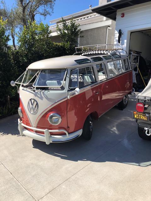

This past weekend at Mecum's in Pomona I was the lucky winner of this gorgeous 1959 23 window. Finally, after years of wishing, hoping, wanting...I am a 23 window owner!
https://youtu.be/lvlanU3HqGM?t=7h8m45s the video starts with the bus rolling onto the auction block and the back and forth bidding.
She needs some minor things but she has the semaphores in working condition, her original tiny engine and most all logo glass. She needs to go into the shop for some minor stuff but expect to see her in the coming months!

Congrats!!! Very nice bus, but shouldn't it have just blade bumpers, not overriders. What is the import country on the birth certificate? _________________ Visit http://www.singlewheel.com |

No clue on the build, sadly. It went to auction through a used car dealer in Perris, Ca, but when I called them they basically blew me off.
The birth certificate calls for that bumper package so it should be correct. |

When say body tag, do you mean the M-code plate behind the passenger front seat or the VIN tag in the engine compartment?
Weird for an LA-delivered Bus to have semaphores but a USA/N. American Bus would normally have bumper overrriders and the other options listed there.
Except for the reverse lights, that is for 67s.
The birth certificates often include things that were for later Buses.

Congratulations on your purchase, it looks like a very nicely done restoration. Your bus should not have semaphores, as it was originally delivered to the US. US spec buses in 1959 came with bullet front turn signals and no semaphores. The bumpers you have with the over riders are correct. _________________ September 1964 Standard Sunroof walk through SWR/BG original paint. |

Will post some more pics later today. I know, I was shocked to see semaphores too but there they are!
It doesn't have the tag in the engine compartment nor one behind the seat. |

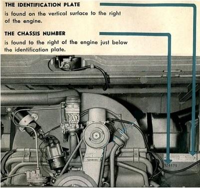

nestbedding wrote: |
But the VIN on the frame ... |
Does your number on the "Identification Plate" match the "Chassis Number?"
Pic please of that area if you have time...

I don't think the I.D. plate exists on the bus _________________ Oil Capital Air Cooled

No plates in the motor compartment, no plate behind the seat. The VIN definitely is stamped correctly and worn so there is no funkiness with that. |
