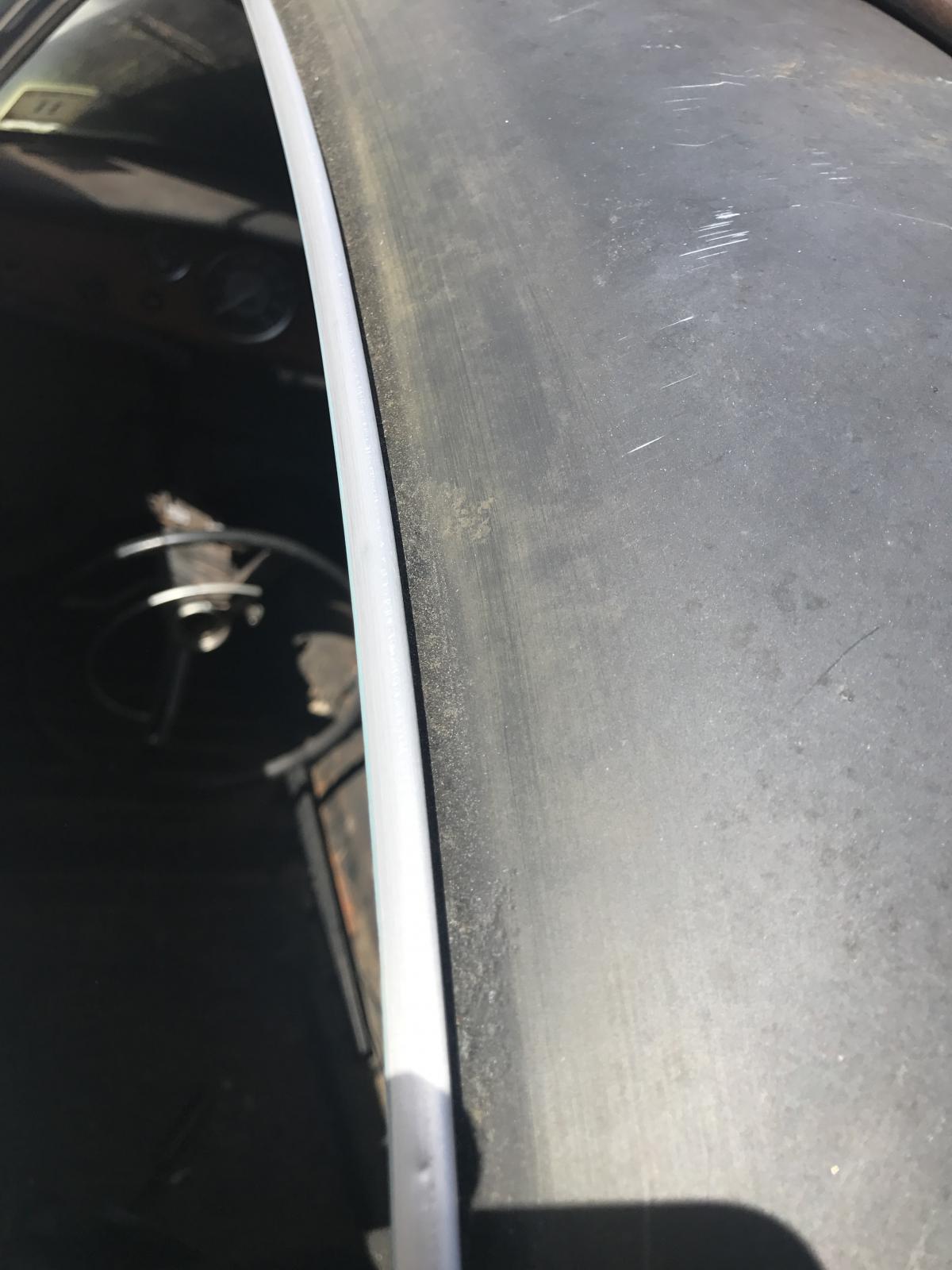

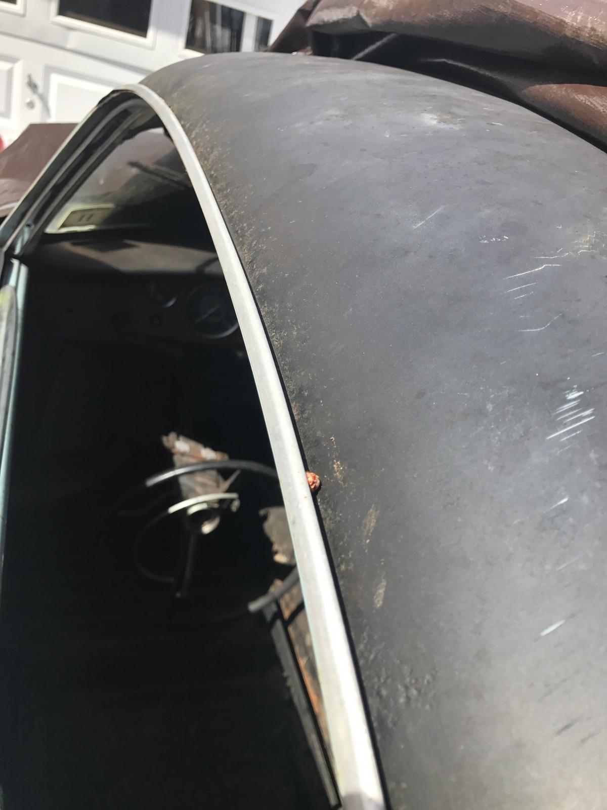

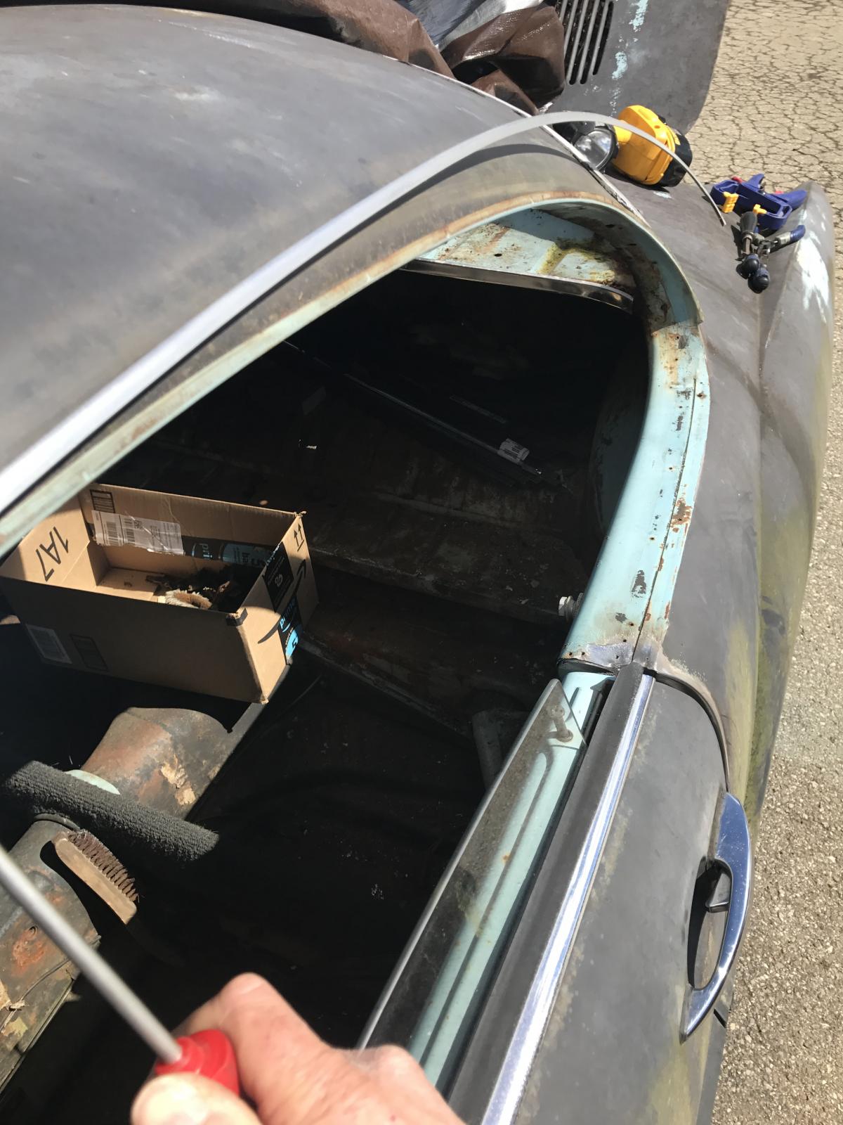

I have a 69 Coupe with the polished (or used to be) metal rain gutter trim.
My question is, how do you safely remove it?
It has seen it's hard knocks, minor dents, abrasions, etc but being almost 50 years old, it is looking good!
Who at 50 doesn't have a little bit of physical road rash?

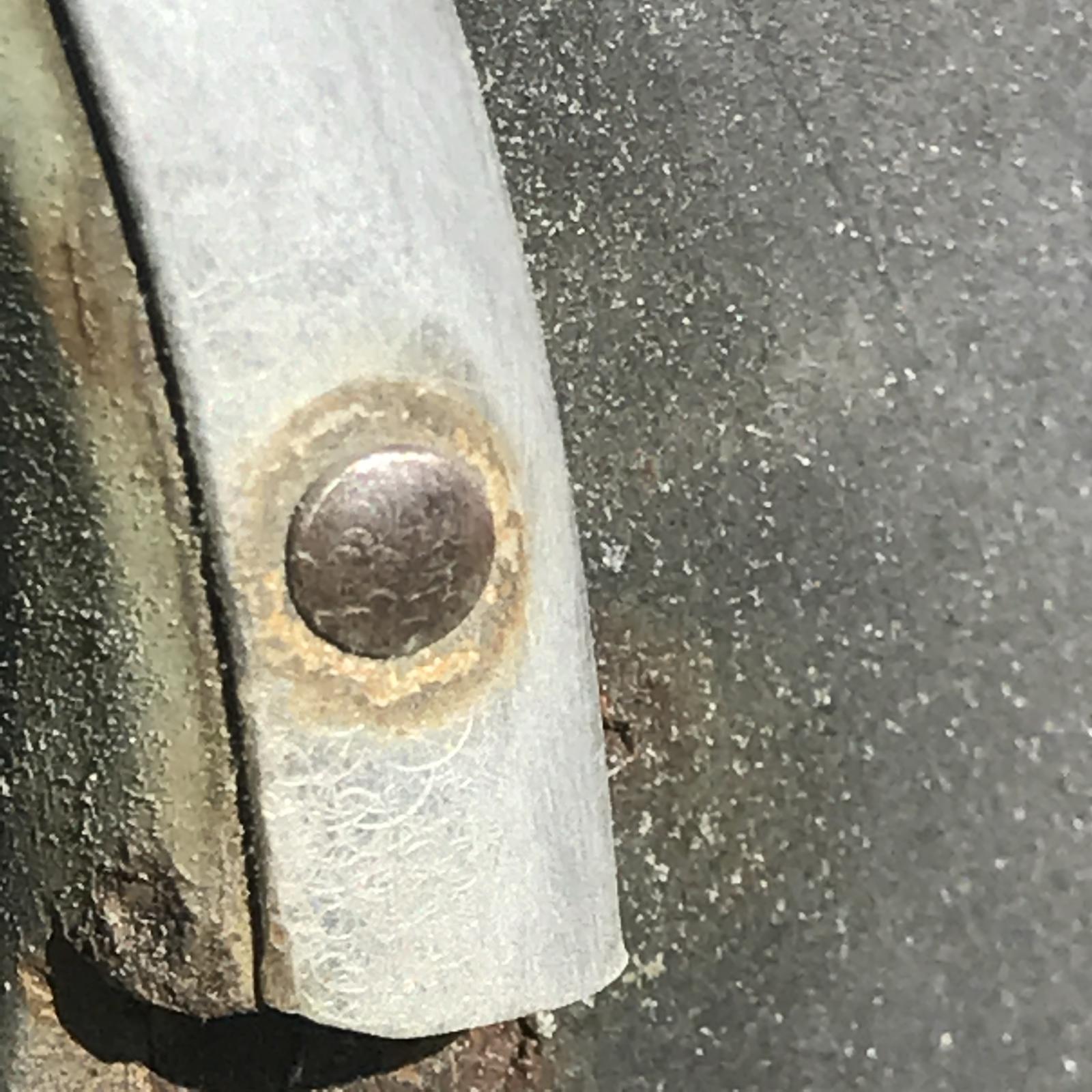

I see a Brass Rivet at each end securing it to the roof gutter.
Just accurately center punch it and carefully drill it out? Slip a sacrificial piece of metal behind the rivet so as not to drill into the roof and paint when it breaks through?
I took a 3M scotch brite pad tomit, rally shined it up!
And the Brass rivet.....

I went at the grime with a brush and found that the "Rivet" is actually more akin to a Cotter Pin!
Push it in, and spread the two bits apart on the back side....... (I had to reword this a few times to make it "family friendly" Laughing )

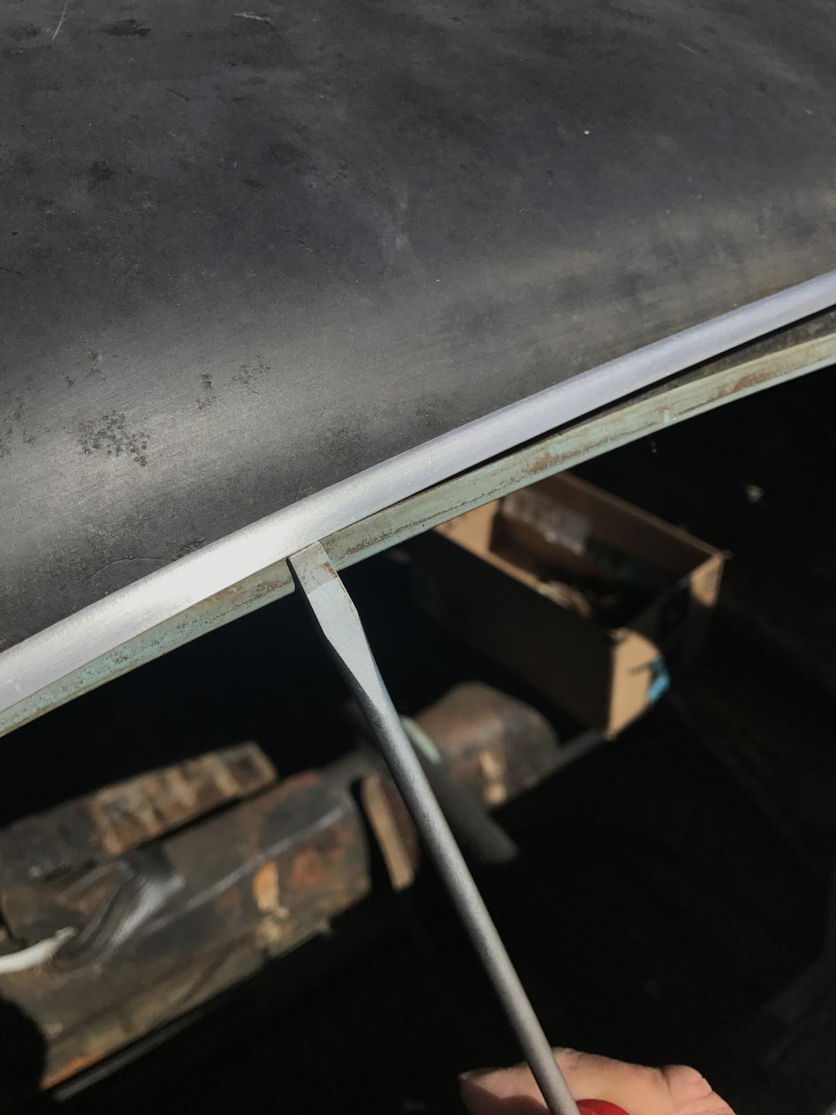

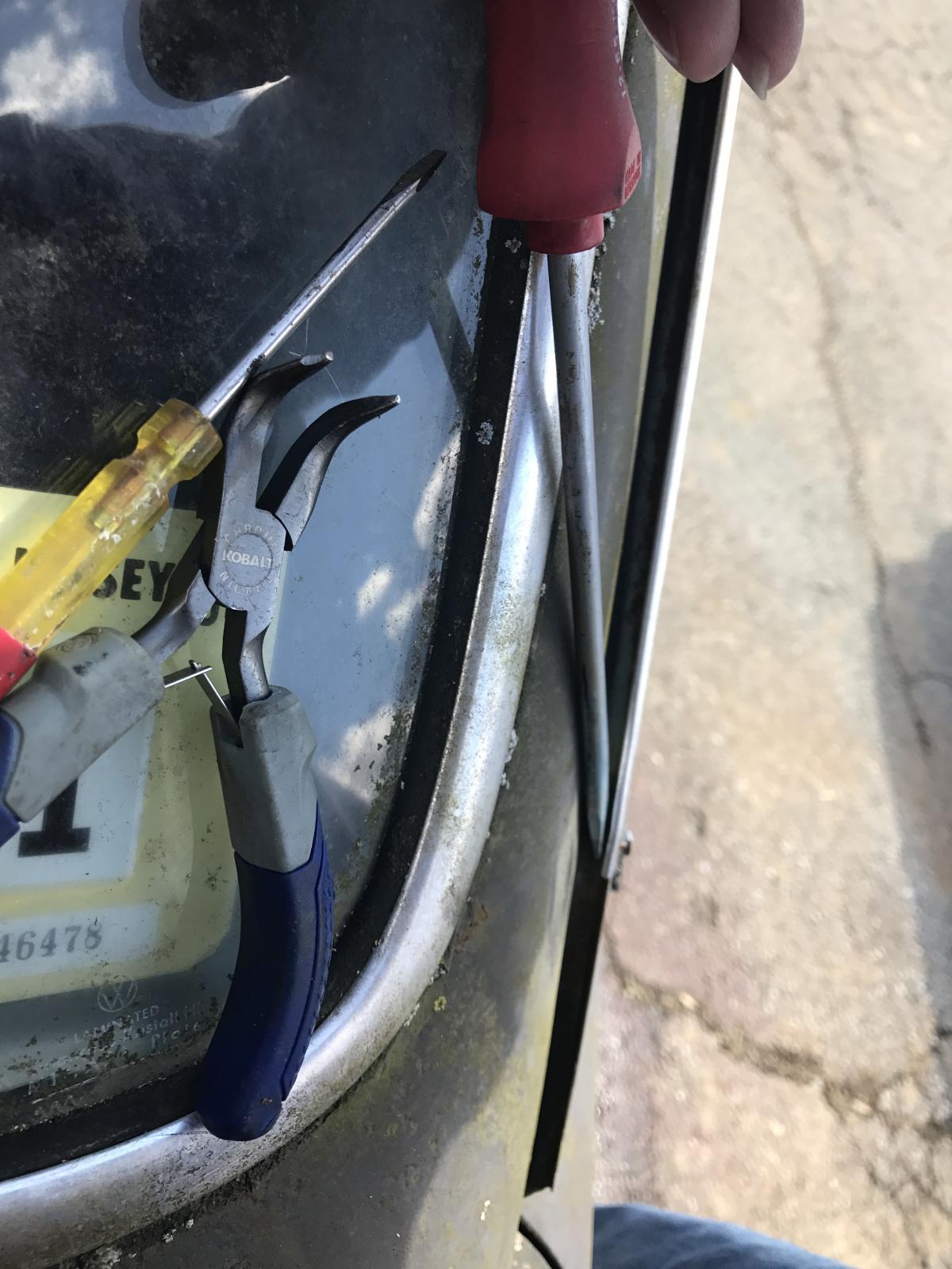

Using a small jewelers size of 90° needle nose pliers, a small screw driver and a small 45° dental pick, I was able to pry up the legs of the "Rivets".
I then used a larger flat blade screwdriver and pushed the "Rivet" out a little.
Next I used a small brad puller and extracted all of the "Rivets".
Two of the four survived the operation.
I then used the larger screwdriver and very gently "Bumped" the trim up and off of the rain gutter.
Great Success!!
I think IF I were going to install these moldings, I would drill the hole for a small round head brass machine screw and tap it. I'm thinking a 4-40 or a 4-48 ....... maybe even smaller.

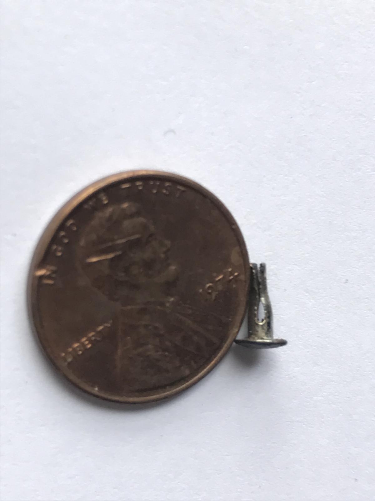

I like that..... "Split Rivet" term!
These rivets are 0.0815 (2.07mm) in diameter (a smidgen over 5/64" 0.0781)
Have a head of 0.1695 (4.30mm) in diameter (just shy of 11/64" 0.1719)
Have an overalllength of 0.280 (7.09mm) (just shy of 9/32" 0.2812)
A 4-48 tap requires a size #42 pilot bit. The overall diameter of the screw is 0.0935.
A 3-56 tap requires a size #45 pilot bit. The overall diameter of the screw is 0.0820.
Next to a USA Penny
