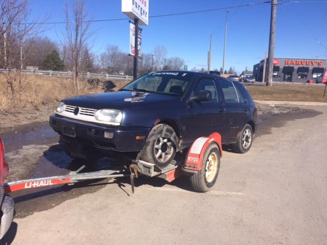

Not too much work done yet.
- Engine out of the van
- Engine out of the golf
- Harness mostly out of the golf.
Cost of the conversion so far doesn't seem like it's going to be too bad.

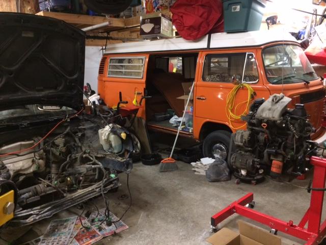

Update:
Progress is slow but steady. Family time is really getting in the way of progress. (Sarcasm... but true)
Engine has been pulled and the car sent to scrap. I was so excited to get rid of the donor car to open up my work area that I left the throttle cable and throttle position sensor in the car... Sad Hoping to get those from a u-pull scrap yard.
Started replacing a bunch of stuff on the engine, got a few wrong parts only to realize it was the wrong parts that I had ordered. Re-ordered and life goes on. The nice thing about having so many small tasks is there is never really a setback, I just have to work on something else. Like chiseling the rust off the block and re-painting it.
Much weeding has been going on with the harness as well, so far i've just about filled a 5G pail with scrap wire. Not done yet.
Got my KEP adapter plate fitted with a new clutch.
Slid the engine under the van and called it a day. Was getting late and had to get home to put the little one to bed.
Right now i'm looking for a fuel return line solution, anyone have a genius idea for me? I'd like to install a barbed fitting into the filler neck. For my '74 i'm not seeing anything that would be easy to T into and i'm not really interested in using a Y on the bottom of the tank. Maybe braze the fitting to the pipe?

Update:
This will be a short one but basically I got the engine withing 1/2" of mating to the trans. This was with the intake and coolant flange removed, and the breather crushed against the top of the engine bay with the perforated board and insulation removed.... Also the 1 pin sensor on the back of the head was touching the firewall and preventing me from closing the 1/2" gap. I ran out of time to monkey around with it, am I missing something? From what I read it should slide in @15 degrees. Based on my struggles it's looking like I need to slide the trans back and down about an inch in each direction. Even then it will be very tight to get the intake on and a horizontal coolant flange.
More to come.
