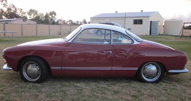

Posted: Sat Apr 14, 2018 12:53 am Post subject: 1962 Aussie RHD Resto |
I bought this 1962 RHD Karmann Ghia in June 2011:
It was in reasonable condition but the floor pans had been very poorly repaired and it had some dodgy accident and rust repairs in the past. It was fairly original but had a 1600 twin port engine, 12V conversion, front disc brake conversion, four stud wheels and mini minor headlights.
I drove it without changing things much for a few years but in April 2015 I started a body off resto. I have done a lot of work on it and have taken a lot of photos but never got around to starting a resto thread until now. _________________ 1962 Karmann Ghia

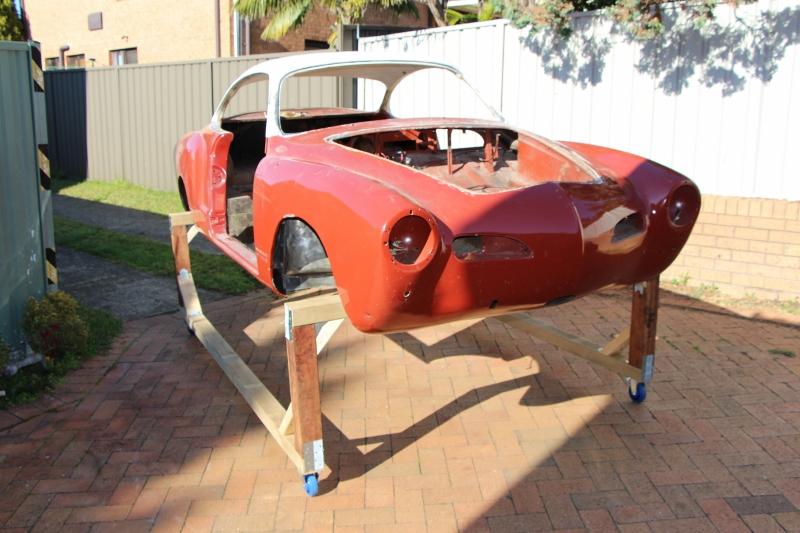

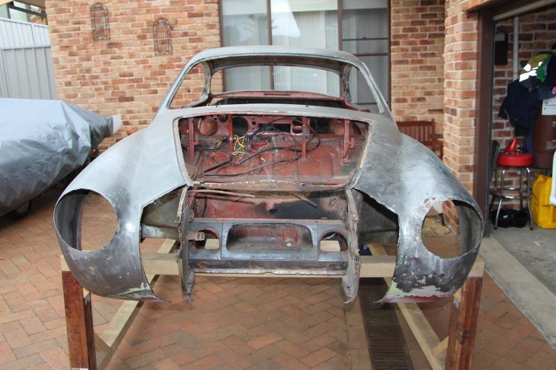

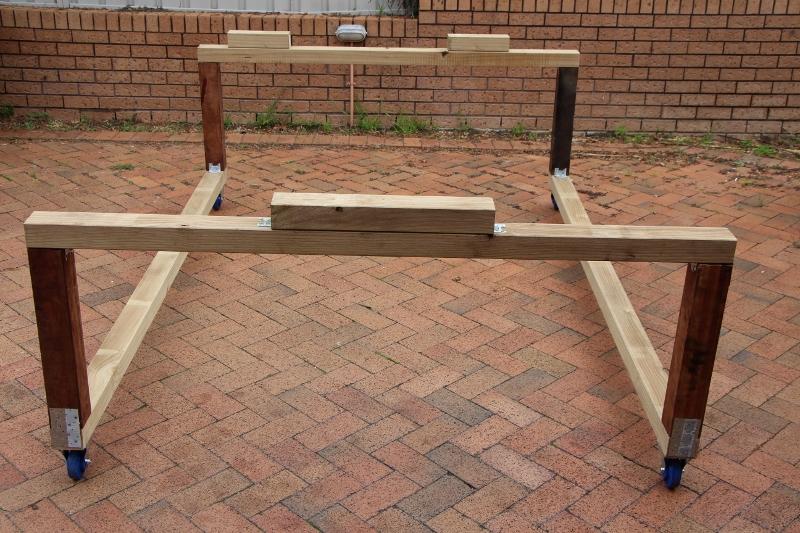

Posted: Sat Apr 14, 2018 12:58 am Post subject: Body Removal |
Body disassembled and ready to remove from the chassis:
Body dolly built and ready for body:
Body welded to the floor pan in a couple of locations so needed to be cut:
Body on dolly:
Chassis with body removed:

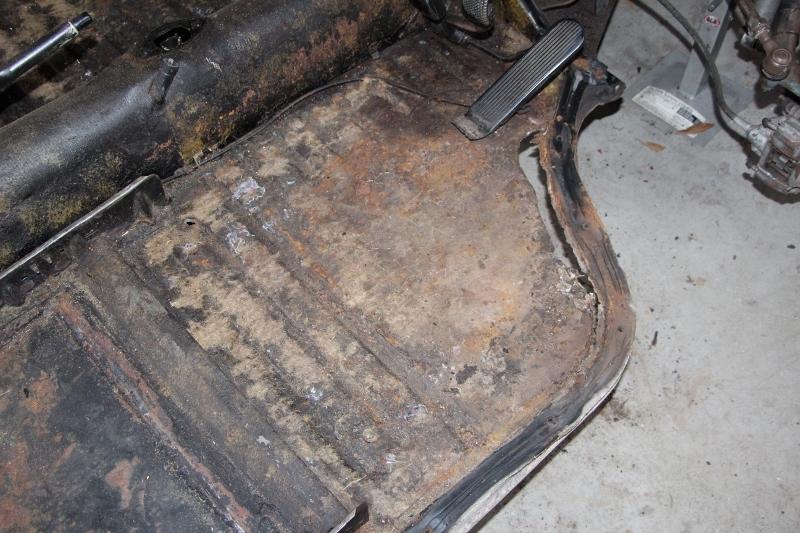

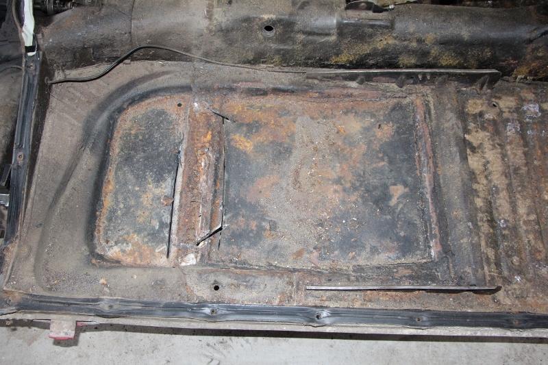

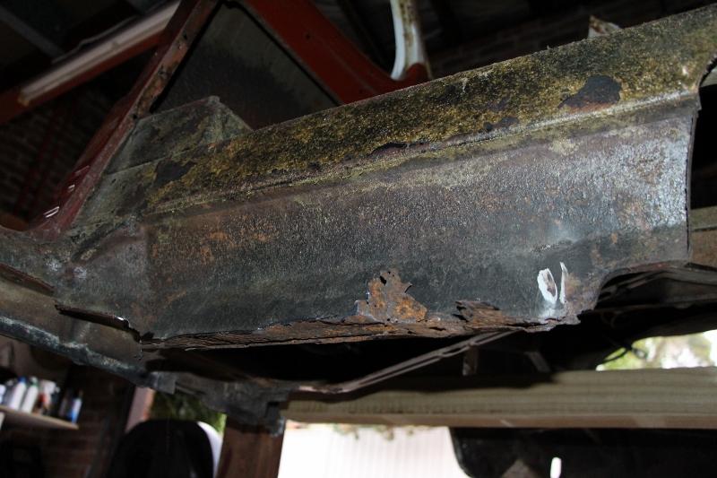

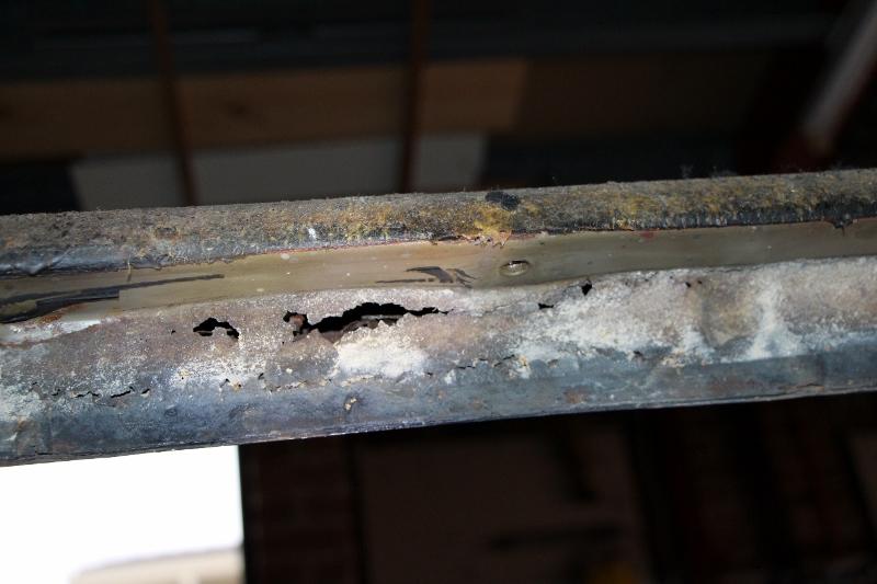

Posted: Sat Apr 14, 2018 1:16 am Post subject: Crustiness Revealed |

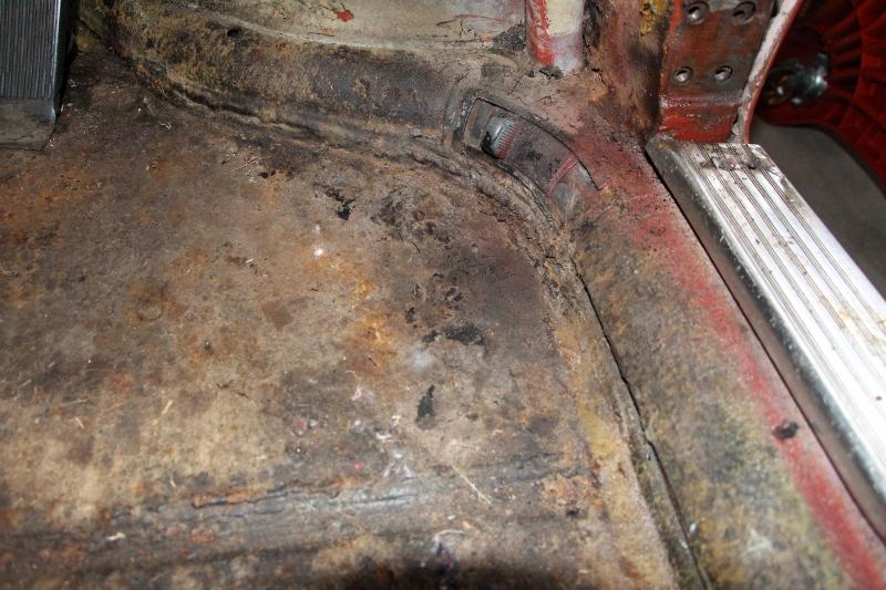

Crusty floor pans:
Crusty heater channel:
Crusty rear seat kick:
Dodgy tunnel patch welds:

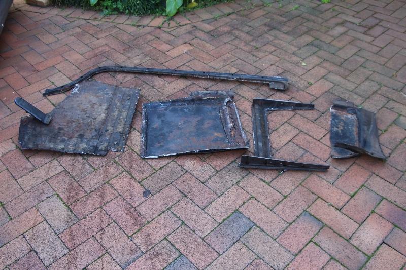

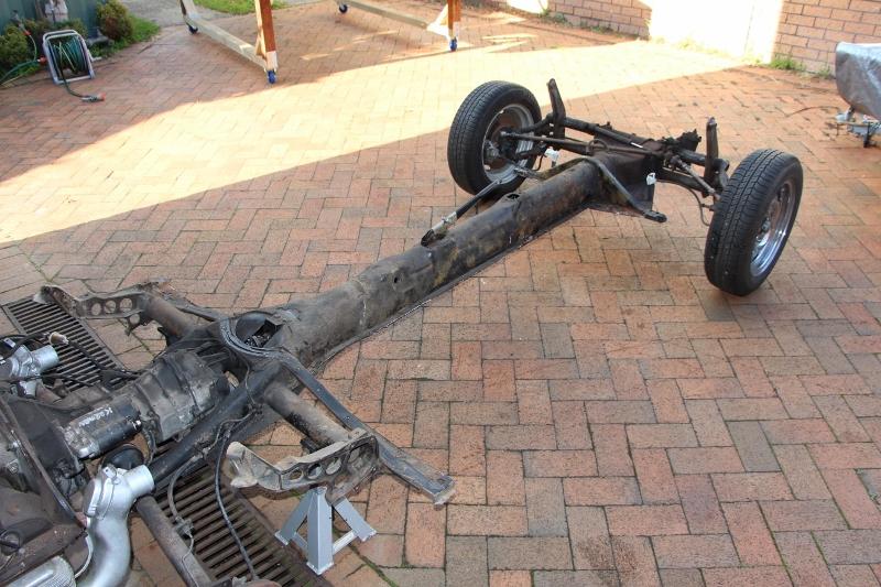

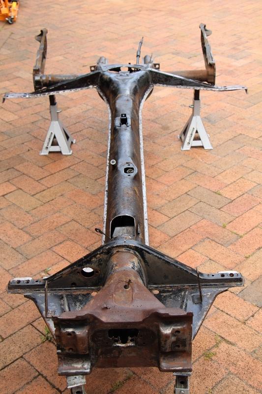

Posted: Sat Apr 14, 2018 1:23 am Post subject: Chassis Disassembly & Repairs |

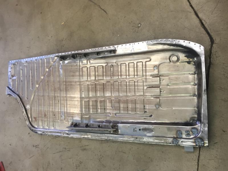

Floor pan remains:
Chassis with floor pans removed:
Chassis with engine and front beam removed:

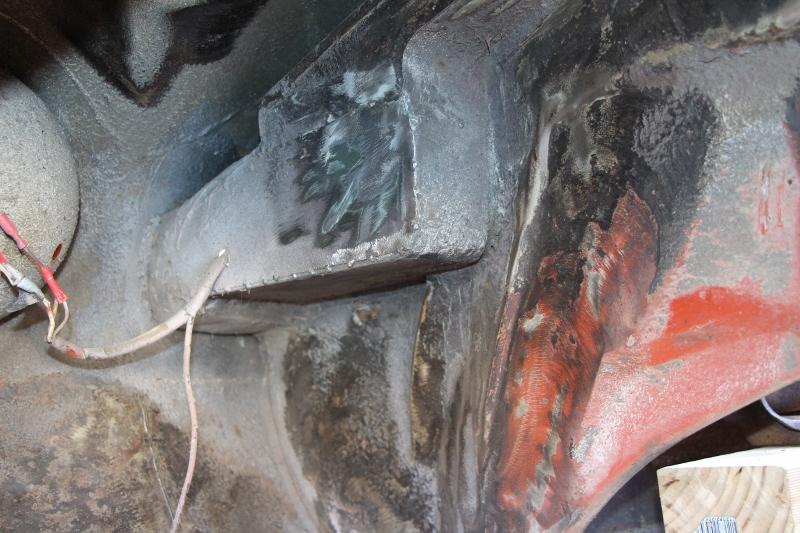

Dodgy factory welds on RHD pedal support:
Welds fixed and ground:
Tunnel patch repairs after checking clutch tube support ok:

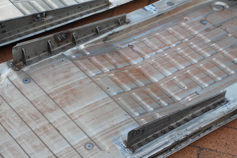

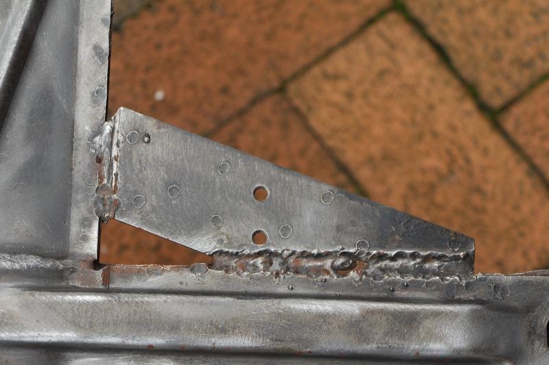

New hand made seat rails:
Seatbelt mounts:
Jack mounts (had to modify because depth of floor pan less than original):

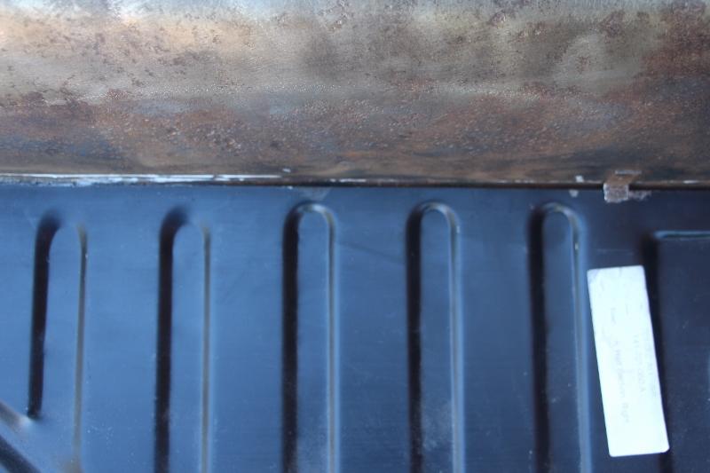

Floor pan first three ribs wrong (too close to tunnel lip):

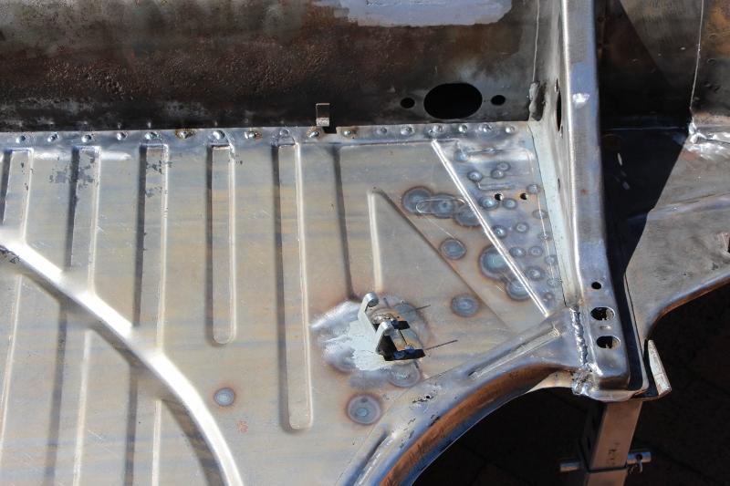

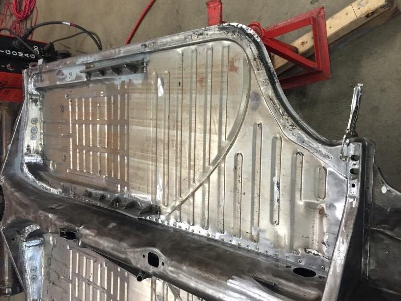

Posted: Sat Apr 14, 2018 2:48 am Post subject: Floor Pan Installation |

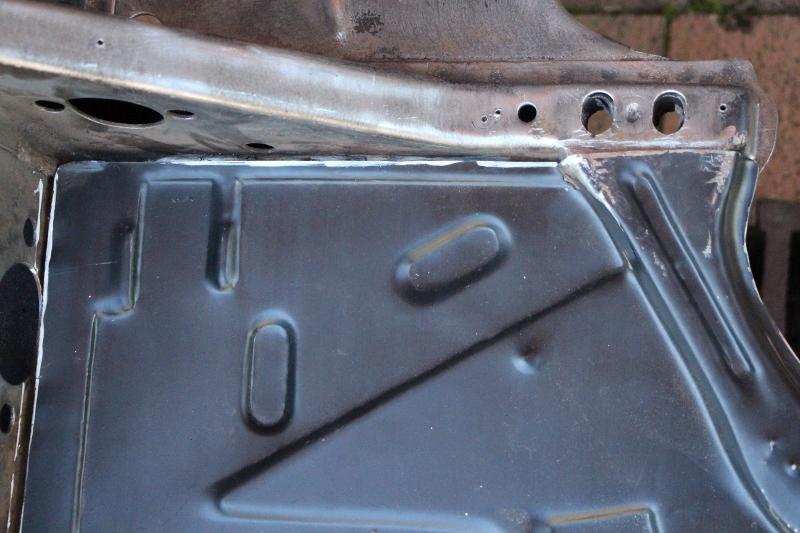

Modifications to pan pedal mount and ribs:
Seat rails installed:
Trial fit of seat frames:
Pans with attachments and plug weld holes ready for fitting:
Pans tek screwed in position ready for plug welding:
Completed floor pans:
Detail showing accelerator mount and modifications at front on driver side:

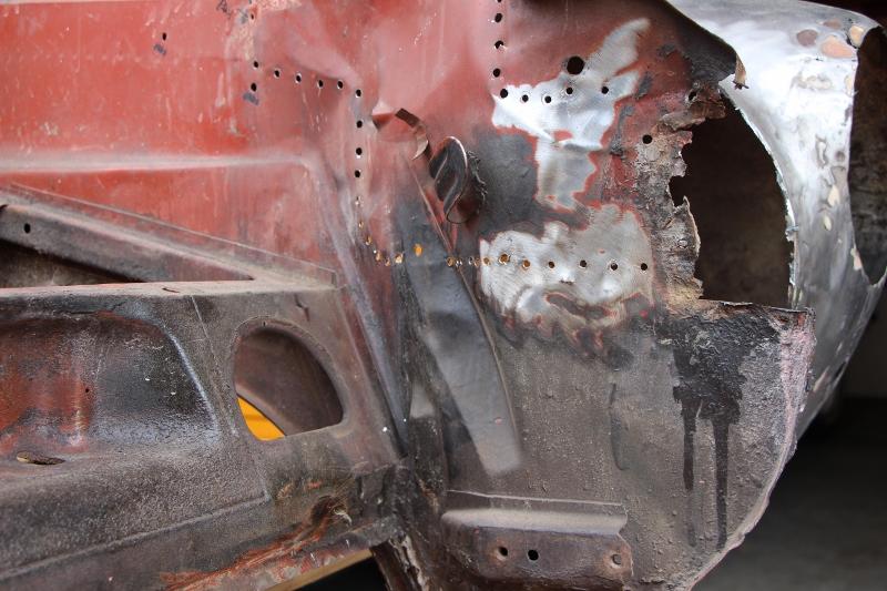

I removed the paint using a combination of paint stripper, strip discs and wire wheels. This car had been resprayed multiple times and each time they had used a lot of spray filler (probably because it is easier to do instead of block sanding between coats).
There was a lot of plastic filler (US translation: bondo) in some areas to cover the dodgy repairs. These cars have always been are fairly rare in Australia and it has never been easy to get used panels like in the US which led to dodgy repairs.
After stripping the paint on the body, the full extent of the dodgy previous repairs became obvious:
Rear driver side quarter major accident repair:
Front nose major accident and rust repair:
Front passenger fender major accident repair:
Headlight rust and mini minor headlight flange:
Front wing poorly done rust repair:
Passenger side ventilation duct previous poor repair:
Driver side ventilation duct rust:
Rear quarter to bumper support poor repairs:
Wheel well rust:

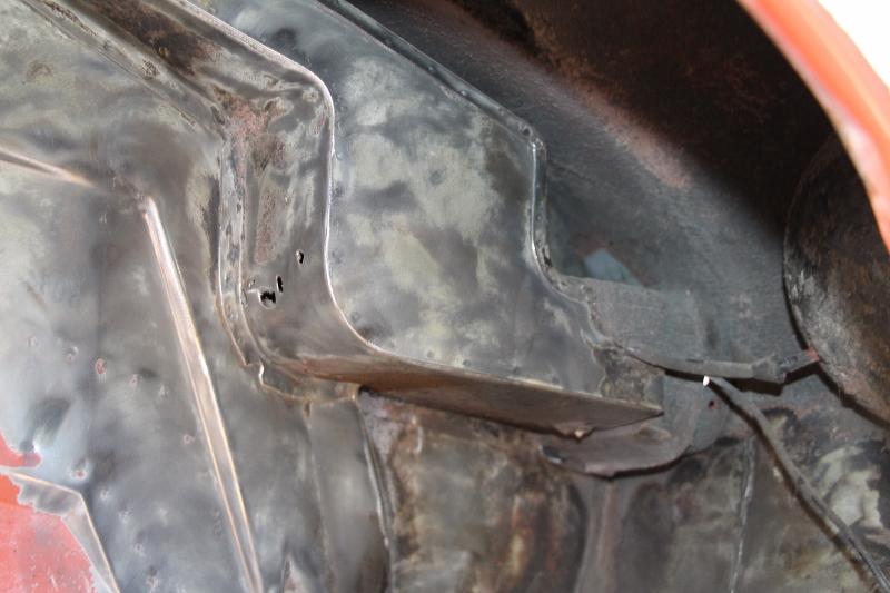

Posted: Sat Apr 14, 2018 4:43 am Post subject: Major Surgery |
The nose, headlights and spare wheel well all had previous dodgy repairs or rust so it had to go:
The rear driver side quarter had been poorly repaired multiple times and a repair section had been grafted on too low so it had to go:
The battery trays and wheel wells had rust and previous poor accident repairs so it had to go as well:
The heater channels were rusted and had previous poor repairs so I made up and fitted a body brace for when it was time to cut them out:

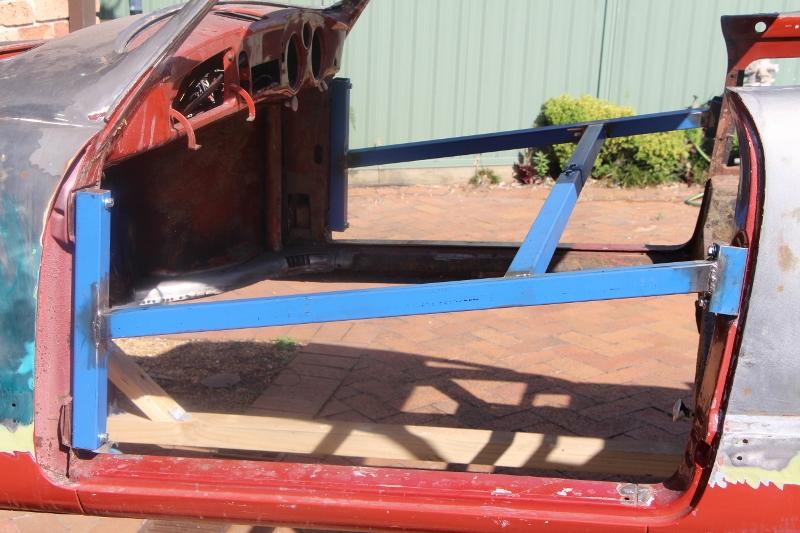

Yeah, the repro pans are disappointing and cause additional unnecessary work but they do the job and no one will ever notice that they are not perfect.
I was going to brace inside the body to allow the doors to be trial fitted but went with doing the brace inside the door aperture because I thought it would be stiffer and easier to install and remove. I hear what you are saying about trial fitting the doors but based on my experience replacing the heater channels (which I will get to soon) it doesn't make much difference where the brace is.
I trial fitted an original door skin while the body was off and the gaps were bad. Even with a rigid body brace, the body still has a lot of flexibility when it is off the pan, even before you remove the heater channels. I think if you trial fitted the doors and adjusted everything to be give good door gaps while the body is off the pan you would end up with bad gaps when it went back on. The best way would be to tack the heater channels in place, put the body back on the pan then trial fit the doors to check and adjust the gaps but I didn't do this.

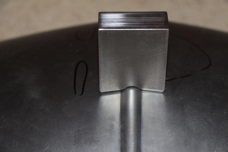

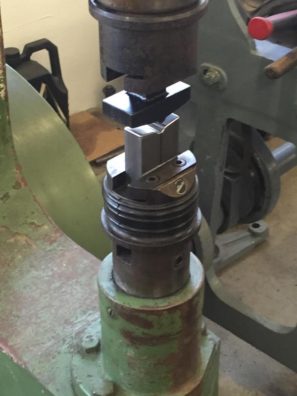

Posted: Sat Apr 14, 2018 10:42 pm Post subject: Nose Panel Preparation |

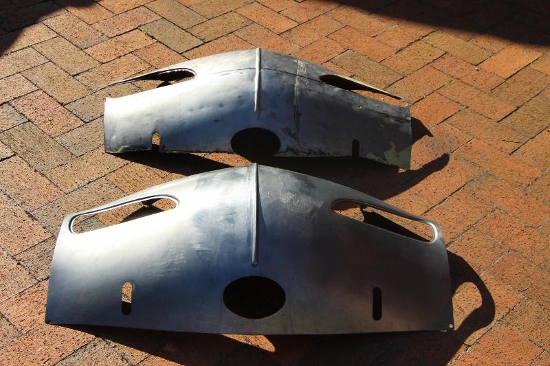

I bought a new nose panel but it was damaged a little in transit:
Also the profile of the ridge on the repro panel was not right anyway:
So I bought Danny Gabbard's nose ridge tool and milled the end so it would fit in the Eckold metal forming machine:
After cutting out the holes for the vents, horn and bumper irons the nose ridge was reshaped:
The nose tool worked well but we needed to linish the ends down because it was a bit too flat and left some serious tool marks at first and had to be fixed using a hammer and dolly then file finished:
The finished new nose and the old nose:

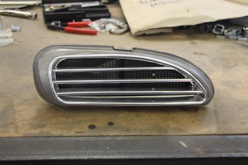

Posted: Sat Apr 14, 2018 11:33 pm Post subject: Vent Box Preparation |
The vent boxes come in two parts but do not have the cut outs, mounting tabs or drains:
I did the cut outs and drains based on the old ones:
The new versus the old:
I made up the vent mounting tabs and welded on:
I trial fitted the mesh and dilled the mounting hole:
I trial fitted the vent:
Then spot welded the two halves together:
Close up showing the drain and the tab joint:
