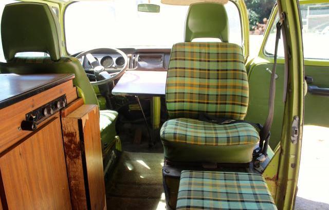

I was looking for a van that would help me to pass through the american continent and found a 1977 T2B Westfalia Berlin camper in sunny California december 2017. As you can imagine it was in a really horrible condition but... challenge accepted.

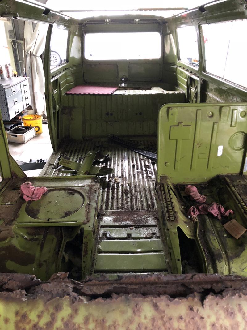

The first step was to bring the van back to germany and rip it apart to see what we're really up to:
Once we managed to get rid of all the interior and loose parts of the body, vantoshi received a sandblasting treatment to reveal all the whole mess:

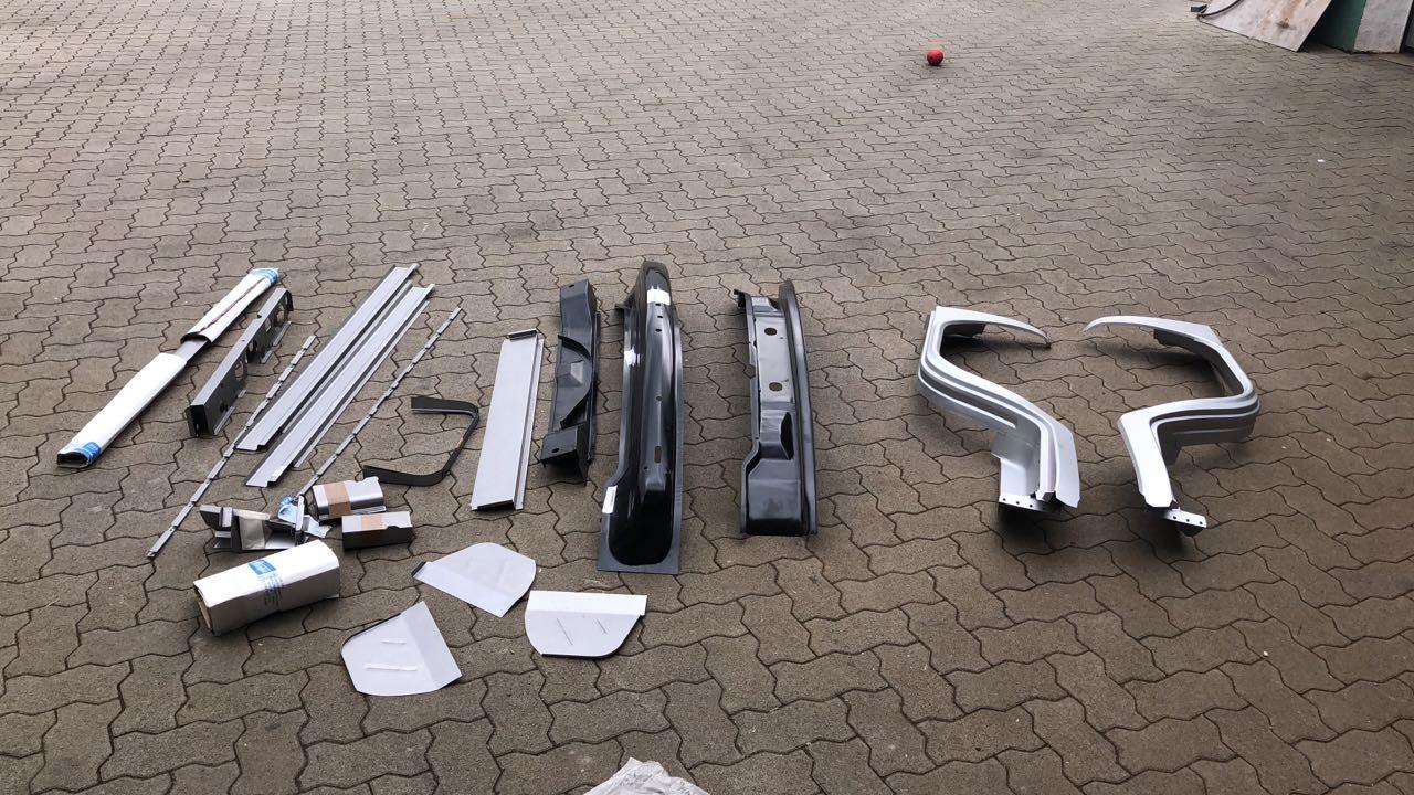

We quickly realized that we needed to get some new metal as a lot of vantoshis body did pretty much vanish completely:
Finally we could start to rebuild the chassis, let me tell you, it was one hell of a welding job. the black color comes from a anti rust treatment, so the sandblasted body will not start a new rusting cycle while we rebuild the body:

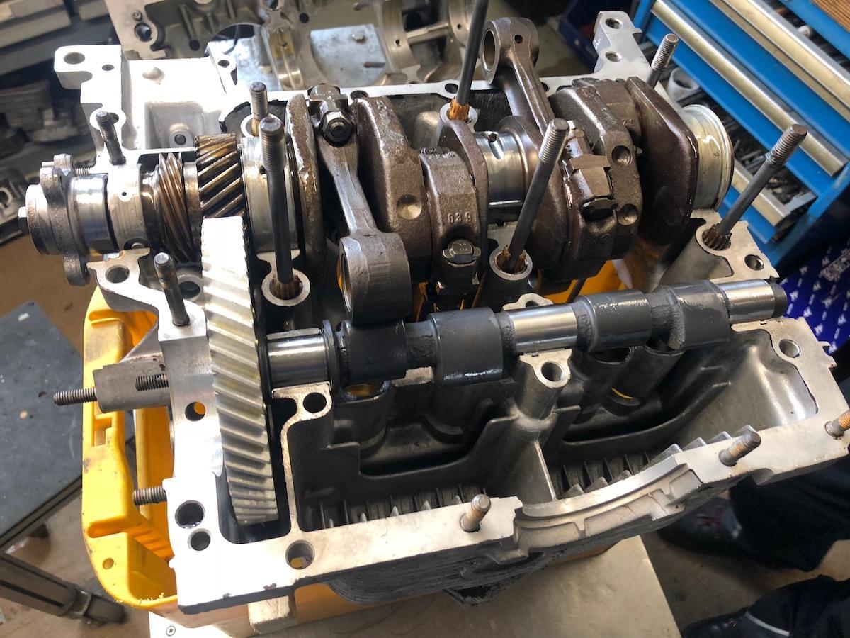

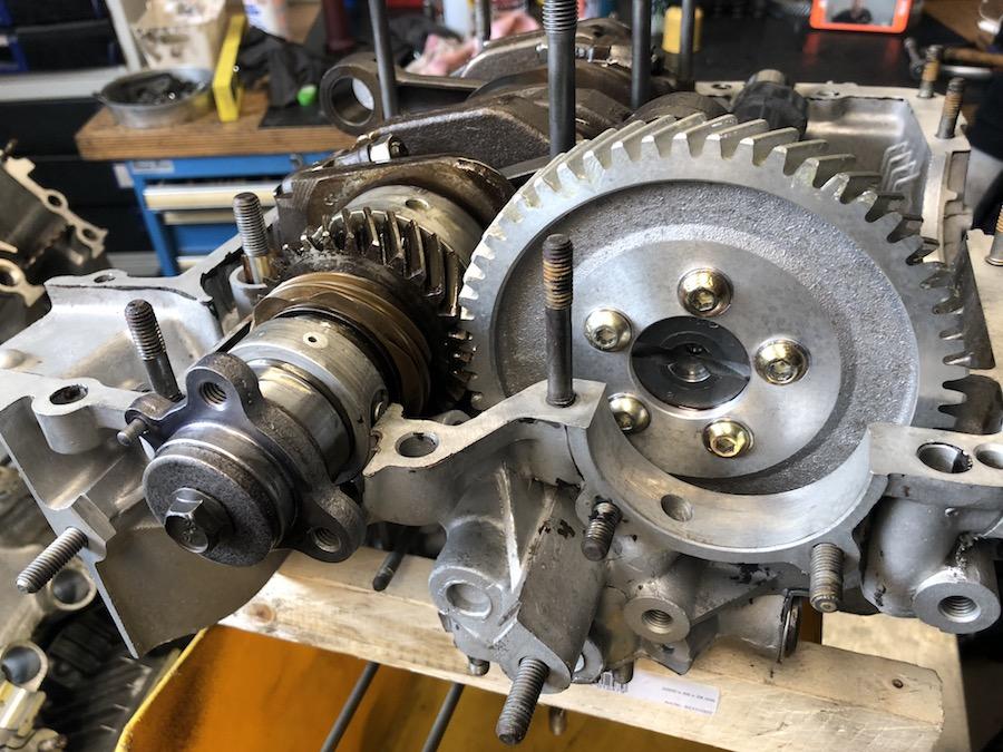

On our way over the american continent we'll be challenging very different conditions, hot/cold tempratures, high altitudes, so we wanted to have a reliable engine that will have the resources to handle all the obstacles. We decided to totally rebuild it:
With a lot of love and care, the original type-4 2.0 litre fuel injected 79hp engine got boosted up to provide enough power even while crossing the Atacama desert or being stuck on a sandy beach.
  • 2x Weber 40 idf dual carburetors
  • modified cylinder, cylinder heads etc. to enhance the engine displacement to 2.1 litres
  • performance camshaft
  • performance tappets & valve springs
This way the engine provides 100-100hp with increased torque and should always be able to master most of the pan-american challenges around the next corner.

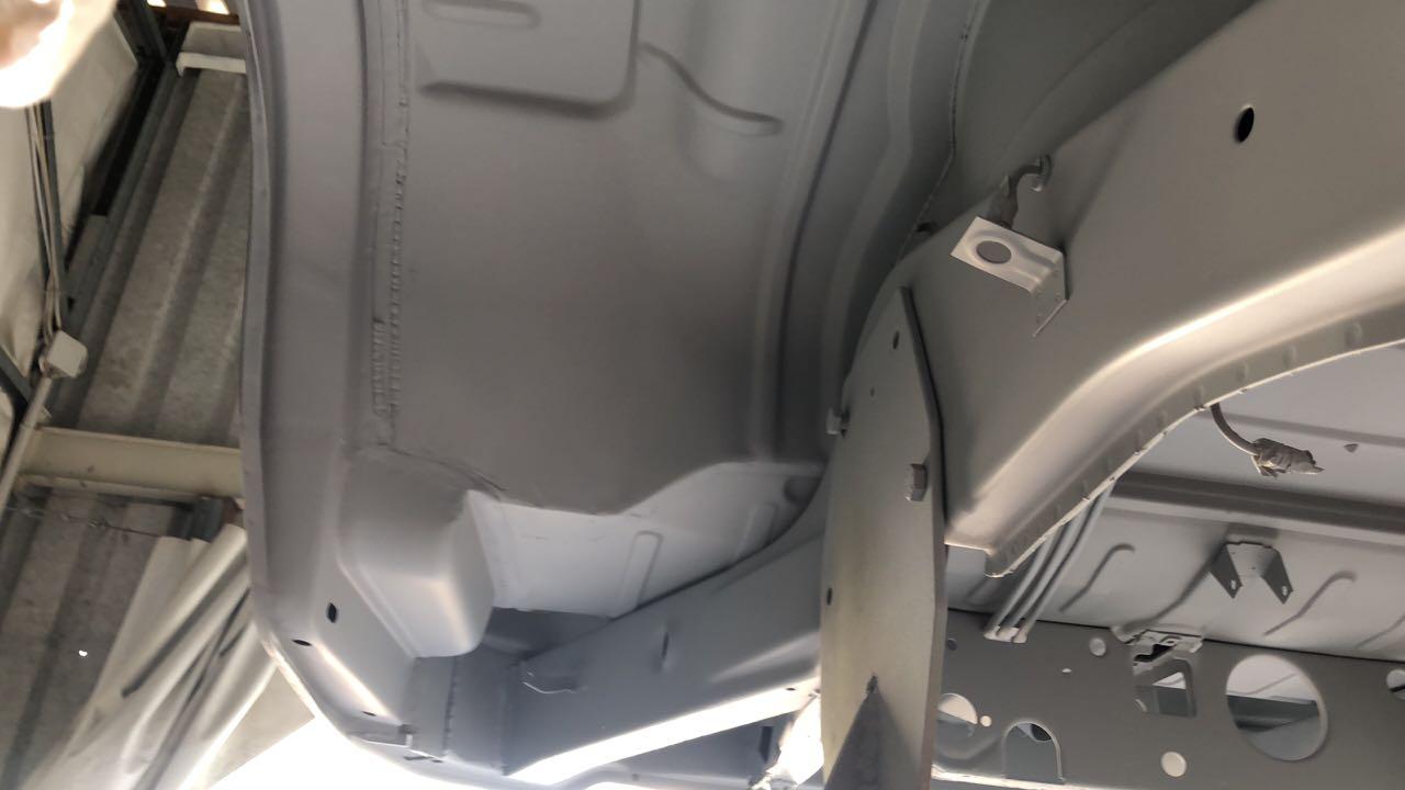

Meanwhile, vantoshi got prepared for his new makeover by applying a primer to the whole body:
