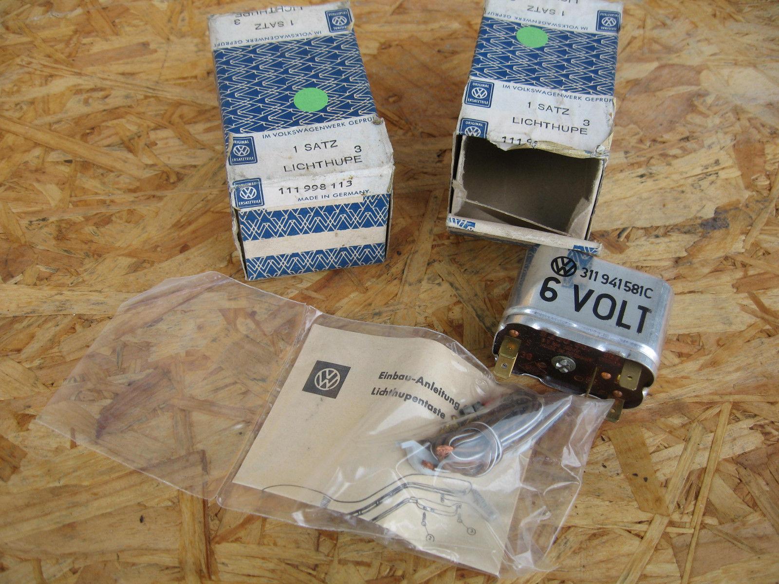

The simple way is to install VW kit part number 111 998 113 which includes the 6 volt relay and indicator stalk button.
Thanks....want to sell me that one?

PostPosted: Tue Jul 31, 2018 7:21 am    Post subject: Re: Adding headlight relays to '65 6v system Reply with quote
Thanks, all. I've decided to go the route of installing the '66 style switch and relay. Parts on order. May reach out for some installation guidance when they arrive.
