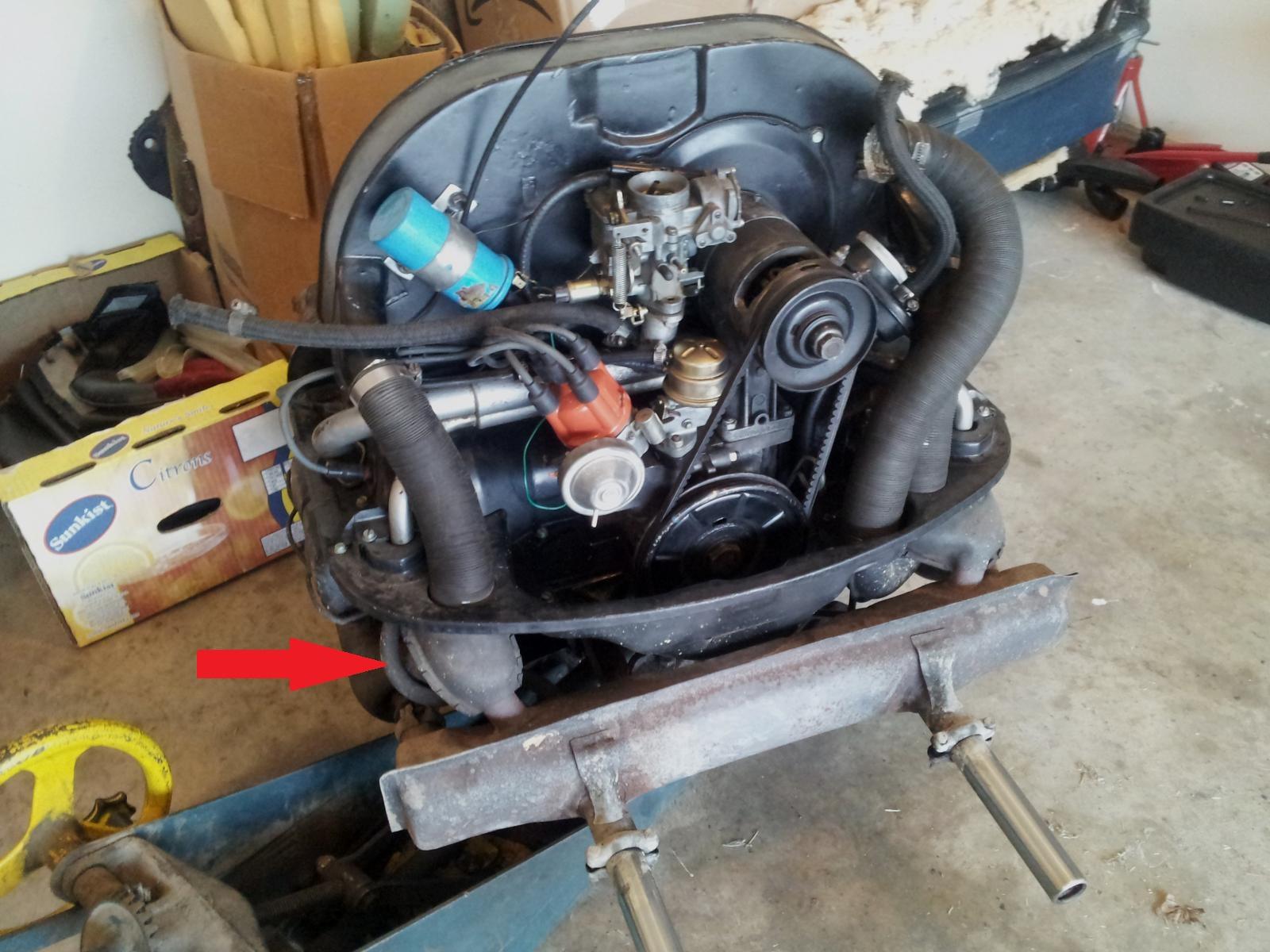

Just a simple question I'm wondering...
Why are all the aftermarket mufflers' preheat tubes for the heat riser on the opposite side as the original VW?
They are all on the right side, the original VW was on the left:

PostPosted: Sun Aug 05, 2018 7:19 pm    Post subject: Re: Current stock muffler options? Reply with quote
Maybe the switch was to consolidate the manufacturing lines of the mufflers once the Mexican Beetle got the spin-on filter oil pump? I know that pump/filter combo won't clear the left-hand preheat tube, maybe VW just began making all of the mufflers with it on the right to avoid having two different parts being made? and the aftermarket followed suit as well?
Just a guess

PostPosted: Sun Aug 05, 2018 8:50 pm    Post subject: Re: Current stock muffler options? Reply with quote
FWIW, that tube is actually the return. On the pictured exhaust, the manifold actually gets it’s heat from the port directly on the #2 exhaust flange, it then flows through the heat riser then through that tube to return to the exhaust flow at the lower pressure side of the exhaust system.

PostPosted: Sun Aug 05, 2018 9:40 pm    Post subject: Re: Current stock muffler options? Reply with quote
Aah.
So then would it make any difference that the return tube is on the opposite side on all these aftermarket units?

PostPosted: Mon Aug 06, 2018 4:08 am    Post subject: Re: Current stock muffler options? Reply with quote
sb001 wrote:
Aah.
No sir, the manifold just needs one side to have a higher pressure on one side so that the exhaust wants to flow through it.
