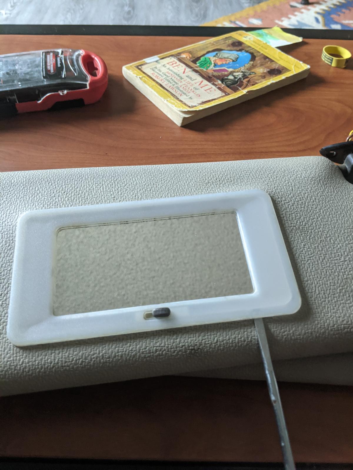

I just did this today and took a couple pics to help out future folks, since the vanagonauts link above appears to be down.
Popping out the mirror frame (1/8" flat screwdriver, insert under frame and twist gently):
What it looks like underneath:
Note the position of the small plastic tabs on the bottom of the frame; one is just left of my thumb.
I'll throw in another freebie: once you connect it back to the van, the lights will only turn on if the visor is in the open position. There's a contact in the plastic joint (hidden unless you dissect the visor) which disconnects the ground wire if the visor is up. This caused me a lot of consternation until I discovered the solution by accident.
