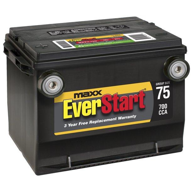

I'm thinking a Group 75 battery might be persuaded to fit without much trouble.
It has side posts only that would avoid most seat spring issues and it is only a 1/8" wider.
I'm sure some folks here must be running these, or even the longer Group 78.
