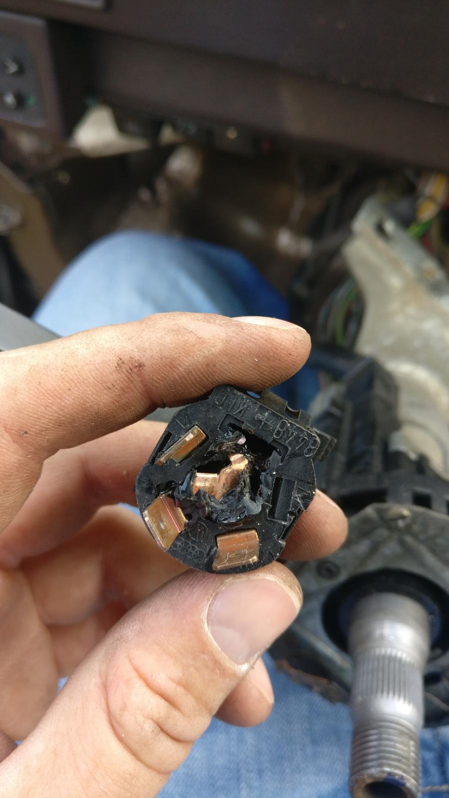

PostPosted: Sat Oct 20, 2018 12:02 pm    Post subject: Re: Front Blower/Fan Motor Issues - Runs for a bit then stops Reply with quote
mine did that for a while in the end it burnt out the switch due to excess power draw, I had to pull the fuse during a camping trip but believe on some motors it also runs the windscreen wipers.
Good info. So your symptoms were the same?....blower would come on, then eventually stop?
What was the culprit of the issue for your situation? Was the blower seizing due to bearing failure?
