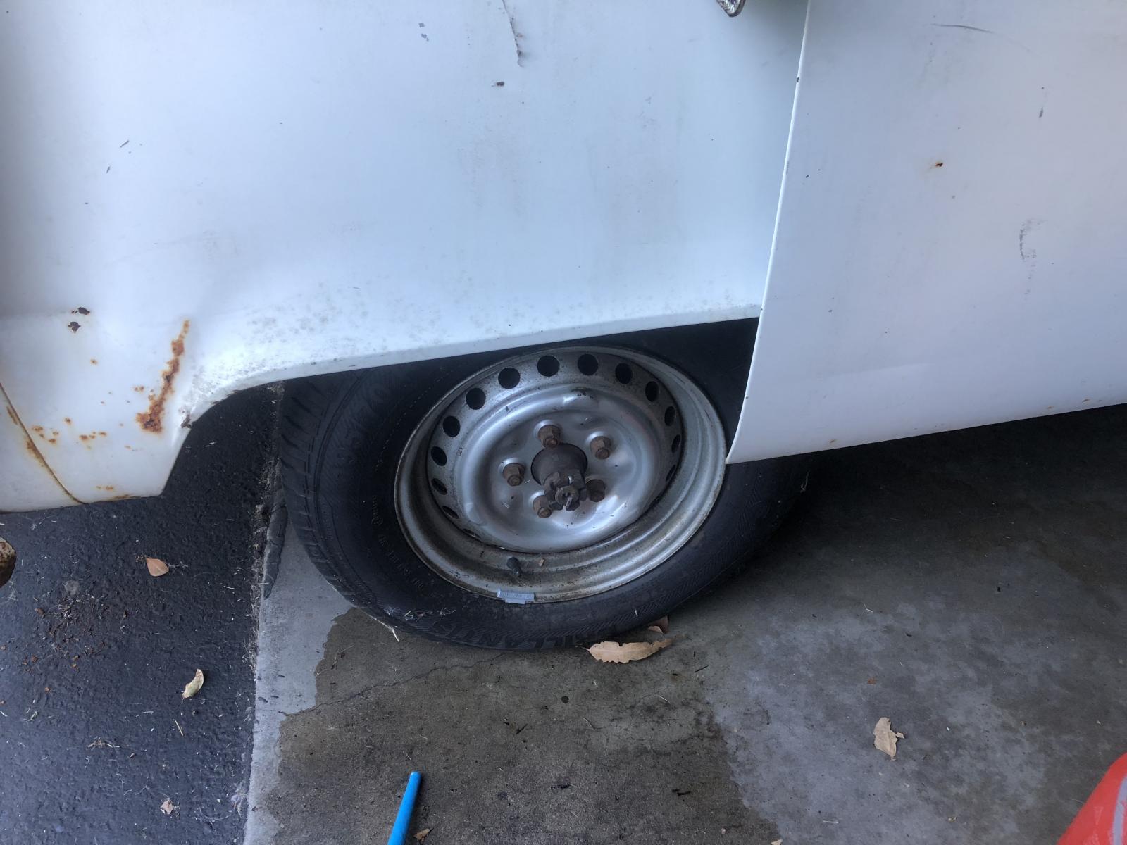

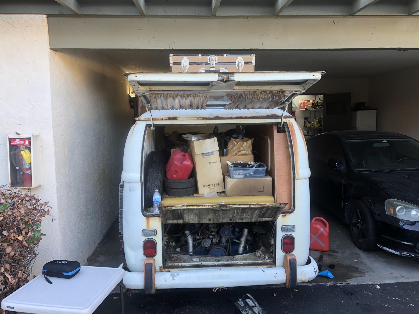

So I showed up and found this today...
Added a ground strap, fresh fuel (gallon or two) in the tank..cleaned the points a tad...
Got it to turn over but wouldn’t catch, so checked points and added more fuel...
And she fired right up!
Took a few pics of what’s going on here, more details to come Cool
This hubcap and rim were simply washed and clear coated 5-6 times...that’s all original paint and rust !

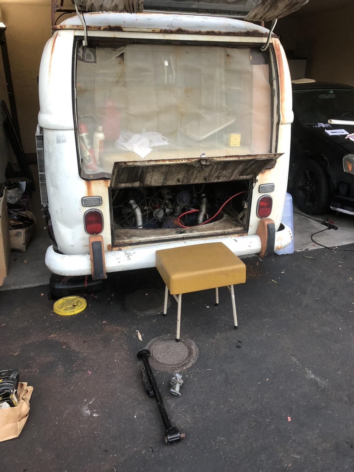

And after a empty and vacuum (still needs a wash down) we came up with this:
The goal is to get the brakes done, clean and adjust the carb, and test drive it by Thursday! Stay tuned. This ones gonna be similar to sunnydogs westy story, because there’s a bunch of vintage phones of the bus soon to be posted, wanted to get the thread started right away to put pics and videos up of progress though Smile

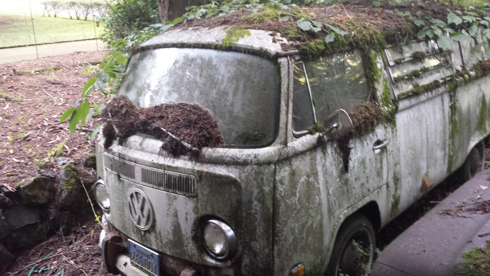

Nice! How long was it parked there or when was the last time it was driven?
I'd also wonder what it looks like under that fan shroud? Wink

We were estimating (Chris, the OP) that it hasn’t moved since 94, maybe 95. It was towed to San Diego from Silverdale WA around 2 years ago.
The fan shroud is on the list to remove once it’s running smoothly. Wink

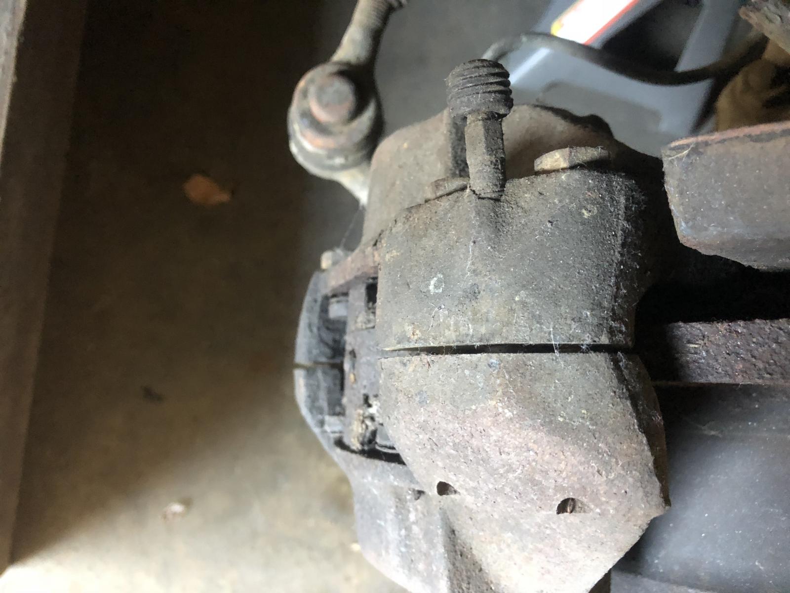

But first we needed some brakes! Now that it started, we wanted to test drive it so that means we gotta be able to stop!
Got it up on jack stands:
Busted the brakes down...
(Note the pad material was GONE) the other side had like new shoes so material must have pulled off with the drums? I didn’t take them apart, they were seized whoever towed it pulled things apart...
They also loosened the calipers up to unstick it. Likely was nothing wrong with them...Crying or Very sad
But we went ahead with all new from Vee Parts in El Cajon (ask for mike, they do ship!) very helpful and friendly. Got everything I needed in less then a days time, and ended the day like this:

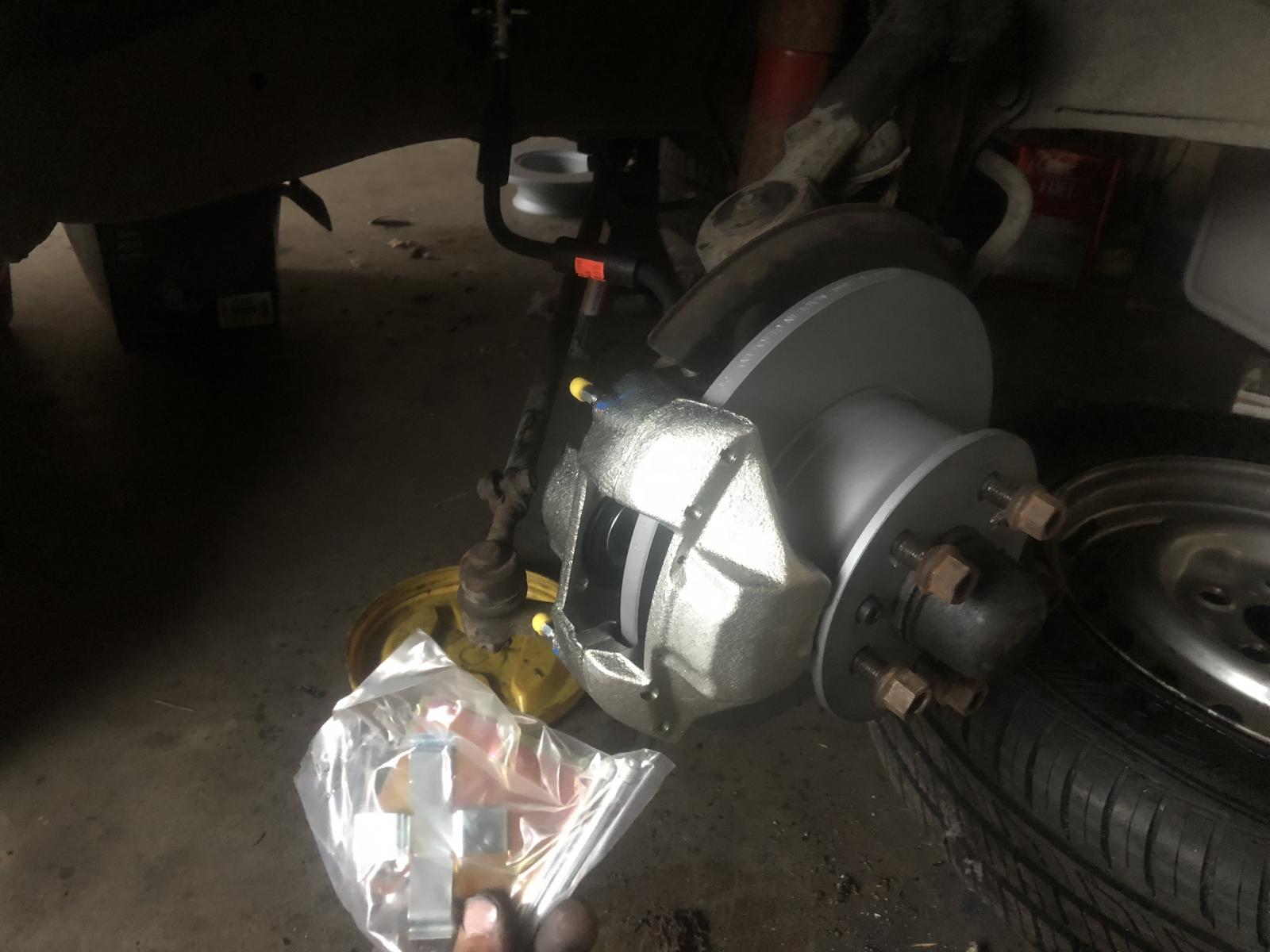

Unfortunately the “loaded” (comes with pads) new calipers had no pads, and they hit the rotor. I think I bent a rotor before I saw it rubbing by tightening it down as assembly happened, so tomorrow I gotta deal with missing pads and wrong calipers. Then the carb comes off for a clean and reinstall, new fuel lines and filter (out of engine bay) and a new battery and a ground strap to the body rather then my extra positive cable to the generator stand as seen prior.
Stay tuned! More to come tomorrow...

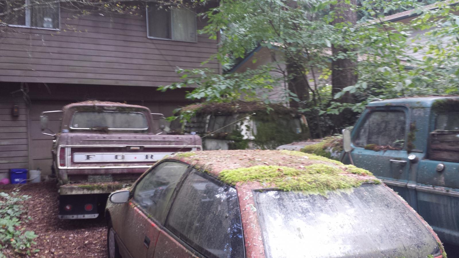

Is that blue ford available?

Unfortunately, no. All the other vehicles found homes a couple years ago. Sad The two F250's were in surprisingly good condition, but the engines were in the same state as the VW.

SO.... Todays adventure...I spent 2 15 mile one way trips (60 miles total) and about 4 hours on the phone with 15 different parts and brake and VW shops... finding out that the supplier of the parts store gave me some late bay calipers...the 14 mm holes simply don’t sit flat, obviously. not to mention a few rubbing spots where things hit wrong...all ending in the two non returnable calipers becoming spares for the 77, which currently doesn’t need them but at least not a total waste. I THINK we can get them returned but it’s up to the store owner, as it clearly said on receipt no return because they were special order. I’ll get into that in the morning! The weird part is the part numbers are all correct and such and there’s DIFFERENT numbers for new late bay style. Funky.
So...once’s that’s sorted out...brakes will be done. Anyone got a source for 71-72 calipers?
Well, I don't (I let my fabulous local VW bus boutique worry about such things) but I do know that they are only available rebuilt or one can change over to (new) later calipers which gets you thicker pads and bragging rights. I stayed with the rebuilt ones, because I am pissy that way.

Well...just found these...
http://www.busdepot.com/j12816
Now I have a failsafe plan. Gonna see what happens in the morning and then I’ll either be rebuilding originals, or buying that kit and fitting the new ATE calipers I got on hand right now.

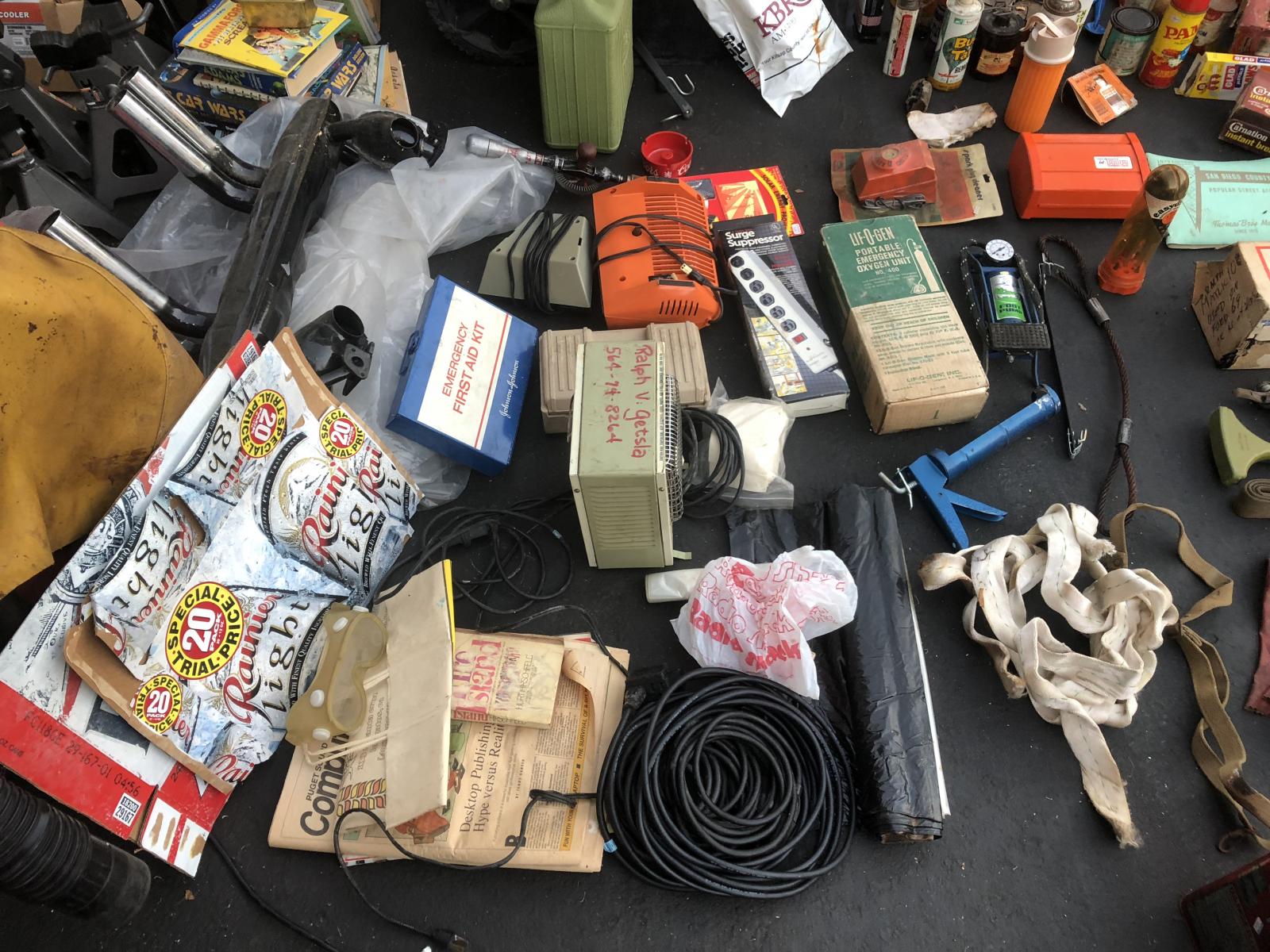

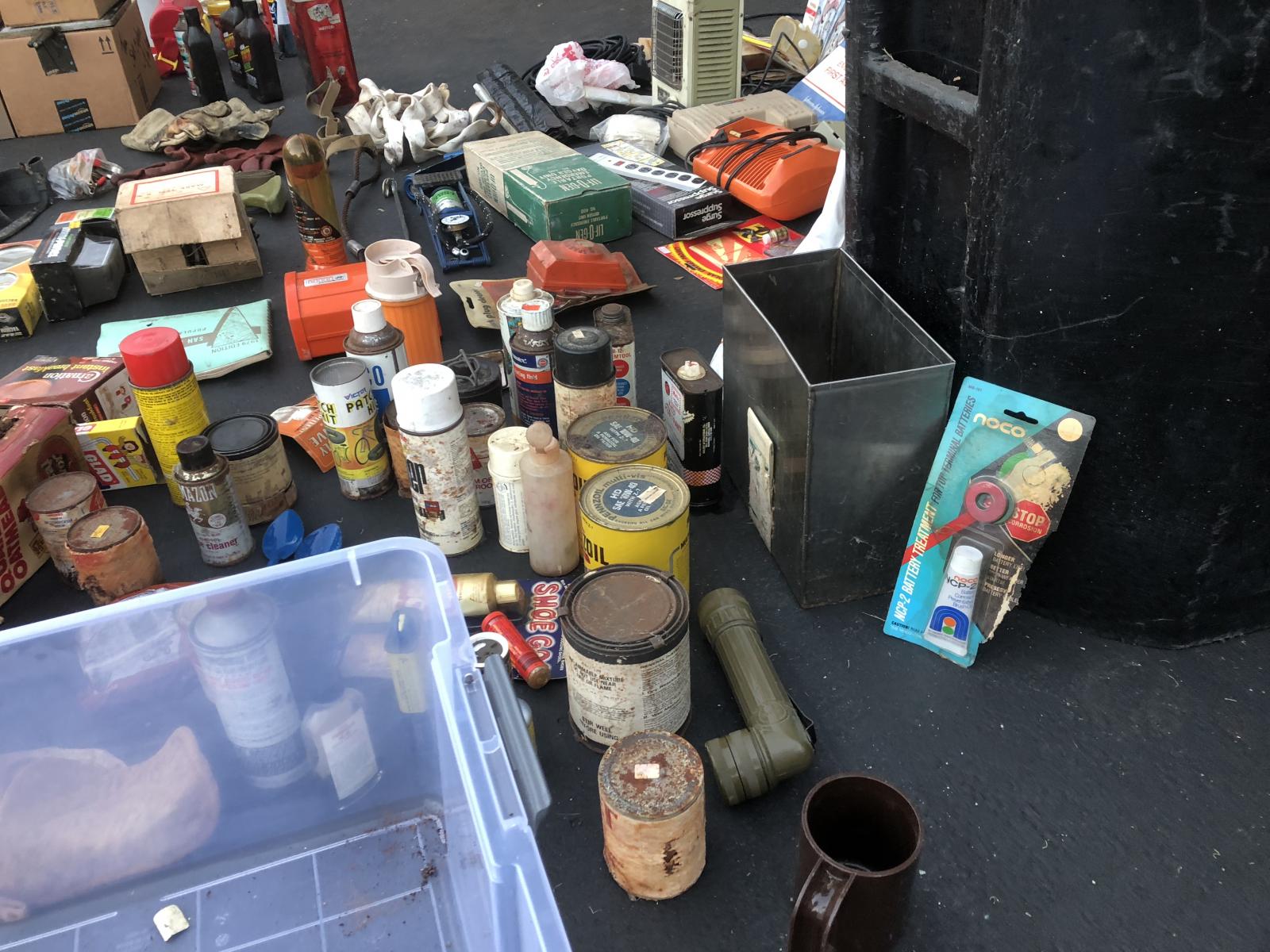

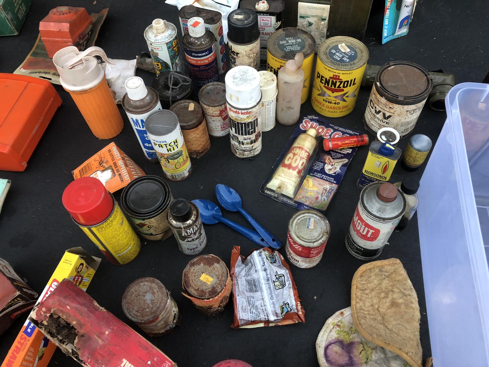

To quote from another thread... We found all this stuff in the bus. Look closely, who can spot the two pictures that have same item in them. 1983 to 2018.
Stuartzickefoose wrote:
Rear screen, stool, front curtain, and child’s cot also!

The new VW of Brazil calipers are excellent, and the pads they come with are great.
VW Paradise in San Marcos sells caliper rebuild kits for $20 that don't include caliper bridge seals. Make sure wherever you get the rebuild kit has all the seals…
