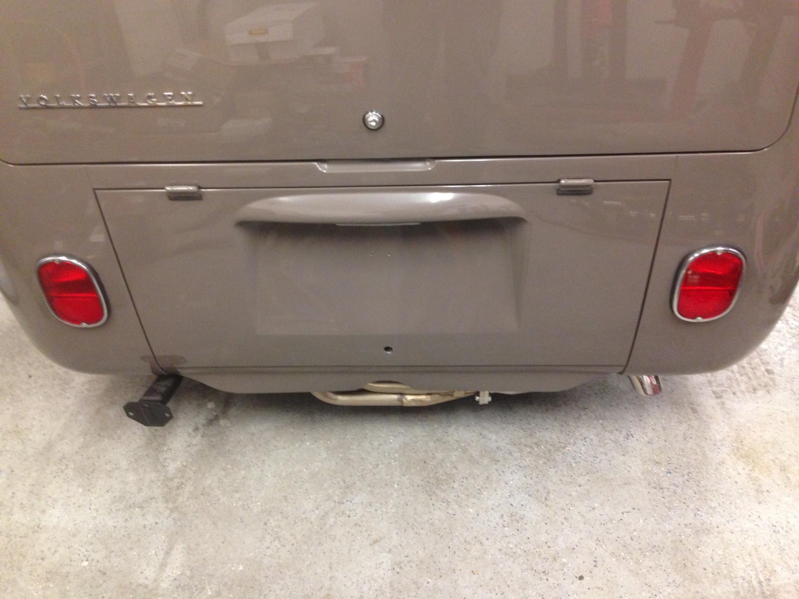

PostPosted: Wed Nov 14, 2018 4:27 pm    Post subject: Re: Sidewinder Exhaust Fit Reply with quote
I had to cut an about 2-3" tall piece out of the very bottom edge of my apron to get it to fit... at the lower part of the exhaust's U-bend.
I'm going with the Vintage Speed on a different engine.
Cut not shown in pic below.. but you can see where the contact point is (over on the left side) and imagine.

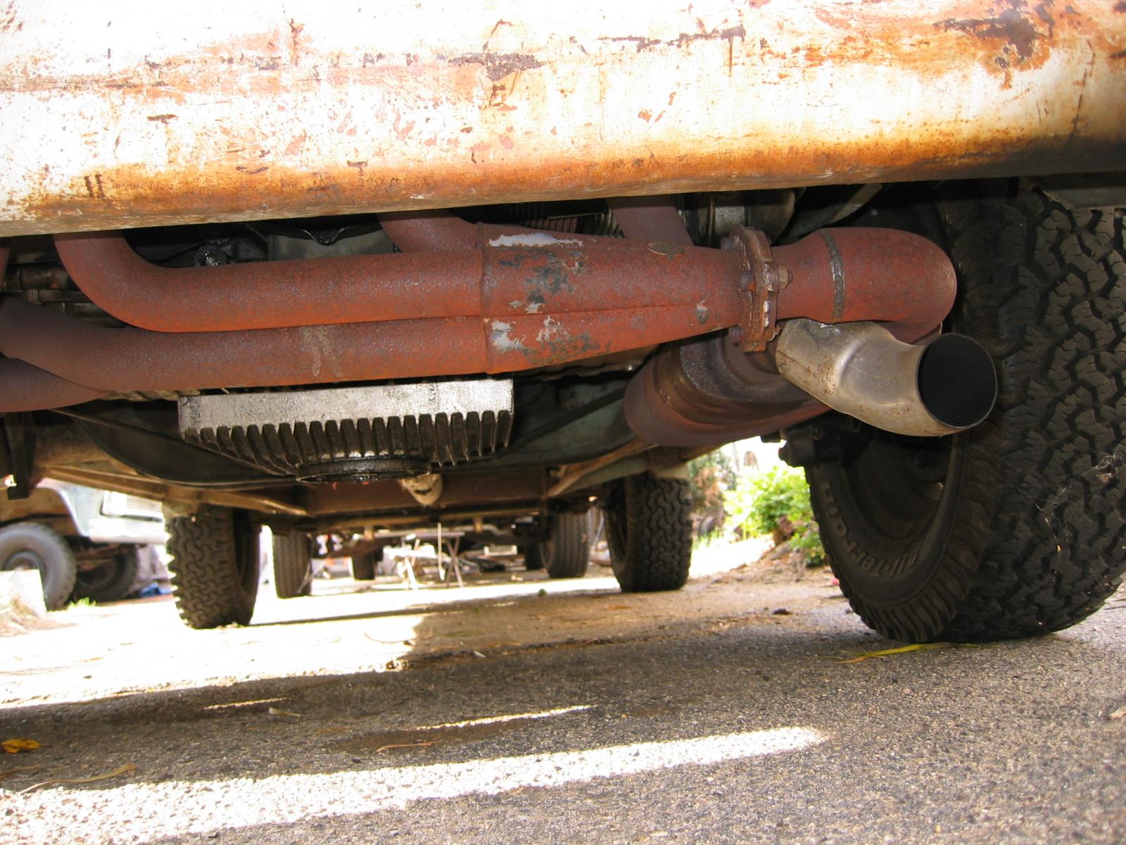

I’ve gone to the peep boys and gotten the cheapest and smallest one, then graft the flange pipe and the tail pipe from a blown apart EMPI. Done it quite a few times already for different VWs. However, the latest find Cherrybomb is the best for size and at around $30 it just can’t be beat! Cool
* Yes, it is tacked to it but also has the link to the #1 exhaust J-tube. AND it’s not in the way of the valve cover! Wink

Here's what I did with my "China sidewinder" muffler deal. No, you have to remove muffler to adjust valves, but my driveway will not let mine sit any lower.

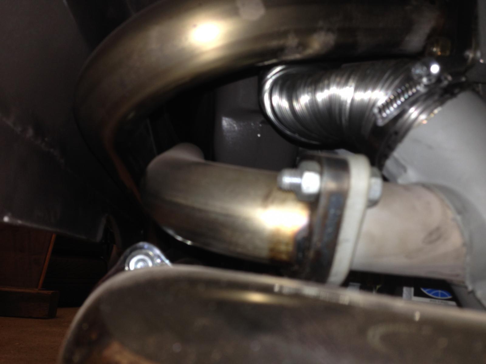

I have a 1 1/2 A1 Sidewinder with AA muffler on the bus. I had to put 1/2 spacers between the body and apron to make the tiny amount of clearance you see in the pic. It does cause the apron to pop out a bit but on my beater who cares.
To cut down the drone from the muffler I put a piece of scrap tubing with two self tapping screws directing the exhaust out the back. I temporarily extended the pipe past the muffler and the drone was even quieter. I could tell the difference as on the freeway the 'temp' tube shot off and the difference was very noticeable.
