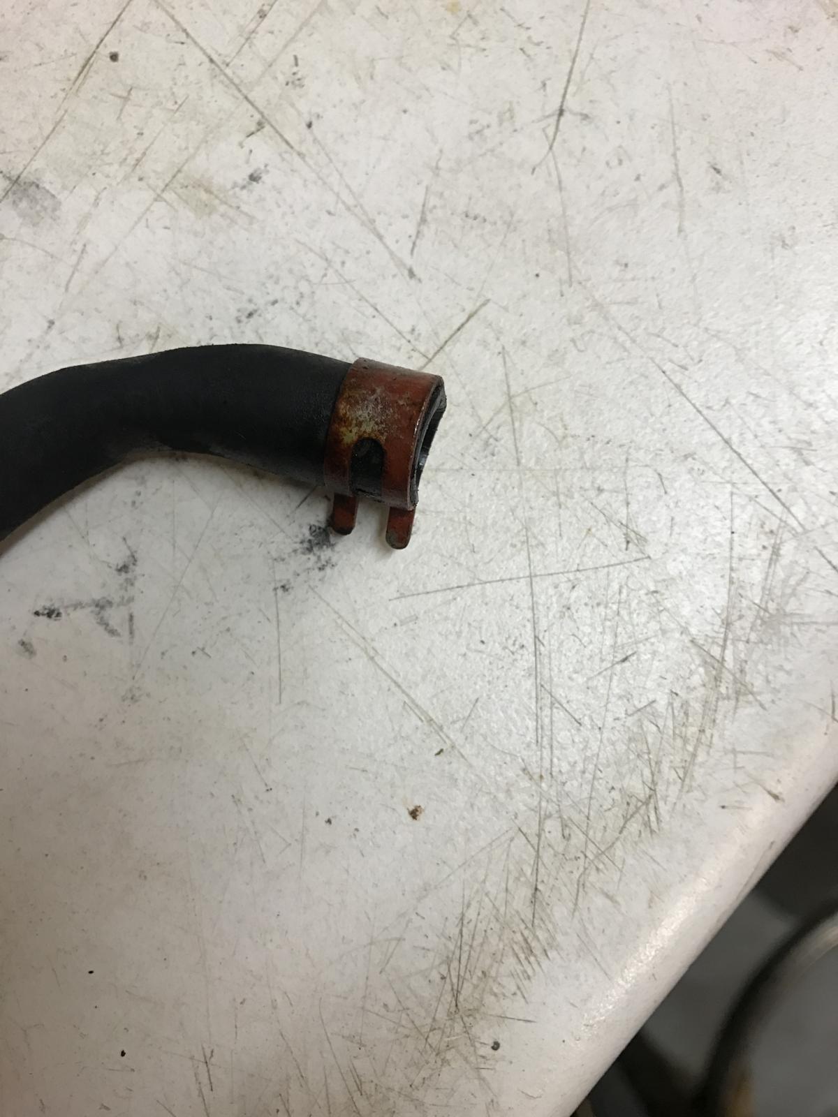

I have heard for years that the spring style hose clamps are superior to the screw clamp style clamps because the exert a constant force through various heat/cool cycles and thus are less prone to loosening seeping.
I have stated here through the years that while I understand the science of the clamp I fail to trust them.
I have through a half Century of twisting wrenches found broken spring style clamps ...
AND
I like the feeling of gratification that comes from physically making sure they are tight.
I was working on a project over the weekend and went to remove a seeping hose and guess what?
Broken Spring clamp
