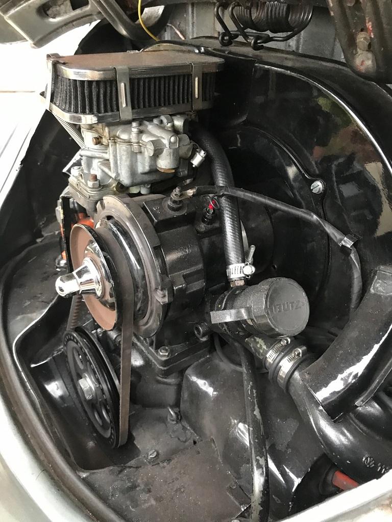

I got a VW bug!!!! So exited! First bug I have owned. Really looking forward to the journey.
1960 err, I mean 1961 VW Beetle
Photos when I bought it:
First thing that I did last night was to fix the headlights... one wire was installed incorrectly and it was blowing a fuse... all lights working fine now.
First changes that I want to tackle this weekend:
1. Replace one rear wheel bearing
2. Raise the car
3. Replace muffler
More later, just could not wait to share.
Edit: Adding the list of things done and those pending... will continue to update the list as I tackle these tasks...
Photo as of Feb 2, 2019
This car will never be a concourse car… I just want to make it a reliable driver.
Just making a list of pending items. Except for the first one, the rest are not in order of priority:
Pending:
  1. Fix fuel line and ignition wire routing
  2. Need to get under the car to validate what type of transmission I have. To determine if it has a reverse switch. If not, I will need to buy speedometer reverse switch and run wires for reverse/backup lights
  3. Paint rims Silver Beige. Will paint them for now...got the paint from WW. Eventually, would like to get them powder coated.
  4. Install inside door window squeegees
  5. Install seat covers. Want to strip the seats and powder coat (or at least paint for now) the frames.
  6. Install headliner. Once this is in place, I can then install the rear side panels
  7. Install new rear window seal and trim. After headliner is in place…
  8. Unclog heat riser (purchased in the classifieds) for stock setup
  9. Install stock carburetor with oil bath air cleaner
  10. Install stock distributor
  11. Correct title in the DMV from 1960 to 1961
  12. Fix/connect windshield wiper motor (also install the voltage drop resistor/heatsink)
  13. Fix windshield washer water system… this one will be fun…
  14. Fix rear lock. For some reason, I cannot turn the key to lock it. I got this new one as a set. If I take it out, I can turn the key without issues... installed, I can only turn the key if in the open position.
  15. Replace wire harness sections as I tackle the different issues.
  16. Remove radio to inspect operation and reinstall.
  17. Have local shop replace/repair any metal needing attention. Replace rear apron for correct one. Repair area in front of rear fenders due to bad patch job..and anything else critical that requires attention.
  18. Buy and install REAL running boards…
Done:
  1. Raised
  2. Removed exhaust and replaced both muffler and J-tubes with stainless steel units...
  3. Cheap #@%#@$ running boards installed
  4. Odometer cable
  5. Fuel gauge light socket
  6. Stainless steel moldings
  7. Door window trim replaced
  8. Tag light lens and bulb
  9. Front door panels replaced
  10. Sun visors replaced
  11. Rear-view mirror replaced
  12. New Pop-out windows installed
  13. New steering wheel installed
  14. Front windshield, seal, trim installed
  15. Missing radio. Only put in place for looks (for now)
  16. Headlights and turn signals operational
  17. Stainless steel roof rack installed
  18. New dash grab handle installed
  19. New knobs for switches and ashtray installed
  20. Emergency brake handle fixed
  21. Installed missing bumper brackets/spacers. This fixed the clearance issue between the rear engine lid and the bumper
  22. Broken wheel stud replaced
  23. OG Gas tank cap
  24. Missing gas tank hold-down brackets and bolts installed
  25. Matching keyed ignition switch, door handle, rear engine T-handle installed
  26. Oil change
  27. Billet crankcase cover
  28. Air filter on existing weber replaced
  29. Door rubber seals
  30. Engine lid rubber seal
  31. Replacement driver-side fender replaced and missing horn grill installed
  32. Replaced front turn signals
  33. Replaced rear turn signal lens
  34. Installed glove box basket (was missing the bolt and I had it upside down…)
  35. Replaced glove box door hinge spring
  36. Installed trunk liner
  37. Installed dash back (trunk side) cover
  38. Installed 3-point seat belts for driver and passenger. Went with gray.
  39. Installed assist straps – missing from my car. Got them from WW
  40. Replaced alternator pulley, shims, woodruff key and belt
  41. Installed and connected horn
  42. Replace rear passenger-side wheel bearing. This was something that the PO told me that it needed to be done. When I went in to replace it, it was in good condition, so only replaced seals
  43. Removed bumpers to install rubber grommets. Paint inside of blade in the front bumper. Installed rear-missing support. Install the bumpers back and tightened everything properly.
  44. Replaced rear brake shoes and hardware
  45. Installed support brace for driver side arm rest and installed missing handle springs
  46. Replaced valve cover gaskets
  47. Drivetrain hopping fixed!! Replaced bowden tube and bracket. Replaced the clutch cable and clutch pedal shaft while I was there... oh, and new pedal pads installed as well
  48. Ran wires and installed switch for fog lights
Drive safe,
Wachuko

PostPosted: Fri Dec 14, 2018 10:53 am    Post subject: Re: My 1960 VW Beetle Build Thread Reply with quote
Thank you for the warm welcome!!
Photos of the interior:
Steering wheel is all cracked... I have seen the videos on how to repair them... but I am just going to order a new one...
Ok, back from the tag agency... it is all legal and registered. Seeing the photos I realized the previous owner forgot to take his tag... I see him this weekend to get a spare driver side fender he has... will give it back then.
So... car metal is solid. That was the main thing that I was looking for since my bodywork skills suck... I can work the rest. I just want a driver for now. Promised myself I would not go crazy trying to restore it... just want to fix the interior and make sure anything mechanical on the outside is working as expected.
Last night, as I was fixing the lights, I was making a list of stuff needing attention. I was also going over a lot of the stuff that is just loose... For example, front trunk lid was not locking and it was just because the catch's bolts were loose... bumpers are all loose, need to adjust all the bolts on the mounts to body and bumper to mount bolts. I need to get more blue and red loctite!!
So this morning, left early, and on my way to work stopped by the local VW auto parts (Triangle Auto Parts here in Orlando)... Got the following:
I really want to get rid of this:
Debated between a stock setup...or the same one I got but in steel (a lot less expensive)... at the end, since I do not plan to get rid of this car, I went with a stainless steel exhaust in the hopes that it last longer while still looking decent...
Stainless steel exhaust
I also got:
  • New rubber seals for trunk lid, engine lid, doors
  • Fender to body seal for that fender that is there right now... no rubber trim on it right now
  • Emergency brake handle (my is missing the mechanism that allows it to lock in position. I will try to fix mine with the internals of the one I bought... if not, the new one goes in completely... wanted to keep the gray painted one that is there right now. Will see how that goes.
  • Rear wheel bearings with the seal/gasket kits
  • Odometer cable (humm, I hope they remember to add the circlip in the bag...
  • Side Molding Kit, Stainless Steel, 7 piece, For Use w/ Wolfsburg Crest - In the photos you can see that the trim on the trunk is longer than it needs to be...I just wanted that strip but ended buying the complete set in stainless steel. Got new clips and seals to replace all of mine
  • Glove box. Plastic box was missing in mine.
  • New bolts for the bumpers. The ones on the bumpers, some were missing, some where fully rusted...
  • Engine lid handle with key
  • Door window trim - I thought I could just buy the rubber squeegee but learned that it is all a complete trim with the aluminum piece
  • Tail/Tag light clear plastic housing with rubber seal.
  • Some spare fuses and light bulbs
Pending things to get:
  • Steering wheel... after seeing a new one at the store, I am not going to try to restore mine...I will just place it on the wall and install the new one in the car. Need to take a look at the car again on the sun light to confirm if it is gray or ivory... I kid you not, I was so tempted to buy it this morning but was not sure of the color... that new wheel looked sooooo nice...
  • Headliner. I was surprised it was not perforated vinyl...also need to decide what color this should be... but I would like to switch it to perforated vinyl... that is what I remember seeing in my dad's car (this is the main reason for getting the VW Bug...the older I get the more I am turning into my father...must be nostalgia for not having here anymore)
  • Seat covers and door panels - would like those to look sharp... will repair the existing panels for now and install some moisture barrier to make them last longer
  • Pop-out side windows - I don't need these... but I sooo want them, lol
  • Driving lights - another thing that I do not need but looks so cool...
  • Period correct looking radio... not high on my priority but to fill that hole in the dash
That is it for now... can't wait to start working on the stuff I got today.

PostPosted: Fri Dec 14, 2018 2:57 pm    Post subject: Re: My 1960 VW Beetle Build Thread Reply with quote
Engine photos... car is running fine, but that carburetor... missing choke parts??
I got a different cable setup just in case... but I rather continue to use it as is until it gives me an indication of needed attention... that will give me time to figure out what would be a proper setup or what this one is missing to have it all working as it should. Much to learn on my side... much to learn...

Sharp64
Joined: August 27, 2015
Posts: 5304
Location: Central Florida
Sharp64 is offline
PostPosted: Fri Dec 14, 2018 4:04 pm    Post subject: Re: My 1960 VW Beetle Build Thread Reply with quote
Post a pic up of under the front trunk lid.
The knob on the lower right dash would have been a choke on a 60, but that motor is a much later dual port motor. Wonder if it has the doghouse oil cooler or not?
Regarding the year. The VIN on the should match in two spots. There is a VIN on the pan under the rear seat. There is a body tag in the inset behind the spare tire. These should match. Florida only cares about the VIN on the pan for title purposes, but good to know what you have. It’s not uncommon to see a body and pan being swapped.
