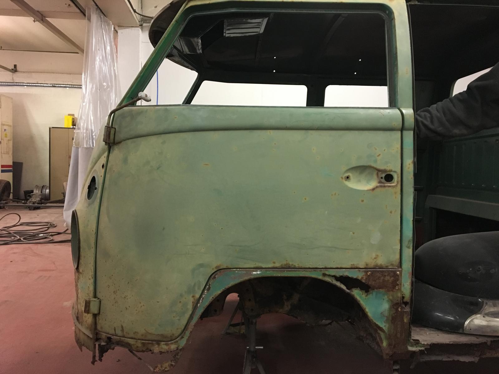

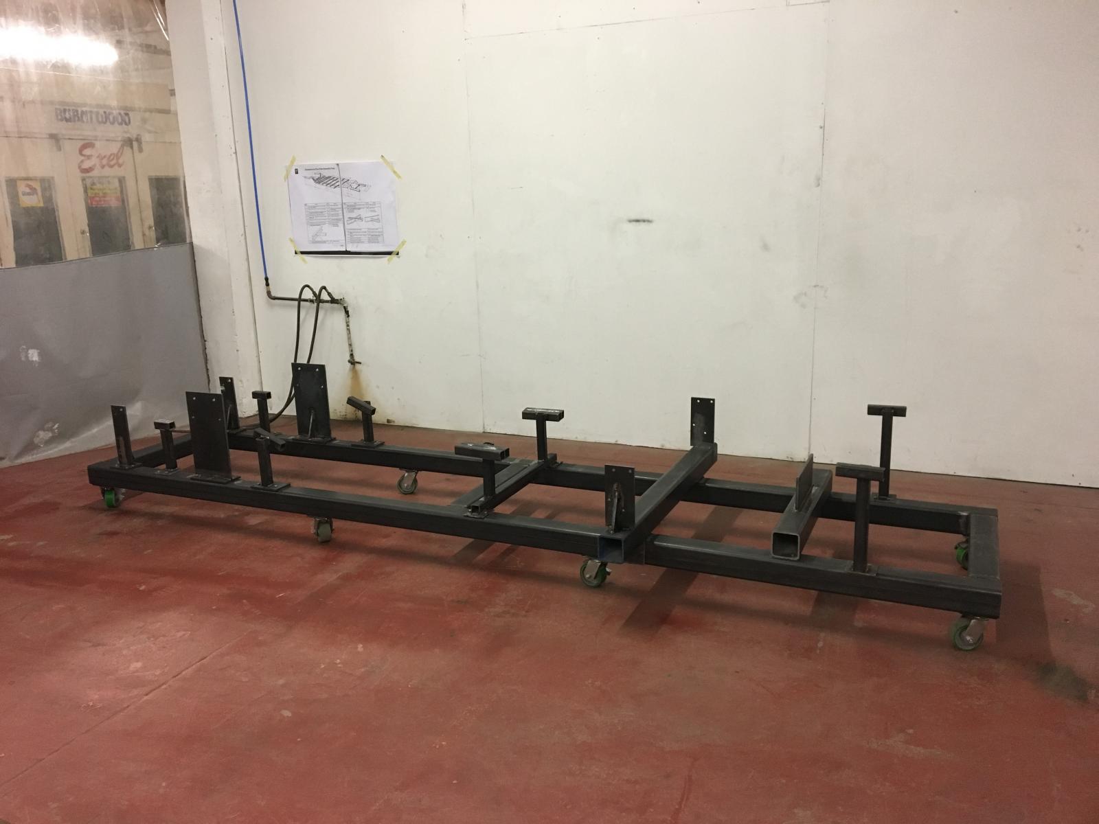

A customer bought his Swedish 66 crew cab to us for metalwork and paint. Thought you guys might be interested in seeing progress but not sure if I should be putting it in this forum or the readers rides though?

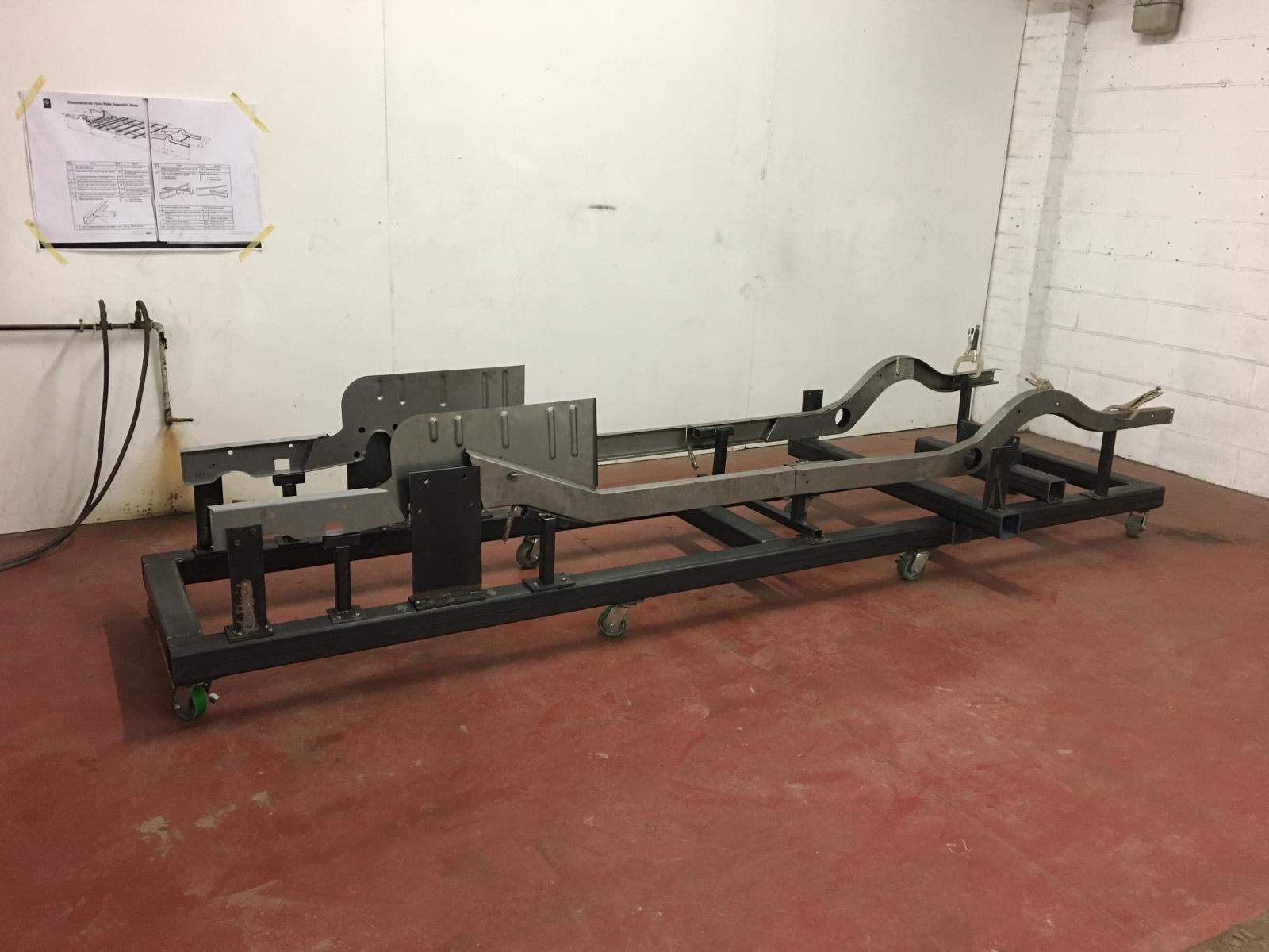

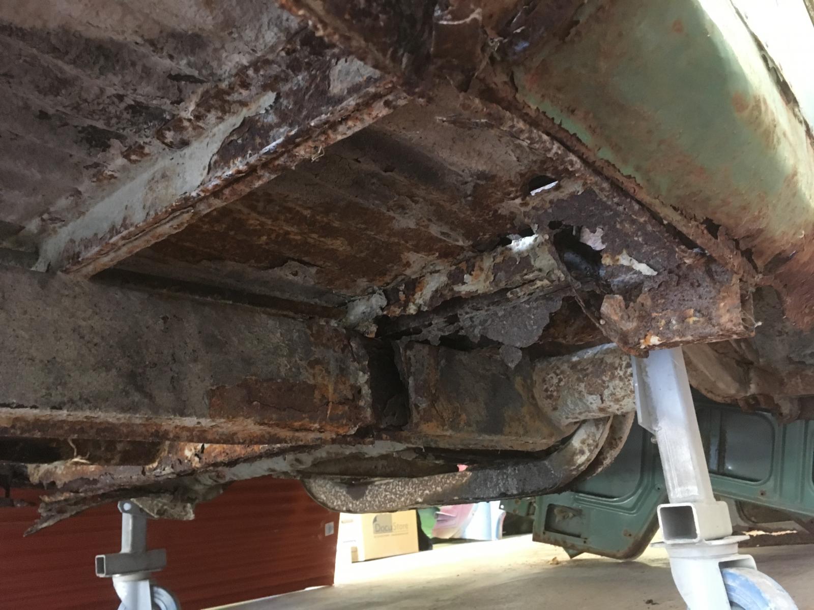

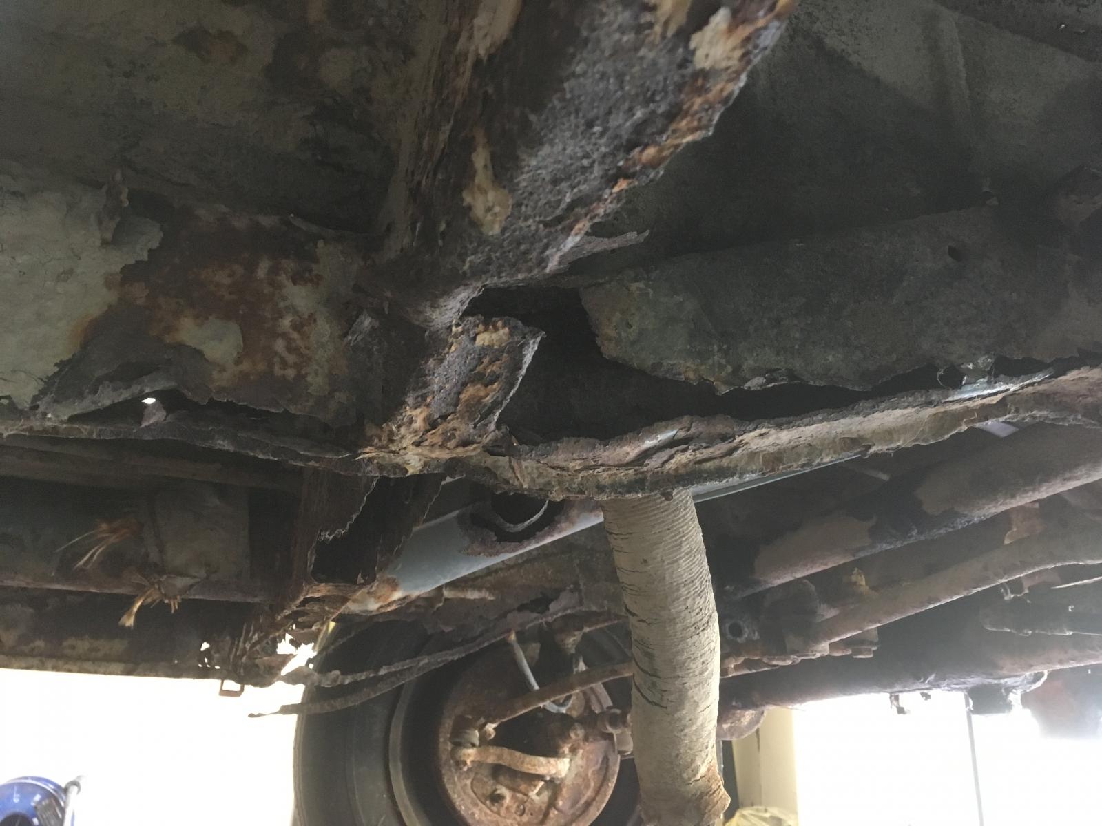

As you can see, the chassis is in a bad way:

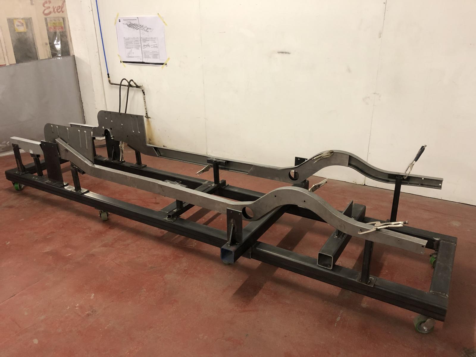

We decided the best way to approach this was to build a new chassis. I had been looking for a Celette or Car O Liner chassis jig for ages but couldnt find one so made one, and had a few brackets cut out which were welded up. We used my 61 split to build the jig and brackets as my chassis is nice and original / straight. Here is the finished jig / brackets, and with the replacement chassis trial fitted to the jig:

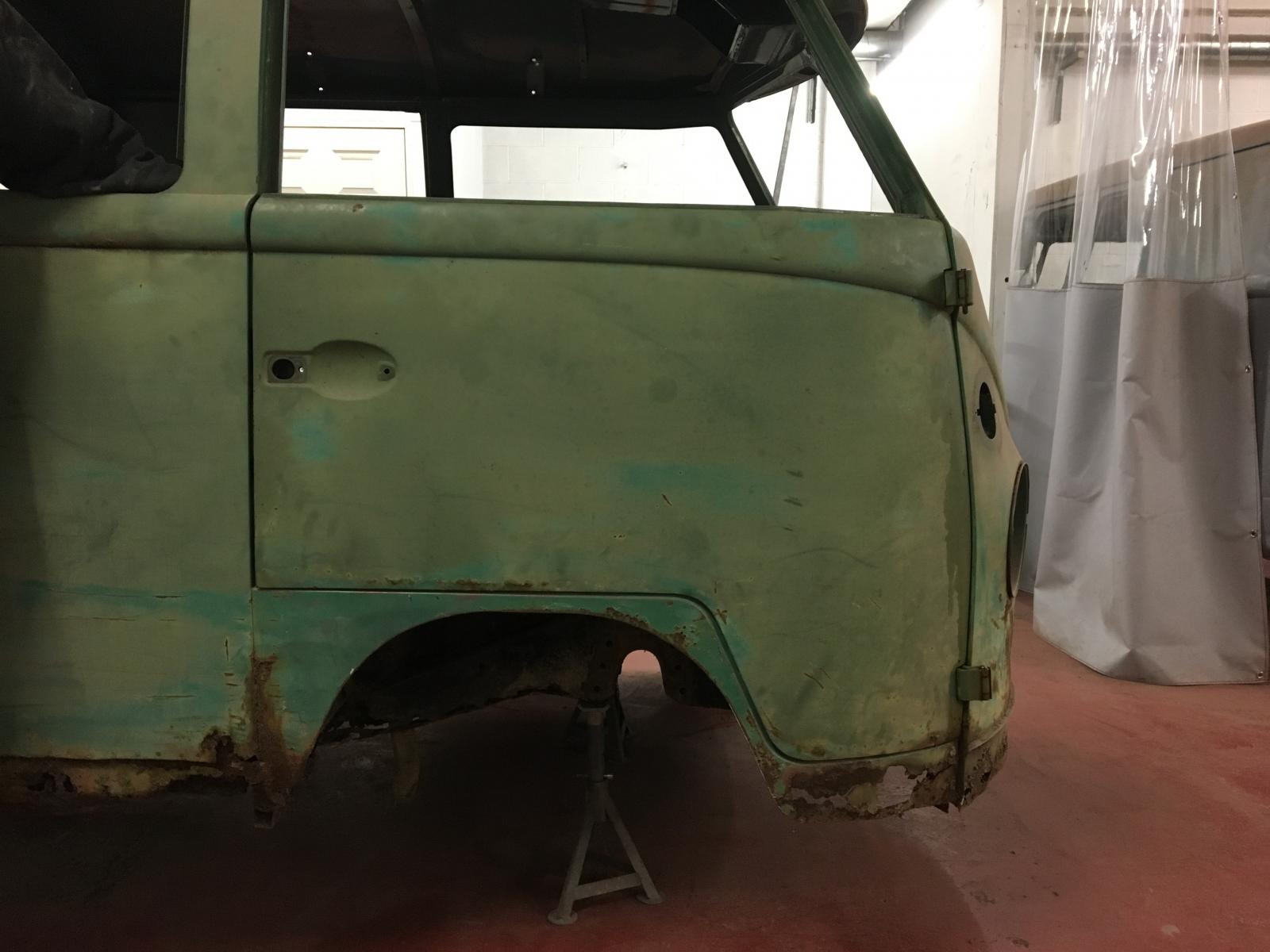

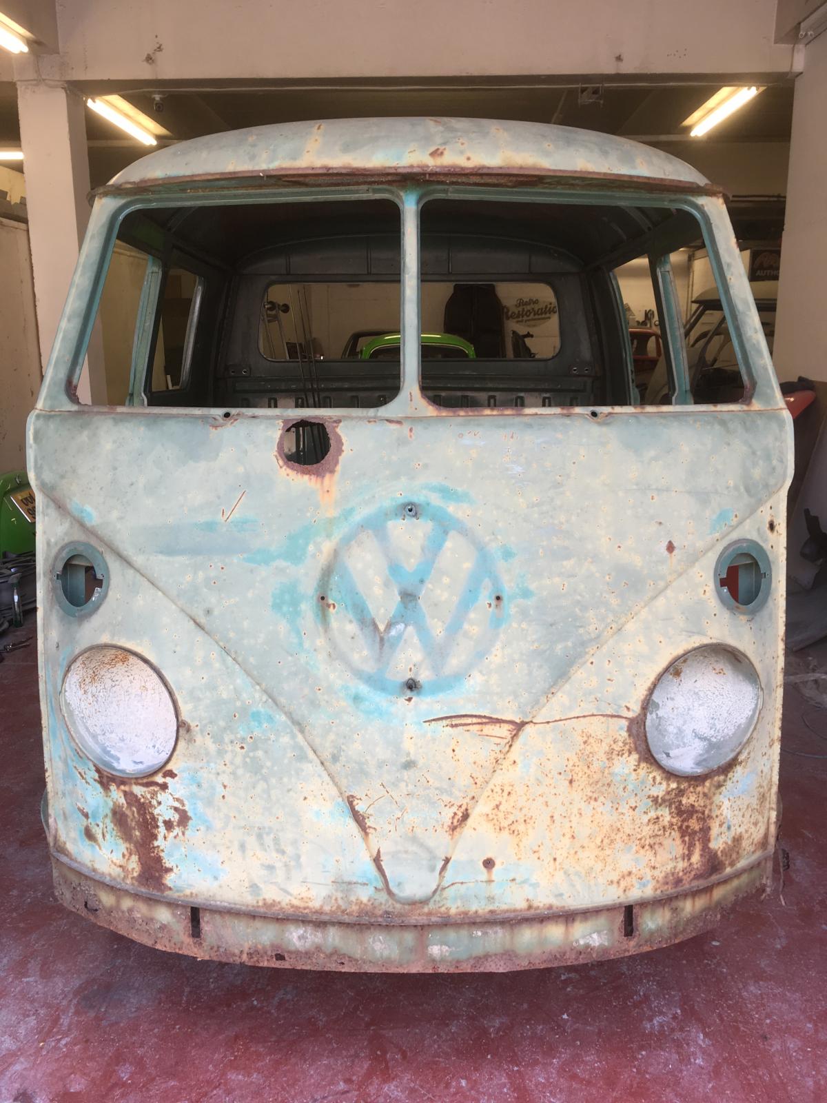

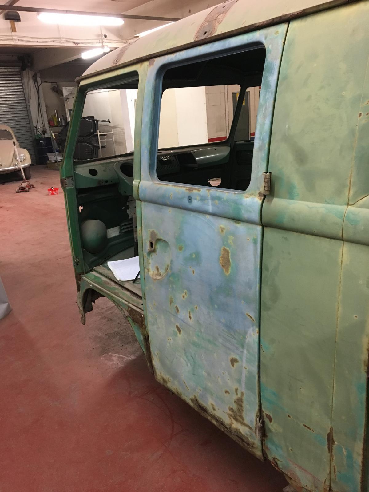

Fitted the cab doors to check the gaps were all good before anything was braced or cut out. They are pretty good considering how bad the rest of the van is. The cargo door and gap needs some work. The door is pretty badly twisted:
Broke up now till the new year and I cant wait to get in and get stuck into this Smile
