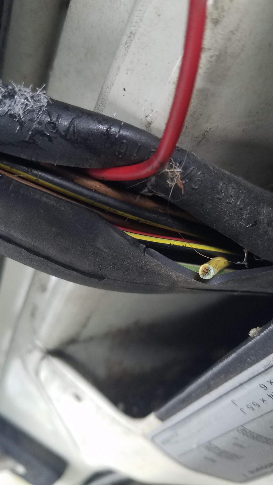

Broken Yellow wire in the door sheath
Broken White wire above and behind the fuse panel.
Both wire happen to break one after the other on the drivers side.

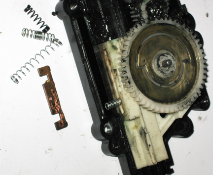

inside the actuator is like this
the copper disk rotates to act as the ON/OFF switch position, the little plate acts as the contact point... either the disk get dirty/corroded or the plate fails to make the contact because of the week tiny spring under it.

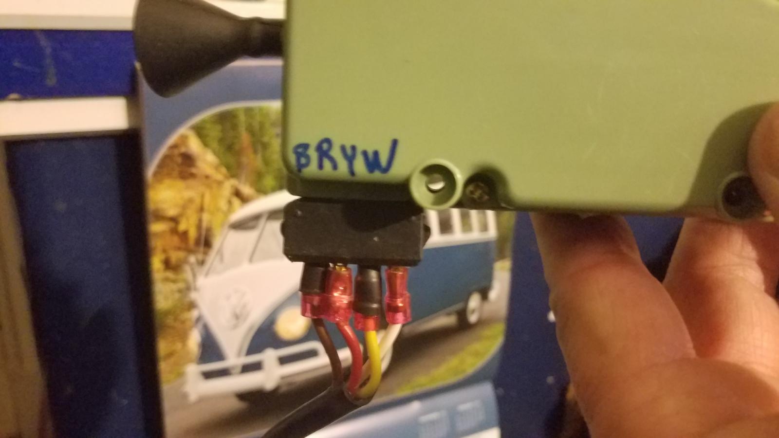

In addition to the broken wires I had was one actuator that was toast! I bought two new ones from Amazon and cut off the wiring harness of old and crimped on connectors to attach to the new ones.
Works just as it should. The connector were then hot glued and then coated with liquid tape to keep water tight.
