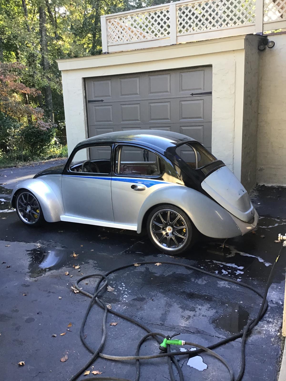

My Vdubs been on jack stands for over 20 yrs & Im finally getting started back on it.
Here is a list of some of the mods....some over 20yrs old:
Porsche 996 front brakes
Porsche 993 headlights
Porsche Boxster 18” wheels
Carbon fiber hood
Carbon fiber dash
Custom running boards made from plastic rain gutters from Lowe’s
Suicide doors
2332 48 dell motor yet to be started

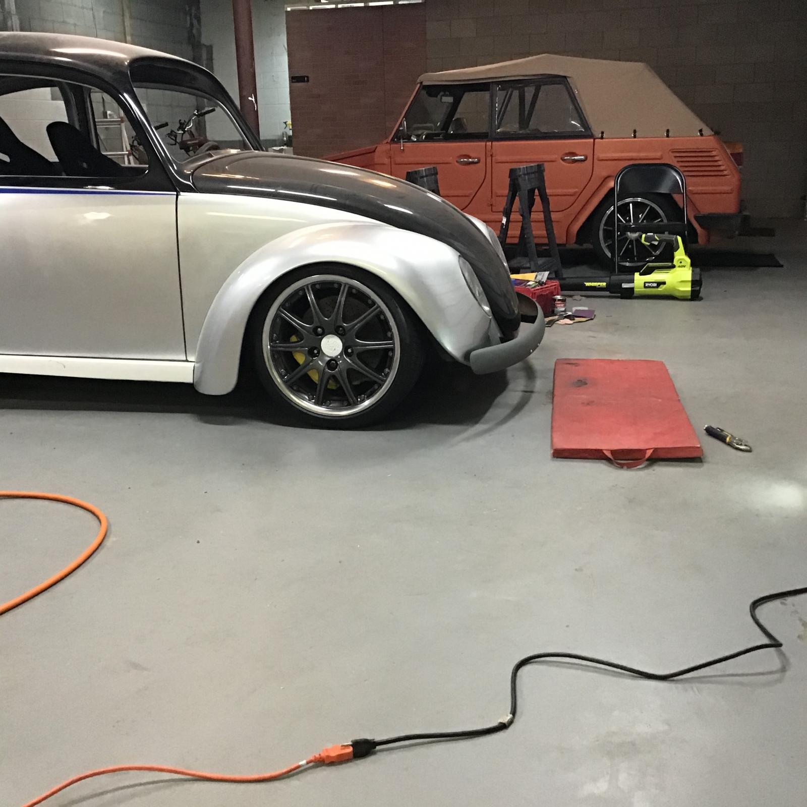

Ignore beat up bumper...I’m using it as a test fit for a custom bumpers I’m working on. I also plan to add a removal apron.
Once I fire up the motor I will pull it out to start Turbo mods which will include upgraded heads, turbo exhaust and Fitech EFI.

Bad ass, great body mods. Are the doors suicide?
DerrickfromNC1
Joined: October 24, 2008
Posts: 1408
Location: North Carolina
DerrickfromNC1 is offline
PostPosted: Fri Feb 08, 2019 9:36 pm    Post subject: Re: 67 Custom German Look Reply with quote
Yes....I wanted hidden hinges and the body shop guy convinced me that it would be easier to pull it off with suicide doors, otherwise I would have preferred the doors to open in their stock form.

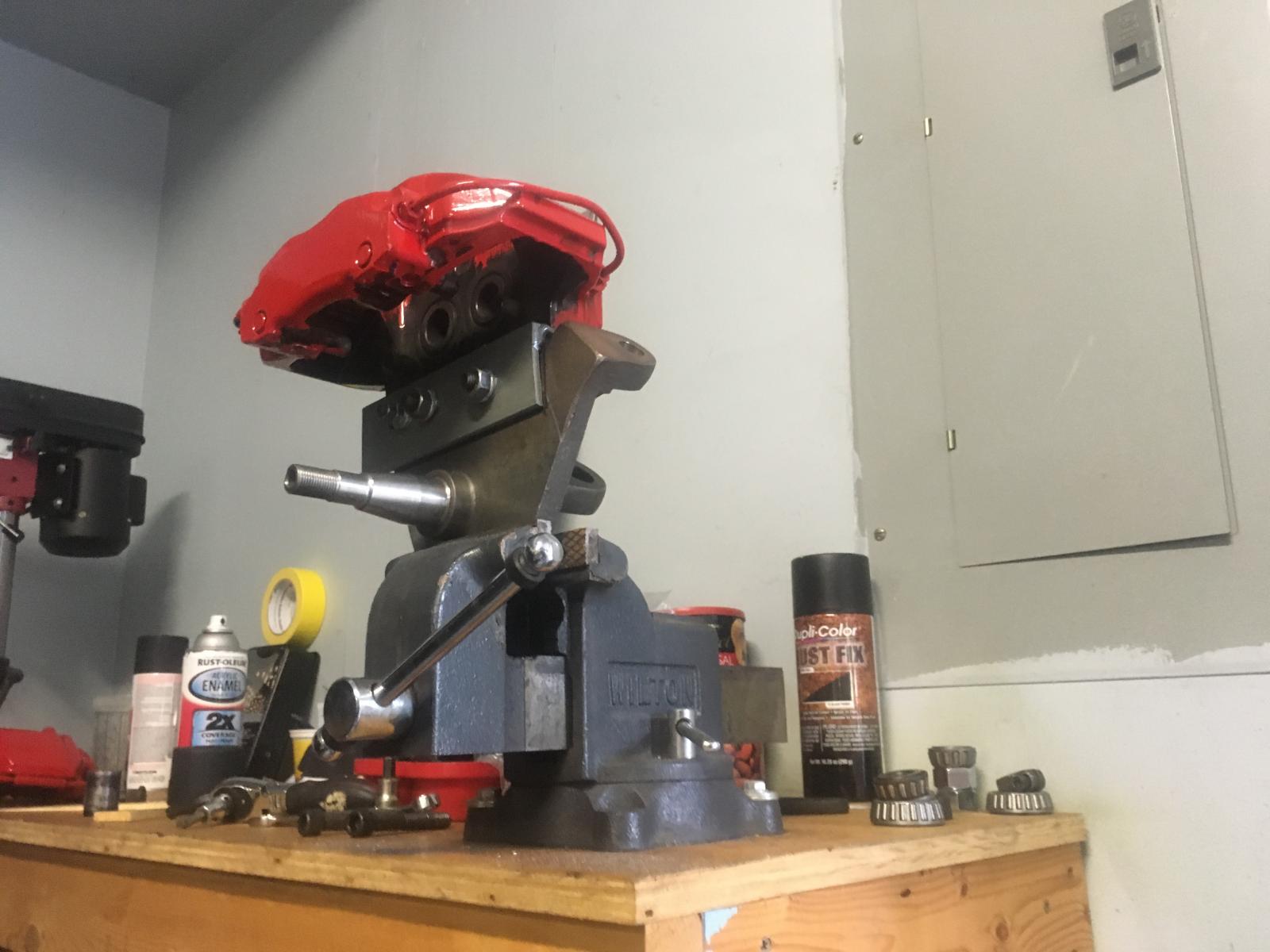

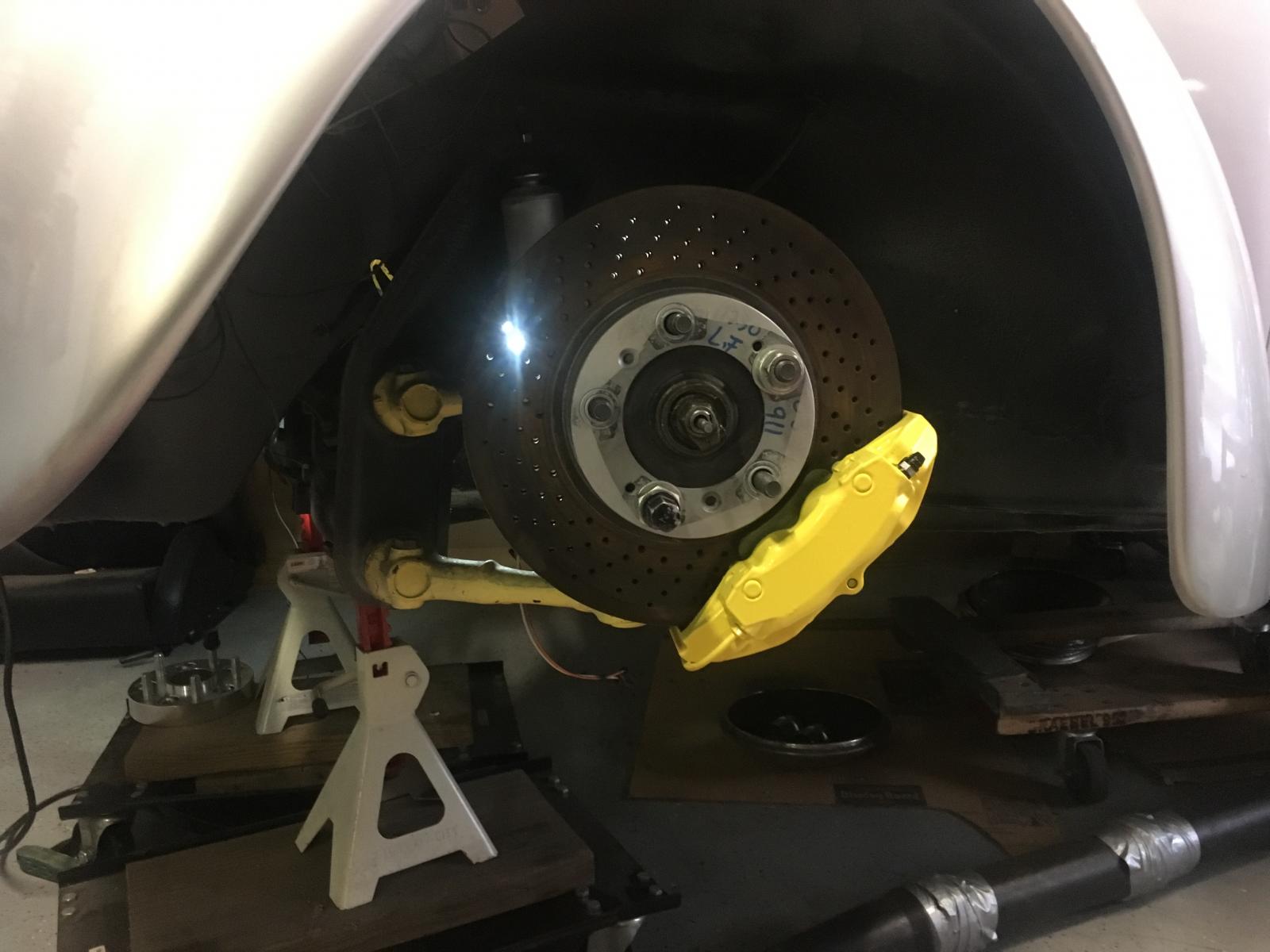

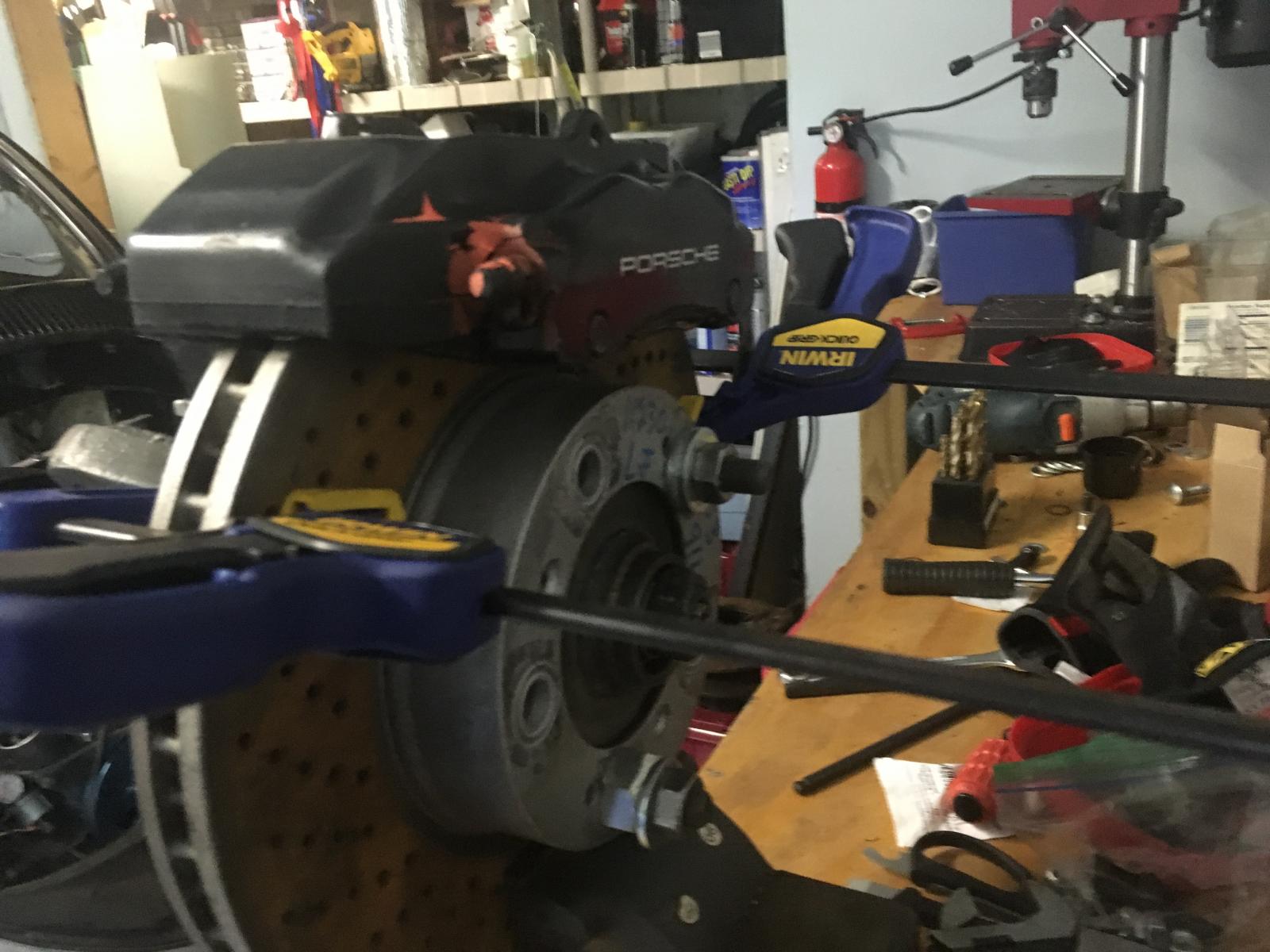

PostPosted: Sat Feb 09, 2019 6:12 pm    Post subject: Re: 67 Custom German Look Reply with quote

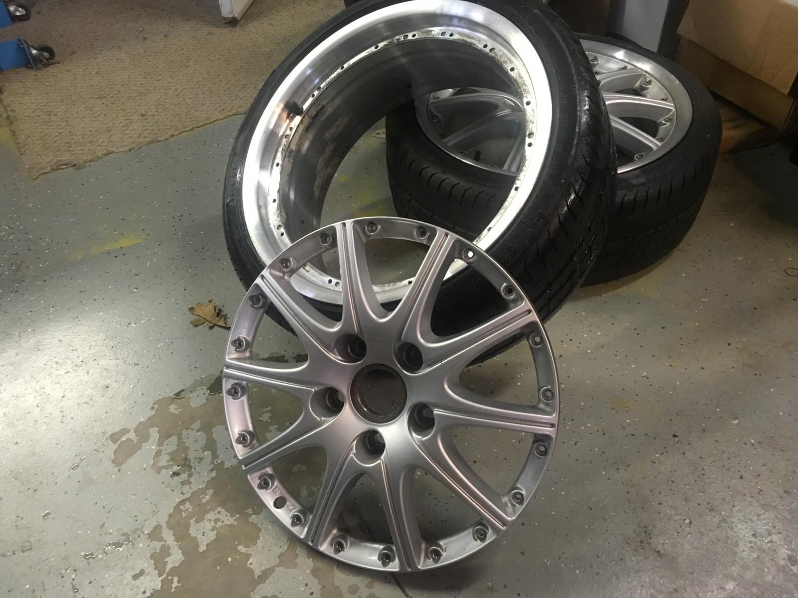

Disassembled and reconditioned wheels
Taking measurements to mock up brake install

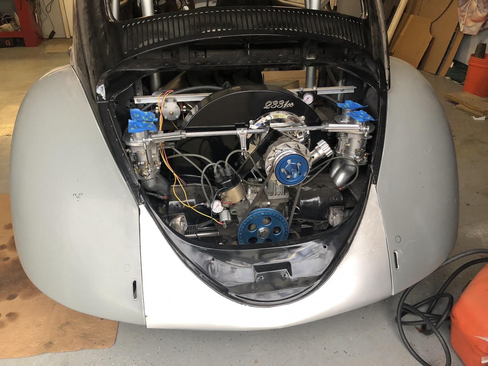

Very nice. Will there be an engine lid?

I recently picked up a nice 67 decklid & CCC makes a nice thick fiberglass 67 apron. I plan to do a removable apron.

Cool. The apron in your engine picture actually looks like it may be removable.

I had steel fenders that were widened 1” and the bodyshop lined up the steel fenders perfectly with the 66 apron. I have since changed to the CCC 1.25” fenders which you can see is way off on the drivers side. When I install the CCC 67 fiberglass removable apron I will fix the misalignment.

I like the color and mods, look nice and well thought out! What are the pods on the sides? Vents for rear brakes?

Ducting into the engine compartment for either oil cooler and/or intercooler for turbo or both. I want to have options and I like the look!

Looks great! I too have a German Look Super that was started from a total from 1999 that I plan on having on the road this Summer. What are you planning on running for side mirrors and exhaust? I made the steel rear apron on mine removable also. Much easier to do everything engine related.

I have a 1-5/8” sidewinder currently installed. For side mirrors I’m planning to use the 1st Gen. Mazda Miata mirrors. I had them on my VW previous....I like their shape. Fits the VW round body.

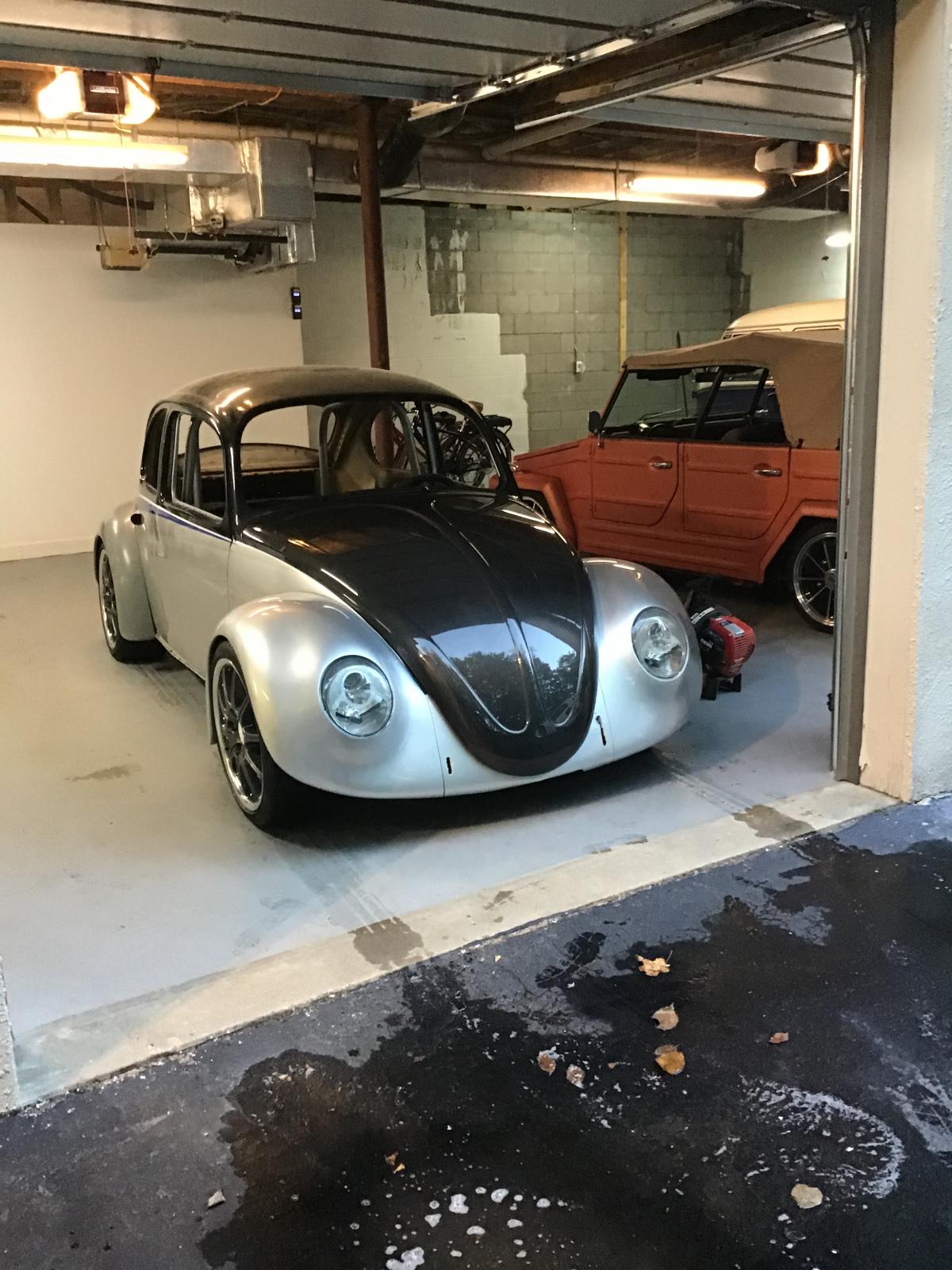

Was thinking of doing a 1” bumper drop but now not sure based on my current ride height. What do you think? I’m also thinking about loping off a few inches from both ends of the bumper blade and welding sheet metal to the upper edge of the bumper to fill in opening between bumper and body to get that one piece look.
Thanks
