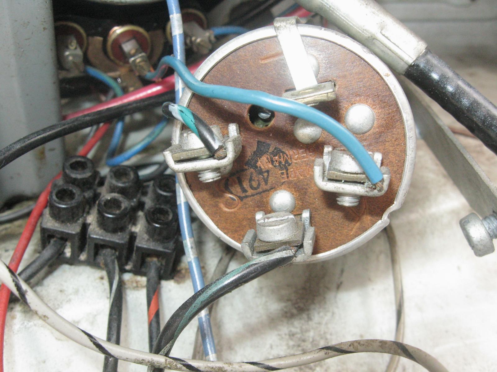

My 1960 VW beetle I just got was doing the same thing so I got the Wolfsburg West 6 volt flasher relay now it flashes too fast unless the headlights are on. I am thinking of trying one of these so I can run led's as the WW flasher won't flash the rears with led bulbs. 6 Volt Led Flasher.
I am in the process of chasing down voltage drops too. I found about 1/2 a volt drop in several places in the headlight circuit namely fuse block connections and the spade lug connections at the headlight switch and the dimmer switch seems to be losing a little voltage. Also the headlight connectors. (But better headlight circuit connections won't help the slow flasher unless they are found in the main circuit ie. 6 volt + wiring from the battery to the flasher relay or in the ground somewhere) But my generator is not handling the headlight load very well and fixing that would help.
Original Flasher wiring:
1960 Beetle And 1679cc DP W-100 & Dual Zeniths!
