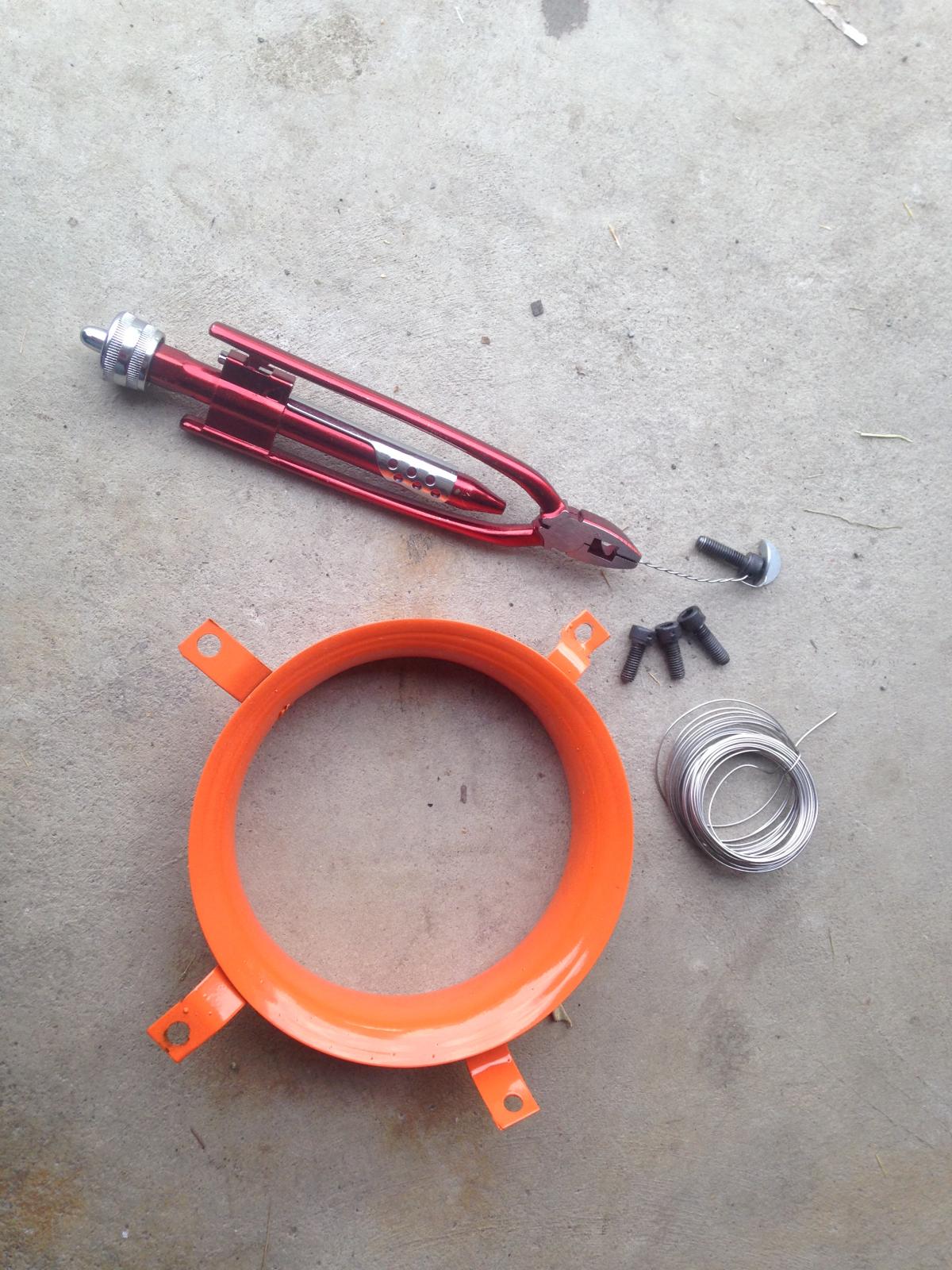

i mounted an anemometer to a piece of wood, it will get barely fit between teh shoud and the top of the engine, puts the meter about 1.5" form the firewall and 1" from the fan inlet, i am trying real hard to NOT get the meter (o rmy hand) into the fan!
with the stock fan, meter set on "max" airflow, i recorded the air flow at 1000, 2000, 3000, and 4000 rpm

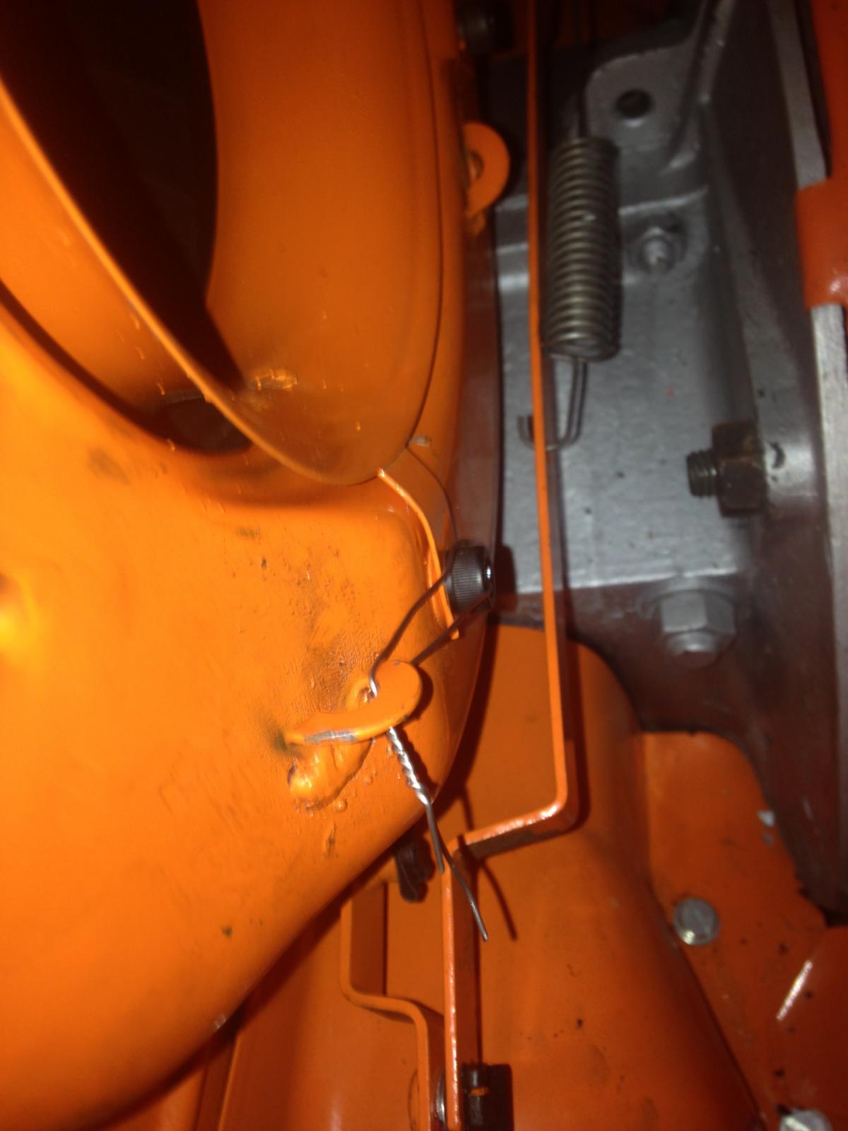

then i installed a venturi ring, now i make these, and i always tell folks to weld, braze or pop rivet them on, not to use screws as they can come loose, but i had planned ahead, i saftey wired the bolt to the shroud, drill a hole in the bolt, welded in a bent over washer, so now impossible to come loose, hard to get good pics, but you can imagine it
again, test at 1000,2000,3000 and 4000 rpm
take the ft/min speed results, multply bey the cross secitonal area of the fan in f^2, you get ft^3/min.
this chart has 2 axis, the blue line is ft^3/min increase in airflow, scale on the left, orange line is % increase in airflow, scale on the right.
so, you get 7.3% more airflow with the venturi ring install across the entire rpm range,,, pretty cool i think,
your thoughts?

Where did you get the sweet red anodized twist-pliers?
Oh yeah, and the Venturi rings, for sale anywhere?

i sell the venturi rings, on here, ebay and my website awesome powdercoat dot com
the pliers are called "aviation twist pliers" - i think i got them off amazon, not too expesive as i recall

The pliers are painted. The only way they could be anodized would be if they were made of aluminum. Aluminum won’t make real good pliers.
