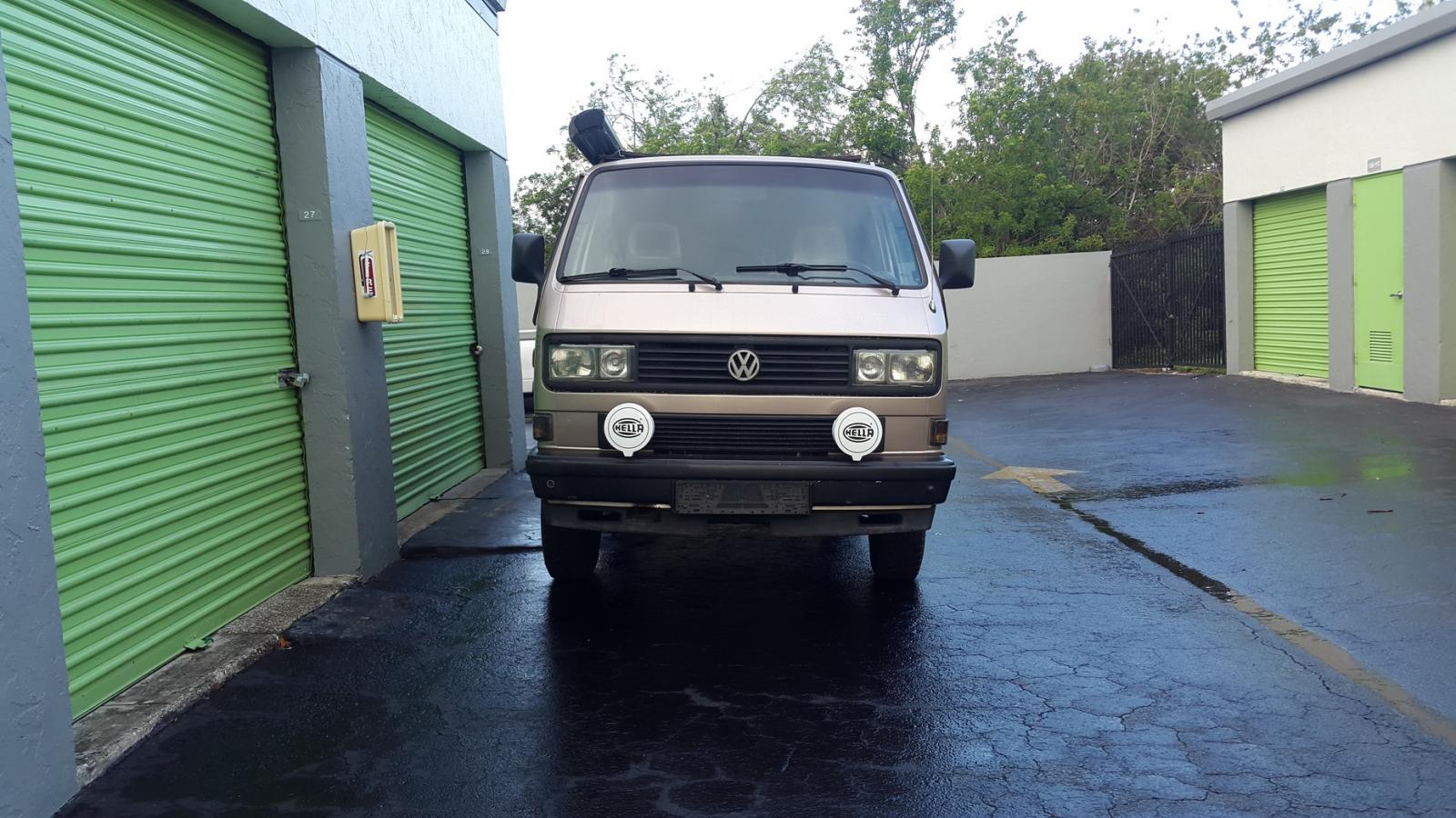

Most old rectangular headlights are just plain unsafe and should be replaced (see my photo of the worn out “reflector” in the thread above). I hope Bus Depot sells hundreds of kits (I may have gone with his kit if it was available at the time I followed the DIY instructions in the thread).
Post a write-up of your install! I’d love to see how it all goes together.

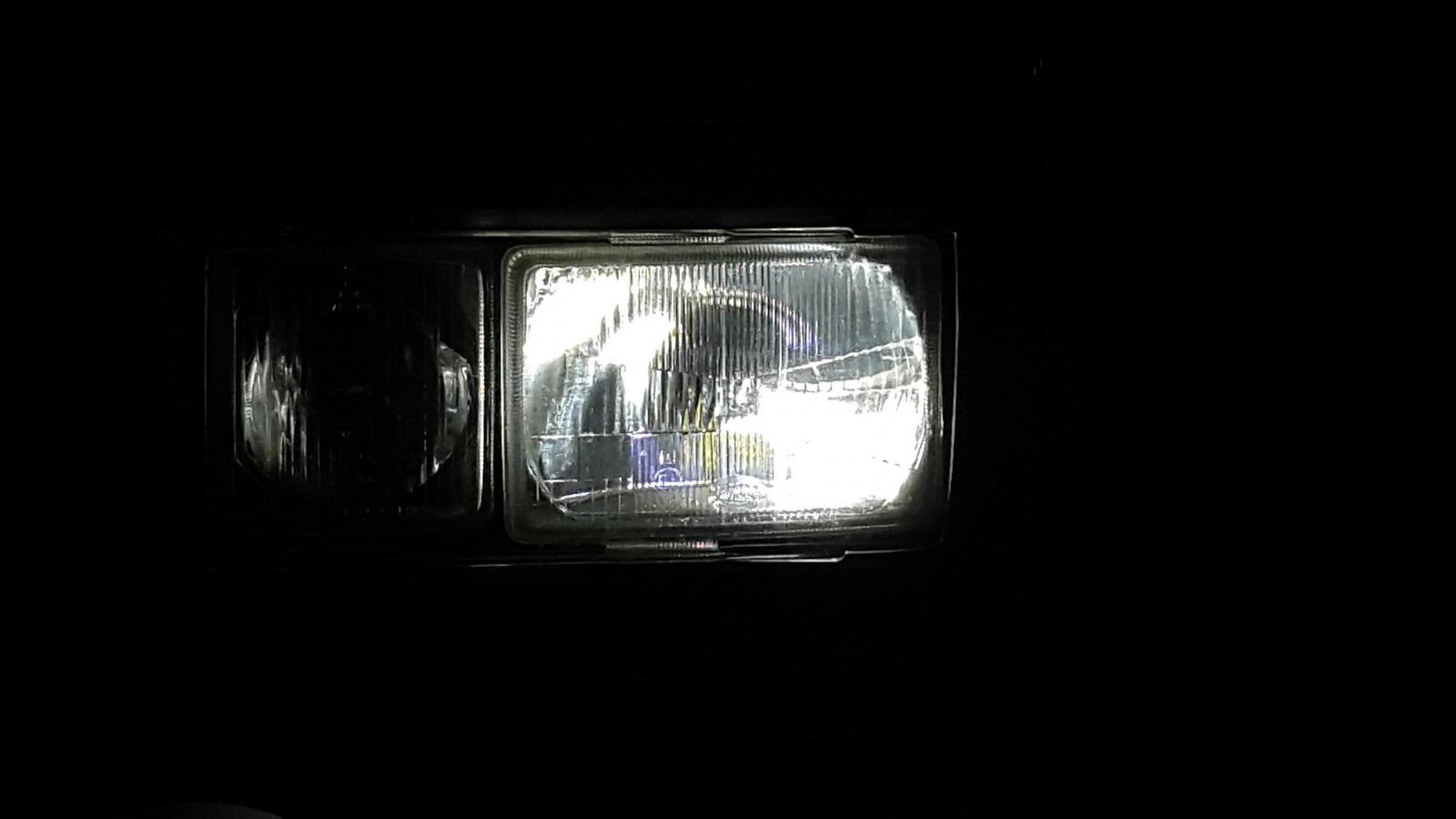

PostPosted: Wed Dec 27, 2017 3:27 am    Post subject: Re: Bus Depot New Vanagon Rectangular headlamps Reply with quote
If they are the same as I have on my Syncro imported in 2016 they do work much better then the OEM VW.
However, my hopes of using the city lights(parking lights) as DRL's has not lived up to expectations.
The city light bulb is too far away from the optical center to show a concentrated beam that is what you need to attract attention.
I do have LED bulbs in for the city lights and they are bright, but just not enough uumph in daylight due to the offcenter of the bulb. The LED's I put in were the highest power I could find for the socket at the time and brighter then the H4 low beam.
I had to fit the LED from the inside out as they were too big to fit through the opening.
I'll post some pics tomorrow in daylight for a DRL evaluation.
Meanwhile here is a night shot showing the reflected light from the city light being too far away from the ideal optical center..

PostPosted: Wed Dec 27, 2017 4:31 pm    Post subject: Re: Bus Depot New Vanagon Rectangular headlamps Reply with quote
So the City Lights as DRL in Daylight...actually overcast and in the shade of the building.
City Light OFF
City Light ON
City light at a distance not jumping out at me!Overcast day in the shade too!
Low Beams ON
City light bulb inside the lens.
Now having said they don't light up my life I still use them as DRL's only because they are different and people do notice something different.
I plan on upgrading with some Cree light Strips.
I would still buy them to get a set of H4's in the size for the grill.

Okay I got far enough way from the city and found a roadside picnic area to see if the city lights would light up enough to see at night.
The result is I am suitably embarrassed and will admit my ignorance.
However, while they do cast a light forward enough to see in total darkness the problem is that if you just drove in with your headlights on your eyes may not adjust to the dim city lights to see.
1/2 hr. after turning off all the lights and your eyes accustomed to the darkness they did have enough light to see.
City Lights. Okay you cannot see what is there in this image, but I can see that there is something there in the camera's image.
Low Beams to show how far away the table really was.
