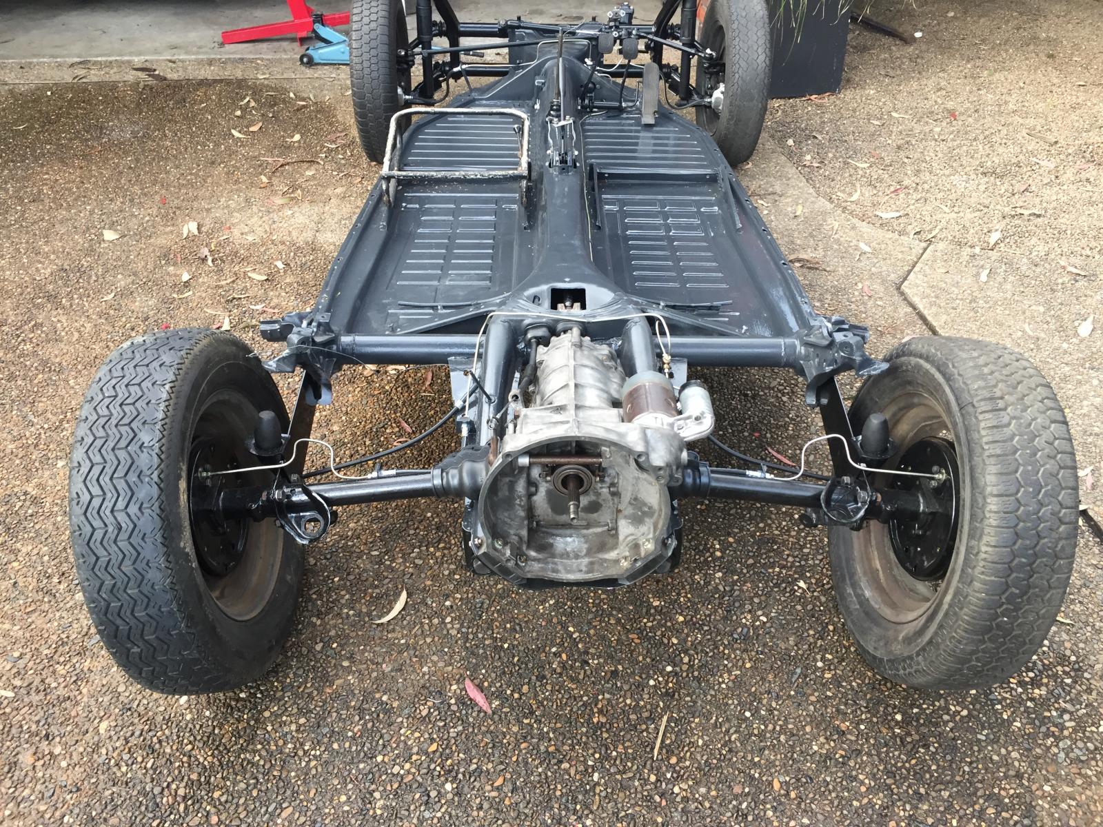

The key to figuring this out is the brake line brackets should be facing straight forward toward the front of the car. As noted, the axle tubes are currently on the wrong sides of the trans.
How they should be oriented:

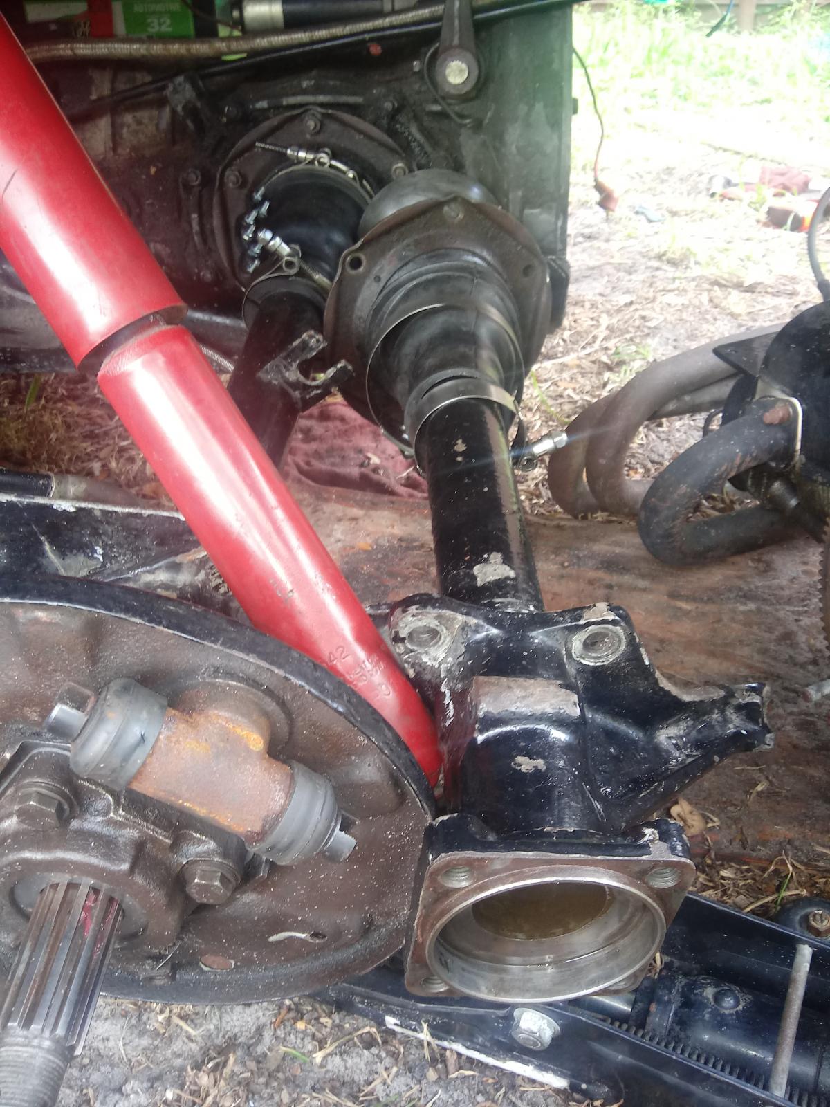

flabuggy wrote:
I have swapped them from side to side and the shock mount still ends up in the wrong place{behind the axle. The brake mounting tabs are welded on. I can't see how I can rotate the bolt holes, there are only 3, and there is only one way all 3 will line up. Here is a picture of both tubes side by side on the left side.
In this picture, your brake line bracket is facing the rear of the car. If you take that tube off and put it on the right side, that brake line bracket will be facing the front of the car, the shock mount will be pointing forward and down, and the shock will mount FORWARD of the axle tube. Q-dog’s pic shows the proper orientation of the shock mounts and shocks, mukluk’s pic shows the orientation of the brake line brackets. Note that these pics are taken facing opposite directions, so make sure FRONT is FRONT!

I have a Euro '68 with swing axle but it should be identical. I always thought US '68's came with IRS?
I went and checked the orientation of the bolts on my axle.
When looking at it (LHS) towards the brake drum from the transmission the bolt aligns as approx 11, 3, 7 o'clock.
The right one should therefore be 1,5 and 9 o'clock.
The rear facing bolts line up (11,7 and 1,5) whilst the single bolt faces forward (3,9).
Any other orientation you have a problem elsewhere or they are the wrong axle tubes.

PostPosted: Mon Aug 26, 2019 6:41 pm    Post subject: Re: swing axle Reply with quote
If you blow up the section below it might help with the orientation. Not sure if your axle tubes are like mine. Hard to tell.
