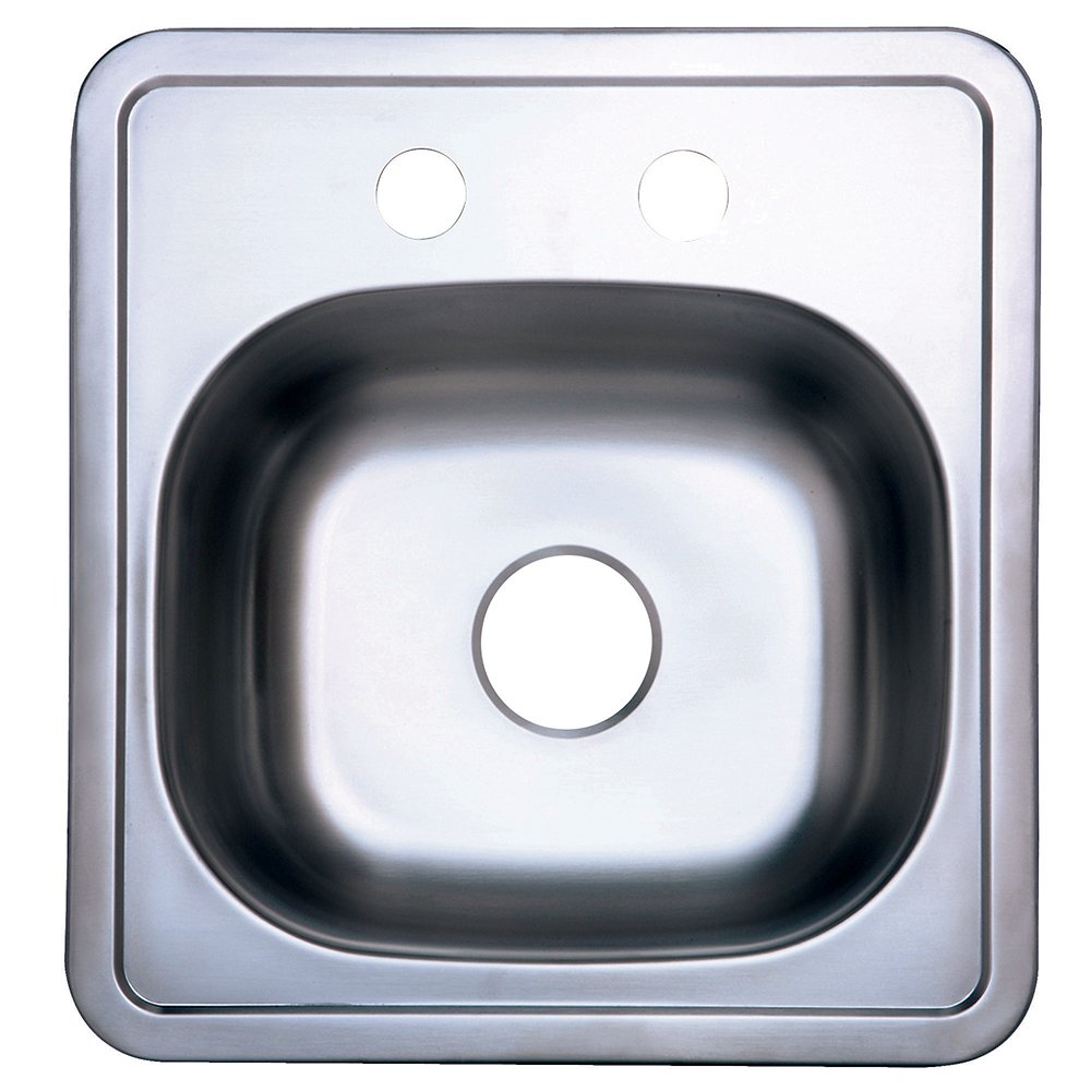

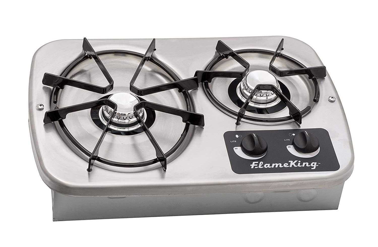

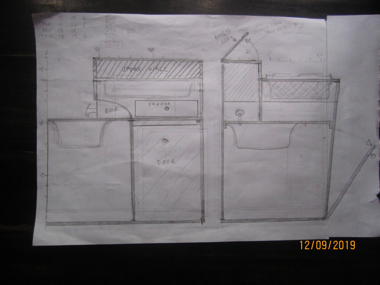

According to the sizes of all the components I intend to order today - and the size of the standard 20lb propane canister > and taking into consideration the sizes of all the building materials I already have here in my Mom's basement (stuff she wants me to chuck out anyway LOL)… I have come up with this design.
Influencing the design also is that I have decided that most likely (for the foreseeable future) I will not be going with a hightop or even a poptop - but rather just keep the tintop as is. Also likely that I will not be upgrading the engine from the 1.6NA to a more powerful engine. So I want to keep weight down.
The interior as is, right now, is in fantastic shape, and I love the very low sitting full bench. I realized that if I have a low sink, I can very comfortably sit on the bench and cook. With the full bench transformed into a huge double bed there is not much need for the second bed upstairs that we get with high/pop-tops.
With this kitchen and with this van in general - considering the lack of time and money I have to invest in him, I want to keep things absolutely as simple as possible. So it struck me that I could eliminate a lot of trouble and expense by simply using gravity to deliver water to my kitchen sink rather than faucets and pumps and underbody watertanks and drilling holes and blablablabla… furthermore countertop tank I intend to use only costs $15. To fill it I just lift up a hinged counter and pour the water into the big hole on the top of the tank. the tank itself will drape over into the sink, and just flick the plastic dispenser lever and we have water.
Beside the sink will be a small area for a cutting board, and the stove will be at second level slightly higher... a 3rd counter space will be slightly higher than that, will be a hinged cover for the water tank - this will be at about window lever, and good for putting plates and bowls on to be served food.
Under the sink will be a large open space for storing dishes and some food... and under the stove - accessible by a fold down hinged door, will be another large storage space which will fit a 20 lb propane canister. [I am not sure if I will actually travel with this large canister, but at least I have the option to fit it in there].
I will be ordering the components today... any thoughts or feedback will be welcome -

I like it but I'd ditch the 20lbs propane tank and go with a 5 or 10 lb max tank. 20 lbs is way heavy, large, and overkill to an extreme.

Here's an 11lb tank that's shorter than the one linked above:
Manchester Tank 10393
For the water tank I might look for something more durable. I've had clear plastic jugs get bounced around and split the corners and very very slowly leak everything out.

The tall 11 lb is your best option IMO.
You state that 1 lb a week is what you need.
So 11 lbs is 10 weeks with a little to spare.
Propane can be refilled almost anywhere.
Carry a 1 lb disposable for backup, giving you a week to fill the empty main tank.

OK, problem resolved... the stove I want in fact IS suitable for indoor use. I just have to buy the pressure regulator.
The girl I talked to had got confused because the add for that stove at HOME DEPOT had a mistake on it.

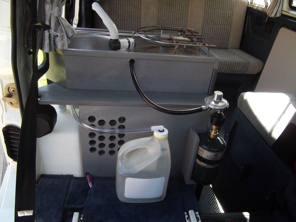

If I build a kitchen into a van I don't build in a portable stove. I build in one meant for inside use.
Here is an example.
