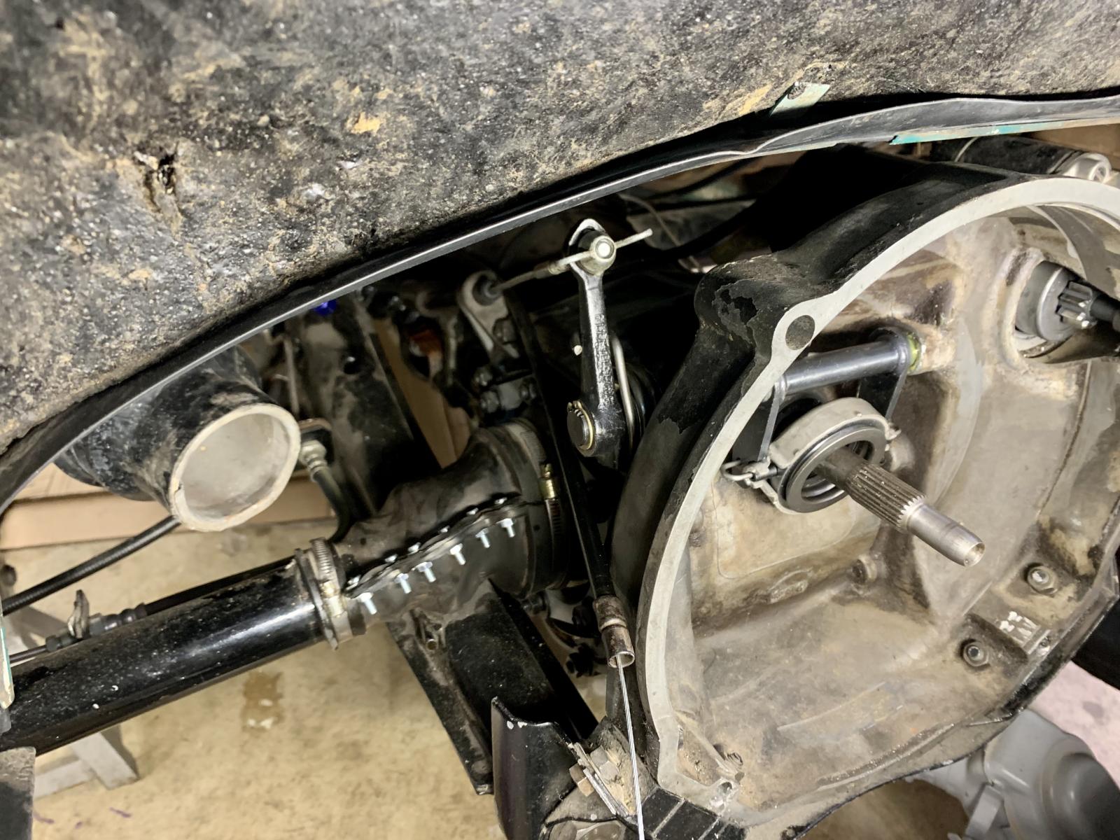

The hardest part today was getting that throw out bearing shaft bushing out of the blind hole! But it’s all done and the engine is back in. I popped in an HD welded throw out shaft with new bushings and hardware, all from Weddle - the holes for the bearing clips are a nice touch!
The rest of tonight I’ll be roasting coffee for some stores that carry our beans. Then tomorrow I’ll see if I can knock out the engine hookups and get the old girl started in the garage. Driving it on my five-year-owniversary looks like it might happen!
