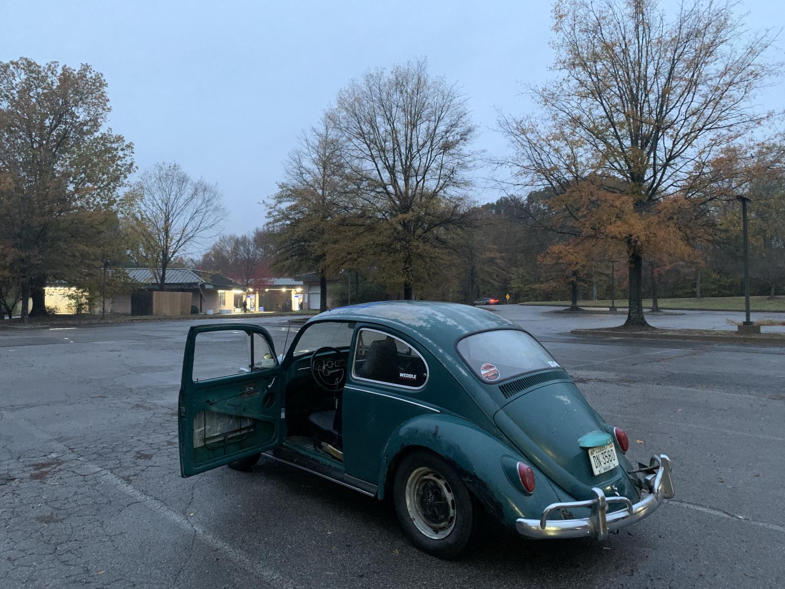

PostPosted: Fri Nov 22, 2024 3:45 pm    Post subject: Re: Scrivyscriv's 1967 java green sunroof sedan (stock) Reply with quote

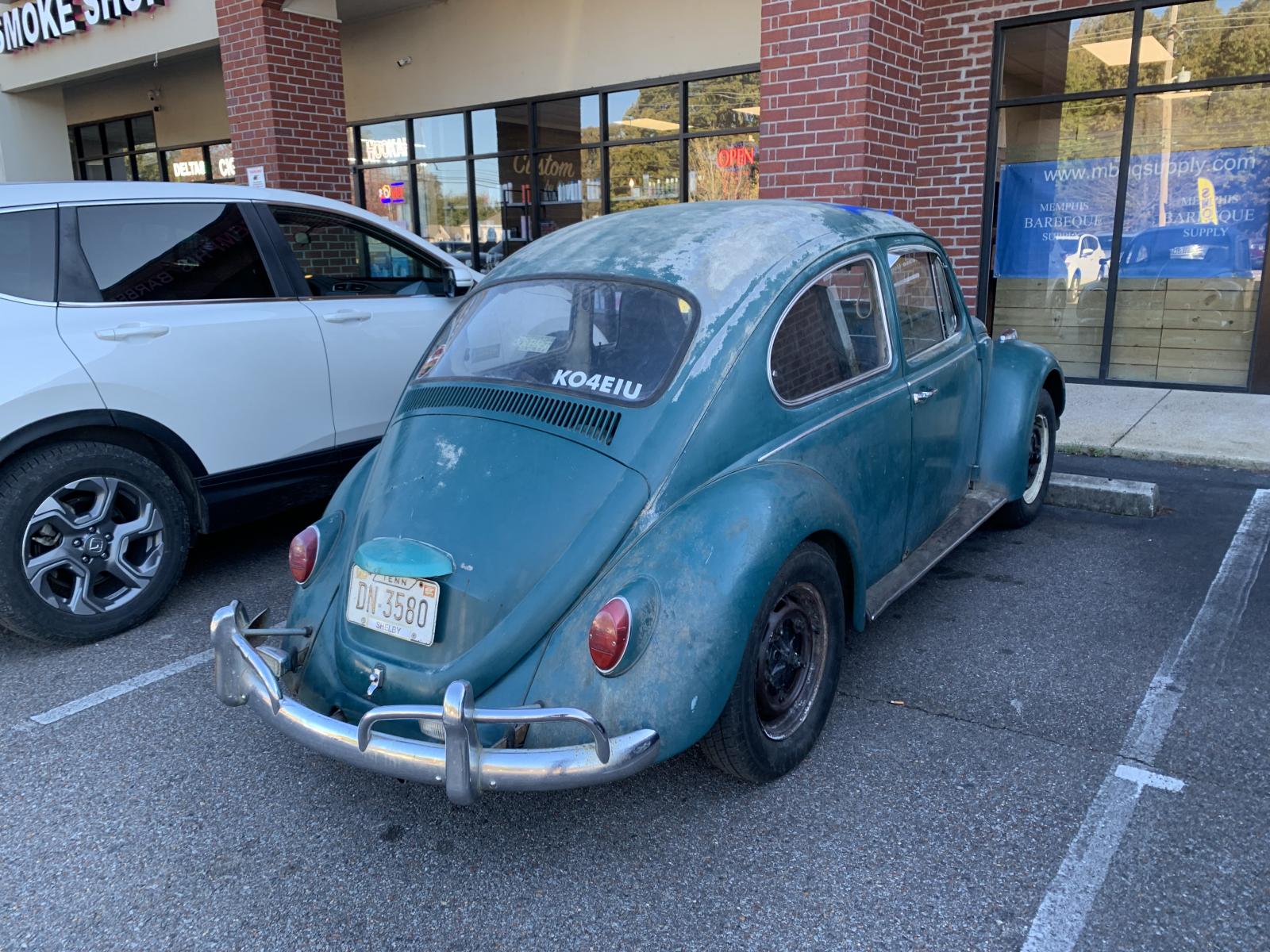

Got the old odometer to swing around and cross 135,000 today on a haircut outing!
On a cool 55°ish degree afternoon, with all the heat hooked up, we warmed up pretty fast. I understand now what people mean when they refer to the vent airflow as “anemic!” It works, but man I wish it blew a little harder. It will be hard to defrost/defog the glass in the mornings for sure. I still have things to tidy up - I think either my choke is sticking or the pilot jet solenoid is causing a problem: it runs and drives at speed great! But when I come up to a stop, weather coasting or downshifting, I have about five seconds of idle before the engine just quits. It started right back up every time, and would idle if I gently let the pedal back down. So I think it’s an adjustment issue, and I know for sure the choke is sticking.
But it’s okay.. I’m putting miles on it. I’m blowing dust out of the heater channels. I’m putting wear on the tires and getting my brake shoes bedded. It’s wonderful!

Progress! Looks good.
Maybe you could replace the flexible ducts between the heat exchangers and the car with custom ducts that would house inline 12 volt fans, something like this:

Congrats. Looks great. I imagine a slightly dropped beam and 356 wheels. Cool

PostPosted: Wed Nov 27, 2024 5:54 pm    Post subject: Re: Scrivyscriv's 1967 java green sunroof sedan (stock) Reply with quote
We made it back home, so I’ll count that as a win. Like I told my almost-13-year-old-son on our inaugural ice cream trip, we’re shaking it out, looking for problems! I’m happy to find problems a few miles from home without the pressure of being late somewhere.
This is the problem:
After driving a few miles from home, with a correctly adjusted and fully warmed up choke, it’s hesitant to start back up after I shut the engine down. It cranks and coughs but immediately sputters out. When I loosened the fuel pump line coming from the tank, fuel came out. Next I opened the filter bolt and thought it was weird to see the fuel was draining out in spurts. It would also pump out of the disconnected top hose in intermittent spurts while cranking. Eventually I took the filter bolt back out and the fuel started draining out normally like I expected to see, instead of spurting. So then I hooked everything back up, pulled the ignition #15 off the coil, cranked it 10 seconds, then hooked ignition back up and it coughed to life.
I’ve never seen a gravity fed fuel line drain out in spurts like that. I believe it had air or fuel vapor in the line. I checked the fuel cap just to be sure and there was no vacuum on it. It’s hard to tell if I have a fuel problem going to the pump, or a fuel problem WITH the pump. I rebuilt it with the new style Wolfsburg West diaphragm a year or two ago. And I blew the chassis fuel line out front to back before putting it all together. So it’s going to take a good bit of investigation to find out the root problem.
