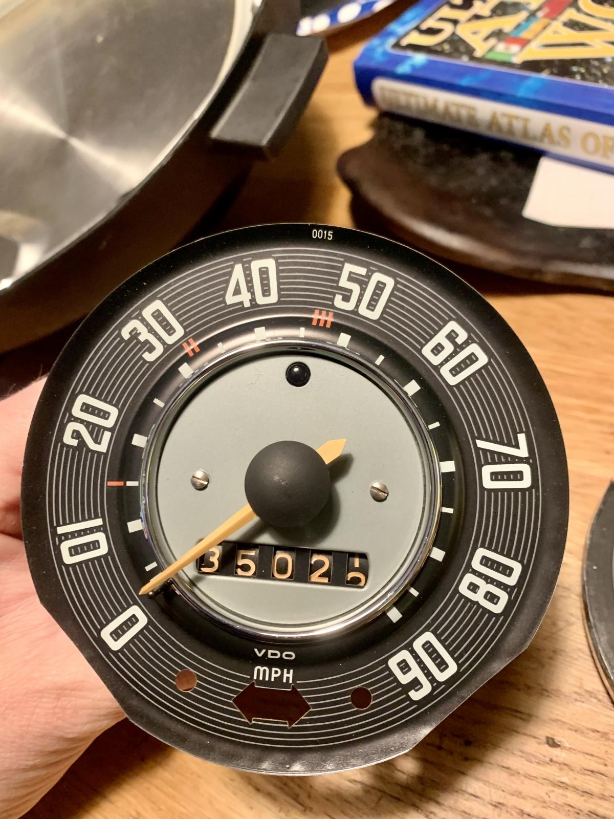

Risky surgery tonight.
I managed to snap the needle off, but the superglue repair seems to be working!
I had the worst speedometer squeal that was getting louder every time I hit 45MPH. I used Molykote paste to fix it, and thankfully I didn’t find any other broken gears or parts. The needle reassembly was a little tricky but I found there’s a sweet spot where the needle shaft seats down into its tiny little bearing.
Overall I think the speedometer squeak is fixable without disassembly. If I were doing it over again I would dribble some 3-in-1 down the input shaft. It’s not as much of a long term fix but much less risky than tear down for cleanup and regrease
Robert in Memphis

The needle was just collateral damage and a total accident that it even happened! It doesn't need to come off just to clean and grease the gears and input shaft.
Look at the second picture in my post above, where I'm holding the drive mechanism: In the very center of the mechanism there's a tiny brass bushing, with an even tinier hole in the center. The back of the speedometer needle shaft rides in that bushing. When I was reassembling the body back into the chrome and glass, I did it with the glass flat on the table, and the body of the speedometer facing down. The needle shaft got dislodged from its tiny bushing and caused the needle to stick in place. I opened it back up to fix the needle and get its shaft lined back up; I accidentally put pressure on the needle with it resting against the little "zero" peg, and the tip just snapped off and went across the kitchen like a rocket! Laughing
It only takes two twist tabs to separate the input mechanism from the odo and speedo mechanism, after the chrome ring and glass come off of course.

PostPosted: Wed Dec 18, 2024 5:33 pm    Post subject: Re: Scrivyscriv's 1967 java green sunroof sedan (stock) Reply with quote
When you replace the cable, consider changing its associated rubber grommet in the spindle too - it keeps water out of the wheel bearings on that side. I do agree a bouncing needle generally seems to be from a cable problem, whereas a noisy speedometer is usually a speedo lube problem.
https://www.wolfsburgwest.com/cart/DetailsList.cfm?ID=111957855A
Robert in Memphis
