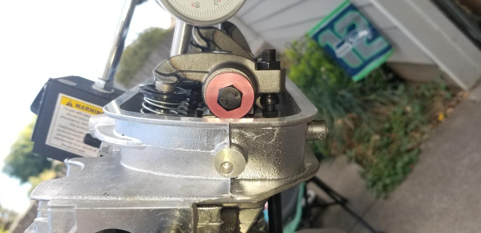

The softer spring is used to set the rocker geo. Without having to use the cam and lifters to move the rocker arm.
Basically you can get the geo set with the head off the engine when using the soft springs. I got my soft springs from Ace Hardware.
After the geo is set. You install the head and figure out the correct PR length.
Good Luck.
Good Luck.
Is the wire clip hole offset like that on purpose?
Good Luck.
The heads are Tim's stage 2. They came that way and the bails give the correct tension on the valve covers.
I can only imagine that the Tim's measured the distance to get the bail over the valve cover. Before the hole was drilled.
