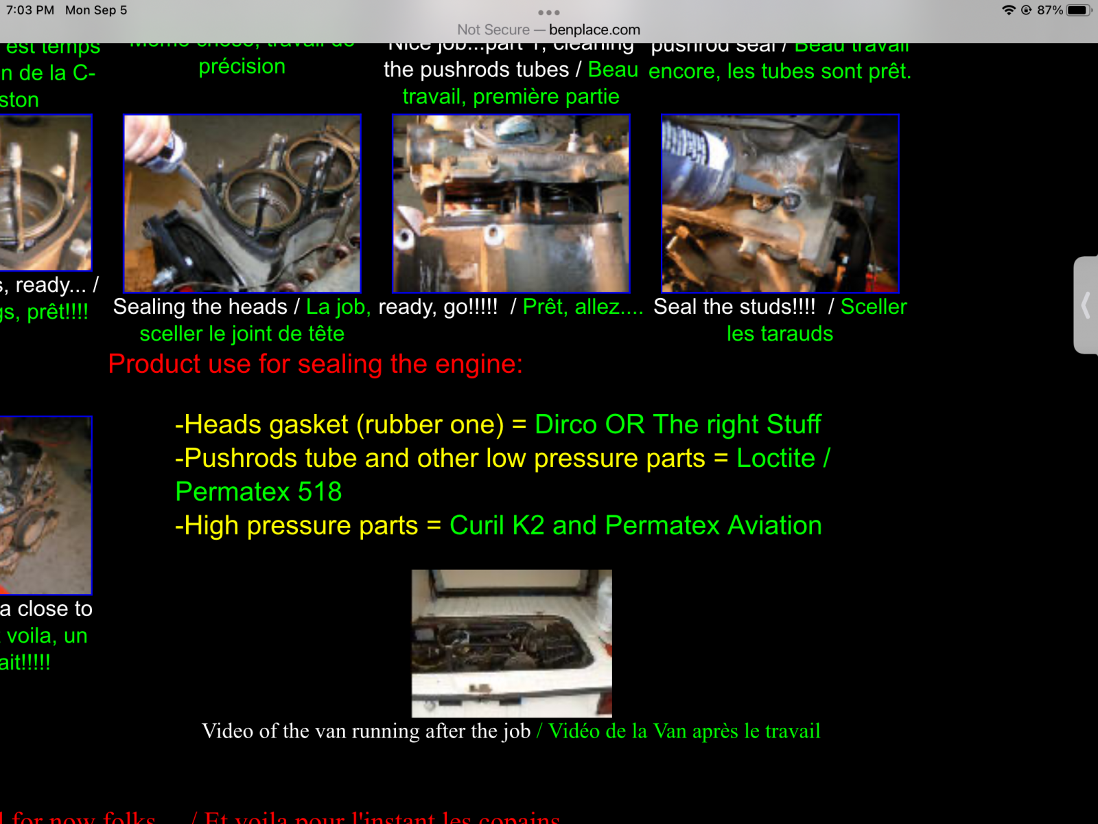

Here is a screenshot from benplace.......
I pretty much follow his advice except I use Hylomar Blue on the fire rings, cylinder to case, pushrod tubes.
Hylomar is an AMAZING sealant!
