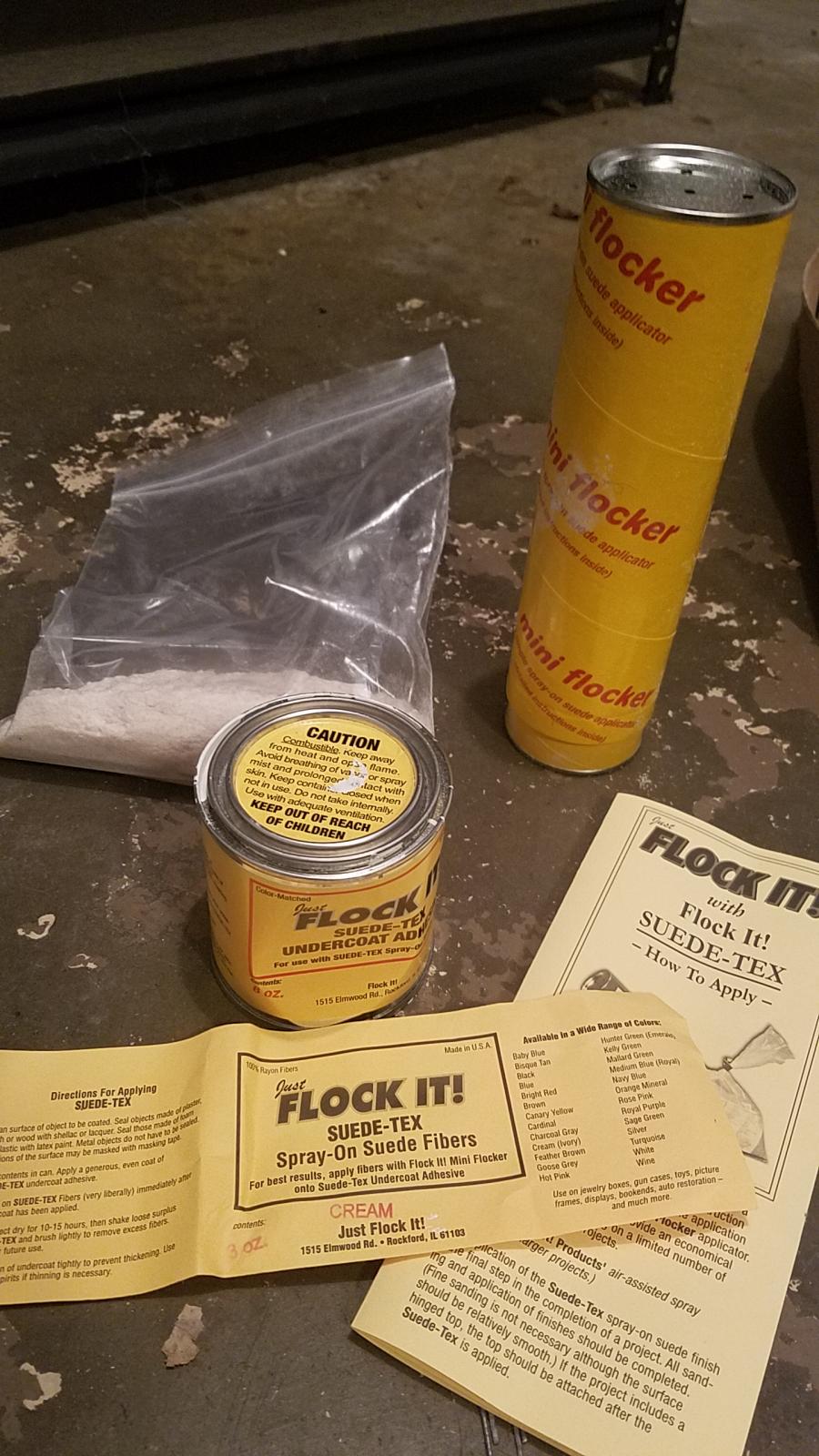

OK - so, I wanted to flock, but what do I do next? Well, TheSamba came to the rescue, and one of the posters suggested a mini-flocker kit from Flock It! (http://www.flockit.com/index.php/products/suede-tex/mini-flocker-kits.html). It looked like they had a good system, so I bought the cream (Ivory) nylon kit, and sent my mesh out to be zinc re-plated.
The mesh came back beautifully done, and, interestingly was pretty flexible (the cleaning and re-plating apparently allows the mesh to move against itself much more easily). I'm glad I marked what side went towards the driver, because both sides look good, now!
Before I started with my mesh, I decided to do a few test flockings first. I went to the hardware store and bought some window screen and some chicken wire (the mesh is somewhere in between these two sizes). I'm glad I did, as well, as all did not go as planned!
My first few attempts were a disaster. The adhesive (really, very sticky paint) was too thick (you apply it with a brush)! It kept on flowing into the screen holes and my flocking basically would (inconsistently) cover up all of the holes. In addition, it would get on both sides, so I had a completely flocked screen. After a few more frustrating attempts, I decided that the adhesive provided was not meant for screens - it was meant for self-leveling for things like glove boxes. Even using mineral spirits did not make it thin enough (and still work) to not flock the screen holes! I thought I could do it right on the original mesh. Nope! Luckily, it all came off after soaking in nail polish remover and scrubbing with a nylon brush! whew!

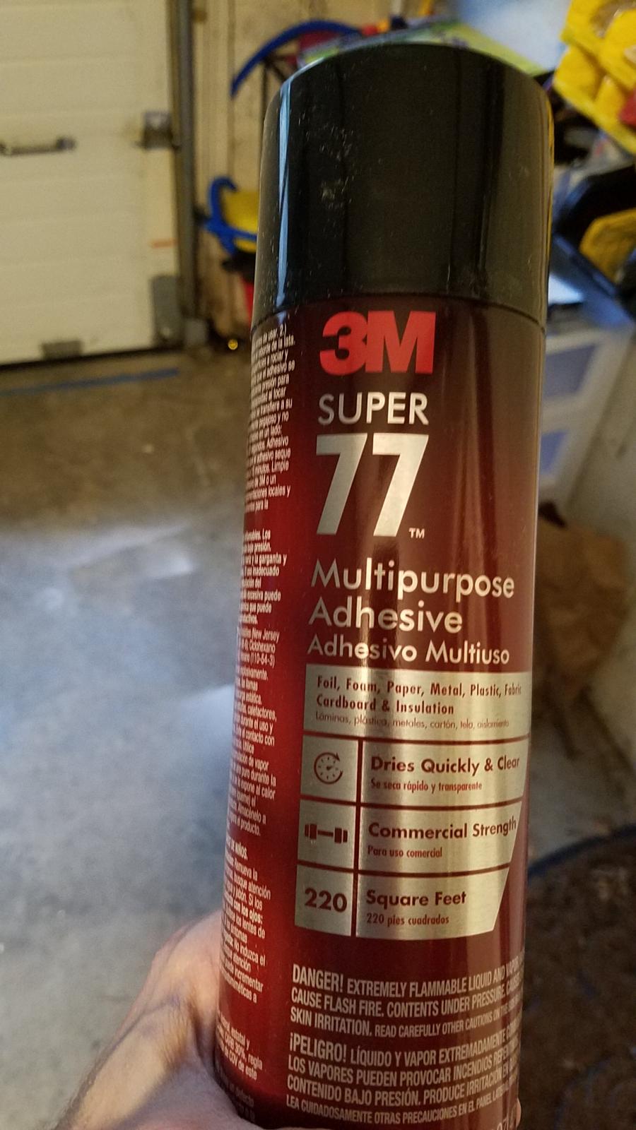

My next attempt was to try a spray. I purchased four different spray adhesives: Elmers extra strength spray adhesive, Loctite spray adhesive (general performance), 3M super 77 multipurpose adhesive, and Rust-oleum paint+primer. What's that? Paint is not an adhesive? Well, it has some adhesive qualities, and, since the Flock It! adhesive looked and felt like paint, I thought I would try it. Here's how it went:
* Paint+ Primer: This was a very weak adhesive. It did spray well, and dulled the metal, but it just didn't capture many fibers
* Elmer's: This was slightly better, but was more like the paint without the coloring - it didn't hold the fibers *and* the metal showed through
* Loctite: Slightly better than Elmers - held more fibers, and sprayed fairly well
* 3M: This was the stuff! It was strong and could hold a lot of fibers.

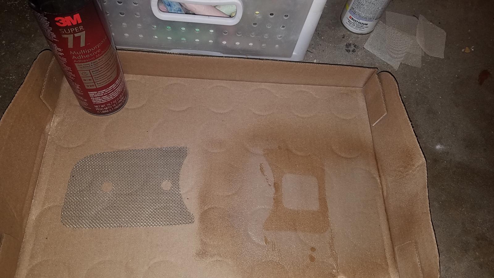

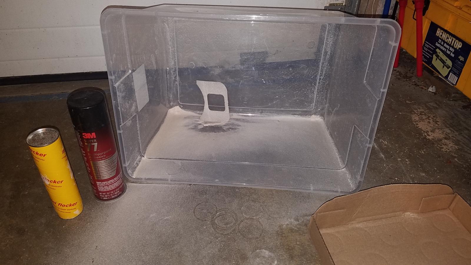

OK, so now it was time to do the final flocking!
1) I set up my "flocking booth" (a plastic tub I had gotten from Target) - this is used to recapture the flocking that does not stick (you can reuse it). I put a piece of duct tape on the bottom to make sure the mesh didn't slip down (I had a problem with this one time, as it fell over, and messed up the consistency of the adhesive)
2) I set up my "spray booth" (a cardboard carton)
3) I filled my flocking bottle half way with flocking, and got it ready
4) I shook up my 3M adhesive
5) I put on my latex gloves (wow, the first time I flocked I got paint all over my hands - and I didn't want adhesive all over them)
6) I put my first mesh piece in the spray booth, facing up the way it would face towards the driver
7) I heavily sprayed the mesh, going evenly back and forth (maybe too heavily)
Cool I quickly took the mesh by the edges and put it in the flocking booth, propped up, facing towards me
9) I started pumping the flocking bottle, facing down at a 45 degree angle and twisting it at the same time, to make sure the flocking material came out. I kept doing this until the mesh was completely covered and I couldn't see anything (only what sticks will stay)
10) I let it dry in the booth
11) later that day, I knocked it down a little to get off the excess flocking, and recaptured it into the flocking bottle
Whew! I then repeated this for the other mesh piece.

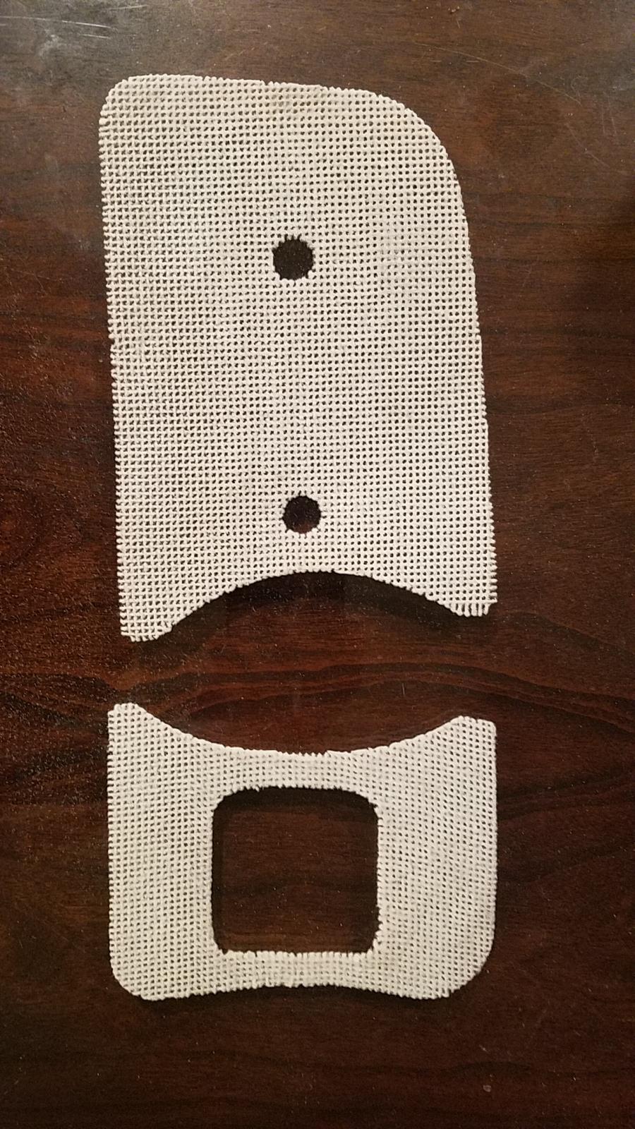

Front of mesh:
Back of mesh:
What I noted was that even with my many attempts, I didn't evenly coat it enough. As a matter of fact, I missed a corner of one of the mesh pieces, and tried to redo it (mistake - you can not spray adhesive evenly on just one part, after flocking - as you can see, it's a little over covered in that corner, now).
So, it's not perfect, but I'm pretty happy with it. I also know that the flocking will fall out over time, so it may weather/age well. Before installation, I might scrub it all off and try again, now that I've learned a bit. But I might not. My goal was achieved. I notice it's already shedding, though. Shocked

PostPosted: Sun Feb 23, 2020 12:44 pm    Post subject: Re: What the flock is flocking? Reply with quote
As a follow-up, I did decide that I wanted to try to make the mesh flocking look a little better, so I made a couple of changes to my process:
1) I did both pieces together to make the cover more consistent
2) I did a base coat of the Rust-oleum ultra cover smokey beige paint (I did this to ensure it still looked colored if flocking falls off inconsistently)
3) I did a heavy spray of the 3M super 77 multipurpose adhesive
4) Applied flocking on all pieces at once
5) Used a wooden skewer I bought at the grocery stores (for kabobs) to poke consistent sized holes in the mesh
After flocking, while poking the holes with the skewer:
At the end, front of the mesh:
At the end, the back of the mesh (to show the metal hasn't been coated - just the front):
