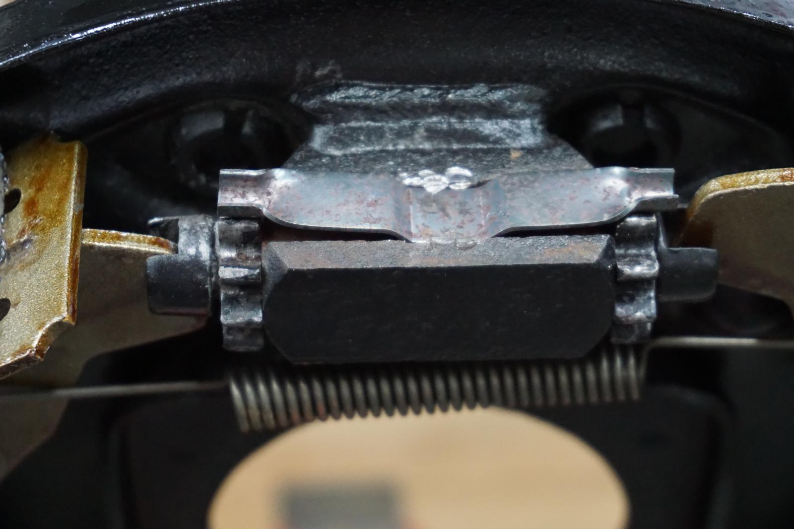

PostPosted: Wed Apr 22, 2020 8:42 am    Post subject: Reply with quote
tjettom wrote:
The old one has already been removed. Are you saying the new replacement spring is too wide to fit into the existing space that the original came out of? So you say to notch (I assume you mean to grind) the width of the new replacement spring...and then are you saying to use a punch to peen the edge of the notch to swedge it in the grove in order to hold it from falling out? Maybe I'm confused at the explanations given?
I'm having same problem. I got new springs but can't get them installed in the original backing plate slot. How did you solve your issue?

PostPosted: Thu Apr 23, 2020 6:24 am    Post subject: Re: Drum Brake Question - spring for star adjuster Reply with quote
Volcrew wrote:
The 'stud' part of the adjuster on the right is 180° out. Just saying... Cool

PostPosted: Thu Apr 23, 2020 8:58 am    Post subject: Re: Drum Brake Question - spring for star adjuster Reply with quote
Good catch! Thanks so much for speaking up! I'm not an experienced Bug mechanic and it easy to get things wrong. I've often wished I had a Bug friend to look over my shoulder as I attempt this restoration.
I will have to pull the drums and look at all eight of them now.
