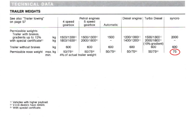

Hi all
I have following question
I owe a '89 syncro 16". As far as i know standard springs and dampers. To store the sparewheel and other stuff i build myself a rack on the rear bumper. I actually made a mistake as i built it as one swing arm full width so its really heavy to move and cant hang without support when open
Also i wonder if it has not become to heavy over all.
I have a spare wheel, Hi lift jack, 20 ltrs of fuel, an alu box with some stuff in it (some spare oil, jump cables etc) and on top camping table and chairs.
But looking at some pics on the web i see people having a spare an 4 jerryt cans on the back which seems to be at least just as heavy.
The ride heigth at the rear is 17,5" when loaded like this and without all (incl rack) its 18,3"
So i wonder, am i ok like this or do i need heavier springs? I have searched the forum and the web but couldn't find anything conclusive
any advise, suggestion is welcomed
rgds
Ron

84 (85) model year Caravelle GL 1.9 DG Auto WBX Bronze Beige Metallic w Steel Sunroof

I'm not sure the trailer tongue weight translates directly to maximum bumper accessory weight.

Hi Dave
No your probably correct but i think its the only guide you will find for loading the rear of the vanagon.
Regards
Rick
