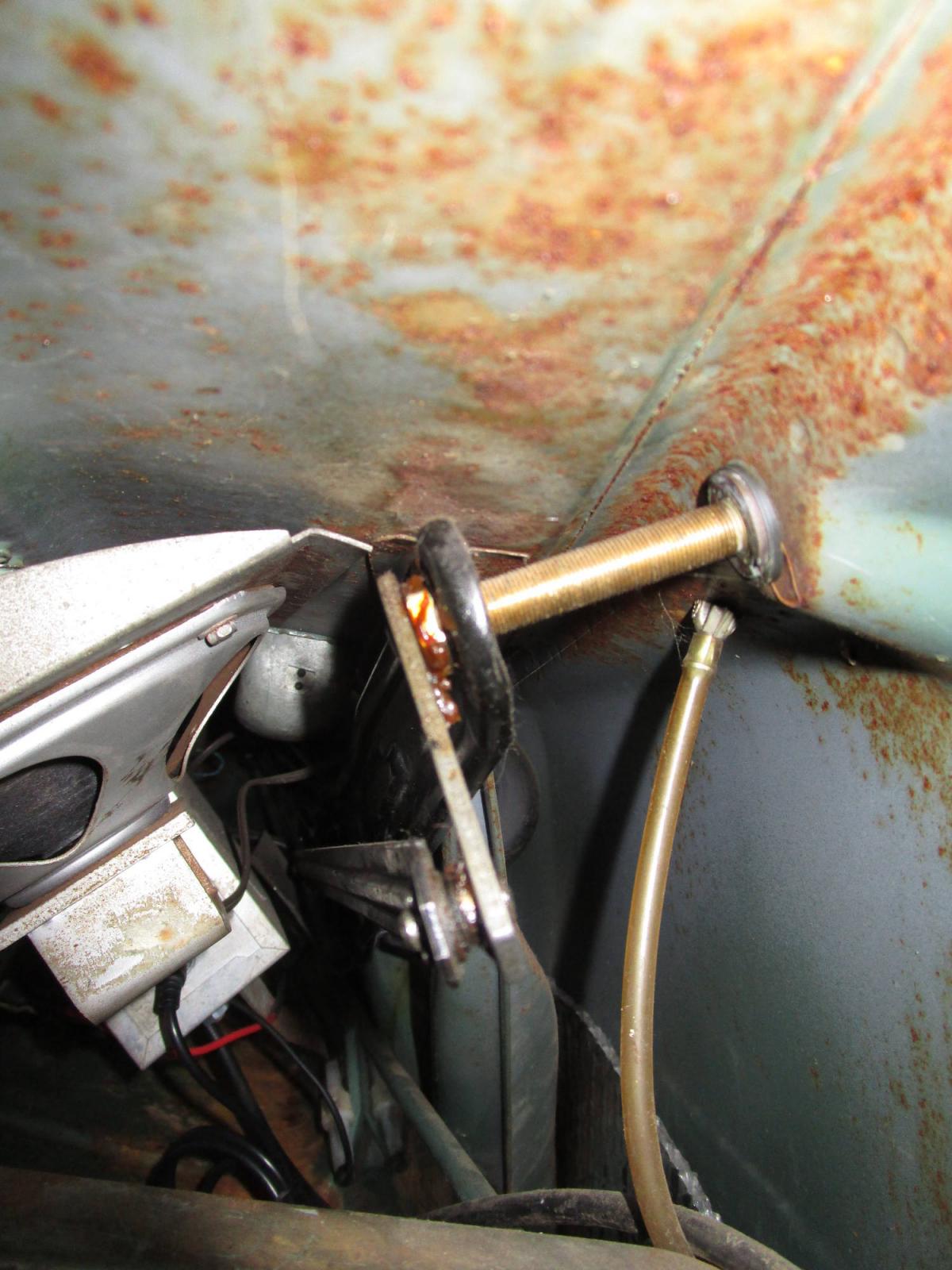

IIRC, you have to take them apart to replace them.
Make sure the shafts and moving parts are greased upon reassembly.
take pics so you know how to orient the parts.
my 66 kombi had worn sloppy pivots, and I installed new WW repro pivots:
