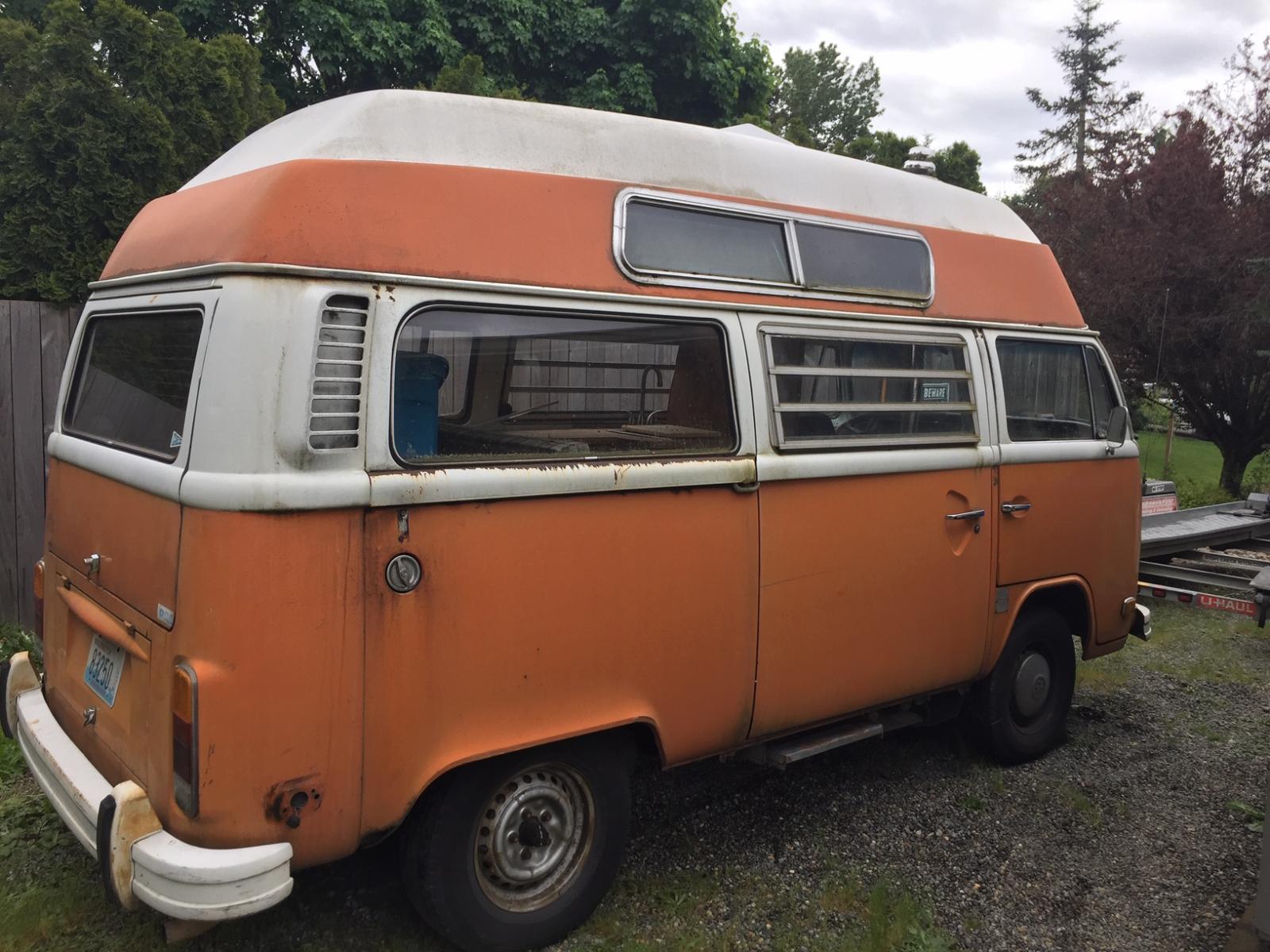

Hello All!

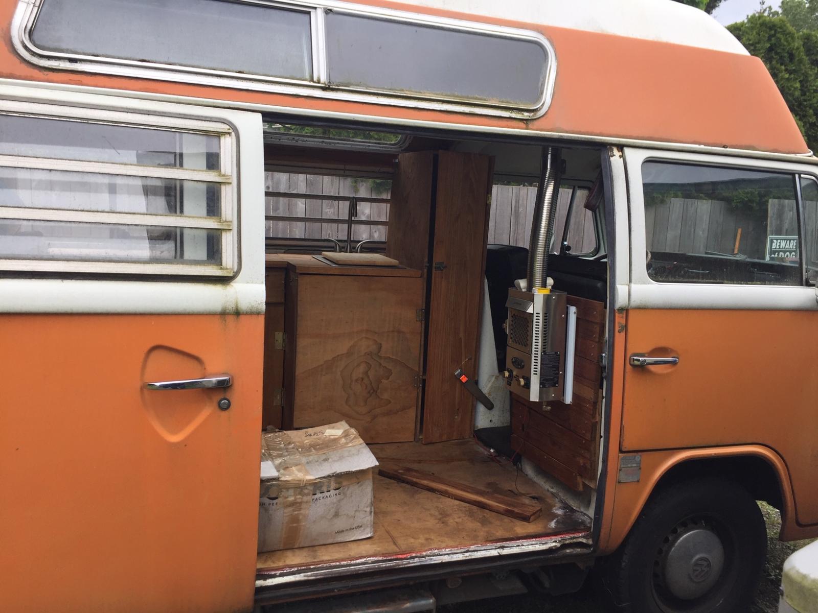

I decided to start a build thread so that I could document everything that I do to this bus. I plan on posting the cost of everything as well because to me that is an important factor and I generally like to see cost in build threads.
First cost, we picked up the bus for $3000 (a pretty good deal in my opinion). Although it was not running and driving when we got it.
Some background, my wife and I have been looking for a camper bus off and on for 3 years. On a whim I got the OK from the wife to start looking again. This bus had been posted on craigslist for only 45 minutes when I started looking. I sent it to my wife and we knew it was the one so we grabbed a trailer, drove up past Seattle, bought the bus, and brought her home that same day.
I was also given a lot of extra parts. Fuel pumps, ignition coils, distributor cap, accelerator and clutch cables, and a radiator for a subaru engine swap to name just a small portion of the extra's I was given. But most importantly I was given these books.

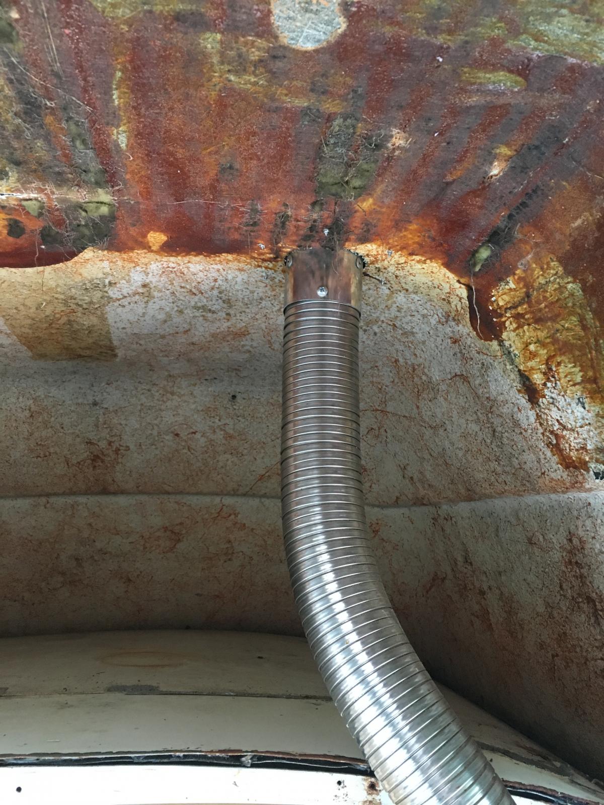

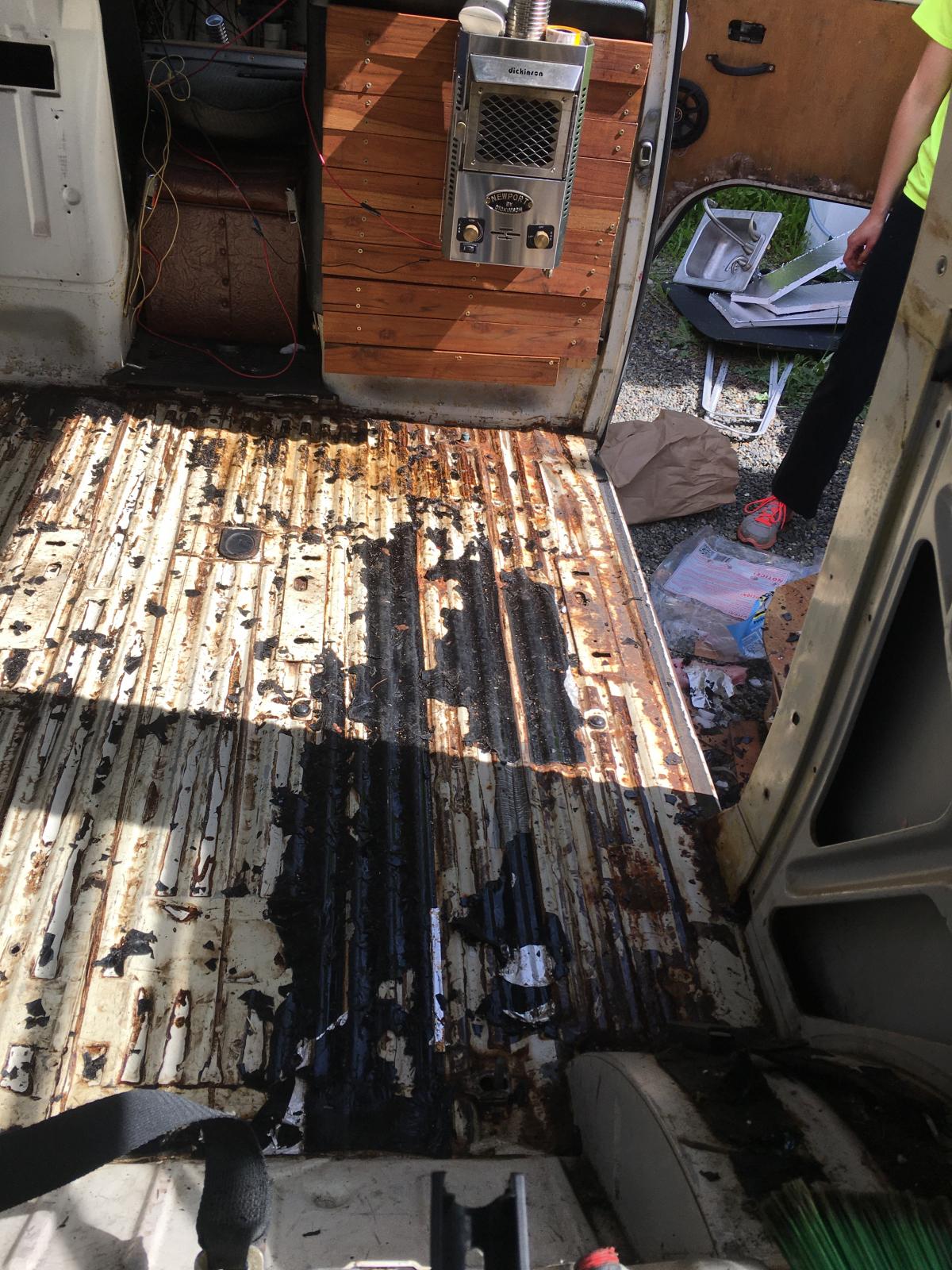

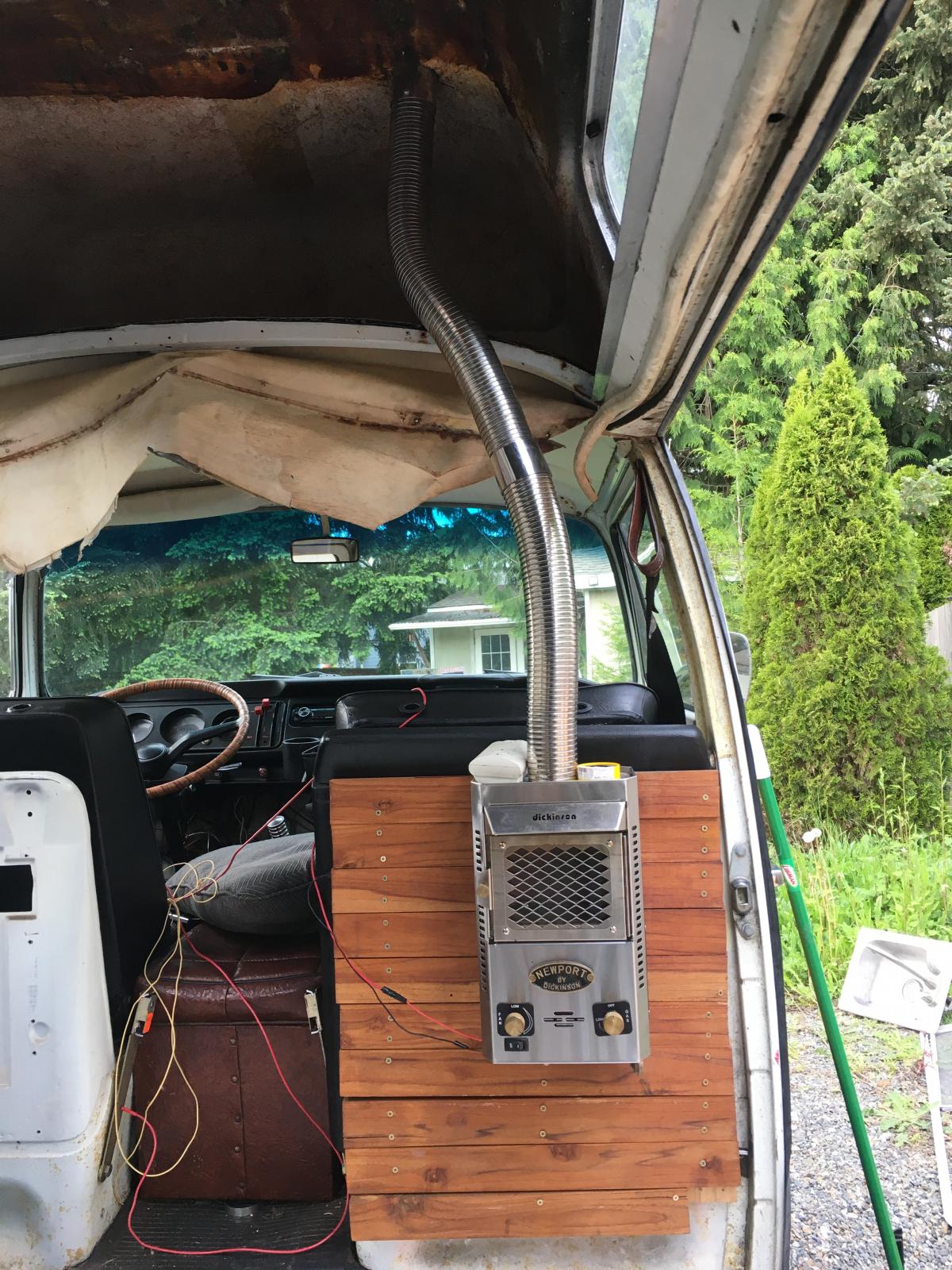

One of my favorite parts of the bus was the look of the heater that was in it. But alas, my wife wants to use that space to return to the original layout by putting a fridge and gas grill there. I'm not too bummed about it though because those are necessities that I wanted as well. Here's some pictures of the layout for the furnace.

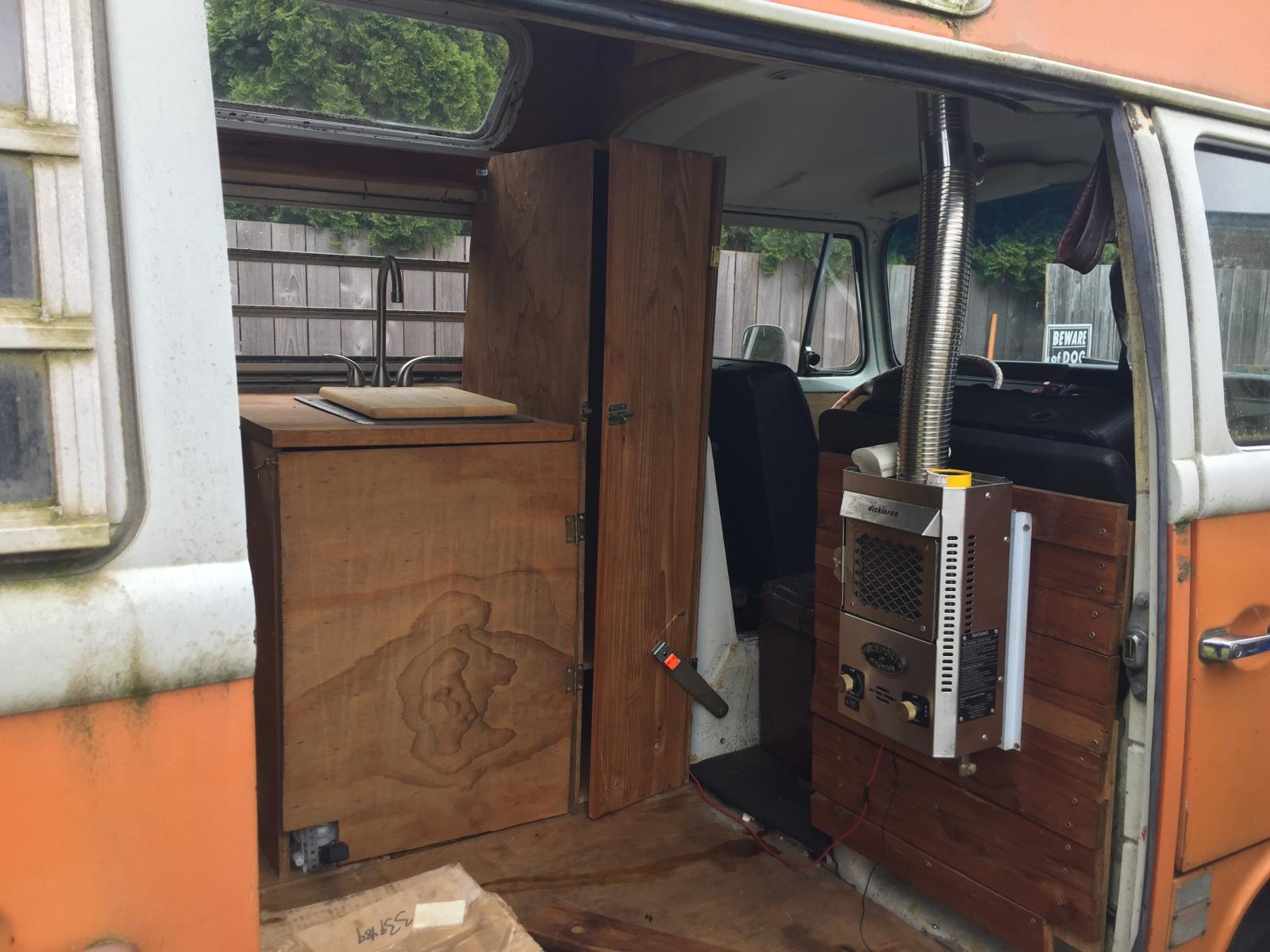

In this first photo you can kind of see the original set-up for the Safare Custom Camper. There's a large propane tank (looks old and original, definitely going to be replaced) that was not used for the furnace. But I like the layout and using the space under the bus so I don't have to take up interior space.
Because we are removing the furnace I am going to have to patch that hole that was cut in the roof. I may soon have the furnace on the classifieds or if anyone reading this wants it you can PM me. It's a Dickinson Newport P9000.
You may have also been able to tell by the picture of the propane tank that we started removing the interior. My wife plans on turning this into a pintrest bus which I am alright with because she has some pretty good interior ideas. My job is to make sure everything is as functional as it can be so that we can use the space wisely.

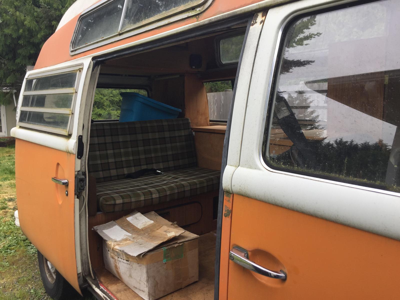

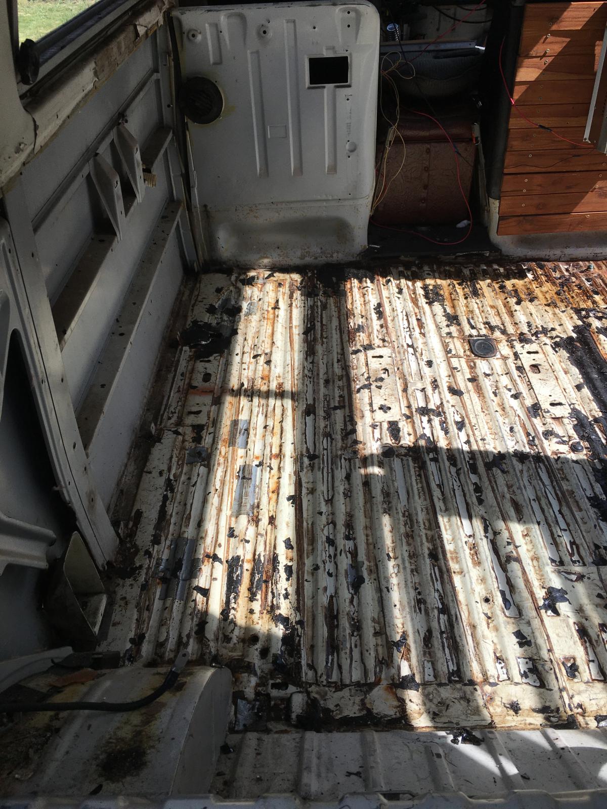

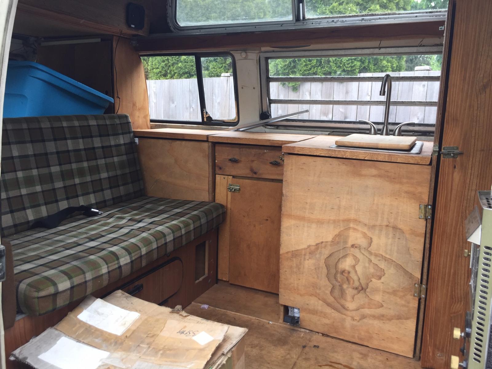

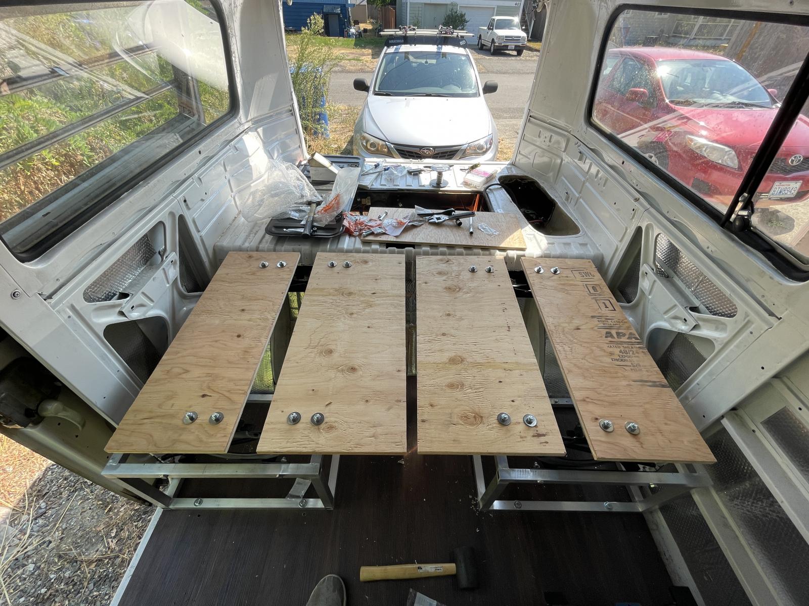

So onto the interior being ripped out portion. We tore all the "custom" plywood built interior out and threw it to the side because we won't be using it. We did store all the Westfalia specific interior stuff like the Z Bed which will also be going up for sale soon (or you can PM me). Then we were left with aluminum tape covering the floor with tar under the aluminum tape. I'm thinking this was used as insulation? or sound deadening? or both? Who knows, but it was a pain to peel off. 3 hours of peeling and we only got about a square foot done. Then I remembered dry ice works wonders. Here's some pictures of that.
It only took us an hour to do that! As you can see there's a little bit of tar left, but dang these floors are in good condition! One thing I didn't think of though is that the dry ice also gets rid of the under coating... So now I need to break off what is delaminated down there and redo that.
This is as far as we are now, I am actually going to the store right after this post to get more dry ice to get the rest of that tar off and then we will try to completely clean the rest of it so that we can respray the interior after we pull the furnace and the front interior out.

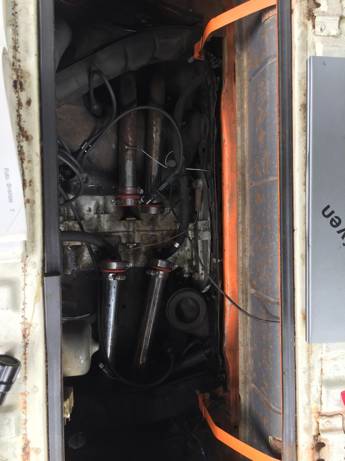

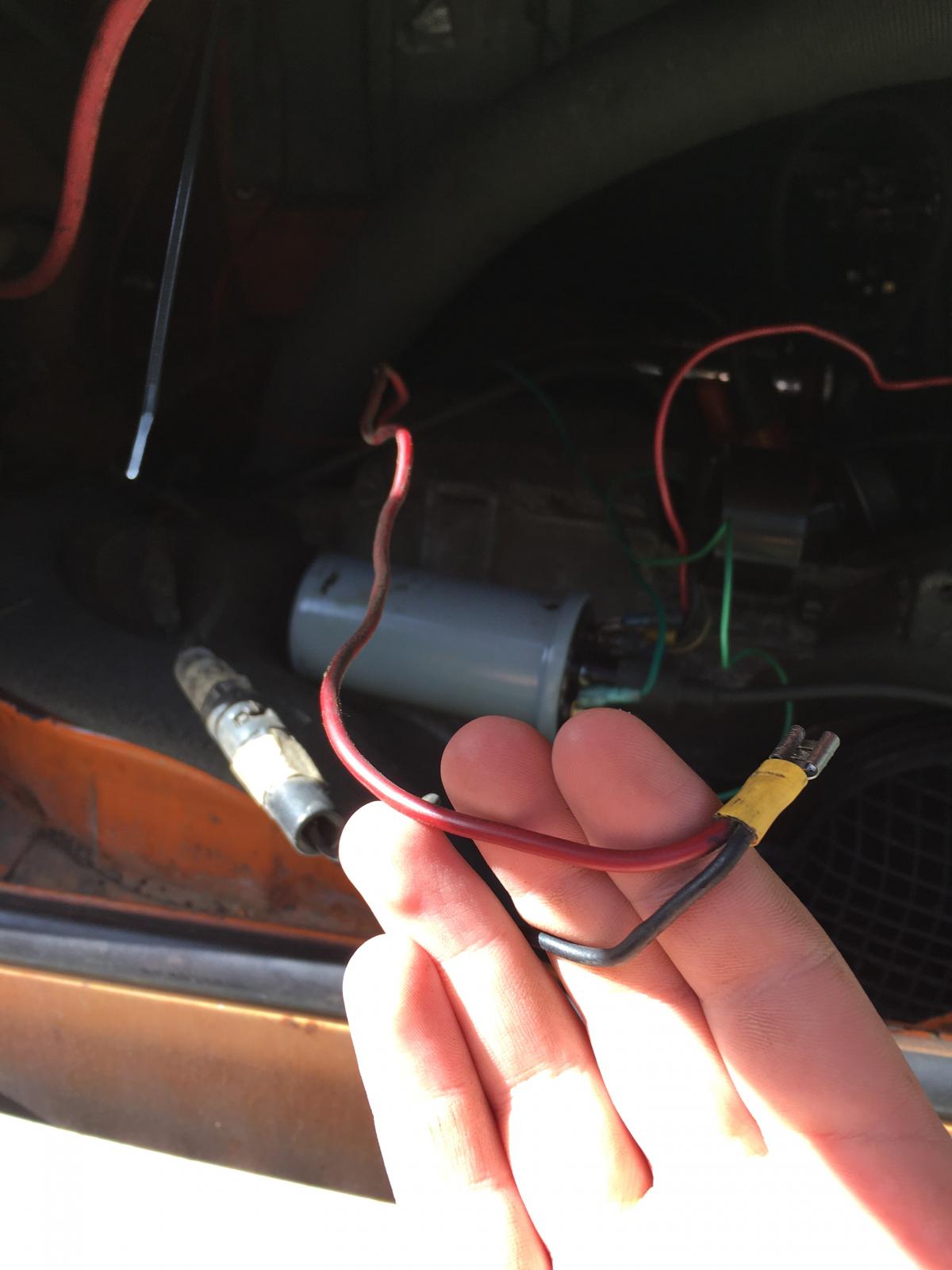

Background on the engine side of things. When the vehicle was posted the previous owner said that he had driven it to work one day and then when we went out to it it would not start. It then sat for a year until he posted it for sale and sold to me that day. To me this sounded like a simple enough issue but boy was I wrong... Let me start with the wiring.
Loose. Wires. Everywhere.
This one had a tag that said "Dizzy" on it but I still don't know what it was for... It definitely didn't connect to the distributor...
Un-capped wires that I had no clue what they were for were all over the engine bay. So my first task was, for safety, to cap everything. I don't care if it's live or not, if there's wire showing it needs to be capped.
Next I checked if there was spark in the spark plugs. No spark. So then I checked the Ignition Coil. No Spark. So I thought to myself, "Perfect! I found the issue. It just needs a new ignition coil." So I went to O'Reillys and bought an ignition coil (not knowing that I had 2 more ignition coils sitting in the bus. I'm still need to test them to see if either works so I can keep one as a spare or both if they both work.) I put the new ignition coil in and still didn't get spark. So I traced the wiring all the way back to the battery to see if anything extra was drawing power from the coil.
The only thing in between the battery and the coil is a fuel pump relay. Which wasn't anywhere in the wiring diagram because it originally came with a mechanical fuel pump. So then I put in one of the extra fuel pumps that the bus came with and I had spark again (the extra fuel pump has a crack in it so fuel was spewing everywhere... definitely not keeping it.)
Once again, I thought I was done. I now had spark and I even got the engine to start for the first time once I got a new fuel pump and plugged everything back in! But sure enough the engine wouldn't run for very long without stumbling and really struggling to stay alive... So I got a fuel pressure gauge to see if fuel was going into the carb and I was getting too much pressure. So I got a pressure regulator to get 3.5 psi into the Progressive 32/36F carb that came with the bus. This didn't fix the issue but it definitely helped the bus to run better. I also pulled the carb, cleaned every orifice, set the float height, and reset the idle and mixture. This got the engine to run on it's own which got my wife and I excited. We were able to take our first test drive.
I also changed the oil, filter, cleaned the strainer, changed the plugs, added fuel to the tank. The general maintenance stuff.
We were able to get down my steep driveway, start down the road and man was it struggling... I could get the bus up to 14mph barely, couldn't quickly press the gas or it would die, and definitely took 5 tries to get back up my steep driveway. Once I figure out how to upload videos I'll upload the first drive and attempt to get up the driveway, it's pretty funny.
After all this I still had a lot of work to do on the engine to get it running right. But this post is already super long so I'll go on to the next post for that update.

Second update on the engine. I was told to check for vacuum leaks. I had a vacuum advance distributor so I tested to see if it was holding a vacuum and advancing and it still was... I also checked the points and they were good. Either way I wanted to get a mechanical advance distributor and hoped that getting a new distributor would help the problem. I also made sure the spark plugs were still clean and that the gaps were right. I was having a hard time connecting the plug wires to the spark plugs too so I made sure they were clicking in and absolutely secure. I think that was everything that I did...
I had my wife start it up because I wanted to make sure that the timing was right with the new distributor and sure enough the engine started right up (the engine starting was very hit and miss before). Not only was it running, it was running well! I got the timing to where it was supposed to be, got the mixture to a good spot, set the idle, pressed the throttle and wasn't having any more lag problems. The engine was running super smooth. So then my wife and I went on our second test drive. It went so much better! The bus drove like a bus, I was able to get over 14 mph, and I didn't feel like it was going to stall out. I now have a good running and driving bus! It's completely gutted but I am now able to take it places and am so happy!
Tomorrow we are going to clean out the interior a little more by pressure washing it, prep a little more at the surface rust, and then re-spray the interior (probably won't be tomorrow because that would be ambitious). But definitely getting progress!
And once again, am so happy that it runs and drives well now!

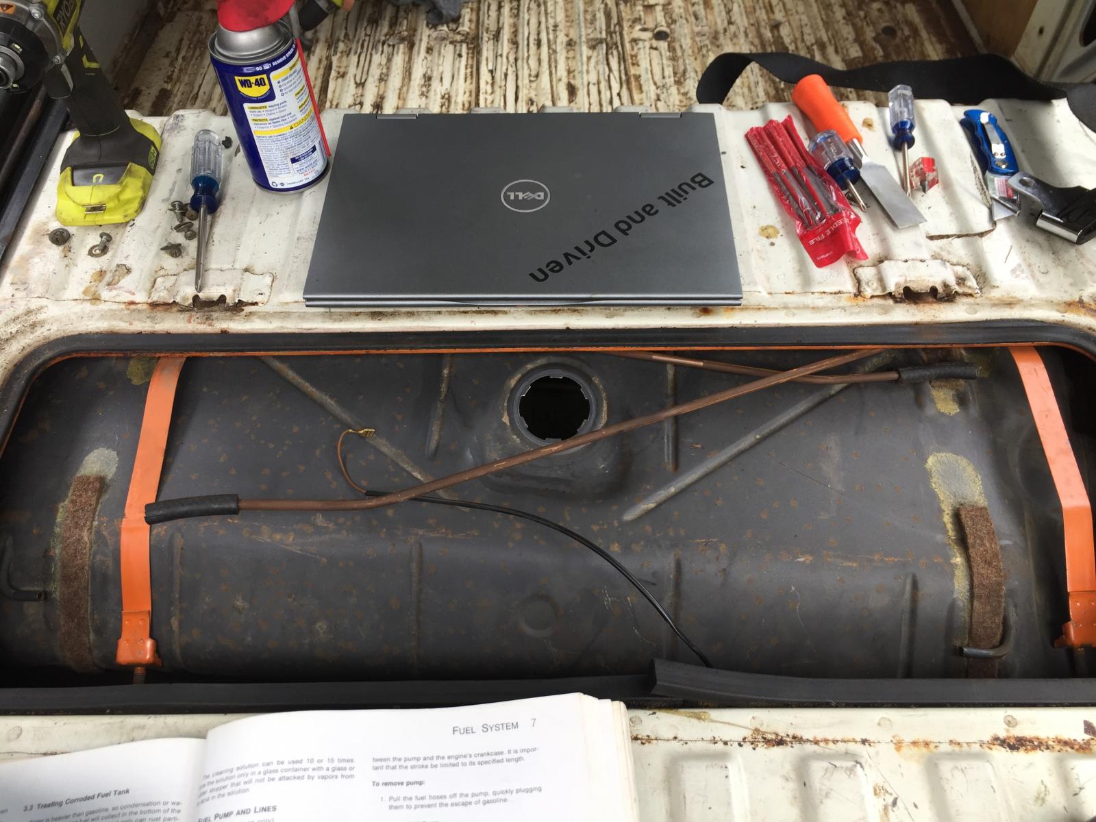

Wow, so much to do, so little time. My wife would like to go on a road trip in the bus next weekend but first we need to get the interior all cleaned and she would like to get it painted. We will be using KILZ because it'll match better with the cabinets. In the meantime I have been working on getting the fuel gauge working again because I would really like to know how much fuel I have in the tank. The previous owner gave me a new sending unit but I was hoping not to have to replace it considering everything I was reading in the manuals was to pull the engine and then I can pull the tank to replace the unit. I was able to pull the panel off that showed the fuel tank after I removed the carb.
My first goal was to find the brown wire coming from the sending unit and ground it to see if I could get the gauge to read. I found it, grounded it, and got nothing... I then looked at the sending unit and the wire that supplies power was no where to be found... I was able to read the resistance of the sending unit though and considering there was fuel in the tank and I was getting "OL" from my ohm meter I determined that the sending unit was bad anyway and needed replacing.
To my delight, as you can see in the pictures above, I looked at how much space I had and determined I should be able to just shimmy the fuel tank out enough to replace the sending unit without removing the engine. This is all thanks to the access panel they started adding to these buses in my model year.
Pulled the tank out, pulled the sending unit out and tested it while moving the punger up and down and it was definitely bad. Tested the new unit and it was good, put it in, wired up the positive and negative, put the tank back in place, the panel back in (it was actually extremely difficult to do this and took forever...), and then secured everything. My new issue is that I need to find the wire that originally goes from the fuel gauge to the sending unit... I thought I found the wire but when plugged in to my sending unit wire I am still getting nothing... So that will be an adventure for tomorrow I guess.

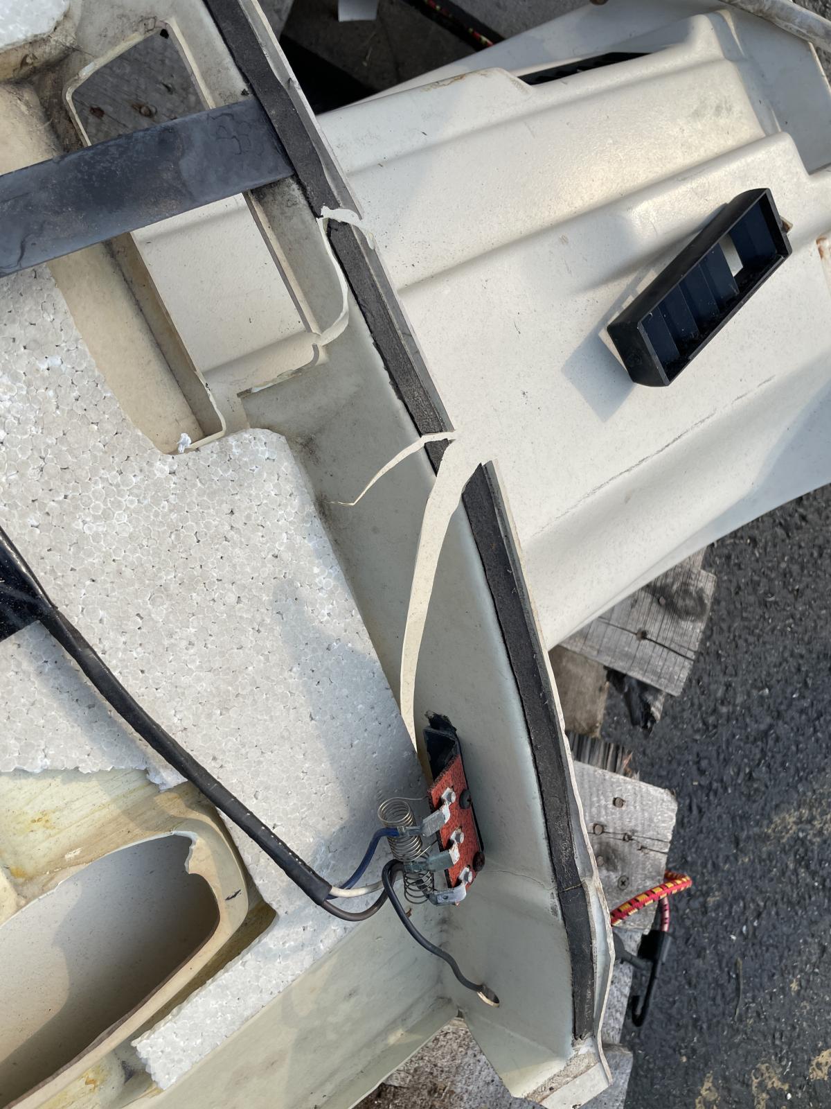

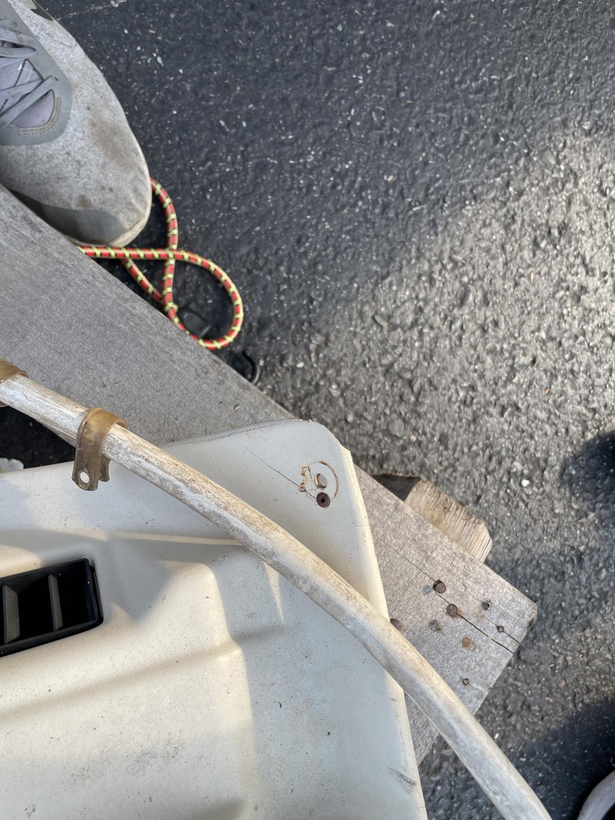

Here are other badges and a sticker I’ve been meaning to include in the post as well. Just for general identification of the bus.
Also 60vwnewengland, I notice you have this same vent as I do. Do you know what the original purpose was for it? I haven’t been able to find it in any documentation. Just curious.

The most notable thing on our trip to the gas station though was the brakes. I have driven around our neighborhood a couple of times now and the brakes have been fine. Not great, but not terrible, definitely felt like they needed to be adjusted. But on this trip the brakes were sometimes non-existent and it would take some frantic pumping to get pressure again in the pedal so I would not hit the mustang in front of me. So that's definitely a top priority to fix before we go anywhere else. I'll open it up, look at the condition of the brakes, potentially (probably) replace them, bleed the system, and make whatever adjustments necessary. In the future I would like to move over to disc brakes but for now I will just fix the drums.
Now onto the engine suspicions, first is the carburetor. When I cleaned the carb I reset all the settings. Then I tried tuning the carb and found that no matter where I put the mixture knob the engine still runs the same. Even if I have it completely shut the engine still runs the same. Not perfect, but not terrible either. So I need to figure out what is going on with that. Any ideas from anyone?
The engine also has issues on start-up, it starts at a really low idle and struggles to start sometimes but then when it warms up the idle goes up to where it's supposed to be. I am attributing this to the carburetor issue as well.
AND the fuel gauge still isn't working... Although I think it may be the voltage regulator because when I check the wire that goes to the fuel gauge it is supposed to be getting 5V and it is getting very little voltage if anything. I still need to check if the input voltage for the voltage regulator is good or not but I was too busy on getting the bus on the road yesterday to check it.
